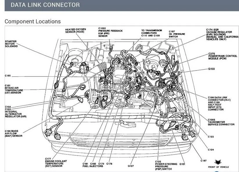

Ok, here is a better detail, reminder I said that older manuals are sometimes not imported onto databases correctly, as I found a discrepancy in them already.

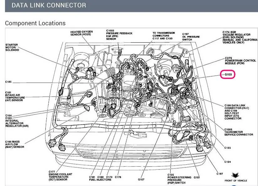

I am pointing out the Ground for the Fuel Pump, I believe the following is the correct G103 Point.
Note other diagrams show G104 as the pump ground.
Another clue that this Ground is the issue, does your Fuel Gauge Work?
The Pump & Gauge have different power inputs but share that ground point.
This is a good point of T/Shoot (knowledge)
I want to draw attention to its location and the location of the Starter Relay (You Replaced)
Its right next to it:
Check the G103 for security and ensure it has a solid clean connection and all wires to that lug are intact.
With all you have done, and the truck was running prior to you, replacing the starter relay, I HIGHLY suspect your whole issue is here.

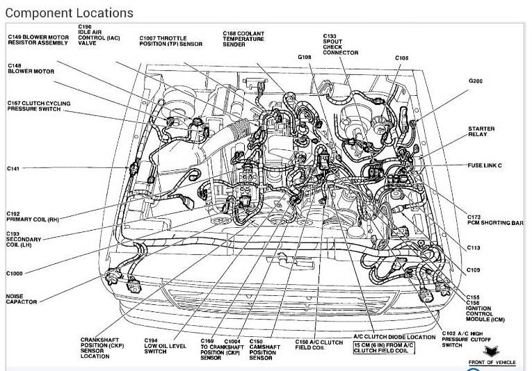

About the same diagram, except this one highlights (1) thing and that is the Fuse Link,
Note how it is part of the Starter Relay Wiring, if this was strained or pulled during install, it is possible you broke the wire, now this link feeds the Alternator and is a protection circuit.
You have a large gauge wire - dropping down to a lower gauge wire, its intent is to burn the lower gauge wire in half to break the circuit (a fuse in a wire) AKA Fusable Link
Check that section of wire, you should feel a soft area inside the insulation where it has melted, if it has - you can also find the spot where the gauge changes (gets larger) - grab that spot and the other end of the wire - grab it and give it a slight tug, if the link is melted you will be able to stretch the wire (insulation)
I do not think this is your issue, but a good idea to check it, being you were touching that wire when the relay was replaced.

Now let's get a meter and focus on the Fuel Pump Ground (1st)
If the above G103 appears intact and a good clean connection.
Key Off:
At the Fuel Pump Connector (4 -Wires)
Pinout as follows:
Black Wire = Fuel Pump Ground
Black / Yellow Wire = Fuel Sender Ground (Gauge)
Meter (Ohms) Scale
Red Lead - To Black Wire ---Black Lead to a Good / CLEAN Body Ground (Frame)
Repeat the same for the Black / Yellow Wire
You should see a reading of around 3 to 5 ohms
This is testing the resistance of the ground wire from G103 back to the Fuel Pump Connector.
If this is high resistance, the pump or gauge will not operate. you most likely have a Mega Ohms reading here (if I am correct)
To correct the issue, closely check the G103 (ground point) and the wires going into the lug.
If no issues are found with that G103 then you have the option of spending the time to locate the broken ground or just run a new set of ground wires to the G103 location or a new location altogether (add into an existing) ground along the frame or make a new one.
So, cut and splice in a (NEW) Ground
That covers the Pump Ground

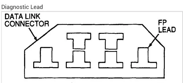

We can by-pass the EEC control and force a constant 12-volts to the pump via:
Step 1: Leave the FP Relay installed and go to the EEC Test Connector, Jumper the FP Test Port to a good body ground
Turn Ign key to (ON) and then test for power anywhere on the Fuel Pump Circuit, you now have forced a ground to be applied to the Coil Side of the FP Relay and should have constant 12-volts being applied to the pump.
Step 2: You have already done, and that is jumper the FP Relay (Removed) (Top & Bottom) pins
This applies direct 12-Volt power to the pump (when key is on)
In step 1 - Tests the whole Fuel Pump circuit, except the EEC Control for Coil Ground as you are forcing the ground from the EEC
If step 1 - gets the pump to run, then you have an issue with the EEC or the ground for the relay coil
If step 1 - is no help, then you have a power or ground issue (pump control)
In step 2, you are by-passing the relay completely and are jumping the power feed from one side of the relay to the other (completing the circuit) that the relay controls.

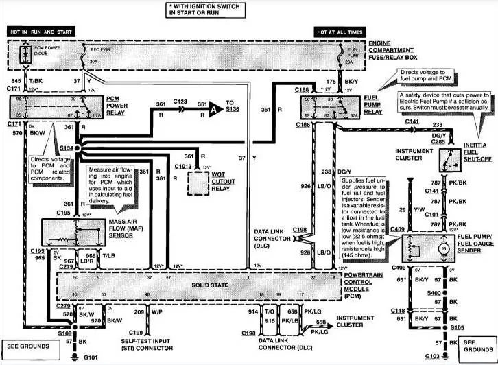

Ok, here is the complete diagram:
Let's start with are we getting power at the Fuel Pump:
Note: set up the power feed described above (using step 1 or 2) and Turn Ignition Key to (ON)
At the FP Connector
Pinouts as Follows:
Note: Voltage readings are dependent upon what your current battery voltage is (?)
Normally this is around 12 volts, so do a test of (CURRENT) battery voltage and apply that reading to all (test result) readings below.
Pink / Black Wire = Fuel Pump Power
Meter on Volt DC Scale
Red Lead - To Pink / Black
Black Lead - To Black Wire
and then
Black Lead to - Body Ground (Frame)
You should be reading 12 volts on both test points
If you have a better reading when going to body ground, then you have bad ground circuit.
The reason for checking both points is we need to separate the ground points to ensure we have a good ground circuit, when you go straight to body ground you are by-passing the ground wire run to (G-103)
Repeat this test using the Fuel Sender Gauge (Wires)
Note: The fuel sender (gauge) I believe is a 5-Volt circuit so you will most likely see 5-volts in this test:
Pin Out:
Yellow / White = Fuel Sender (Gauge) Power
Black / Yellow = Fuel Sender (Gauge) Ground
Same power test as above for the pump power (only use these) wires
If I am correct, you should see 5-Volts and the same matching voltage on both tests (wire and body grounds)
Same as above if the body ground provides a better (higher) voltage reading then you have a ground circuit issue.
Note: here as I want to point out that since this is a lower voltage, it's easier for power to get to ground, so this is a shared ground circuit with the pump power, so you could possibly see a good test result on this (as far as the wire ground / body ground) separation check.
Ok, If we do not have power at the Pump Connector and our Pump / Gage grounds are good, then we have a power issue confirmed.
It is a good T/Shoot Practice to split your test circuit in half, to help isolate which side of the circuit you need to diagnose.
A perfect spot is the Fuel Inertia Switch:
With the (Step 1 or 2) still in play and the Ign Key (ON)
I suspect that it has a connector, on it - If not you will need to back probe it via:
T-Pin (Wifes sewing kit) or a paper clip, slide it carefully down the side of the wire to hot the contact pin:
Pinout:
Dark Green / Yellow = Switch Input
Meter Set (Voltage DC)
Red Lead to - Dark Green / Yellow
Black Lead - To Body Ground
You should have 12-Volts
If yes, then the switch is bad or wire feed between the switch and the pump is bad.
Note there are 2ea inline connectors between the switch and the pump
I can dig for locations (if needed)
To test the switch (isolate) switch vs wiring (between the switch) and pump
Key (OFF) connect the connector to the switch and back probe the other wire:
Pink / Black - Key (ON) and check for voltage on this side of the switch same as above for the Dark Green / Yellow wire
If you have power on one side and not the other - It's the Switch
If no, power on the Dark Green / Yellow then we need to move farther upstream of the switch
So - Undo Step 1 or Step 2, Turn key (OFF)
Pull the FP Relay out (if using step 1)
Key (ON) and with meter in Volts DC
Ref the Diagram Above:
Note: Since I am not sure (100%) which Terminals are what (Location)
I do know that the (2) vertical contacts are 30 & 87 (the center one is 87a)
The Horizontal ones are Contacts 85 & 86
But with that in mind should be:
Pin 87 = Top
Pin 30 = Bottom
Pin 85 = Right
Pin 86 = Left
The vertical & horizontal may be opposite sides of each other (so swap them if needed)
The main point is with Key (ON) you should be getting power to (2) contact pins
Pins: 30 & 86
Pin 30 = Always Powered
Pin 86 = Powers with Key (ON) and the EEC Relay Closes (Switched Power)
With meter set to Volts DC:
Red Lead to Pin 30
Black Lead to (Neg) Batt Terminal or Body Ground
Repeat for Pin 86:
You should be getting 12-Volts, note if no voltage swap to the opposite side (vert or Harz) in case my Top/Bottom and Left/Right are backwards.
On BOTH Contacts - 30 & 86
If no power on pin 30 - the issue is in the relay box or fuse
if no power on pin 86 - the issue in with the EEC/PCM power relay or wiring
This is where is gets deep into a T/Shoot as we do not know if the Wiring/ PCM Power Relay / or the EEC itself has fried.
So, we need to do a more detailed T/Shoot - If this is the case as there are deeper steps to take for this.
If you have power on both pins 30 & 86,
Then you have an issue with the FP Relay itself or relay box
To T/Shoot this, we need to disconnect the battery, the EEC Connector and the Fuel Inertia Switch and use the meter (ohms) scale and resistance check the wires
For the wire runs for Pins 87 & 85 and pull apart the Relay box and check for broken wire feeds coming from the FP Pump relay contacts - with a close inspection of the pin that was pushed down
There you have it - A HIGHLY Detailed - T/Shoot Guideline.

I would also say that it is possible that you broke the Fuse Link at the Starter Relay, and that may be playing into this - throwing a kink in the T/Shoot process.
But my strong hunch is the Ground Point (G103)

Maybe the G103 wire was damaged? Is that the ground for the fuel pump?
Yes, G103 is the Ground for the Fuel Pump, Check this for security, just in case you moved or damaged that wire, ensure its not pinched under the Starter Relay. I am focused on this for the sole reason, this would explain why all of a sudden, the pump is not running just after you were in this area. (a high possibility) of a damaged wire or lose ground point.

To be a little more precise, Near G103, if you follow the harness down from that Ground Point, I am focused on a Splice (S105) - you should see a spot where 6 ea wires are bundled together with a single wire running over to the Ground Bolt (This is where numerous ground wires run together) (Splice)
They are:
Fuel Gauge, Instrument Cluster, Brake Fluid Level Switch, Left Headlight, Engine Compartment Light, AC Clutch (coil) and AC Clutch (Diode)
If you are having a Ground Issue, the Splice would be the area that is high probability of being damaged, the Fuel Pump and the Left Headlight are the highest power draw, and they would be the 2 items most affected (in not working correctly)

Regretfully....This a follow follow up.
I won't go into the details with my former mechanic.
I think he was in over his head to figure this out.
He had done a tie-rod and exhaust job great.
One thing he found out is that the problem is that the fuel pump
is not getting power. We also tested a new fuel pump.
We did get it running for about 15 seconds. It started and ran perfect.
He manually charged the pump with some pack he had.
I had another mechanic over today, He tested the fuel pump relay and the fuses in the distribution box. After that he admitted he wasn't comfortable delving more into the wiring in the distribution box. I'm almost 99% sure following your feed back and what I did that it's a ground issue or broken wire.
At this point I will take it to a nearby decent shop if I can't find a mechanic that can figure this out. I think it got to be something simple before the inertia switch. Again any thoughts and feedback I can get and give to someone that can actually fix the issue would be greatly appreciated.
Thanks again!

Hi, So this is my final follow up.
I had to wait for appt at a garage.
I just got a call and they verified it's a wiring issue in the distribution box.
That's good but the shop tech is saying it may take four hours or more to trace down the issue, or issues. I think it's a broken wire or bad ground in the wiring to the fuel pump relay part of the distribution box. That seems to have it's own wiring bundle.
So the time was just a quick look from the tech after he verified the fuel pump is good.
If any of the guys that posted wiring schematics showing the ground or how the ground jumper is done I'd appreciate it. Otherwise the repair cost may be too much and I'd have to try to sell it. Which I'd hate to do.
Thanks much again!!
