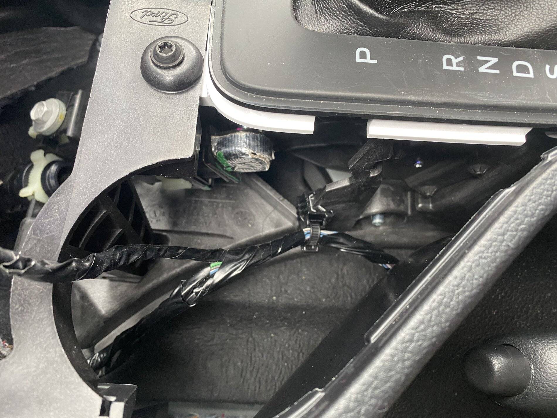

For what it’s worth, adding the light can be done although a bit tricky. I’m not planning to buy from the parts dept, not going to salvage them either.
Had the centre console apart about a month ago. You have to remove the top of the shifter assembly to reveal a very thin slot where the light would go. A regular LED strip wouldn’t work. It’s so close to the letters, you would see each light - no distance to diffuse. I am going to order a roll of COB to see if that may work.
Unlike in my last F150, I don’t even see the unused plug in the Ranger. I will tap into the lighting for the USB connections. Of course, this just lights things up, it will not move with the lever or indicate what gear.
