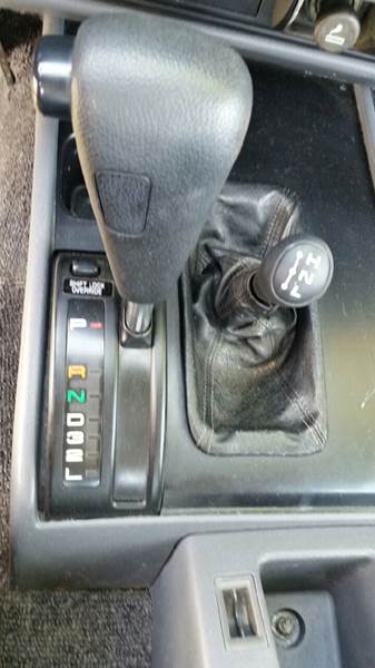

Yeah, I don't get it either.
Paddle shifters and automatics don't belong together.
Also, I feel it's a pretty natural moment to reach for the shifter if you want to shift gears manually.
Anybody remember these?
