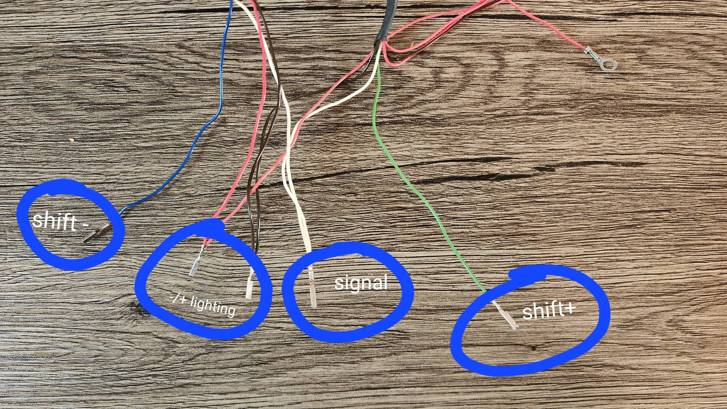

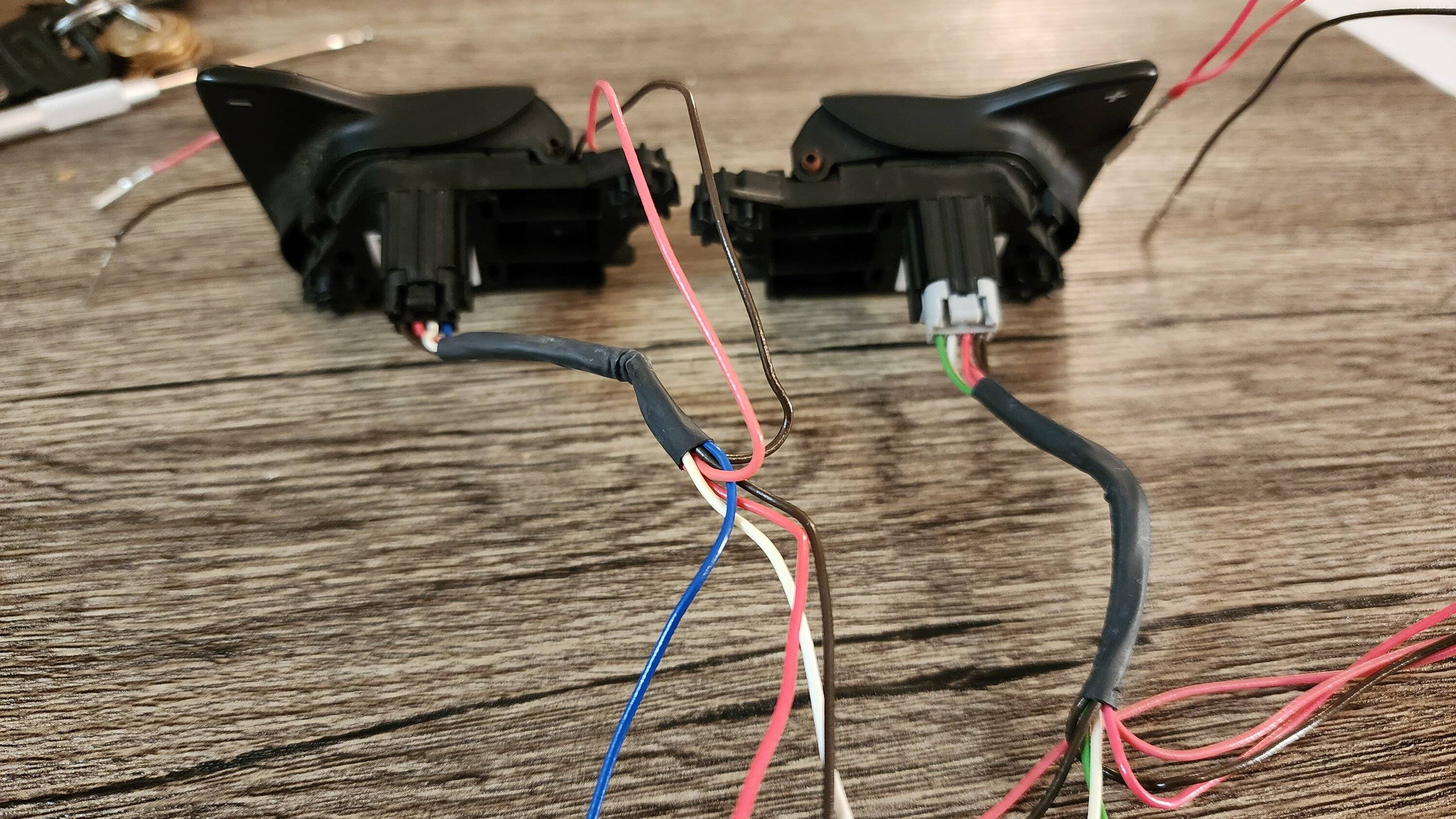

I just need the interior lighting diagram, I already figured
I promised someone else I would but never got around to it... very sorry to him.
Will try to get that done soon.
I just need the interior lighting diagram, the set of paddles that came with the steering wheel already has a harness. I figured what each wire does. I just need to know where to tap to get the +/- to illuminate. Also there's a relatively easy place to tap under the shifter boot, will run wiring from there to the steering wheel control module, I don't want to just tap into the wires so I'll go to the junkyard to see if I can find the same connectors to make a pigtail.

The - and + symbols are illuminated, I just checked with a 12v charger
