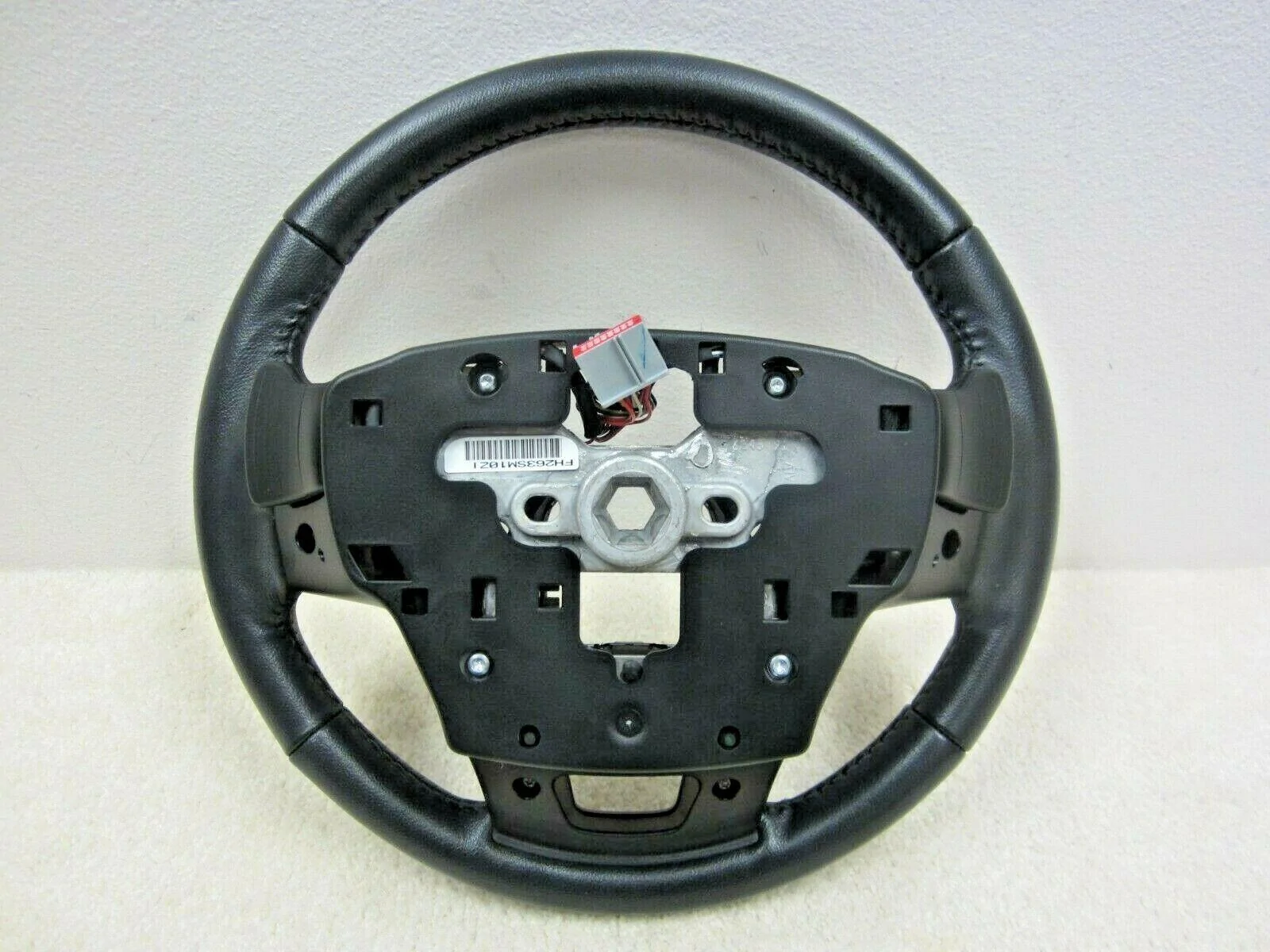

Possibly... This is the Explorer wheel I was thinking about... Got photo of the Escape wheel?? Also, what is the diameter and does the airbag match the Ranger??
RCMUSTANG
Ray
Jan 22, 2019
1,867
2,191
Los Angeles
2017 Fusion 1995 Ranger
I looked and the explorer steering wheel does not fit.
I'll take a look and some measurements the next time I'm there. I'll only be able to get exterior dimensions--will that be enough ?
