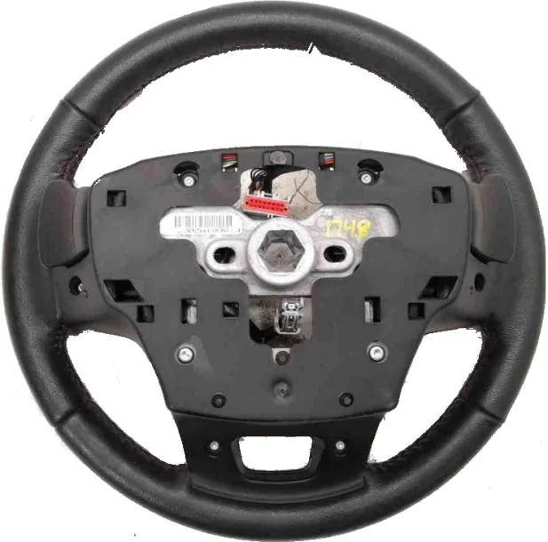

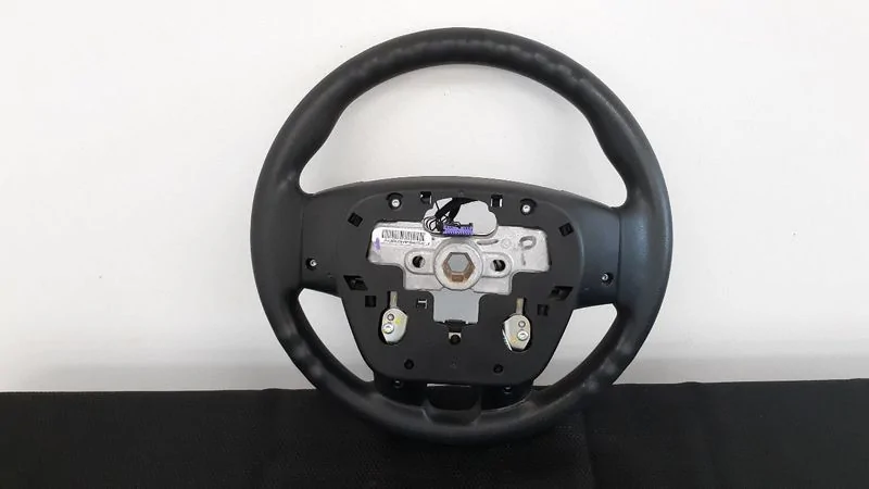

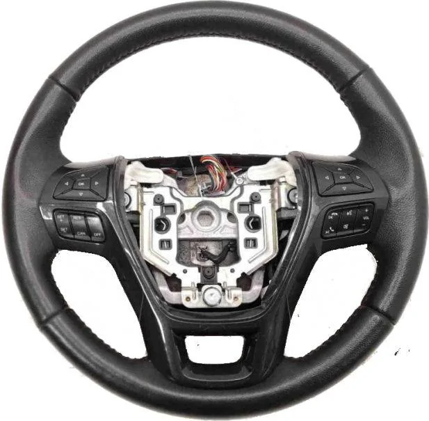

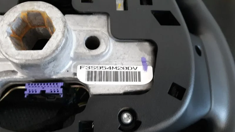

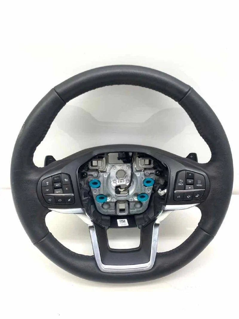

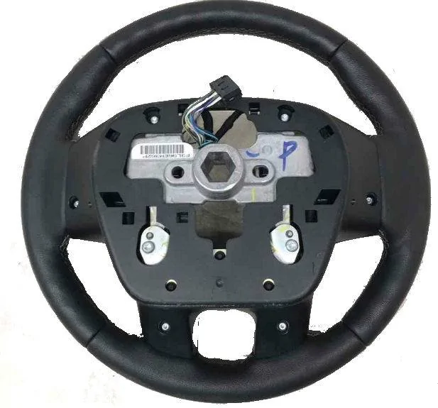

Recent F150 and Explorer wheels bolt on. Some Explorer wheels appear to even have the same connector, although pinouts might be different, mixed information, haven't dove too deep.
Additional complication is the adaptive cruise control, and whether there is a difference with the button functions on the Ranger wheel vs other models that also support adaptive.
Pictured, 2020 Explorer steering wheel in first three pics, same connector, paddles, bolts up, but Ranger does not have the additional connector/pins.
Fourth pic is a 2020 Ranger.
Has this mod progressed any further?

I want to revive this thread and take a crack at this mod. One of the features I miss in my previous Audi was the paddle shifters.
In looking at the Explorer wheel (2019 shown).
It appears to be really close to the Ranger, obviously the air bag doesn't transfer, but how about the buttons and wiring harness and dremel some holes in the back cover. Can it be this easy? Run the needed wiring UP/DOWN/COMMON to the center console.

No compatibility other than superficial looks. That's why I ended up doing my heated steering wheel the way I did. Plus the as built is so different on some modules programming it would take a monumental effort. That's why we still haven't figured out how to change the quick flash turn count. I changed every hex on the SSCM and nothing affected that one.

Looked into doing a Ranger Raptor wheel swap. Without basically getting the whole column to go with, can't be done and even going that far still might not be enough. Parts compatability is extremely small.

In another thread someone revealed that the plus and minus shift option on the center console are electronically controlled. We determine all that you really needed to add paddle shifters was to tap these two channels and a harness to wire some sort of momentary type switch (whatever shape)and some mounts that go on the column behind the wheel. This method means you can bypass having to use the steering wheel clock spring for wiring.
You can basically recreate this whole system for pennies on the dollar it appears.
I am of the opinion that the first person to come up with a production method of creating this type of kit is looking at an untapped market of cash.
