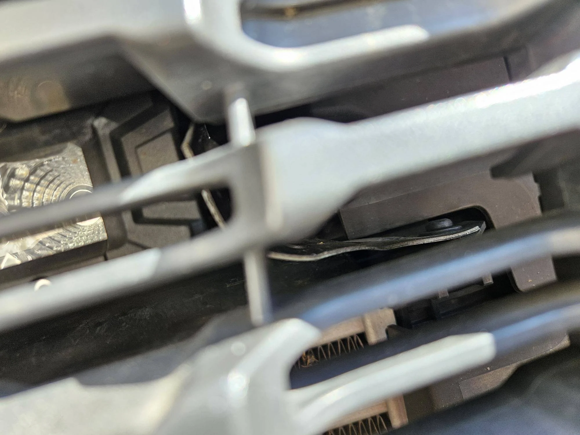

I had this in there, but had to take it out to put winch in.
I took off the skid plate, them just found a bolt on each side to connect it to. I got a piece of punched flat bar from home depot, painted it black, and bent it to connect the ends of the light to the bolts.
I did the same thing for the white bar behind the grill.
I considered a light bar behind the grille too but I felt the XLT grill might not have enough open space for it to shine through like the lariat grille would. Does it throw any light?
ylwjacket
Jan 18, 2023
259
742
N. GA
2019 XLT FX4
TBH, not sure.
I have it pointed down just a tad, so it's bright up close when the bright lights are on, since those shine out into space. When the low beams are on, it spreads a little more light left and right than the low beams do.
If the bar I had in there was brighter, maybe it'd put out more. I can pic in the dark and see.

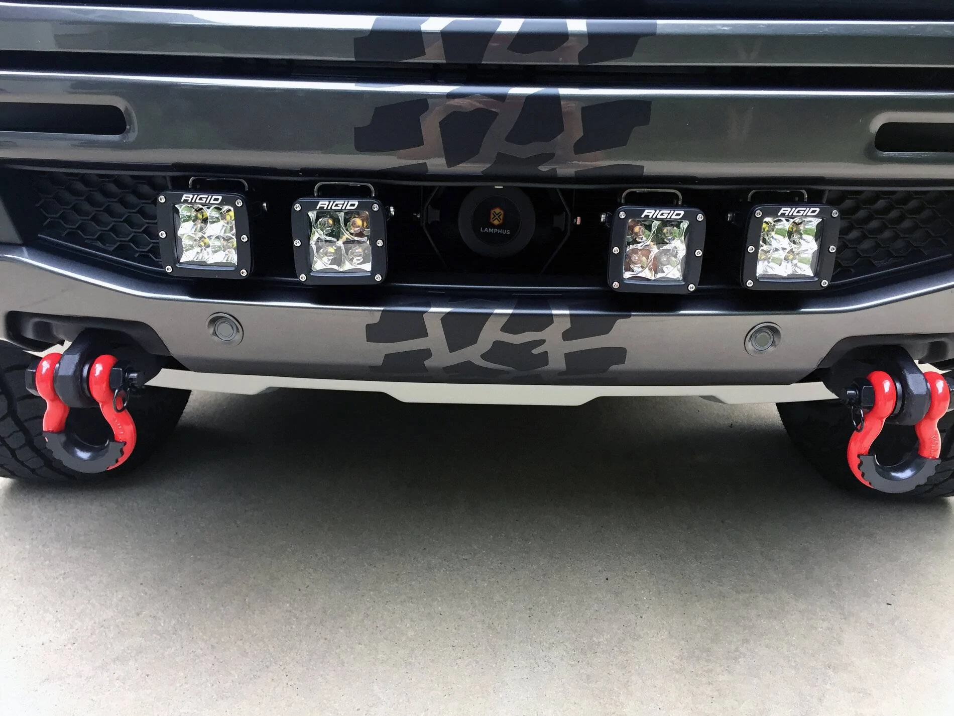

I put these in the actual bumper. Best idea ever had to remove the bumper and the plastic inserts needed to be modified but what a great addition
What lights did you use? And how did you wire them up? I plan on putting some lights here.

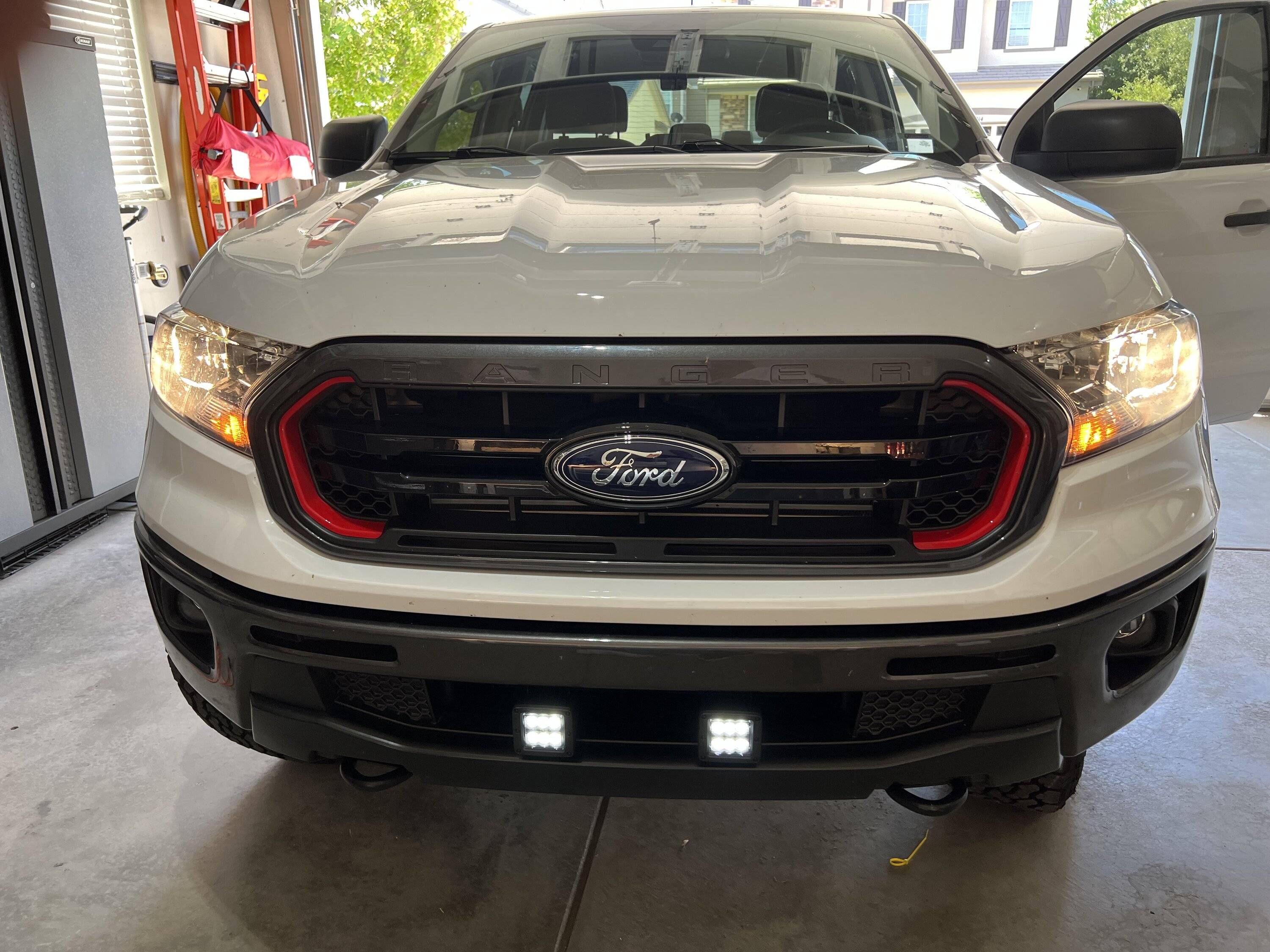

Subarus, 2021 Ranger
Diode Dynamics. It came with the bracket. No need to remove anything to install. Look at their web page and instructions...may offer some guidance. These do not interfere with center
sensor.
I have the same, easy-ish install with their brackets.
