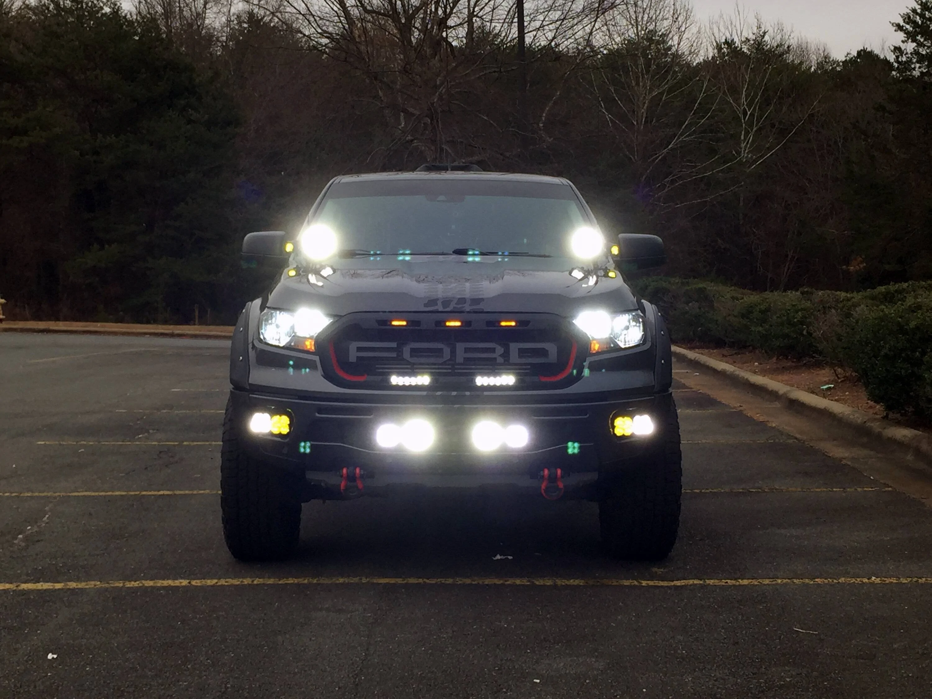

Suggestions for grill/bumper area lights that will fill in the gaps...
9,213
28,479
NWO Robot Polisher
Those look great! You running Mickey Thompson's also?
Thanks! I had Coopers ATS/XLT...now I have General Grabbers X3...

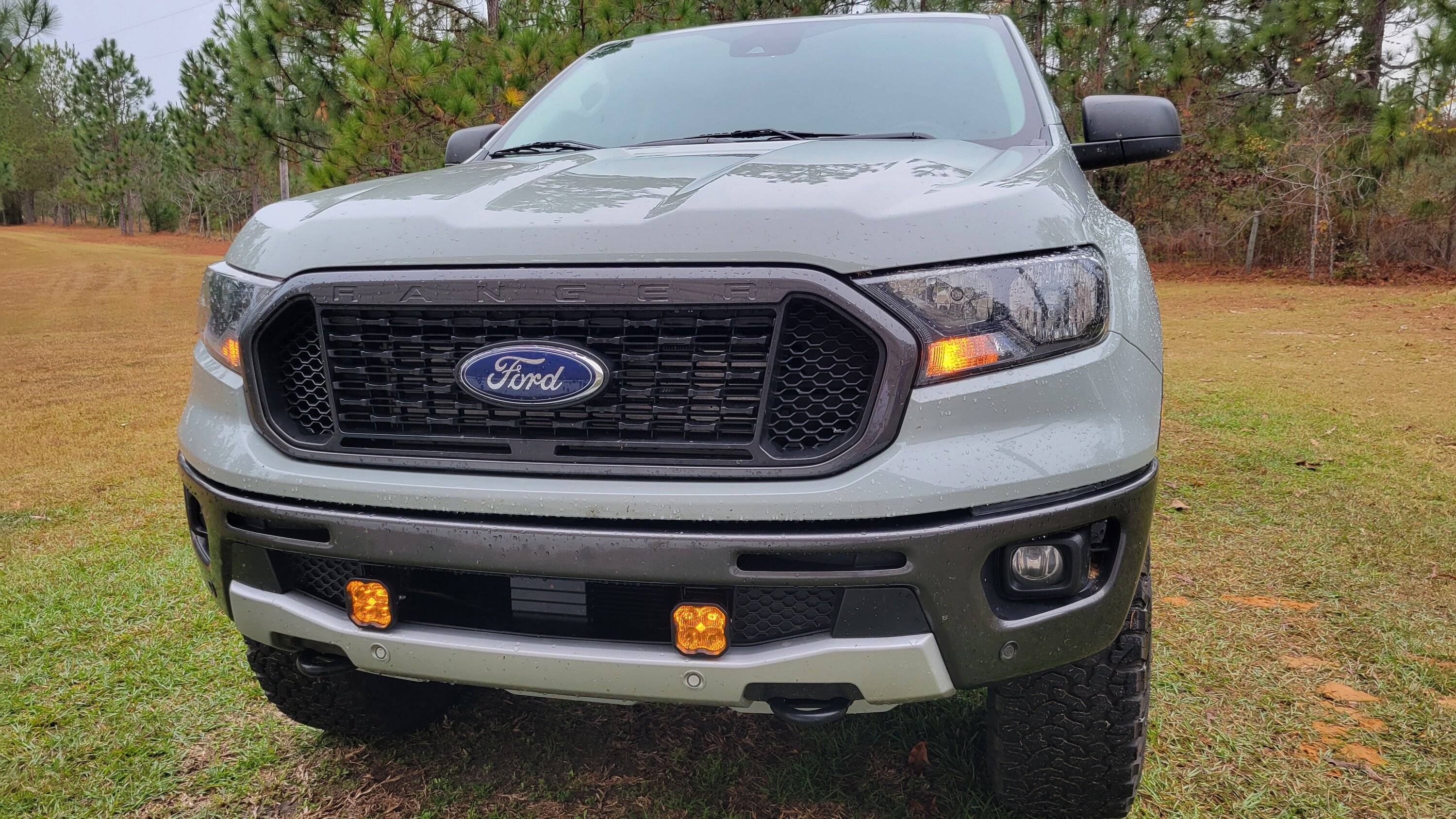

Is that your OEM grill? I just replaced mine and it a bit different. Ford emblem in the middle is the same, but has much larger slots on the main front screen area. Doesn't much matter now since I installed a new one with Ford spelled out and it's more like yours now - no big gaps.
Yes, in the OEM grill. The truck is an xlt with the sport and FX4 packages.

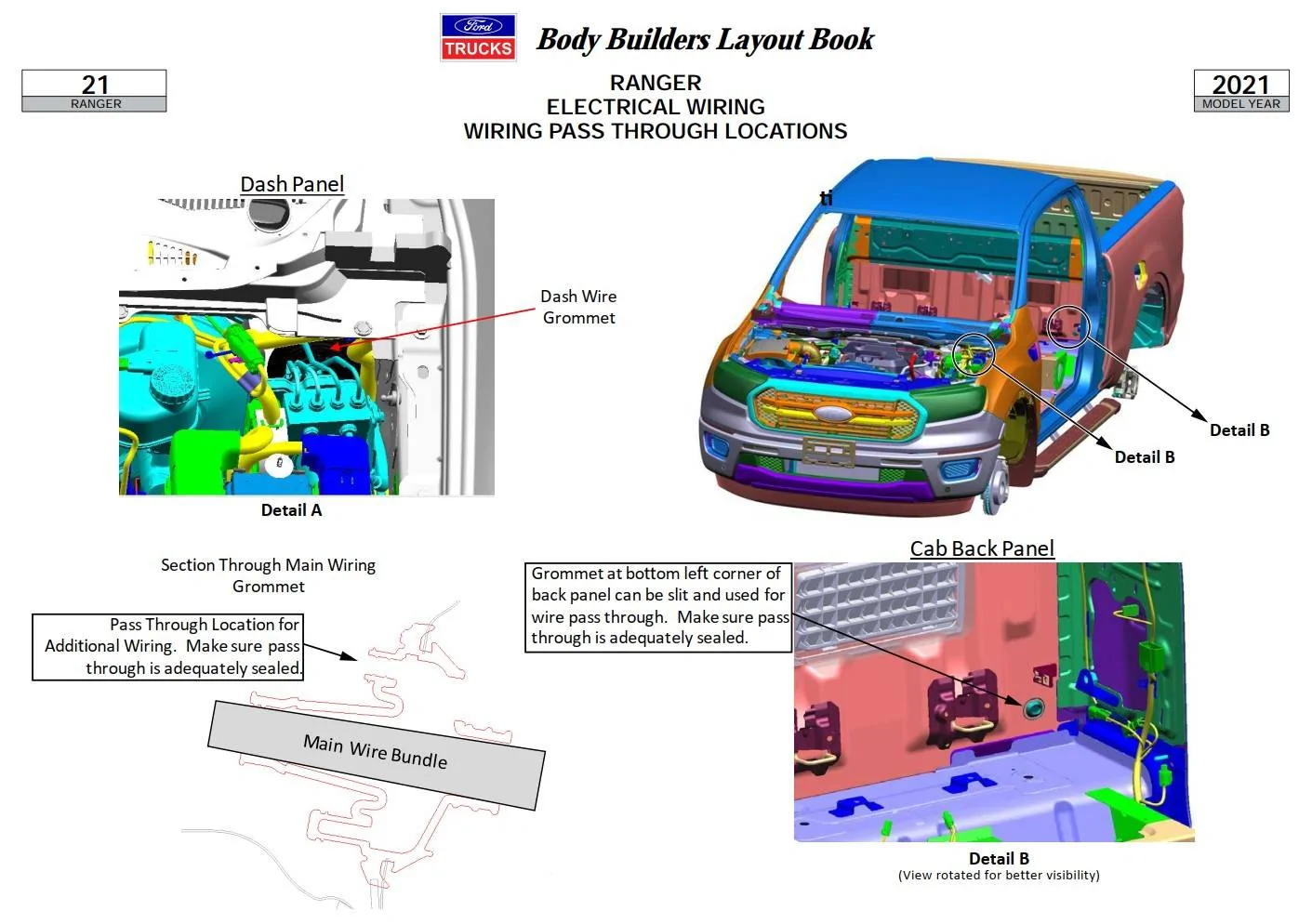

How did you run your wiring thru the firewall and what kind of Rocker switch?? OR, did you wire to headlights?
The wiring harness I bought with the lights came with a 3 position switch, On/Off/On. I cut a small slit in the rubber boot where wiring runs through the firewall on the drivers side.

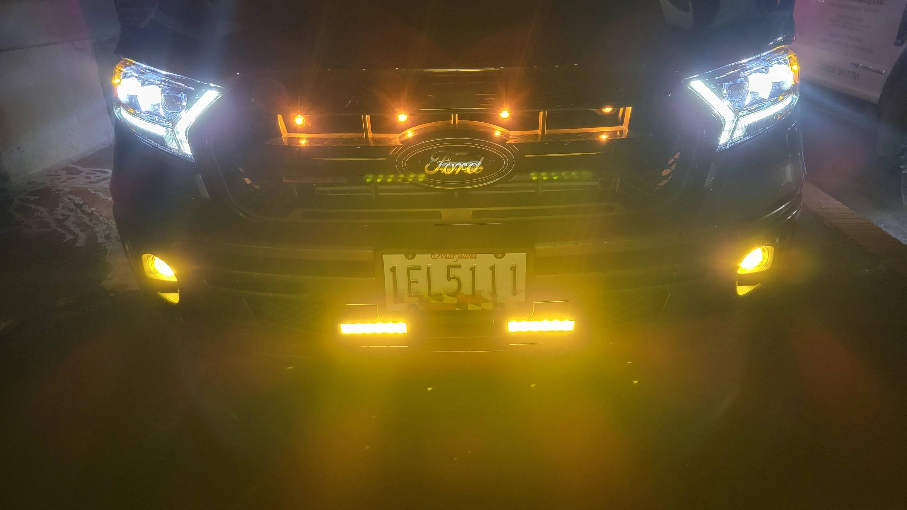

I have the 6" Diode Dynamics light bar (driving lens) in yellow
https://www.diodedynamics.com/stage-series-6-sae-amber-light-bar-pair.html
and the (easy height adjustable) Elite Series yellow fog lights.
https://www.diodedynamics.com/elite-series-fog-lamps-for-2019-2023-ford-ranger-pair.html
I bought the bracket kit for the 6" lights
https://www.diodedynamics.com/stage-series-led-lightbar-kit-for-2019-2021-ford-ranger.html
a pair of 10cm lead Y-splitters
https://www.diodedynamics.com/deutsch-dt-2-pin-splitter-wire-one.html
I used the fog lights as a trigger source for two relays and put a 5A fuse in-line to the battery to power the 6" lights. The 6" lights only come on when the fog lights are on. I have the fog lights set up in forscan to come on when turning. Both the fog and 6" light turn on while turning now even if fog lights are not turned on. I verified with Diode Dynamics that a 5A fused source is good to power both lights. The fog lights have a DRL function that I wired to the side marker through a 1A in-line fuse and set up in FORScan for side markers to be on when driving.
Edit: You will need to extend the Y-cable wires to the 6" light bar and weatherproof. Length will depend on how you run wires. You can PM me if you want more details on how I completed install.

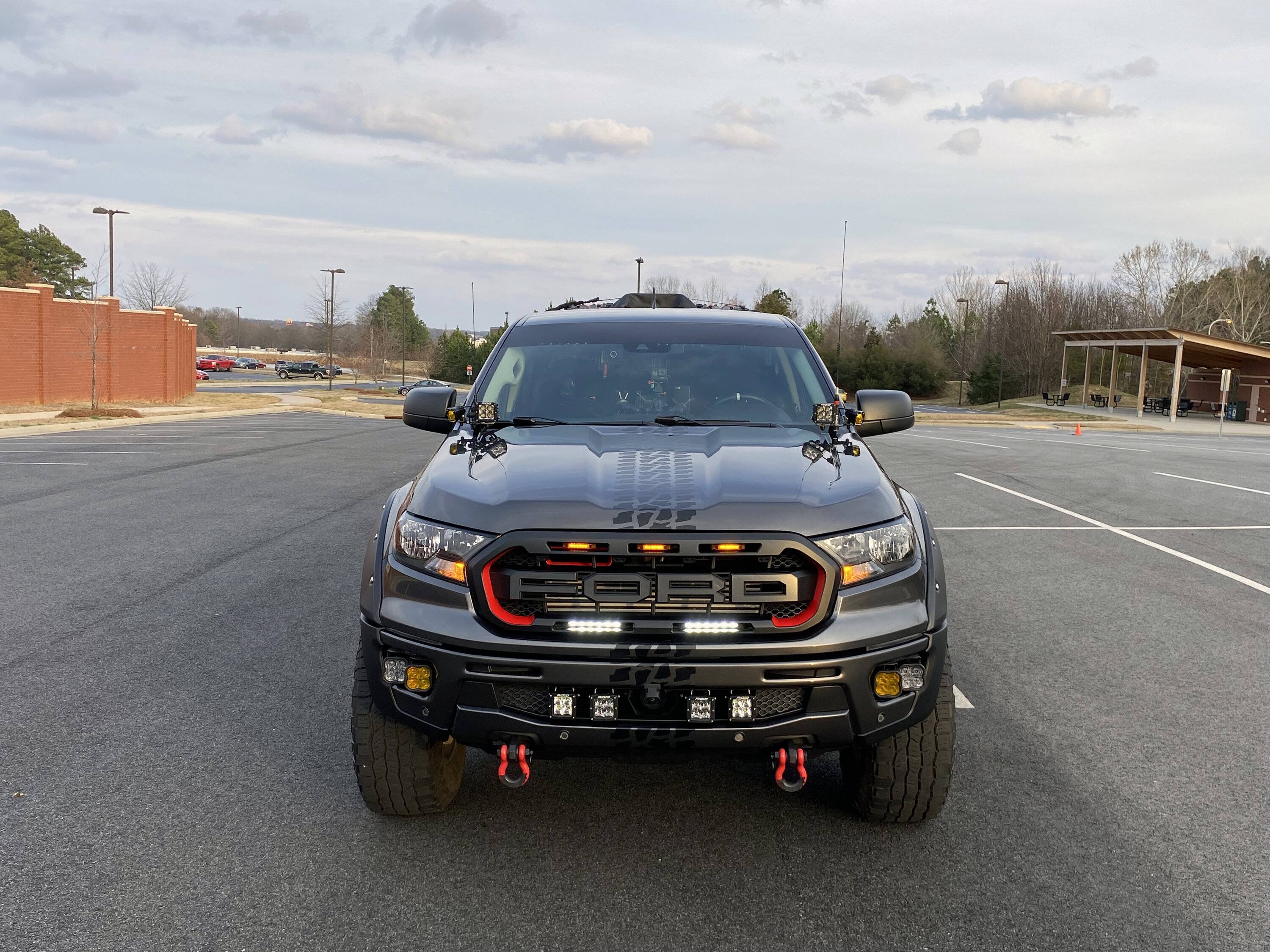

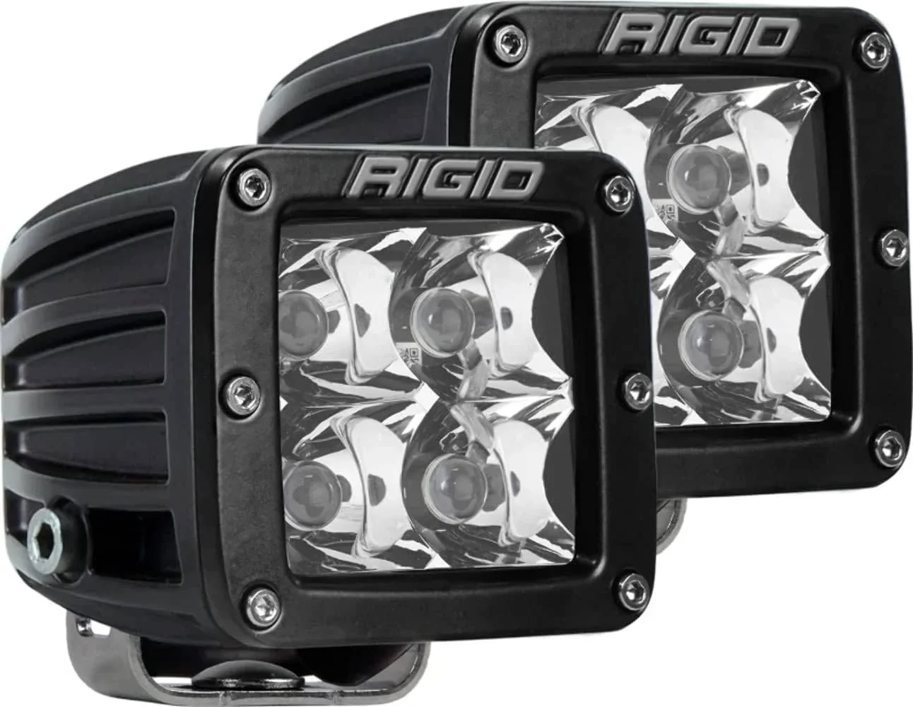

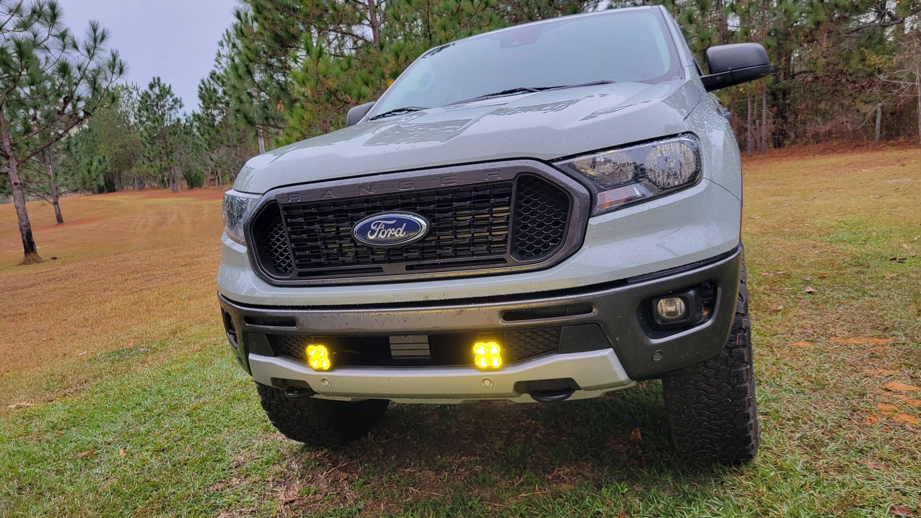

They're two pairs of Rigid D-Series Pro...spot and flood...the holes I mounted them to already exist on the top side of the bumper grill opening (covered by plastic plugs)...

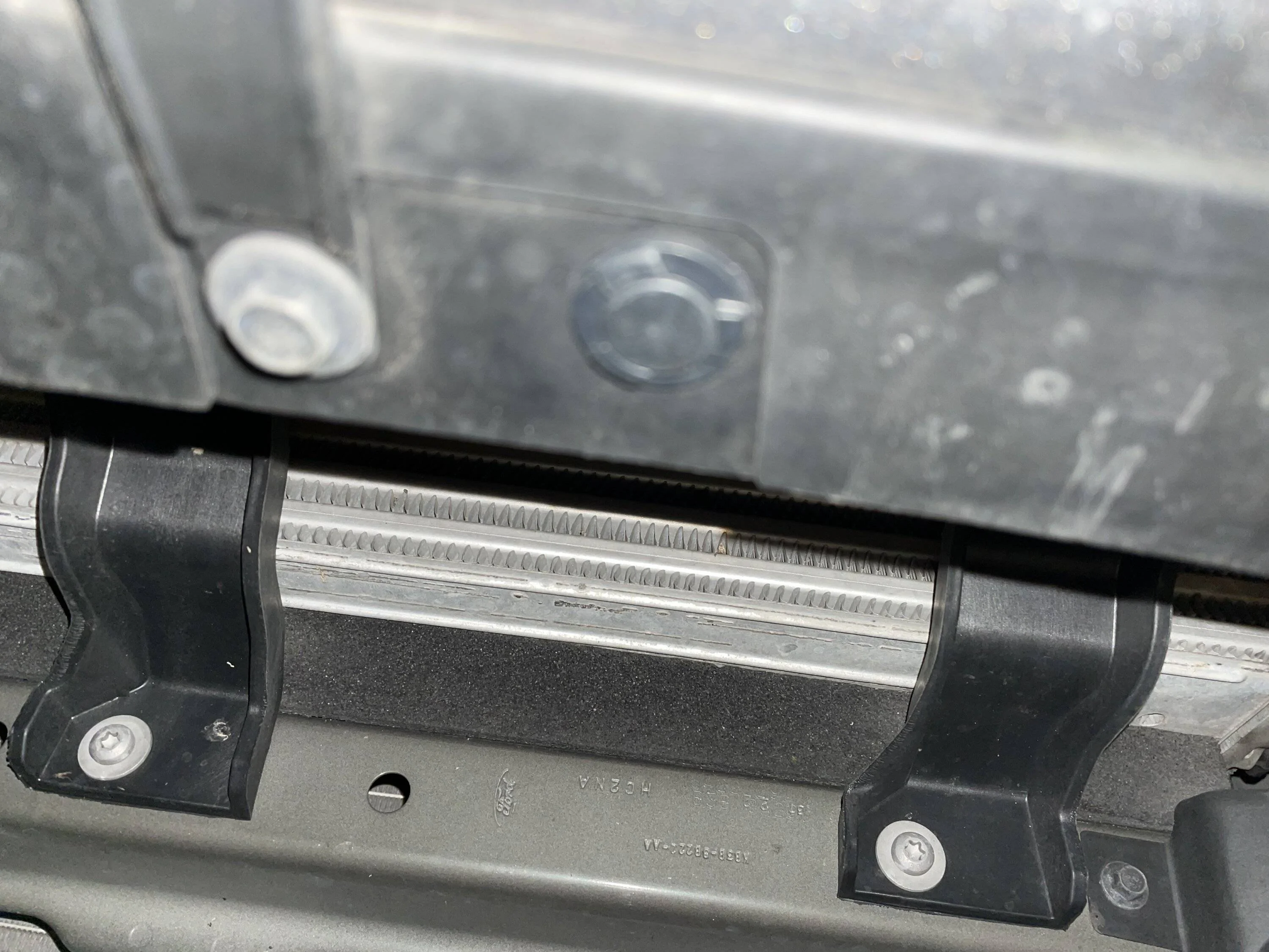

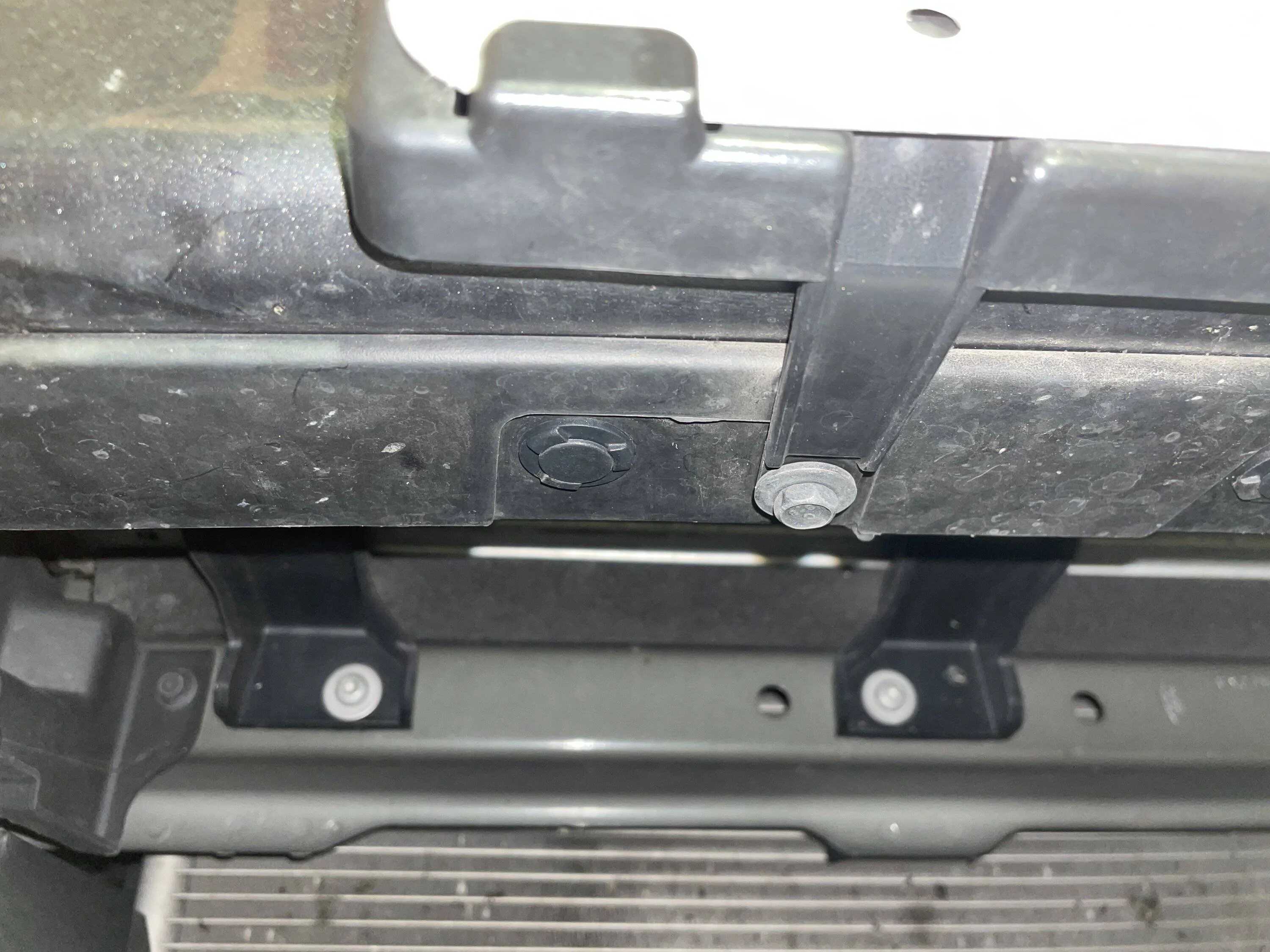

So the holes in the top side of the bumper? Was there like four of them and you just popped them out? Looking to install light bar.
That's what I used. I just popped out the 2 outside plugs.
