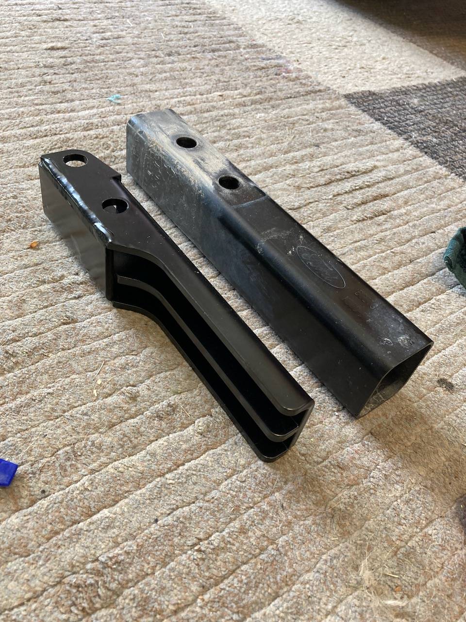

Can't answer it exactly since I did loosen the front bumper.
However, here is a picture of the Readylift next to the stock bar.
As you can see the stock bar goes farther into the receiver tube so I am fairly sure you can fit them with the bumper in place.

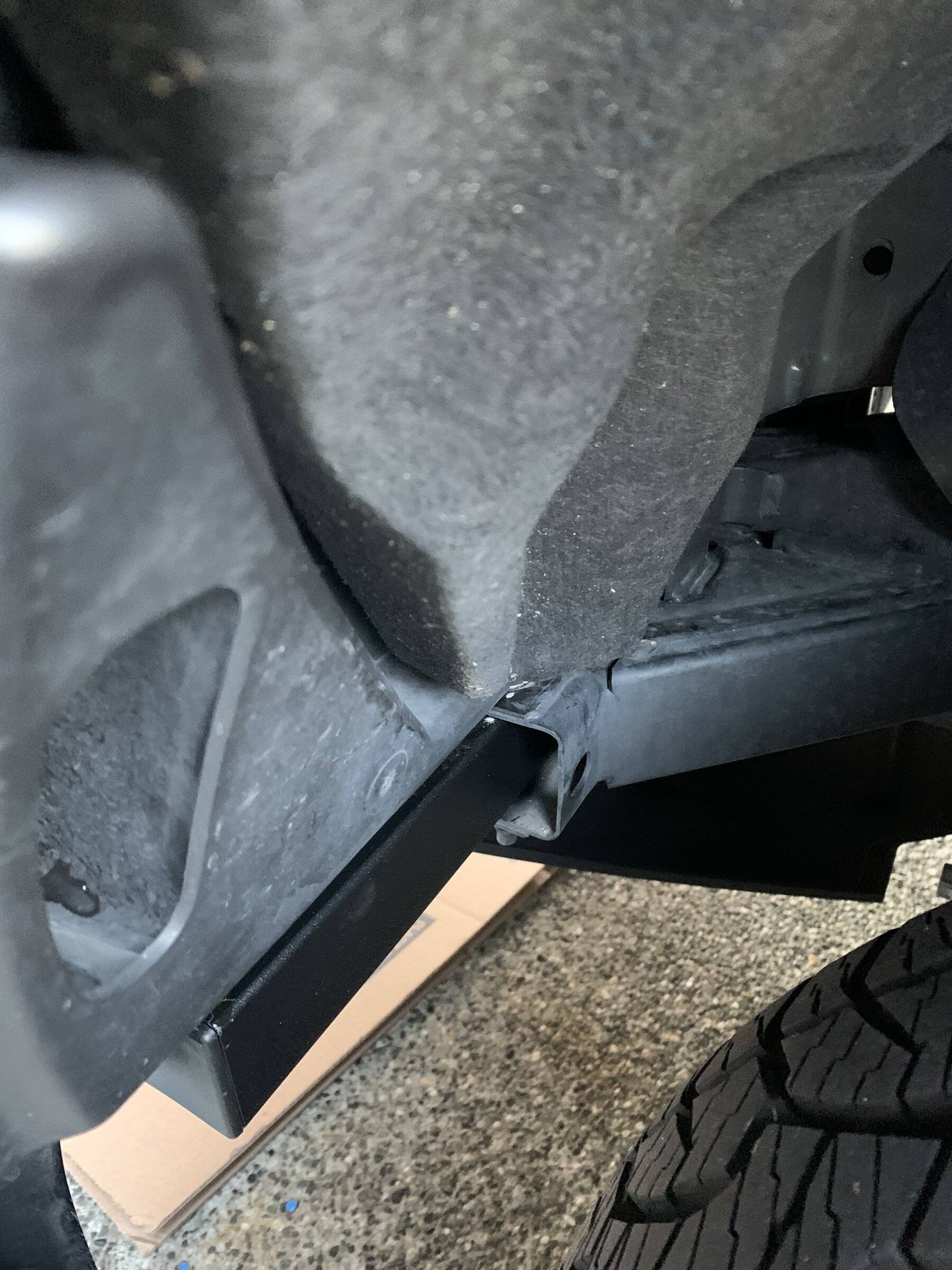

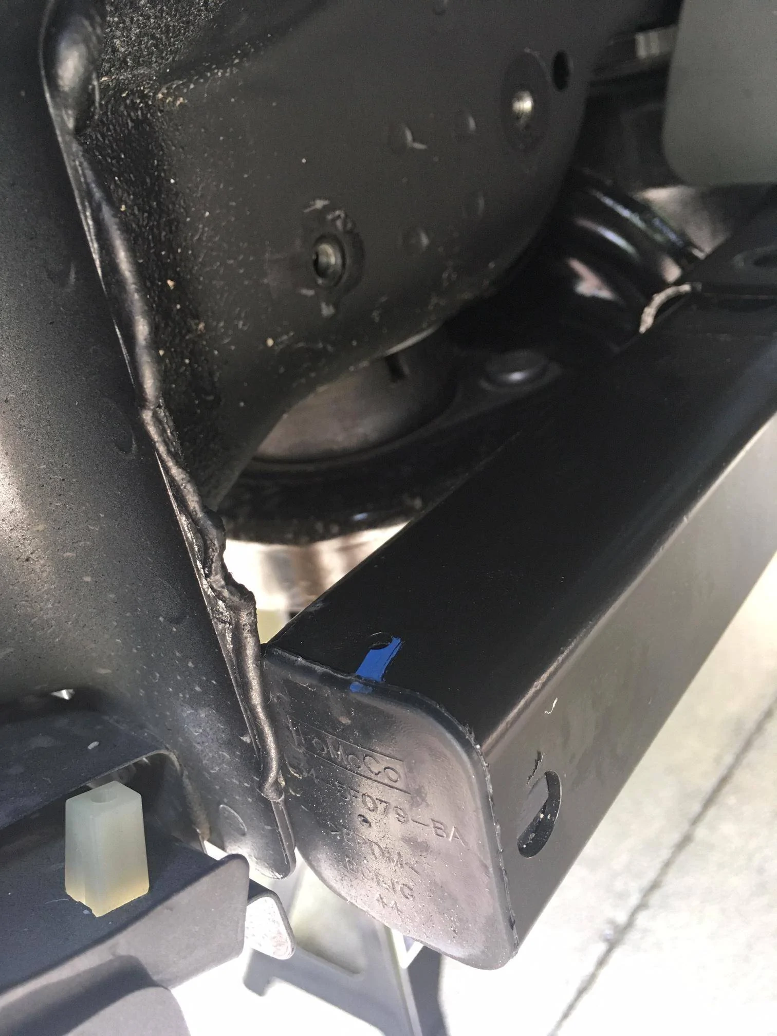

Remove lower fender torx bolt (from bottom) and pull fender out/rearwards just enough to allow the rear bar to clear...the photo shows that there isn't much stopping the bar from coming out...
I didn't even need to do that. Mine just slid right out.

It was definitely close but my bars didn’t have that plastic end cap so I was able to grab the bar end with pair of pliers and pull.
Yes it's super close...probably could've just forced the bar past the fender without loosening the fender... ?
Thanks for the picture reference ?
