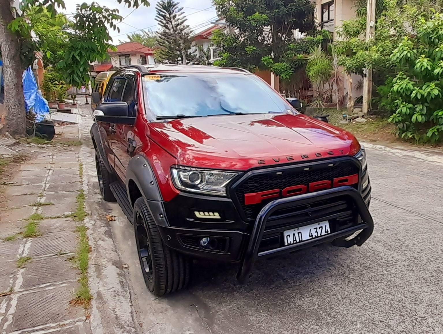

We have one on the Ranger SUV. It doesn't interfere with any sensors.

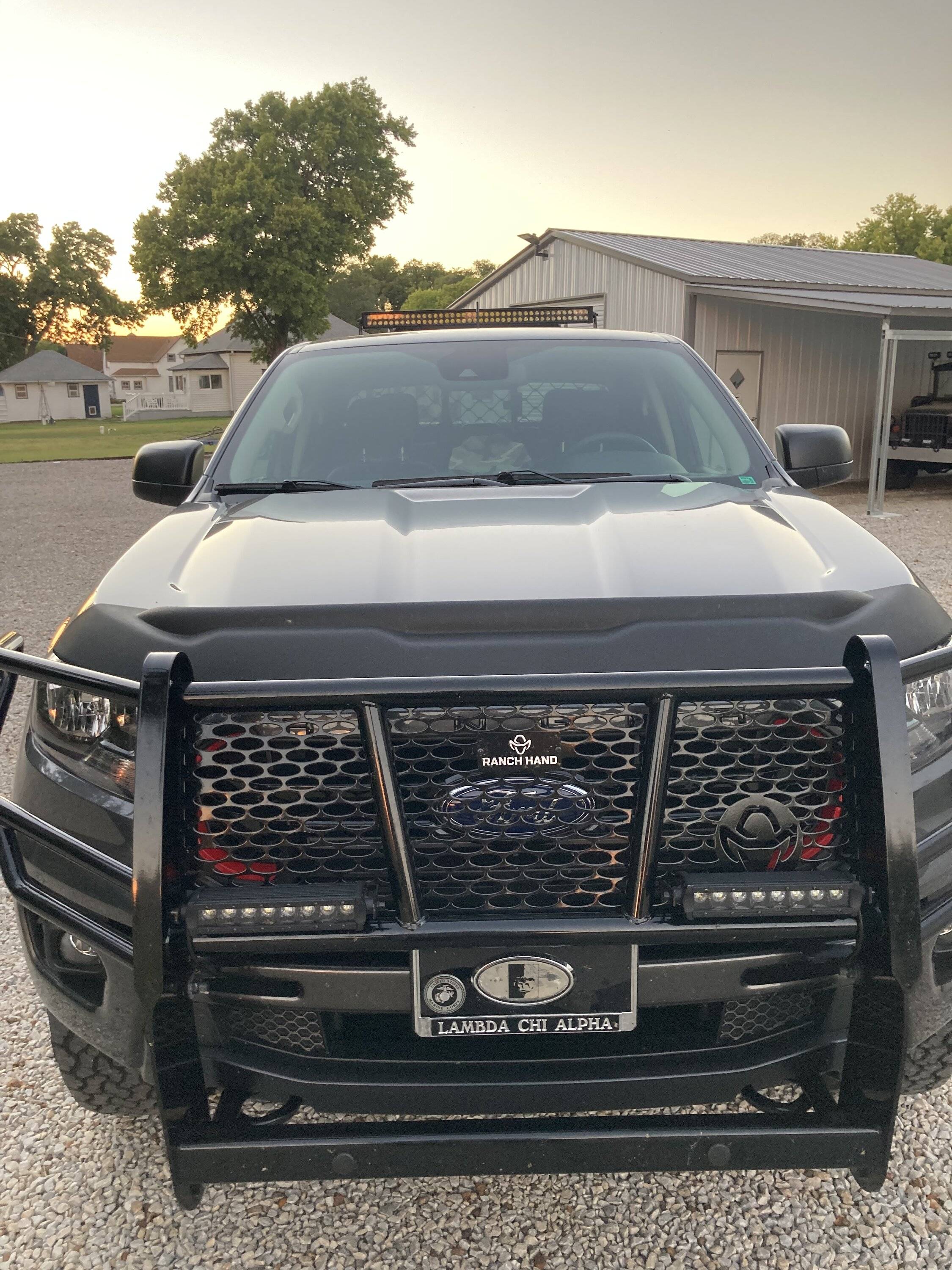

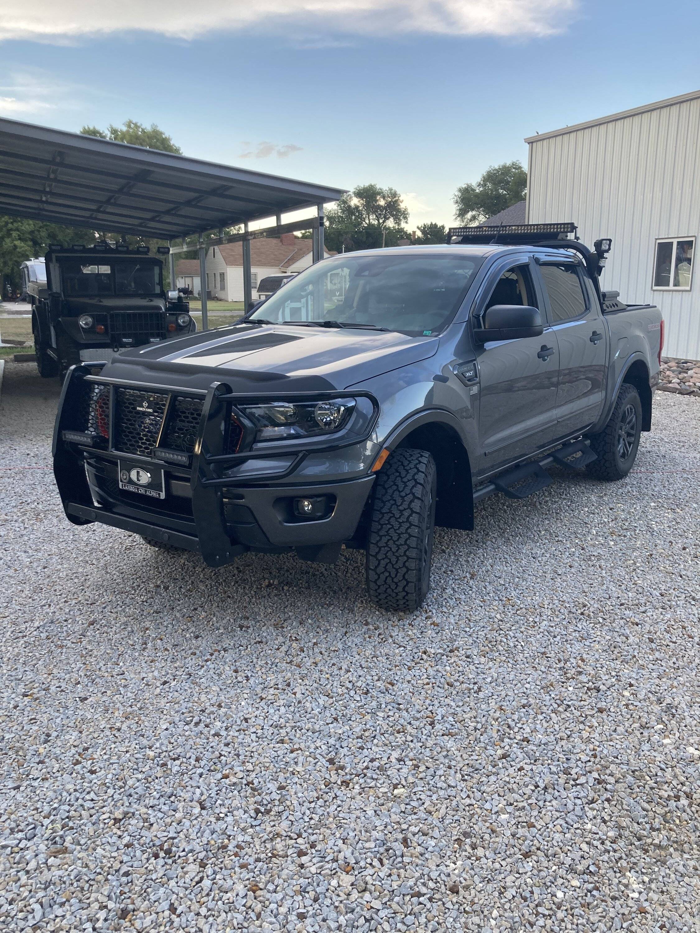

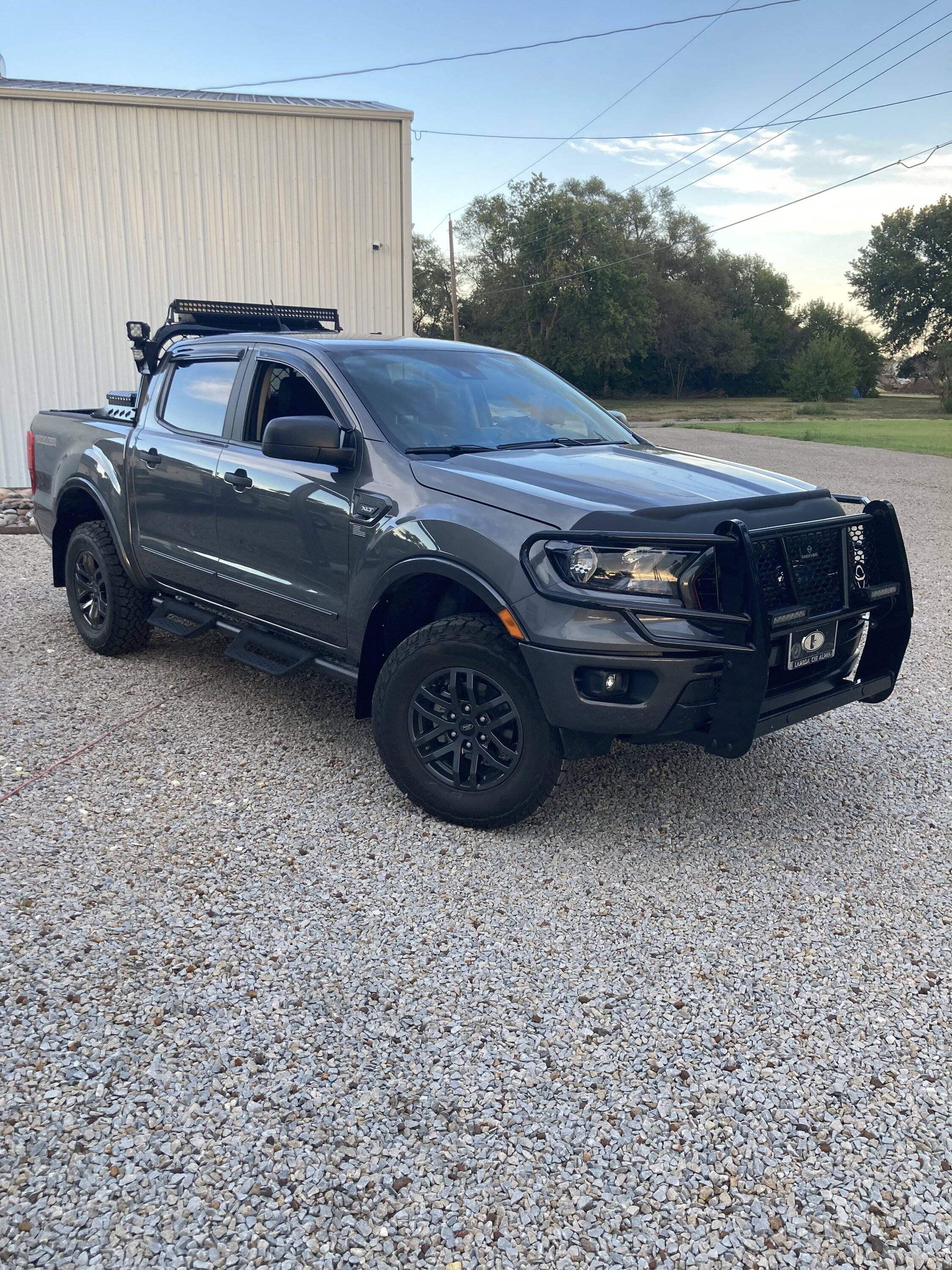

From reply to another thread. 2022 tremor, Ranch Hand, with relocation bracket for sensors.

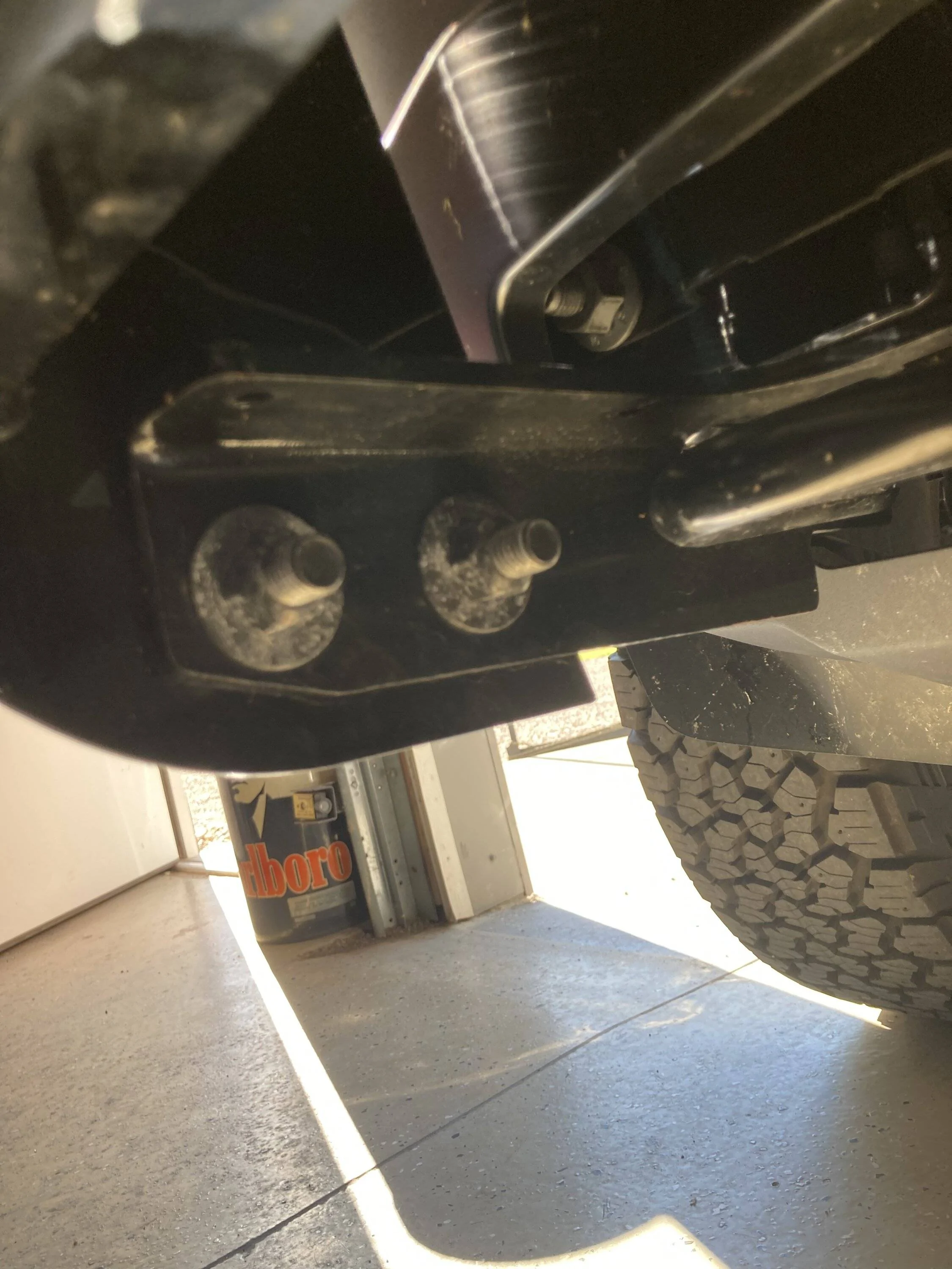

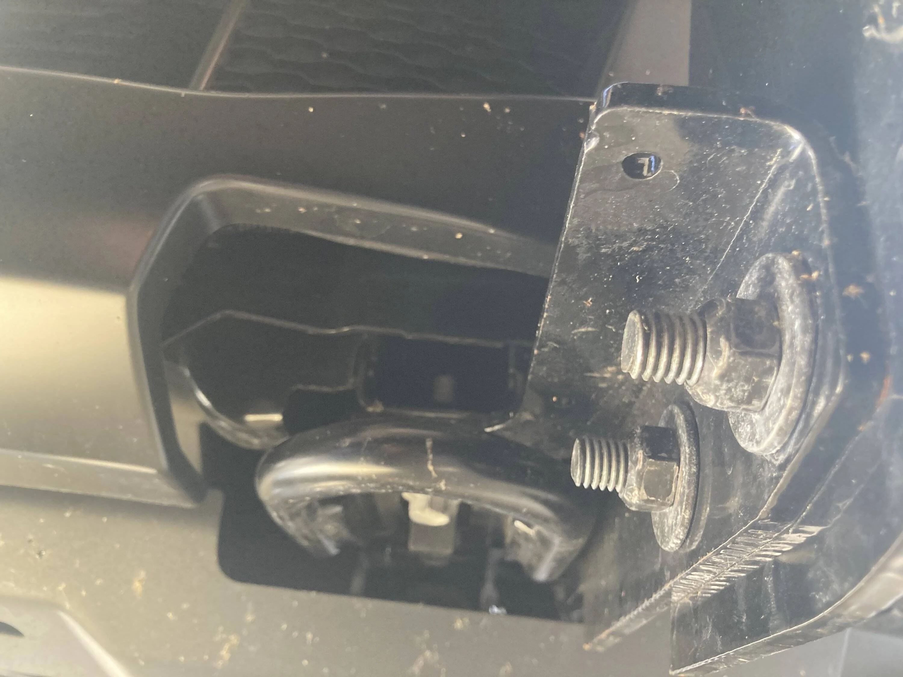

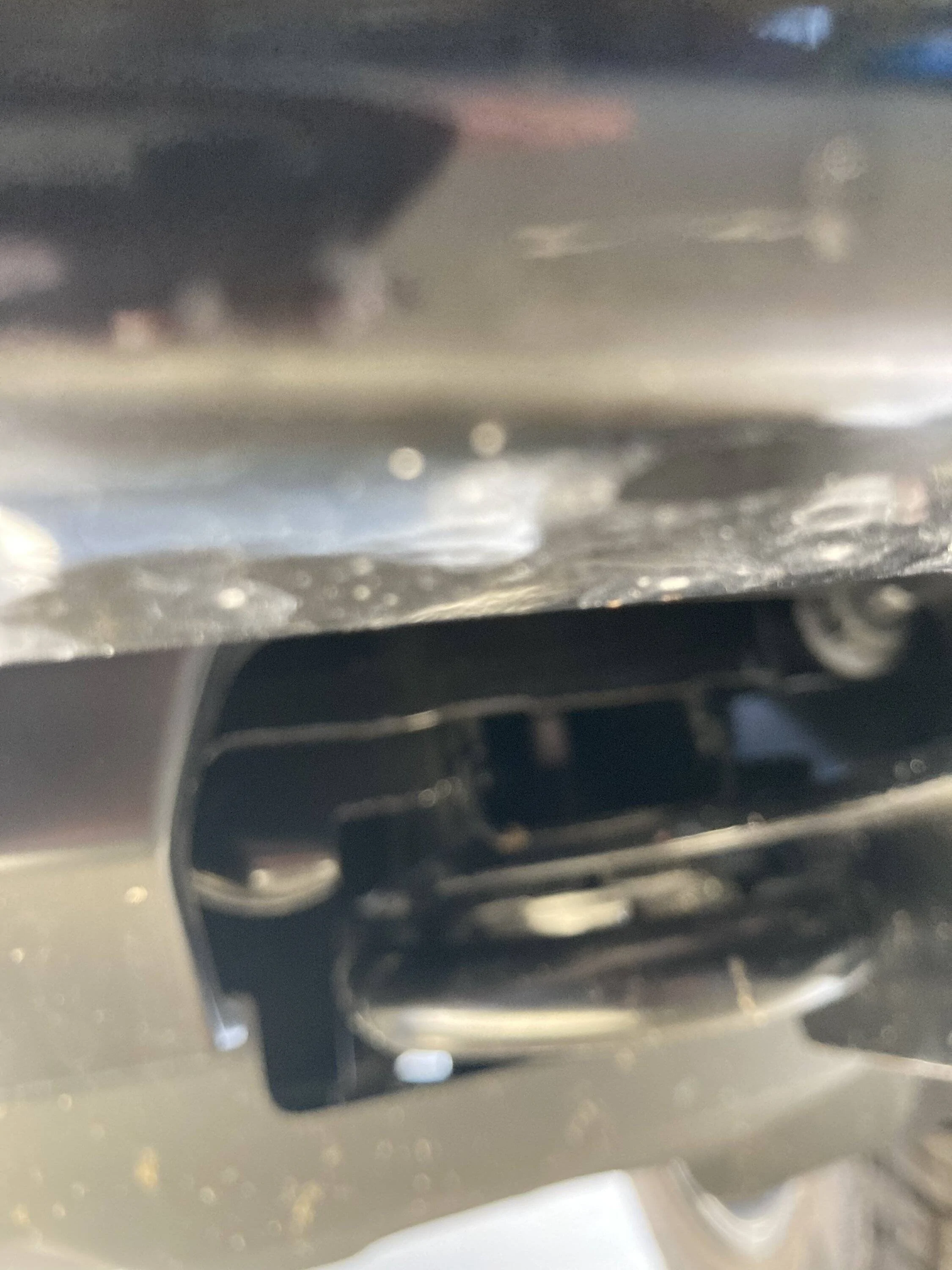

Pics and mounting, no cutting of skid plate, brackets/bolts use existing holes in frame
