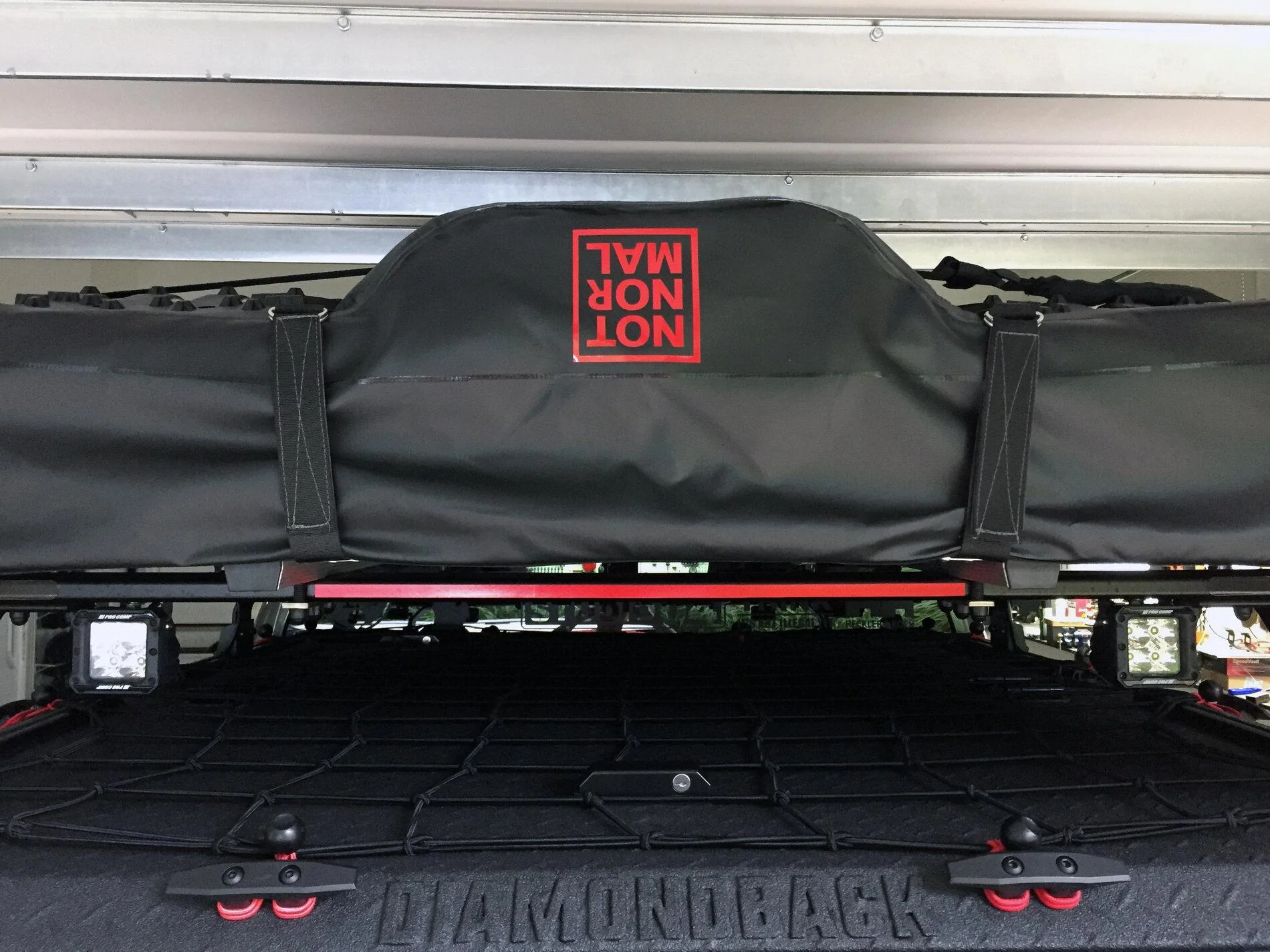

Another step closer...got my "Last Line of Defense" style Front Runner racks mounted to the Diamondback...without the RTT loaded, both hatch open normally:)
Looks awesome! which diamondback cover did you go with?

Funny you say that...the next time I take off the RTT, I'll be able to open the Diamondback and route line for new CHMSL LEDs on the load bar... ?
