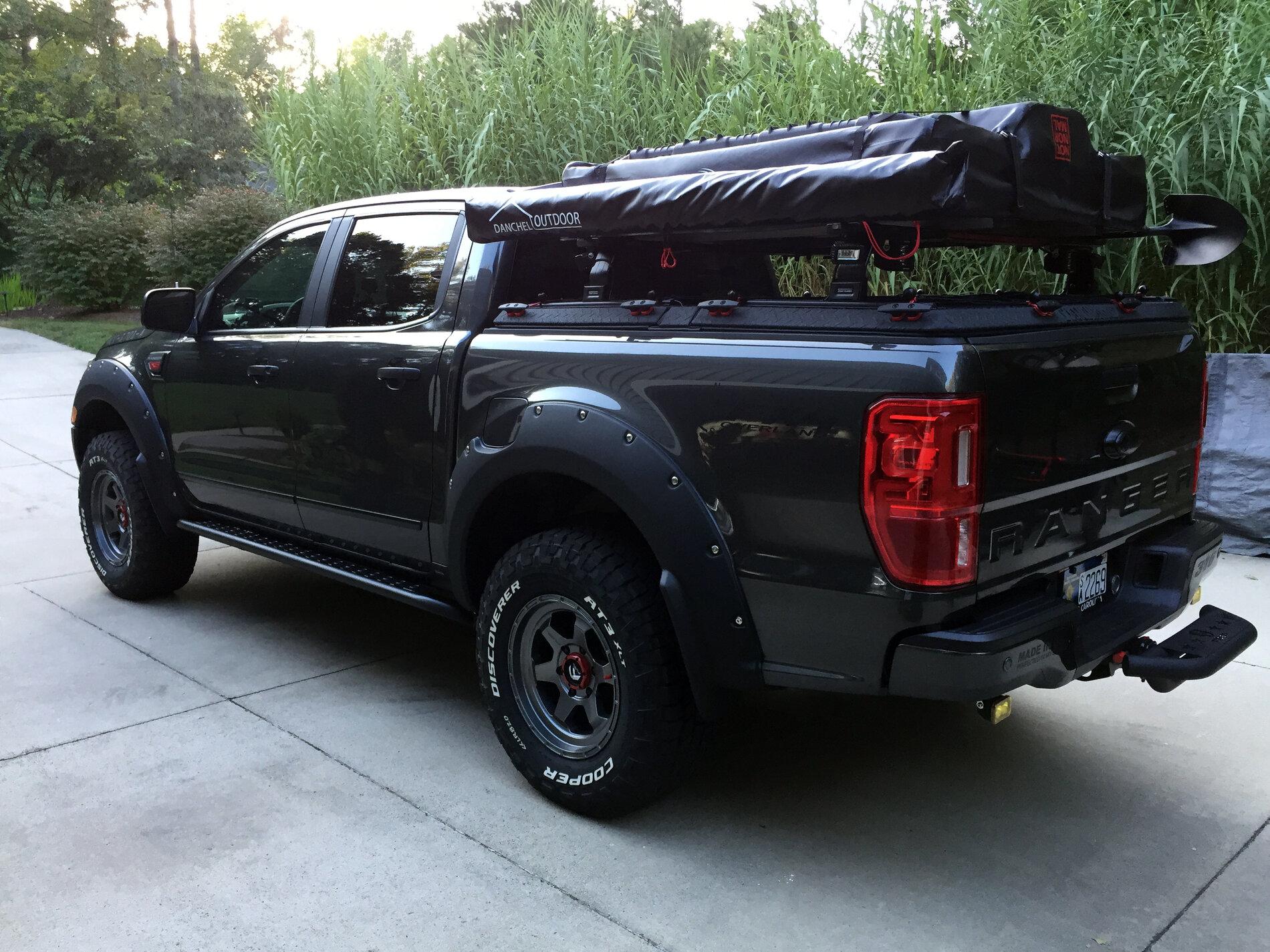

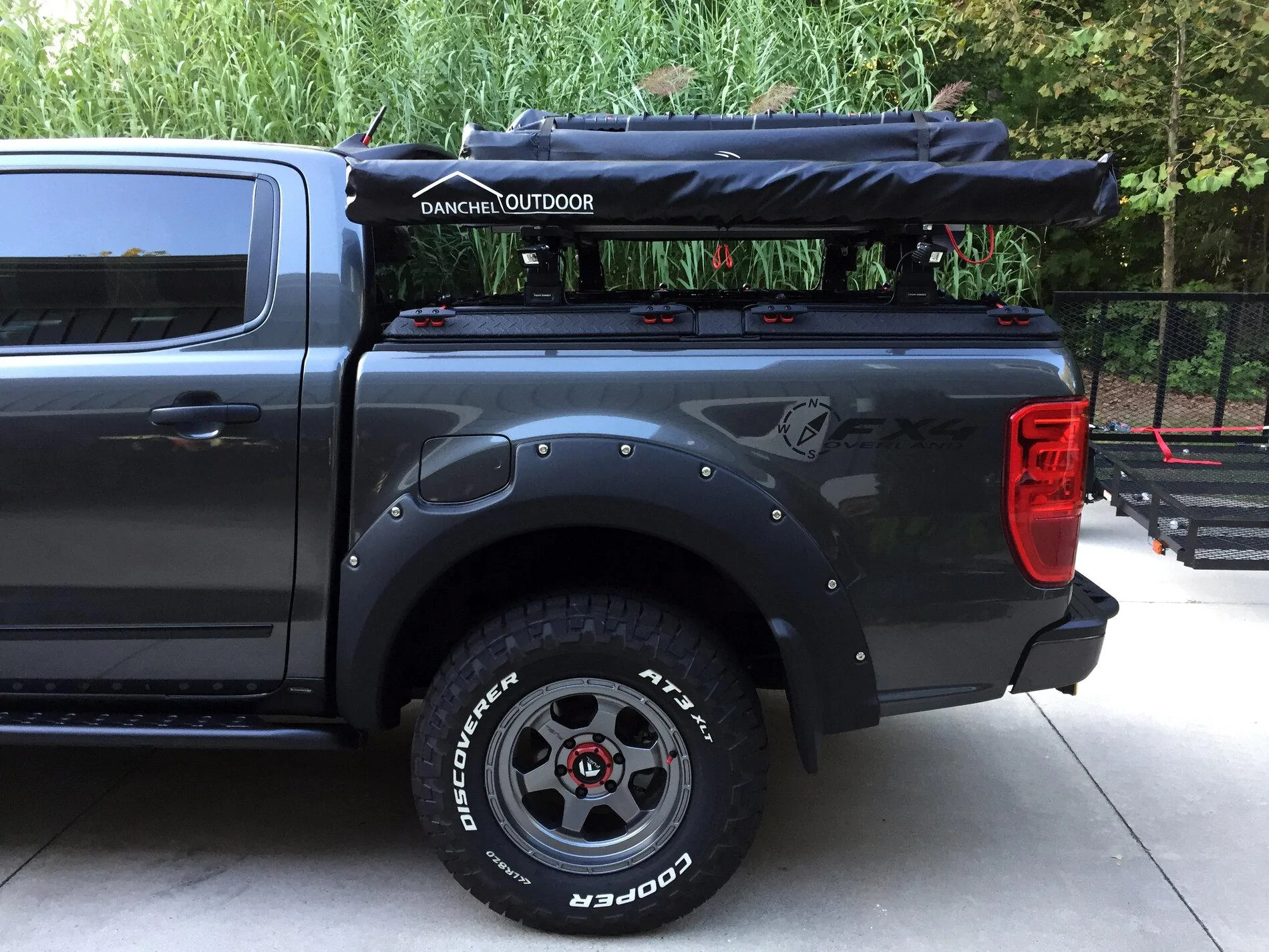

5x8 awning mounted...wanted a brand name but none of them makes one in this dimension...this Amazon deal is better than I thought and saved a few bucks...

Now the stance is right...added four 1.25" spacers to each corner to fill out the Air Design 2" flare extensions...starting from +55 to +20 wheel offset added 1.4" to each side adding around 2.5" total...now with this addition total gain is near 5.5" in track width......I should've started with a -12 wheel offset and not need the spacers but I had no idea this would be where I end up ?
BTW...I found a third technique to torque front wheel spacer while they're up in the air...first is have someone hold the brakes...second is the pry bar through studs against the floor...my method was to put the truck into 4 low...when I jacked one side to install/torque the spacers, the hub is locked by they other wheel on the ground... :)

Another step closer...got my "Last Line of Defense" style Front Runner racks mounted to the Diamondback...without the RTT loaded, both hatch open normally:)

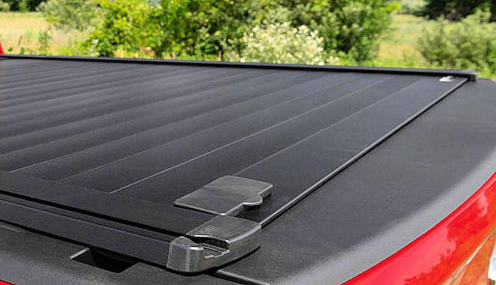

I agree. I asked because was wondering in case the bar had to be fixed only in one position and the posts had to be a specific spot on the bar. Not knowing exactly the width on the tracks I showed you for different brands. Some companies don't specify which trucks like one says mid-size pickups or full size pickups. Follow? So my concern should be as long as they are not wider than the body and can slide to 'be centered' as you mention.
Just got to figure what brands are compatible with tracks or have adapters.... :)

The Front Runner bars have a single slot the whole length of the span (top and bottom) with a couple of enlarged slot to allow the bolt head to drop in and slide to any position you prefer...

Yep, but the ones I showed you are actually part of the retractable cover. So no extra parts. Check that link I sent you. I'm working on something with Putco...
