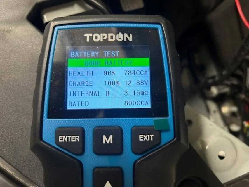

Most newer battery tester are now non load testing type, and they provide tests results such as this:
Just hook directly to the battery posts, with the design of the (BMFL) it is somewhat a challenge to get a perfect connection without disconnecting the battery cables., so you just hook up for the initial test and get a baseline reading, then all future tests you have a comparison to use.
These testers are not the greatest as they are under a $100, but they do provide a good reference point for battery health.
