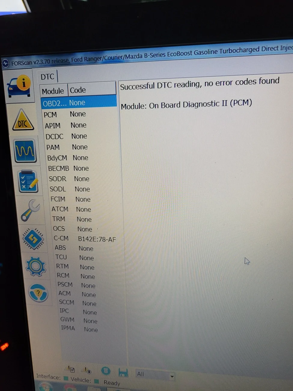

I would clear the codes and see what comes back, since you have had battery disconnect and or connectors and fuses pulled.
and then run the calibration for the (CCM) as that is what the code is (for the CCM) but ensure its vertically leveled as I posted above using a combo square
The Vertical (Alignment) is a manual adjustment
The Horizontals (Calibration) must be done with the scan tool or Forscan
After clearing all codes and recalibration - post any remaining codes

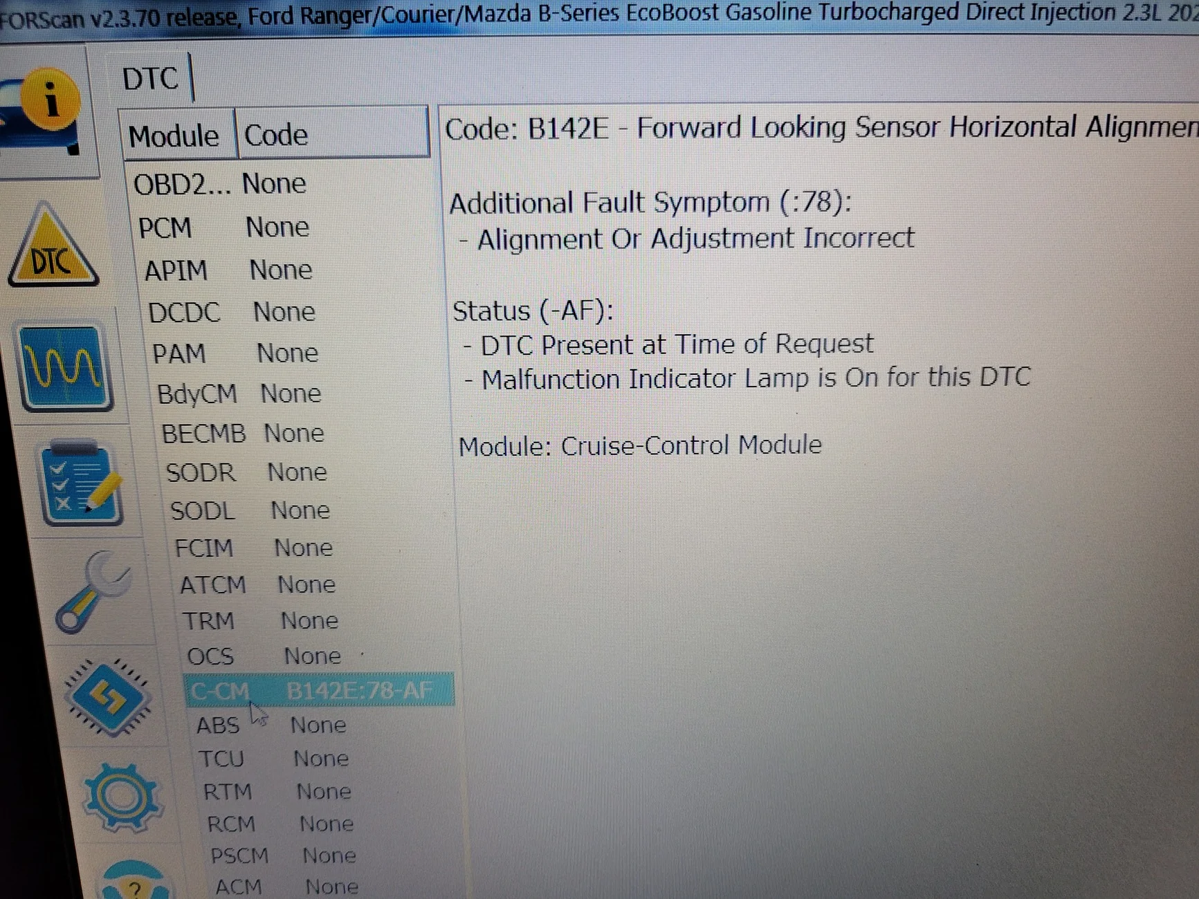

I got a complete readout this morning.
That is indicating that the CCM needs alignment in the horizontal plane.
B142E:78 Forward Looking Sensor Horizontal Alignment: Alignment or Adjustment Incorrect

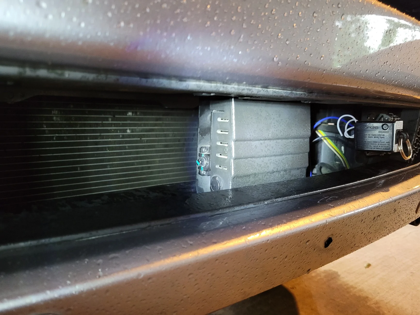

Looks like this newest scan verifies the alignment issue? My levels are all too large. Cant really see how to use even a smal one there. The front cover is terraced. The cover cant be open without removing the module from the pegs, and nothing behind the box. Ill figure it out.

Here's what I have to work with. No flat surface on front. Gonna get a small level like the one in the pic and fiddle with it. One turn at a time I guess.

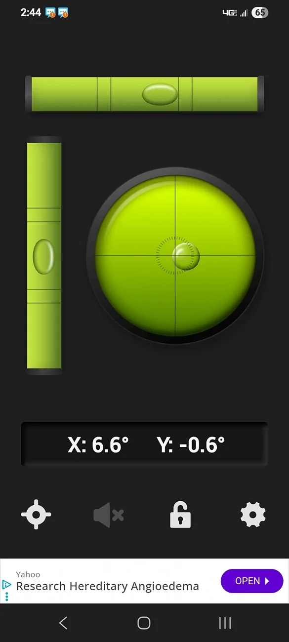

Now, I do have this. Pressed tight against the 3 terraces and turned the screw until it came to 0 on level. If this didnt work ill get a small level.
The code that you have indicates horizontal (left-right) misalignment. The level is used for vertical (up-down) alignment. I would try the horizontal alignment, (level not used for this one).
Well duh. I just noticed the unit moving up and down as I turned the setting screw. I remember one of the codes mentioned something about sensors, right side. Ill check that next.

Noted that the module beside the CCM - (MAY) be in the line of sight for the CCM, so after the calibration and it still gives you issues. May be something to look into moving farther away

But has this module always been mounted in this exact location?
I am only pointing out (a possible) that it may be clipping the line of sight (Horizontal)

Was the module (flat towing?) installed recently? Possibly it is interfering with the CCM radar view of the road. You may have to move it farther away from the CCM.

I would unmount that device at the driver's side of the CCM and place it inside the bumper temporarily. Clear the CCM code and test drive it to see if the code comes back. If it doesn't come back, the device will have to be mounted farther away from the CCM.
