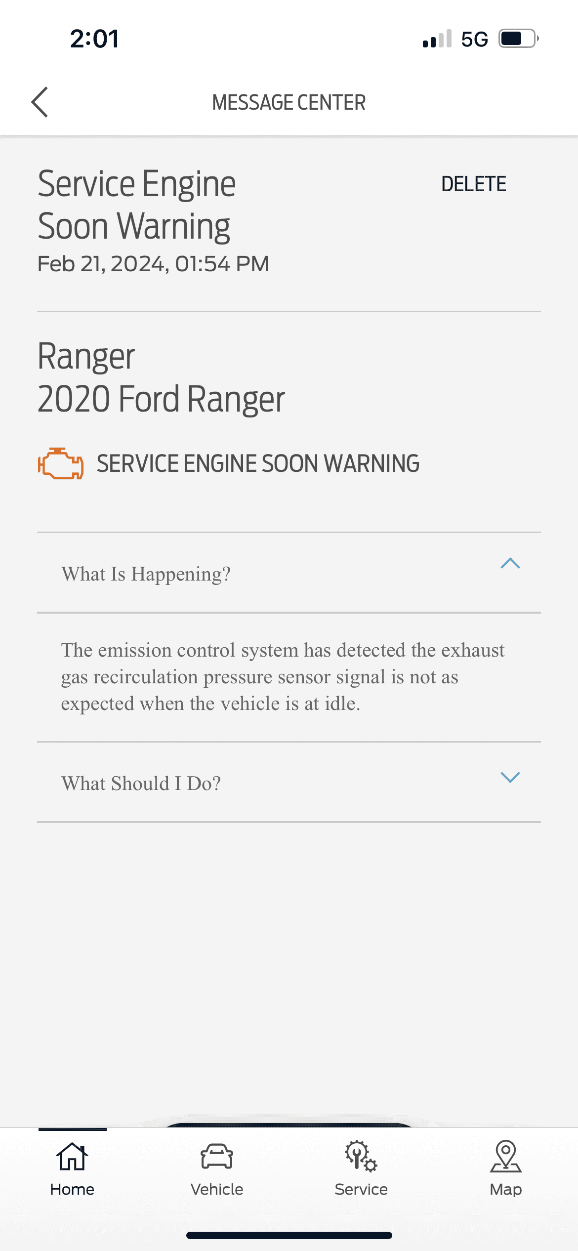

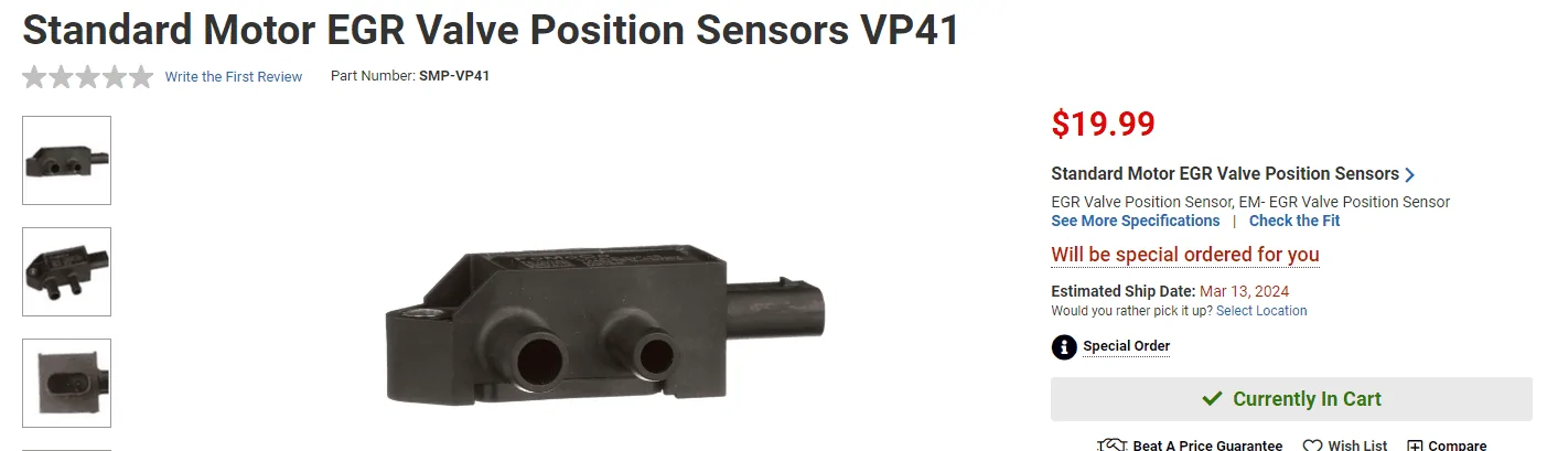

I’m a little confused. Is it the DPDE sensor or the or the EGR Balve position sensor because those parts look totally different on eBay motors
Stevedbvik1
Oct 4, 2021
2,898
8,779
2022 Ranger Tremor XLT
DPFE sensor ( differential pressure feedback sensor)
