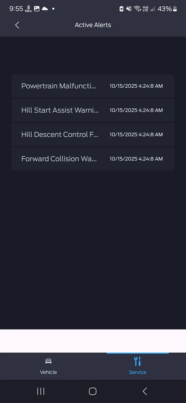

Ranger has been sitting at the airport for 2 weeks, when I fired her up I've been getting these non stop, tried cleaning the radar and camera to no avail. Anyone had similar issues or thoughts on what it could be?

Look for rodent damage

You will need to get the DTC codes read to begin any troubleshooting.

Mine did this once and I could never figure out what happened. Hasn’t happened since 🤷‍♂️

somewhat related my wife's Landrover hadn't been driven in just a few days and went to pick her up in her car from the airport and had similar experience... the BMS as part of the system will cut off some pre-determined set of sensors and they fire off warnings if you just jump in.
Only way I've been able to defeat that is by keeping one of the small battery jumpers in the car the size of two cell phones... doesn't have to be expensive or large. Just enough to push 6000mah of power into the car battery. Starts up with zero warnings after sitting for 4+ days... well her Landrover anyways, never tested in on my Ranger how long it can go without a start up with zero issues?

I’m new in this group. From Norway and bought my first Raptor one month ago. A 2021 model with 145 000 km.
I have the same error messages, started just after I got the car. Popps upp nealy every day, sometimes with a few days apart. I also have an issue with the cruise control, it would not always set the speed. This often happens when the error message shows.
I had the car too the local dealer for diagnostic, but they didn’t find anything.
I wonder if this has to do with a bad connection. If drivers in som bumps the cruise control starts working.
Anyone with similar experience and suggestions about how to fix?

I changed the battery 14 days ago. The errors still occur so it didn't help.
Do i have to progam inn a new battery?
