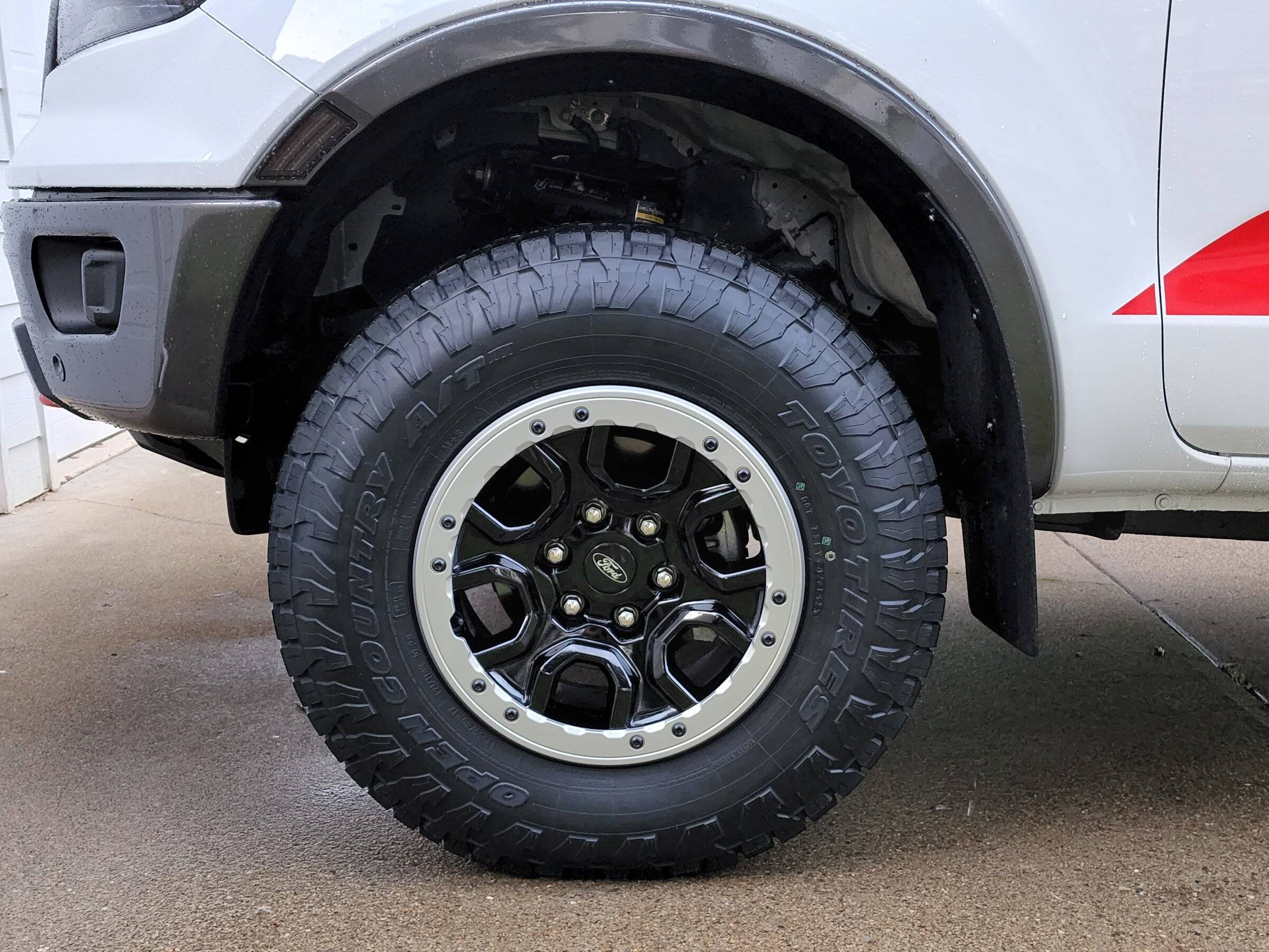

I have the Toyo ATIII. They are E rated. They are marginally heavier than the 265/70r17 C rated BFG I had before.
