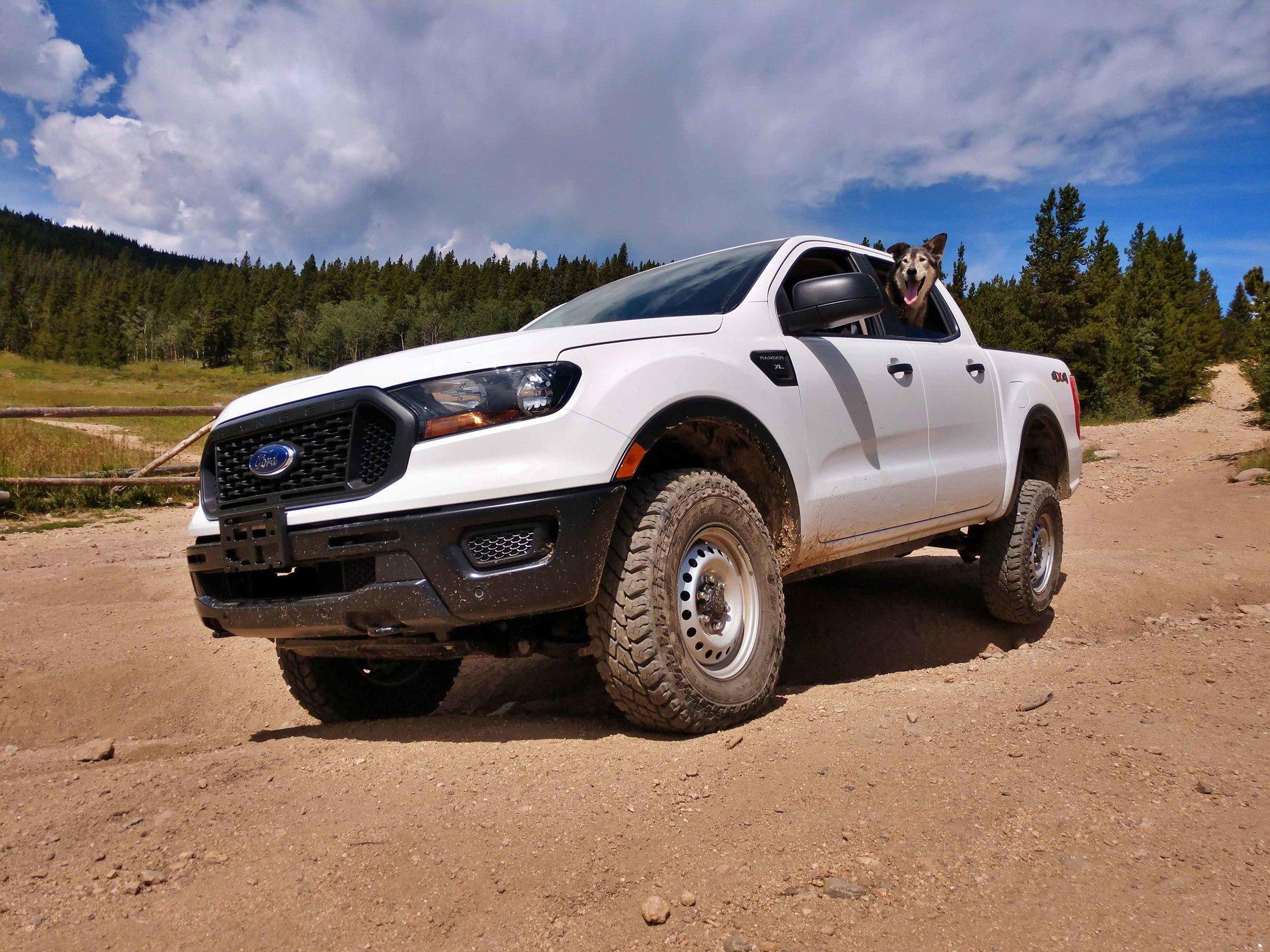

Hey Tom - I like the narrower tires also. My "summer" tires are 255/75R17, which are effectively 32.1 x 10. I just put on a winter set of studded Nokians that are 235/85R16 which are tad shorter and about an inch narrower, 31.7 x 9.3. The 235/80R17's are much narrower than 11", 235mm is approx 9.25", so they are the 17" equivalent to the 235/85's I use on my 16" rims.
My old FJ40 landcruiser used 33 x 9.5, those suckers were crazy pizza cutters and great in the snow too.
I haven'd had my truck in the snow and slop yet but have always used narrower tires in the winter on my Audis and have always had great luck. They track much better and don't get thrown around as much in the ruts.
The caveat is most tires in these sizes are Load Range E, so do have a stiffer ride. It didn't bother me, but some folks are put off by that.

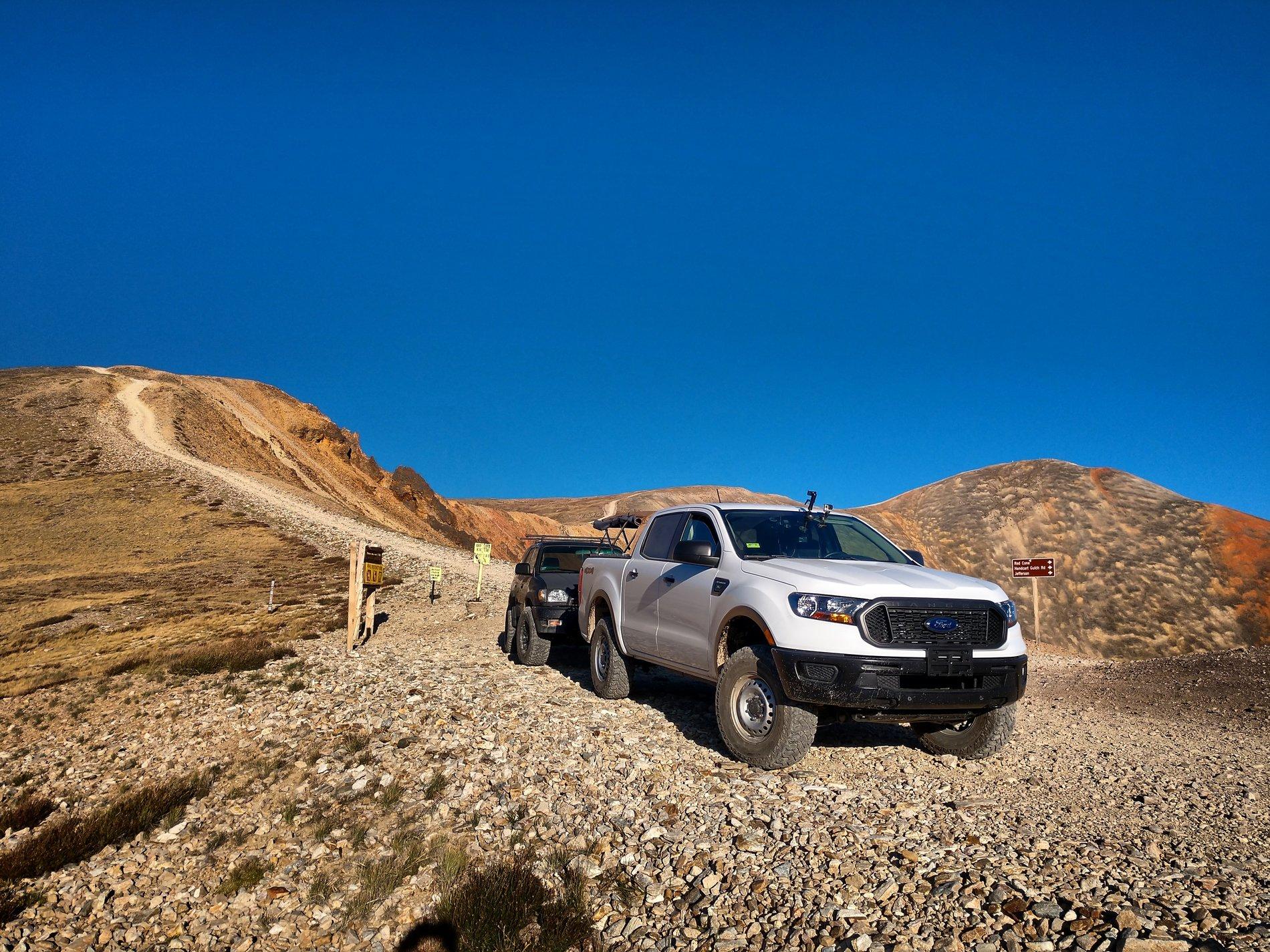

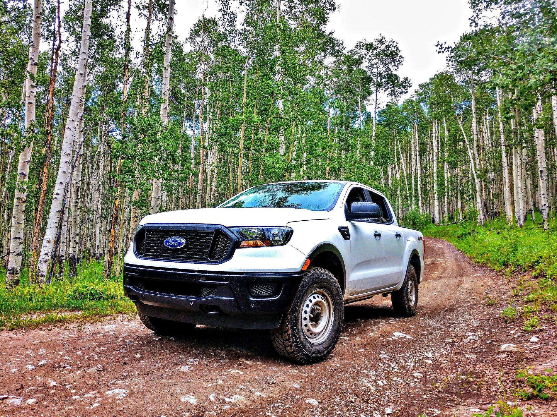

I ru 235/85 16 on the stock XL steels. (235 is about 9.25, not 11). I'm really happy with them and they perform great in the snow and in the rough. however, I do wish they were slightly taller, just for aesthetic purpose. so I'll probably switch to 255/85 at some point in the future.
also, if you were to go with a 235 tire, you don't want to run a wheel any wider than 7.5 inches maybe 8 at the widest.... this makes it pretty tough for finding aftermarket wheels....
even if you go with a 255/80 17, I would try and find something more narrow than 9.... it can be done, but if you're running low pressures in the dirt and over rocks a more narrow wheel would be much safer both for keeping the tire bead seated, and protecting the rim of the wheel.
ALSO, these are load range E tires, and they ride great. load range is not really going to affect your ride that much unless you are dramatically increasing the pressure as well. I run about 30psi in mine and they're just fine.

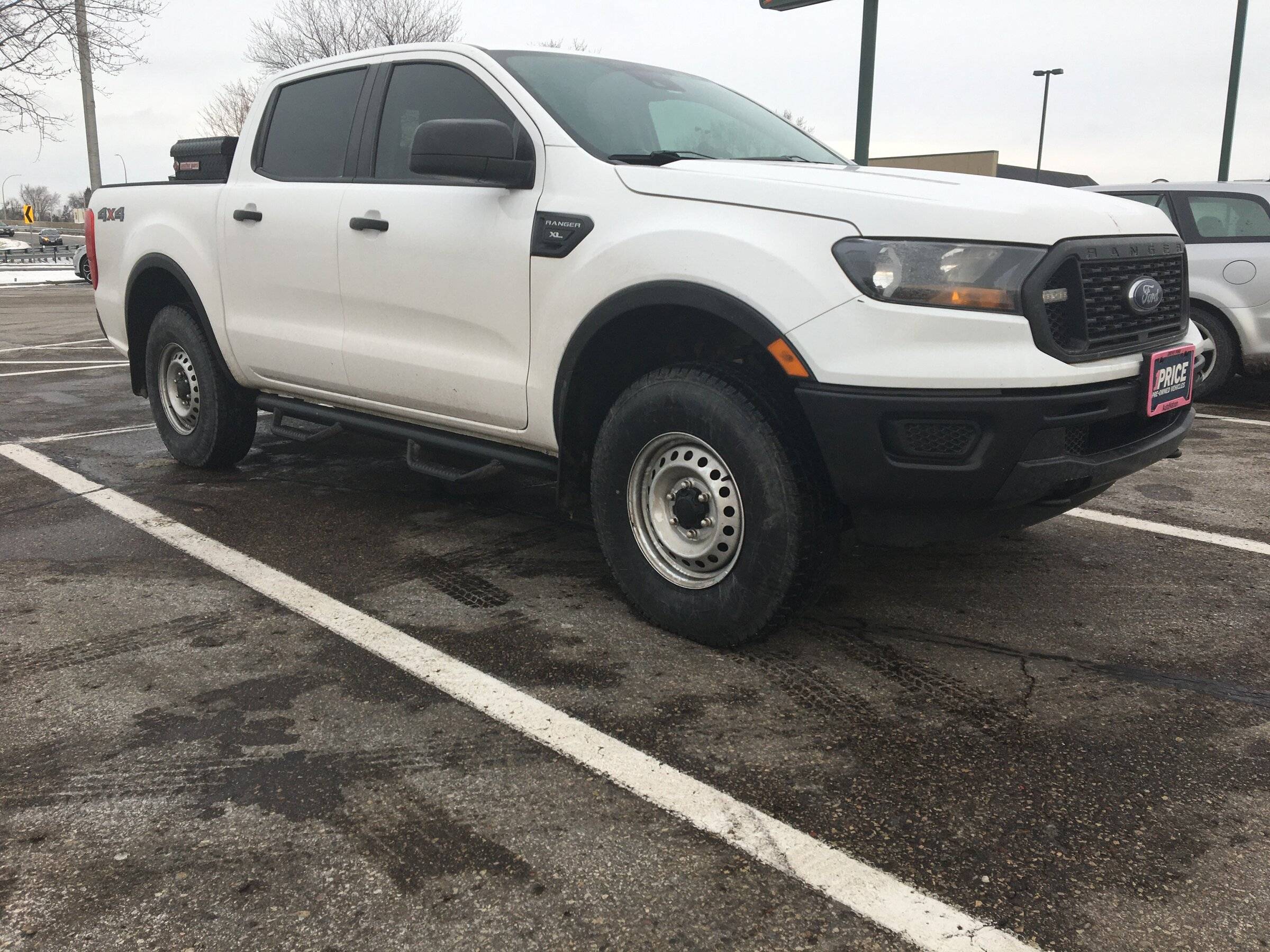

235/85 r16 Firestone winter force 32”.
Had them put in yesterday. I thought the 30psi would be sufficient but they look a bit low.

Is that 30 PSI what you run on a trail or street pressure? I just put 235/85r16 on mine and they "look" low at 30 psi. I'm seeing some people state they run this tire at 45-50 on tacomas.
How many miles do you have on the tires?
I typically run them closer to 34 ish, depending on how much weight I have in the truck.
On the trail I usually start around 18-20 psi.

from the photo, I don't think they look low, but if so, it's probably because they are winter tires. Those 'usually' have a softer sidewall which will be more likely to compress. you could try adding a little air, or just watch the treadwear, and temperature once it warms back up.
