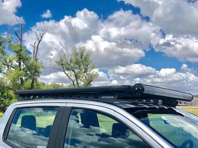

Rhino-Rack is coming out with a product shortly (in a few days they told me via email) called the Backbone mounting base. You will be able to put their Pioneer platform (or tray) on it. But from “how-to” videos I’ve watched on Youtube it seem like a job for professionals, as in lots of cutting (of molding), drilling, caulking, etc... since the Ranger doesn’t have the pre-drilled holes in the roof.

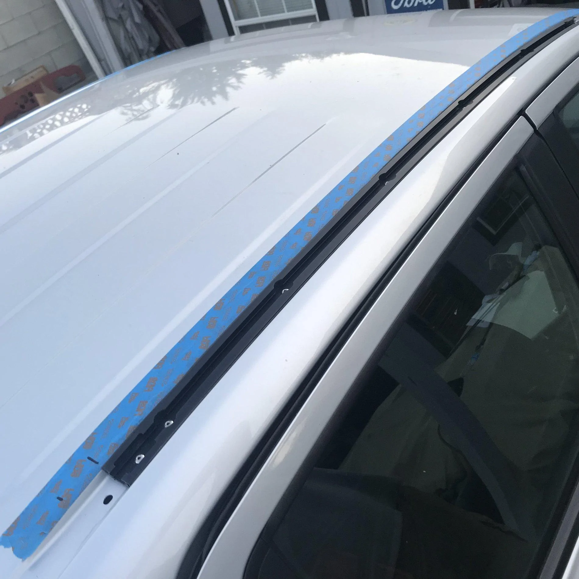

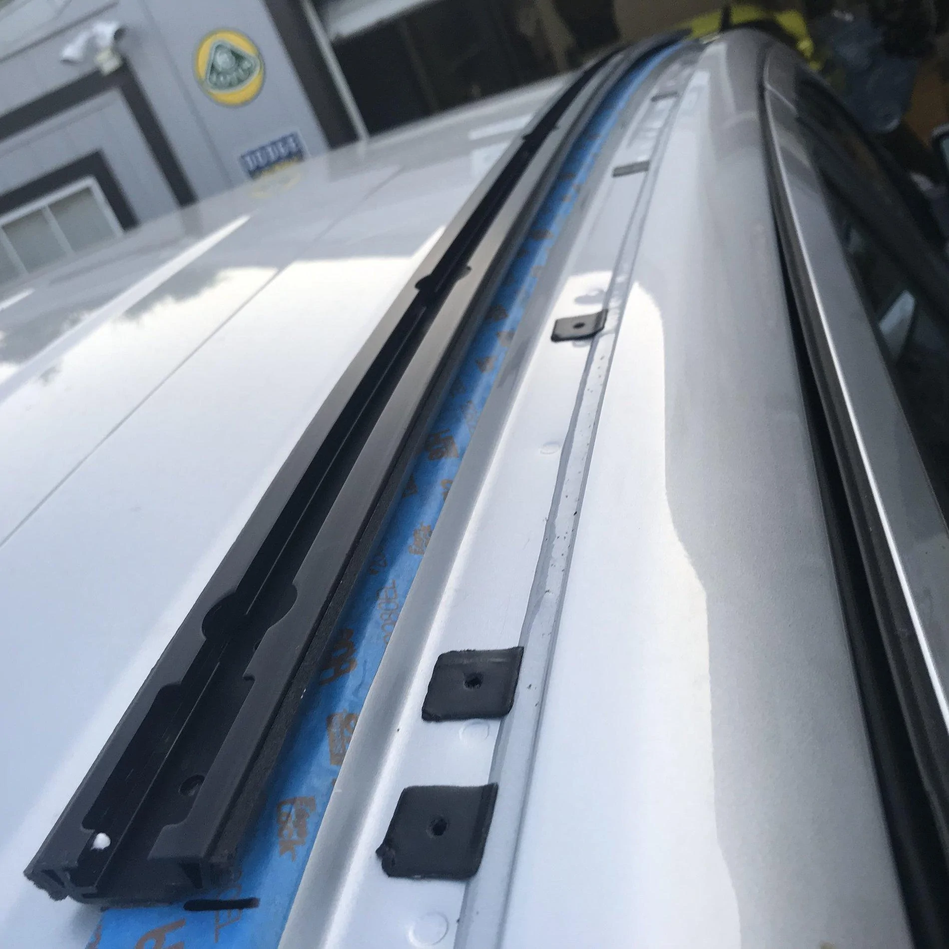

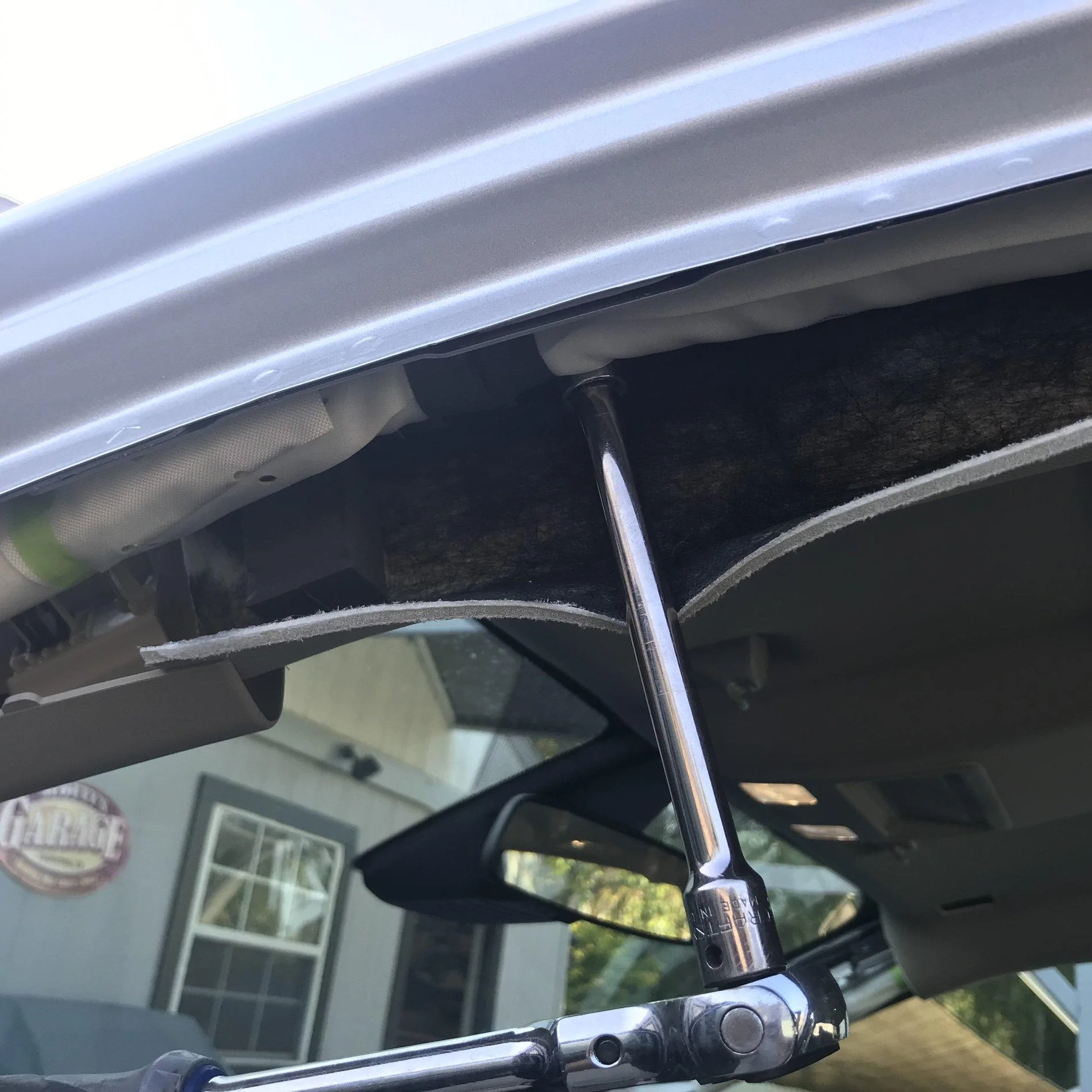

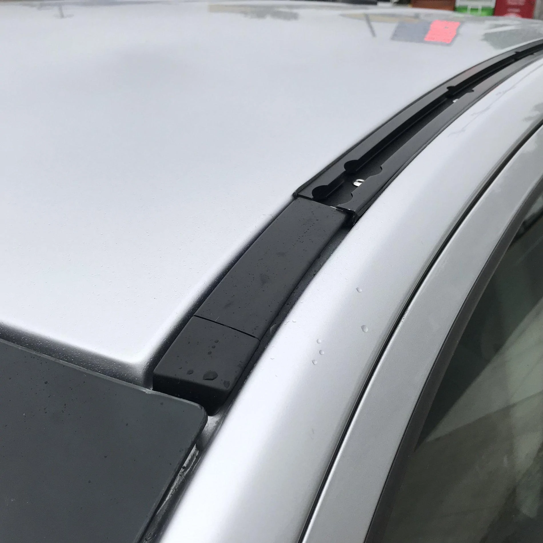

So.... there is one bolt or stud on the end of each aluminum trim piece that goes down through the roof on each end. These are attached with a nut which can be accessed by dropping the headliner... there is no threaded rivets or nutserts in the roof... I just installed the Rhino Rack and had to drill and rivet 16 holes (8) per side to make this work...
What’s the weight capacity for this setup??? And how long did the install take?? Looks great
not sure on weight capacity... took about 4 hours to install.... I'll get weight capacity specs...

Currently there is no permanent style track conversion for the US Ford Ranger but Rhino Racks is developing for release soon. If you have a Crew cab you can order through Rhino Racks Australia. I have an inquiry in to them at the moment for the Supercab...waiting for reply. Their system is a replacement track that allows you to install Yakima/Thule style towers that lock into place, otherwise you can go with an aircraft door style clamp on...not my choice though.
