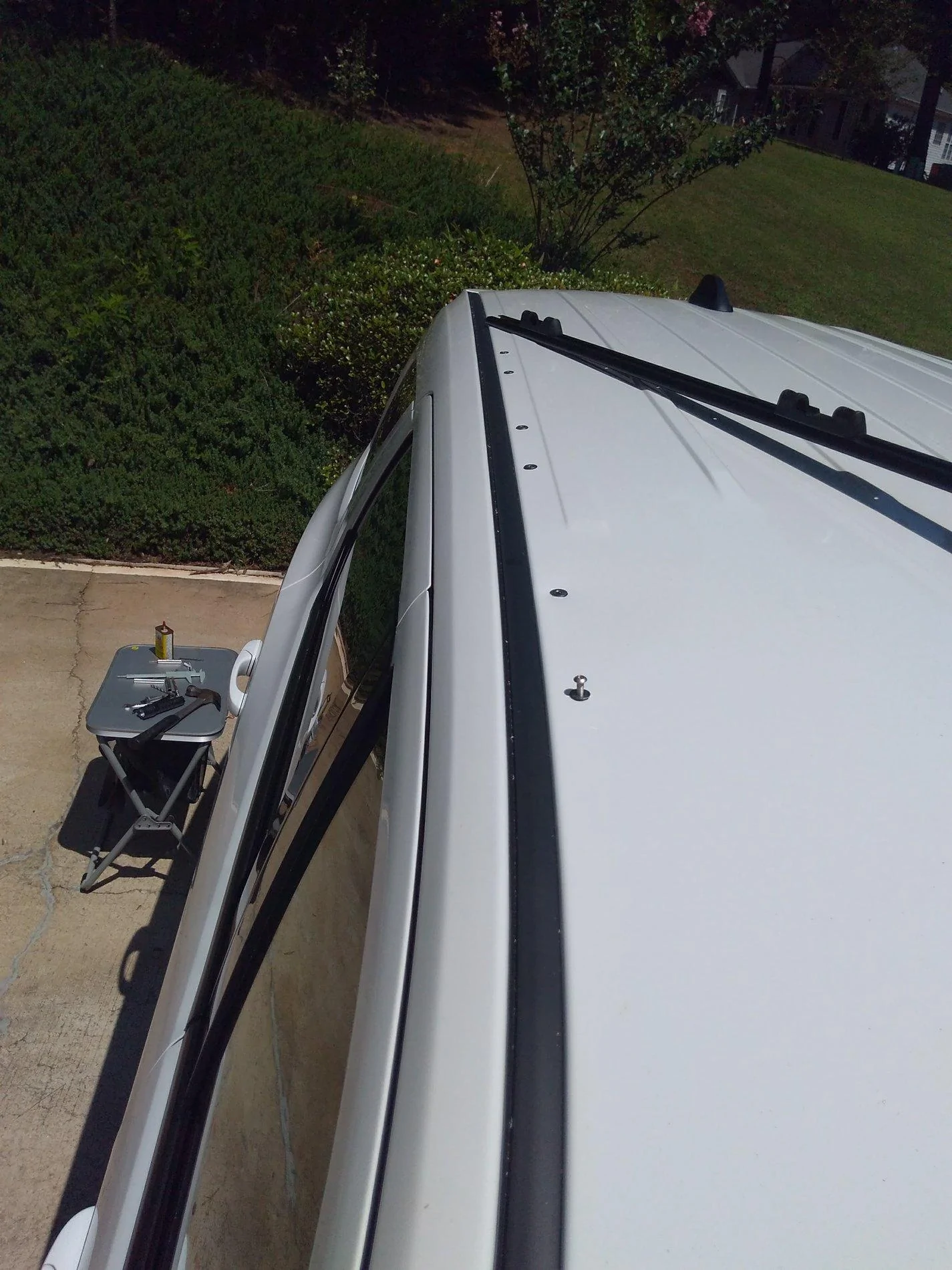

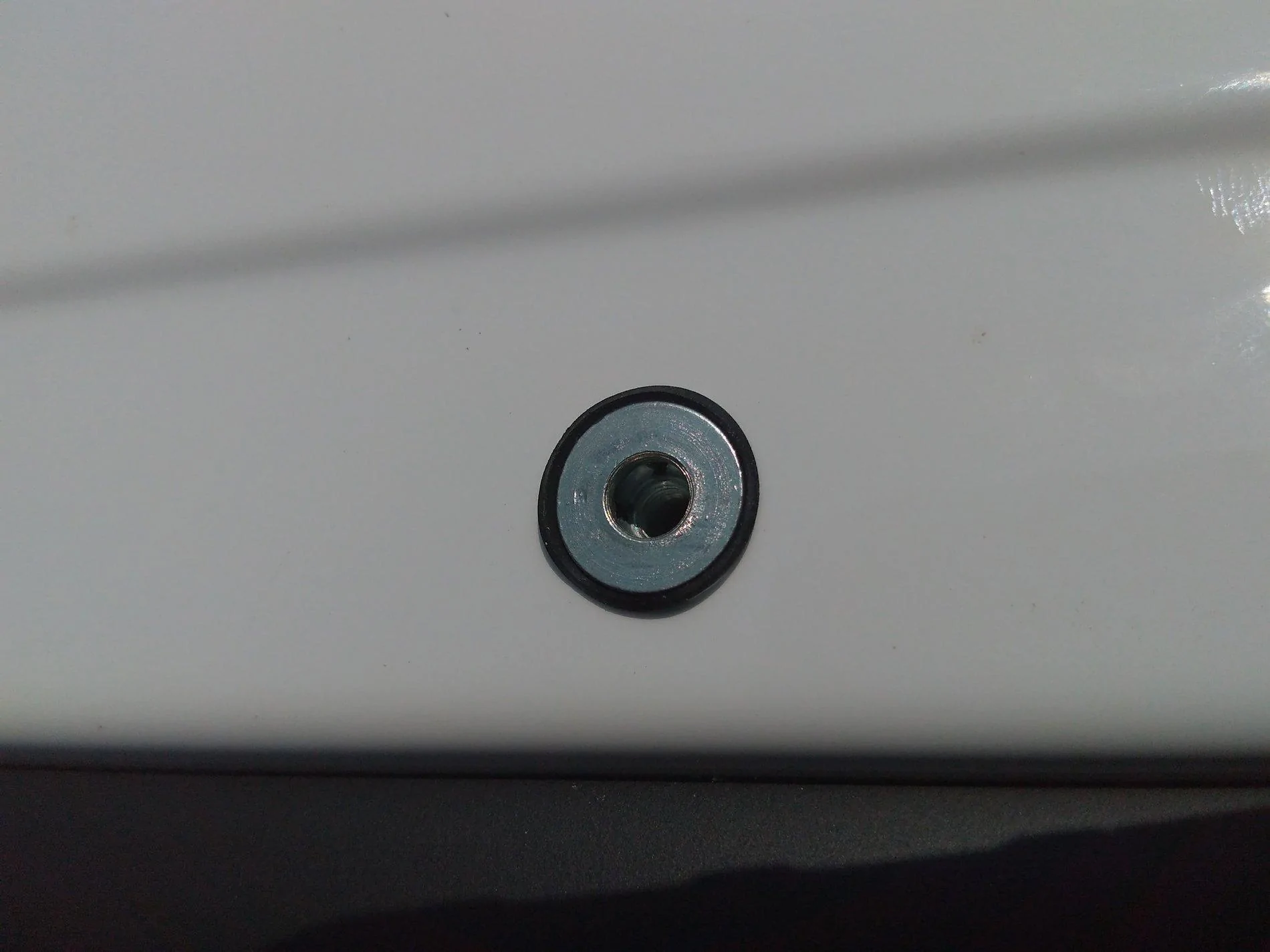

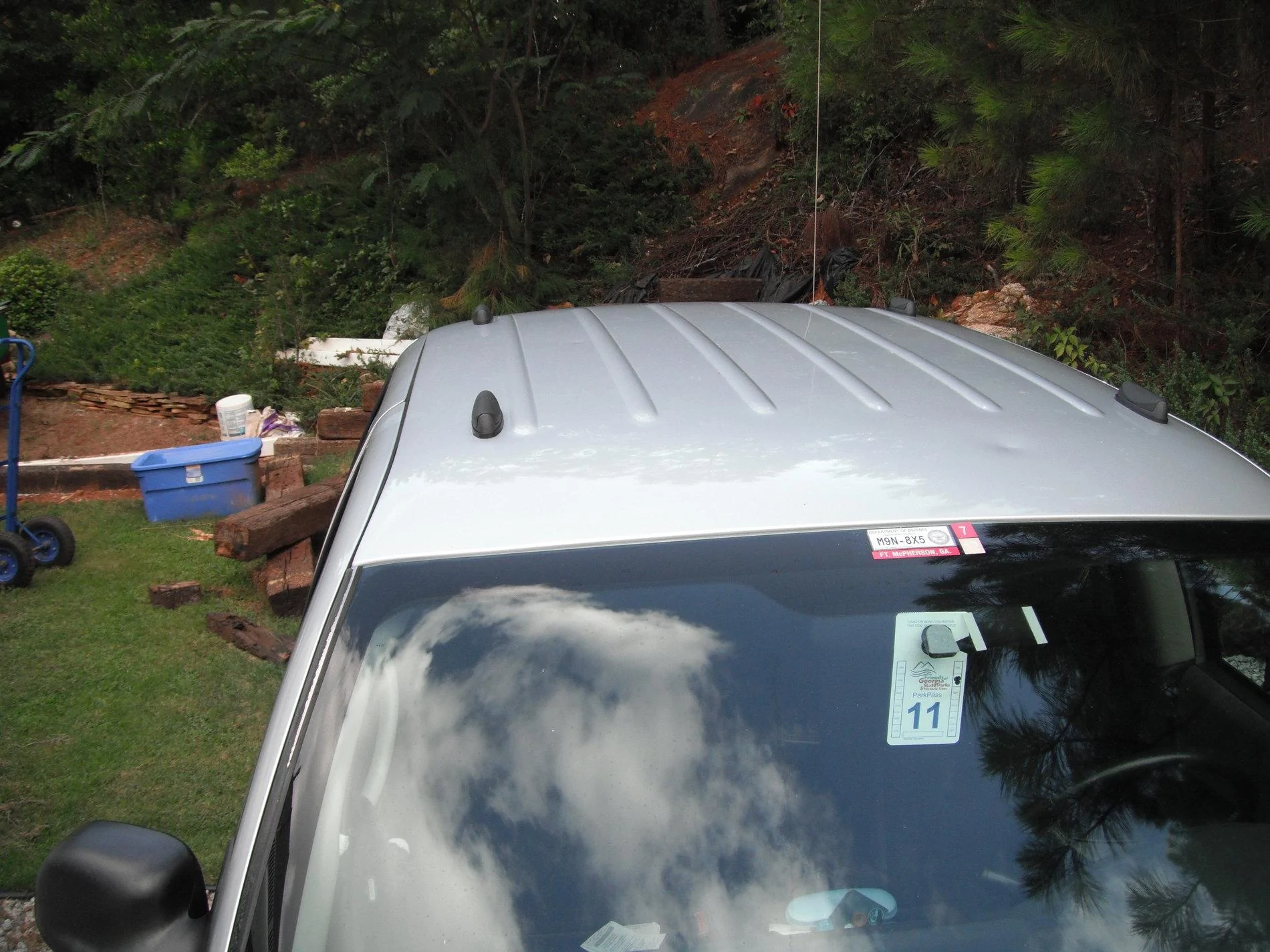

Considering adding one fixed point to the cab to go along with a topper rack system for longer loads like 18' canoes. Has anyone looked into this option from Yakima for a fixed roof mount? I did this with my fiberglass topper on my Tacoma but am a bit nervous drilling holes in the roof of the cab from a waterproofing perspective. A plus is when you don't need the cross bar you can easily remove and you're left with two small "caps" that I think would look fine.Overall installation looks easy enough. Thoughts?
https://www.yakima.com/landing-pad-7?_ga=2.123195084.670648903.1558562330-59395332.1557507470

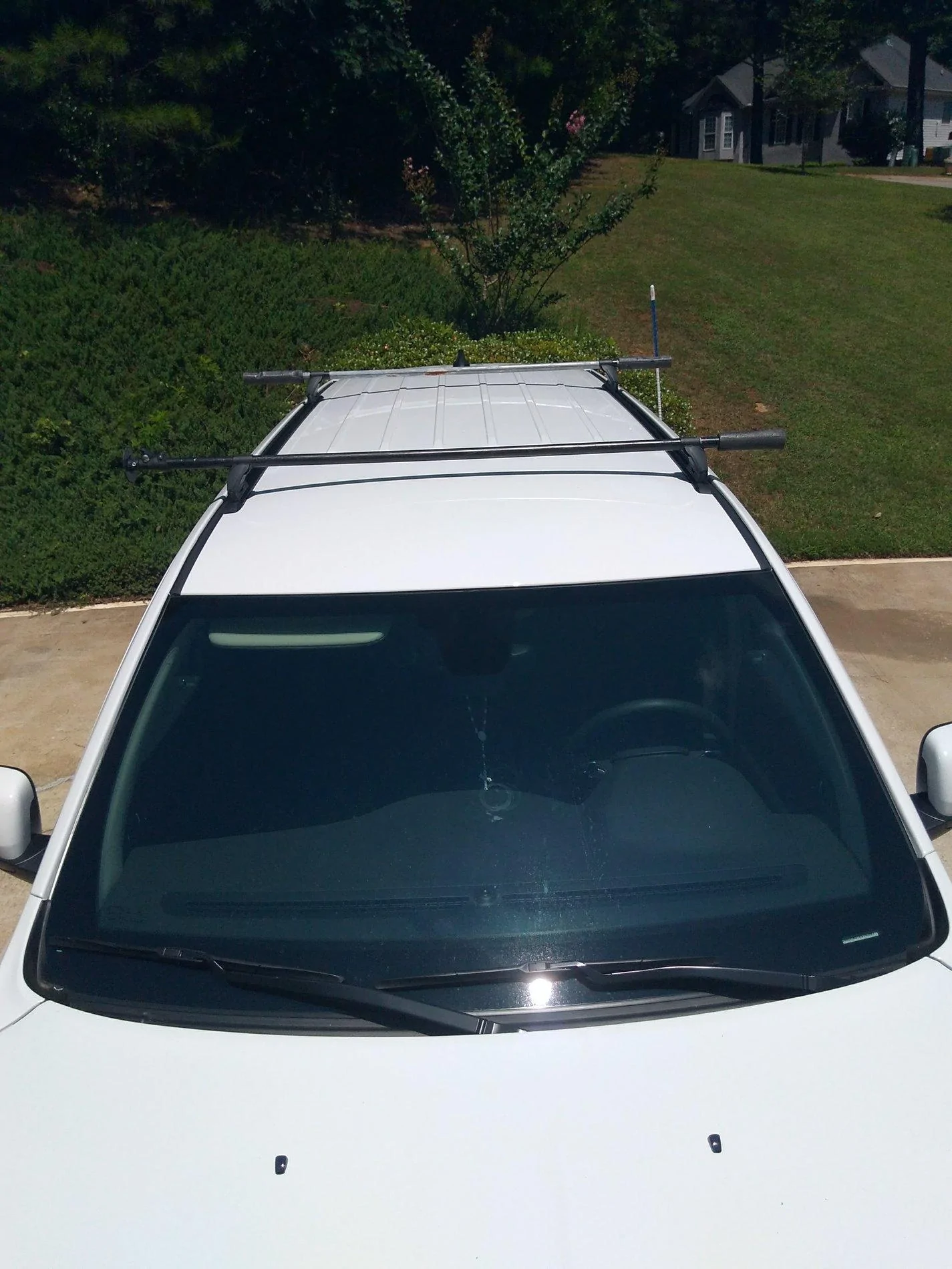

I used those Yakima landing pads on my Dodge Dakota many years ago with the supplied blind fasteners and have carried canoes, kayaks, bikes, up there with no problems at all. The sealant they give you seems to work really well.
On my Durango, I went with roof rails and used Plusnuts to attach the rails and use the same crossbars/feet for both vehicles.
Waiting to see what others come up with before drilling into my Ranger. :)
