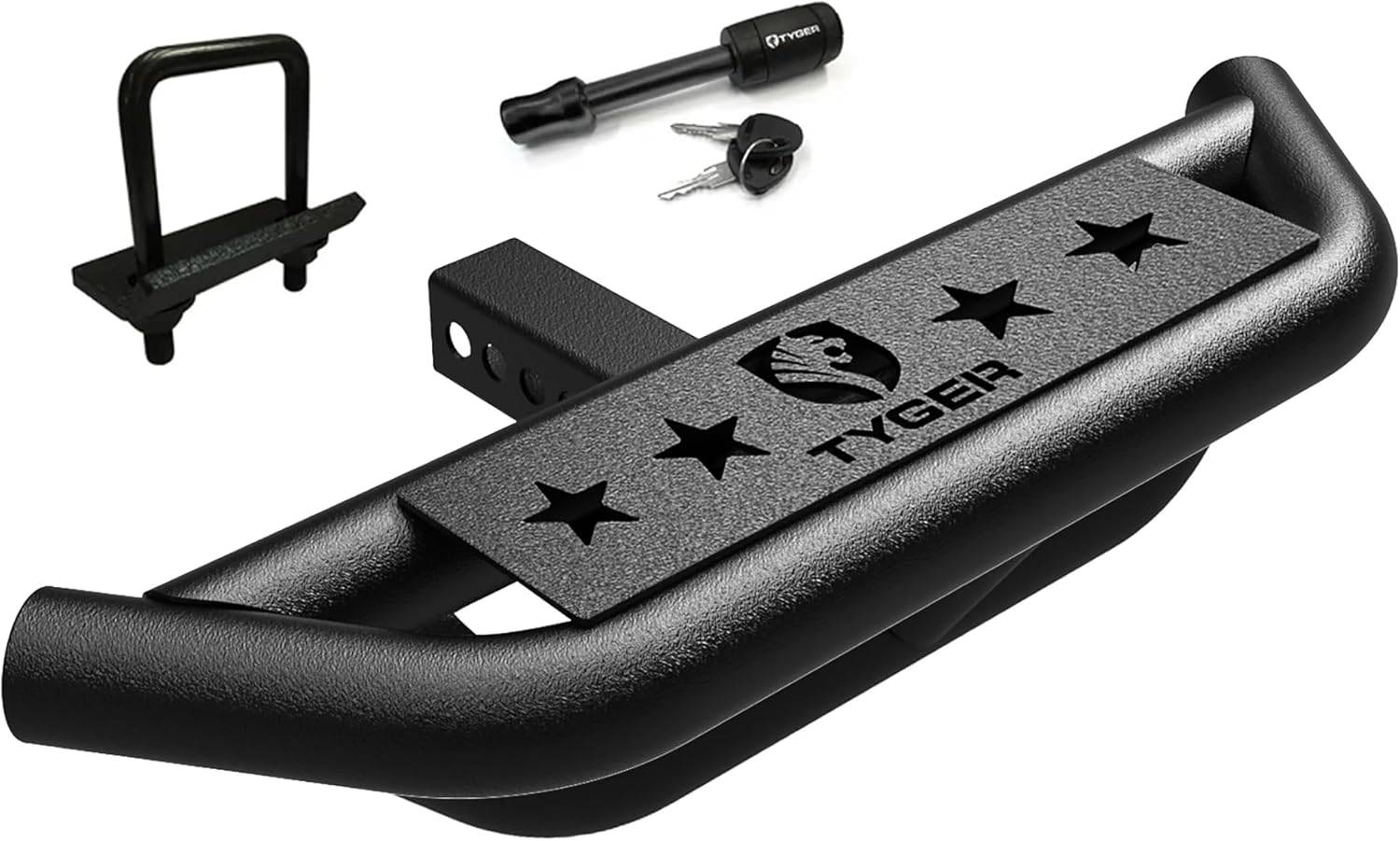

So I figured it out, sort of. I bought the truck a year ago and transfered the bump step to the Ranger and didn't have any issues for 11 months. Removed it to pull a car hauler trailer and changed back mid Jan and a week later the sensors started acting up. Didn't put 2 and 2 together until tonight. Removed the step and backed up at least 10 different times and works like it should. No clue why it worked for 11 months and the when put back on it didn't. I guess I'll just keep the trailer ball on all the time.

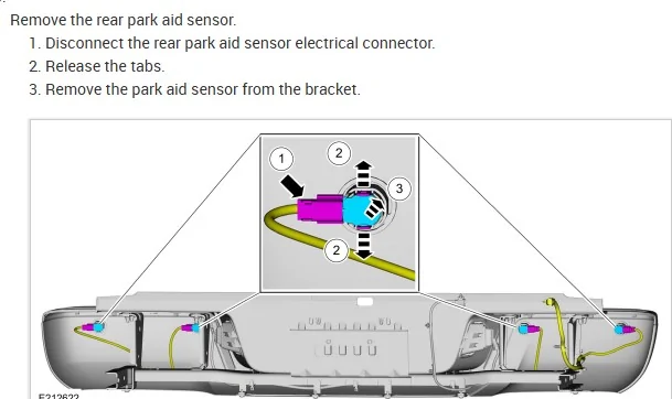

Since this was working and not triggering a false alert at one point, I would check the installation security of the R-Inner sensor, as if it became dislodged from (secured) position it is tilted and or it became overly sensitive for some reason.
The parking aid system detects objects under the following conditions:
  • The vehicle is in REVERSE (rear parking aid)
  • The vehicle is in motion in any gear except NEUTRAL (front parking aid)
  • The vehicle is moving toward the object.
  • The vehicle is stationary, and the object is moving toward the vehicle.
  • The vehicle and object are both moving toward one another.
Specs are: (Approx)
70 Inches from Bumper
20 inches from Bumper (sides)
12 inches off the ground
So, if the Step Was installed previously and it was not generating alerts, then I would check the Right Inner sensor to ensure its not partially out of the locking tabs.
It depends on which sensor was triggering the alert (R-Inner) or (R-Outer)
If it was the (Inner) it would have been a longer (Bar Indication) Horizontal with the R-Rear Bumper, the (R-Outer) would have been a short bar (indication) on the (R-Rear) Corner.
The Inner sensors both equally cover the center of the bumper, so I would suspect that with the step equally covering (surface area) and it was an issue then both inner sensors should trigger and pick up (object)

I had some work done on my front bumper shortly after I bought my truck and the shop put the sensors back in upside down. Got false alarms constantly.
In the rear I have a sparebumper.com SuperBumper which is similar to the Tyger step. It's never triggered the sensors so I don't know why you might be experiencing that?

I removed the connector and pulled out the sensor and then reinstalled it correctly. Reconneded the connector and still got a few phantom flashes over several days. I just put the step on upside down for now and all is well.
