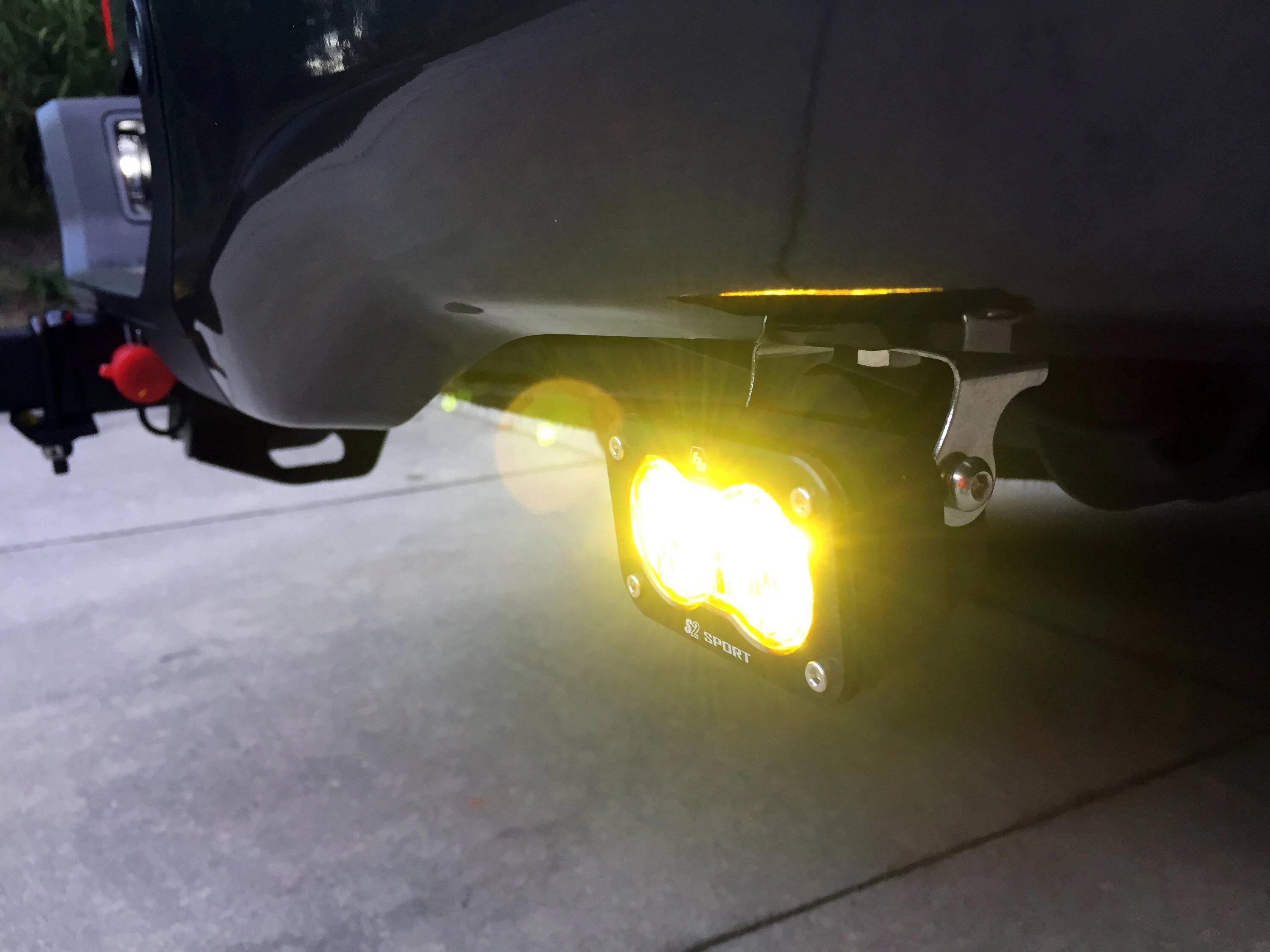

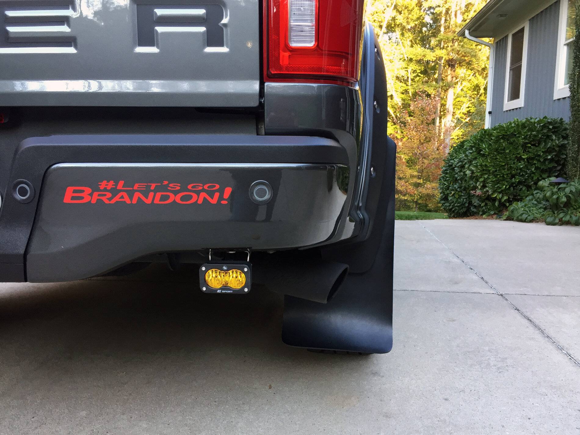

Hey RangerDanger617,
I would recommend going with our Dual S2 sport reverse light kit. The is kit comes with everything you need to be able to use them as reverse lights. The kit comes with a harness that connects directly to your Taillight plug. If you wish to connect them to your Upfitters on the vehicle then you can go with our S2 sports w/c amber. The harnesses you would need to connect to your up fitters is 55 inch splitter, 10 ft Extension, Upfitter harness. Feel free to let me know if you have any questions.
