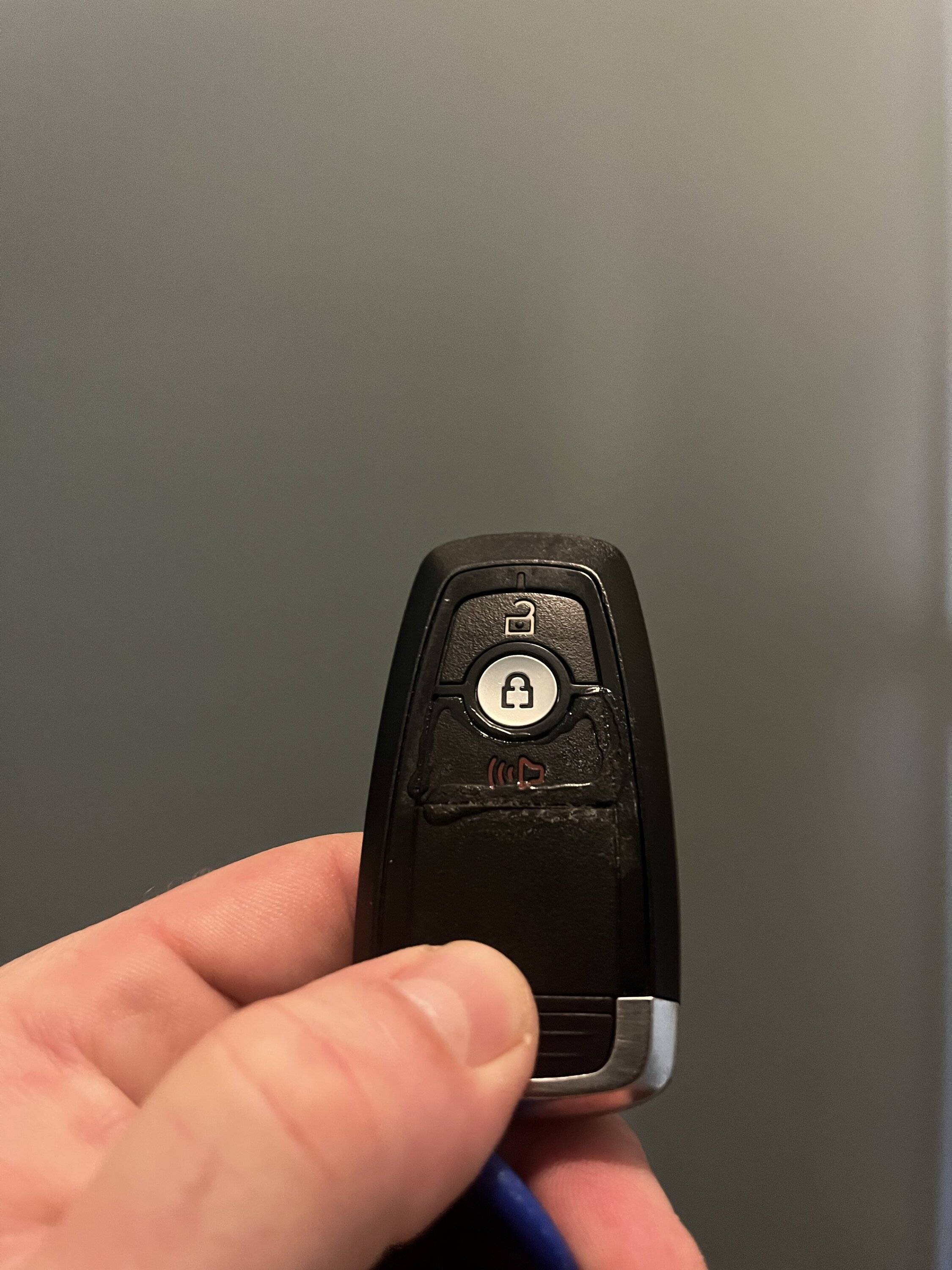

I redneck engineered mine. Ran a couple beads of super glue around the panic button and haven’t had a problem since haha.
