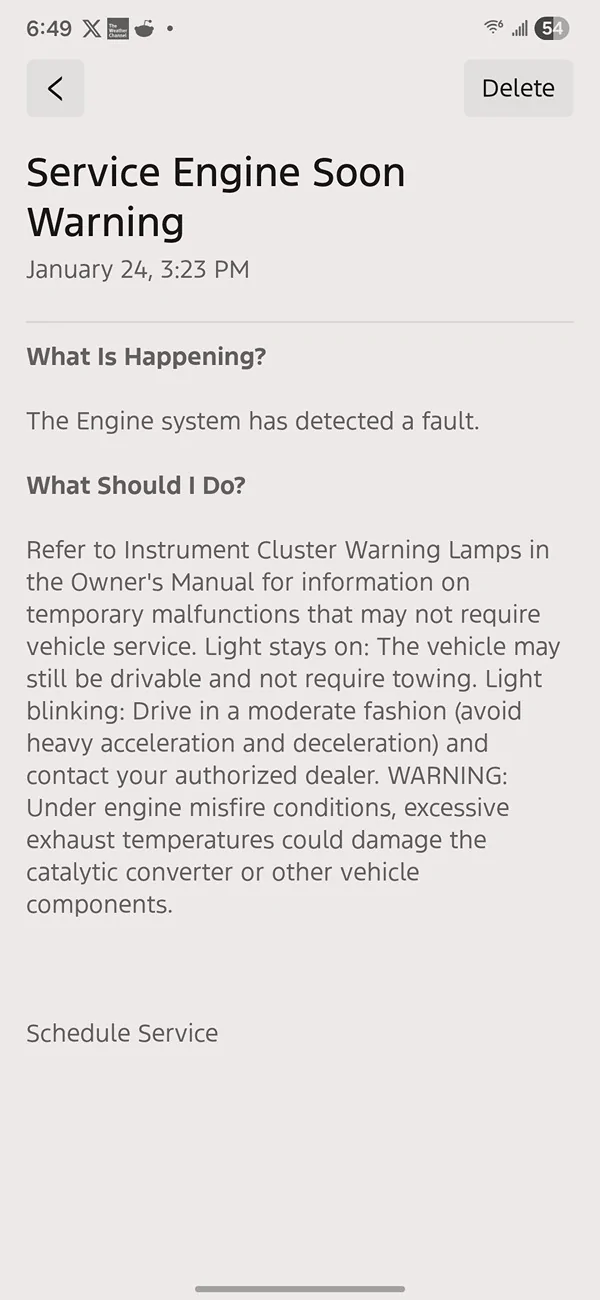

Check engine light came on my truck yesterday while driving. I drove it today and the engine light is off. Does the emissions sensor going out? Should I be concerned and take to a mechanic?
