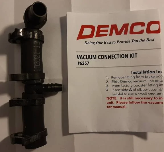

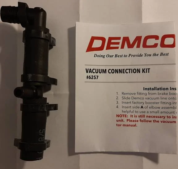

That is the same as mine originally. Here are a couple of photos of the NEW connector, part #6257.
I've disconnected from the top vacuum port and will be installing this on the bottom port.
We'll see what happens then.

OK. It's been a month since installing the Vacuum Connect Kit #6257. I am happy to say there have been no more warning from the Brake light.
I do believe we have a cure.

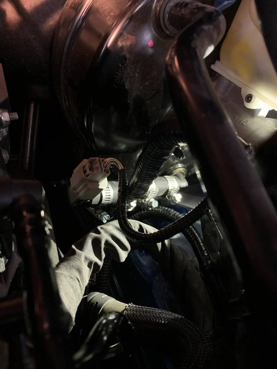

My system was installed using the vacuum port near the top of the brake booster. Since my last post, Demco has told me to change my hookup to the lower brake booster vacuum port where the sensor is installed.. Demco is sending me a new installation kit so I will have all the needed fitting and new hose to install.
I have attached the photo I received from Demco showing the new installation.
We'll see what happens after this is done.

That is going to be a bear to get too on the bottom like that. No line on it as it is just for the vacuum sensor, so they will need to provide an elbow along with a 'T' for the sensor and the vac connection. Mine is connected to the top hose and seems to work fine.

You are correct. The auto Start/Stop no longer works. That is the same photo Demco sent me.
What they sent me was the Part# 6257 and new vacuum hose to run from the control unit. The 6257 is all made up to just plug into the lower port on the vacuum booster, you move the sensor out to the end away from the booster, hook up the new vacuum line and done.

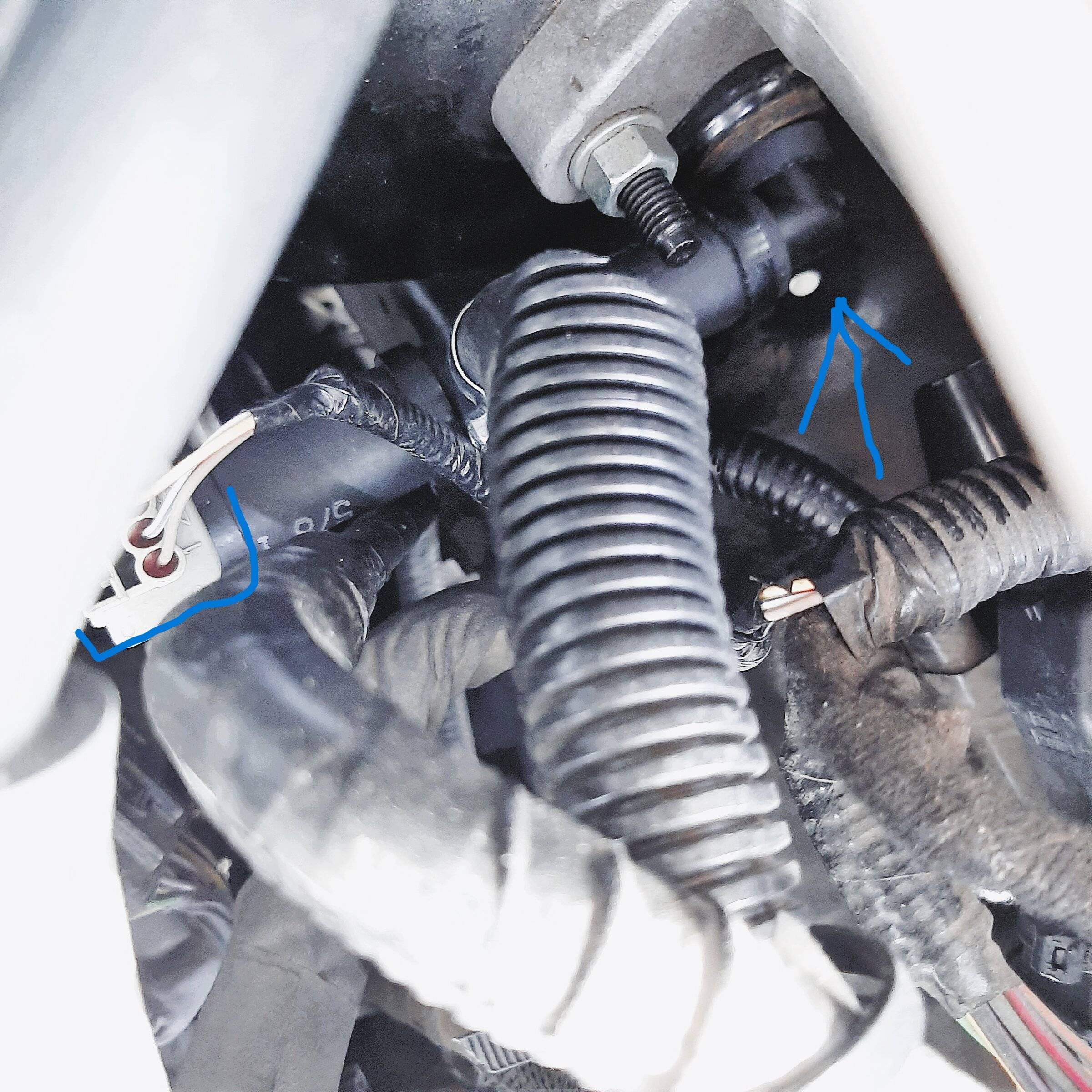

Attached photo is my current configuration.
The BLUE arrow shows the 90 degree fitting in the lower port of the brake booster.
The other BLUE line shows the sensor moved to the end of the new part.
The "T" in the middle is the hose going to the Demco Control unit.
There is 1 check valve installed in the vacuum line near the Control unit.
