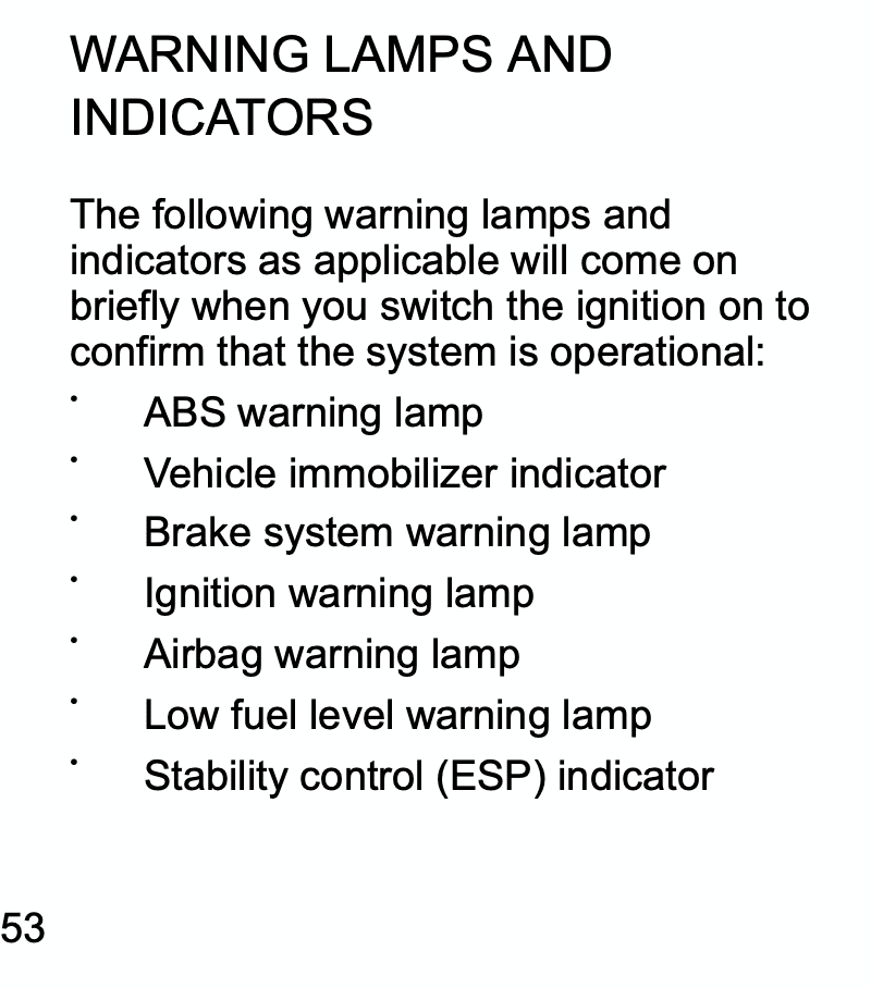

Check your owner's manual p.53. The oil pressure light is not supposed to come on with ignition on, only if there is a problem
. Weird, I know.

Thanks Motorphycology, but here is a pic of page 53 in my owners manual and also a pic from page 86 on the oil pressure light. First sentence says that the oil pressure light will come on when ignition is switched on.....what do make of that? That certainly doesn’t happen with my truck.

I believe others have mentioned it appears our US Ranger manual has some cut and paste issues from other manuals. Both the US and International versions.

Too many cooks spoil the broth, I guess. I got the info I posted from Manualslibrary.com. I'd go with your hard copy Owners Manual and take it to a dealer to have checked out,
