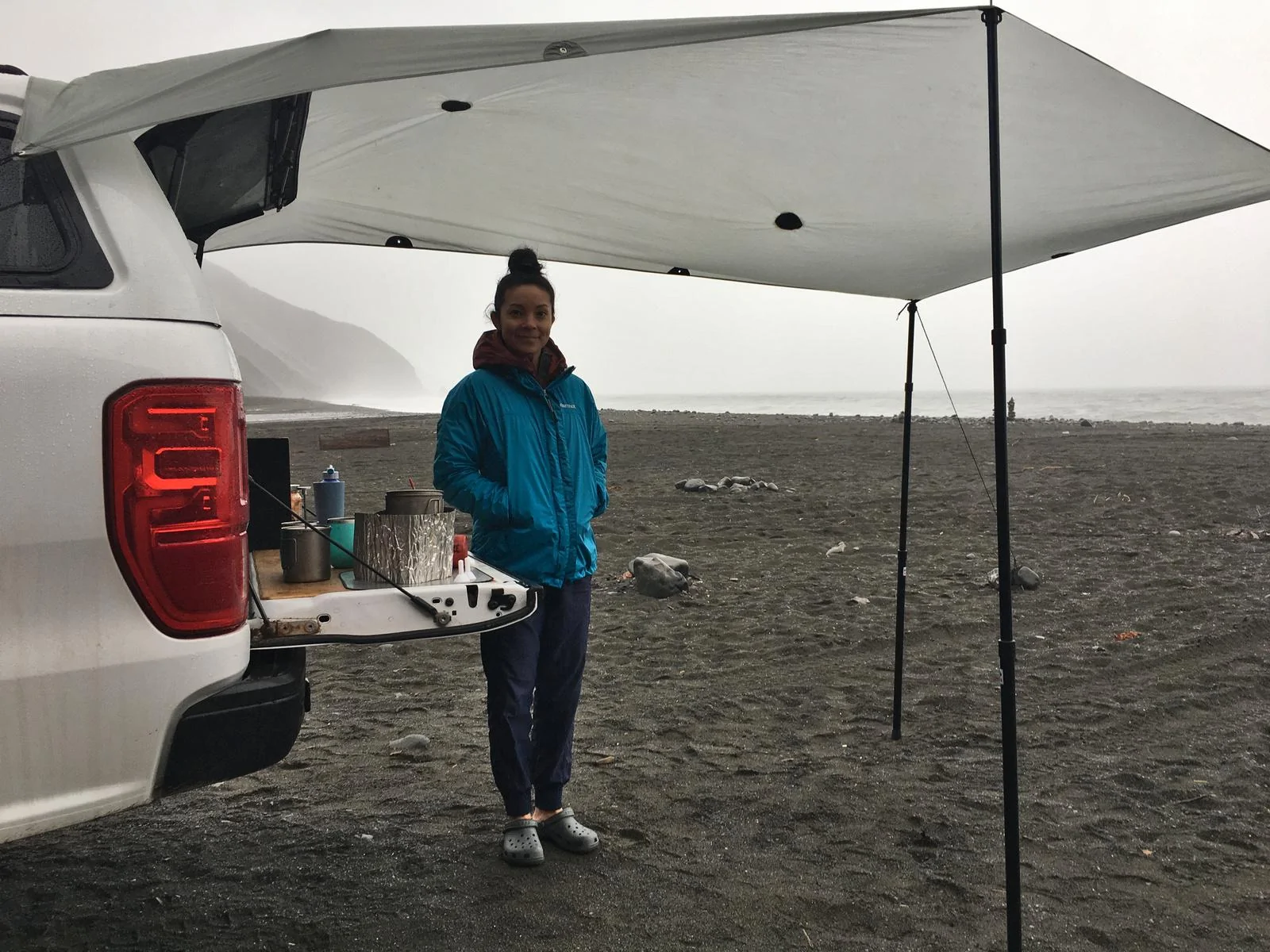

Have you guys considered adding an awning off the side of the topper, so you can spend time outside even when it is raining? It wouldn't necessarily follow your sleek and stealthy overland look unfortunately, but it wouldn't be too bad. We have a 270deg Batwing awning from Rhino Rack that does wonders on our teardrop.
It's also nice for protecting from strong winds and driving rain/snow. It's been a huge saver for us and we are so happy we added it as an option.
I have definitely considered that. I have watched videos several times on the 270 awnings and they are obviously awesome in terms of upgrading the QOL, especially in sun and rain. our current setup is pretty sh*tty in the rain, as anyone can imagine. like future divorce court kinda' stuff:)
however ultimately we decided against it for now. it would require installing both a roof rack plus an awning, and blow the clean look. we are also (me more than my wife.. or maybe its just me...) anal retentive about mpg and i dont love reading it will drop me down another 1 or 2.
i have experimented a little with deployable shades. i took the old silicone coated ripstop tarp i made twenty years ago as my hiking shelter (ancient history!) and played around with a couple adjustable poles and some suction cup attachments.
works ok. ok enough that i have just invested in a far larger tarp in the hopes of making something really viable and comfortable. that tarp just came in the mail, and was 6% the cost of a 270 awning. so if it works even 10% as well i'll be making money;)

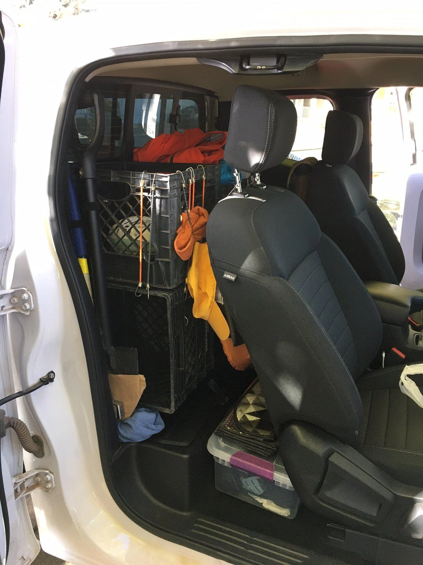

The Cab Redesign:

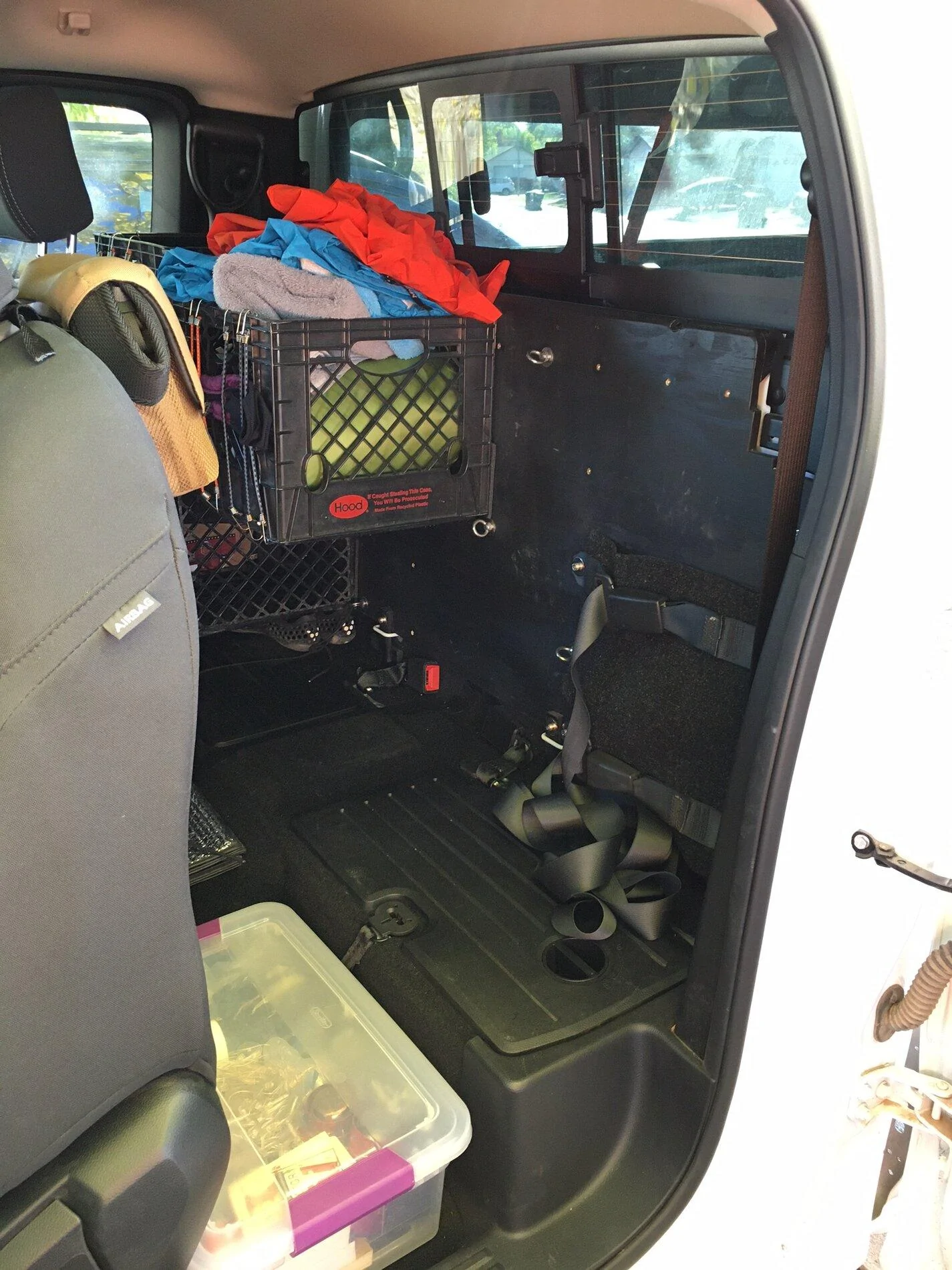

We never have passengers, and (unfortunately) don't have dogs, so the rear portion of the supercab was reconfigured into designated storage.
You get a significant amount of room back by removing the seats, and I turned the rear wall into modular storage.
For a look at my rear seat delete, check out this thread:
https://www.ranger5g.com/forum/thre...eed-advice-on-sound-proofing.7976/post-146496

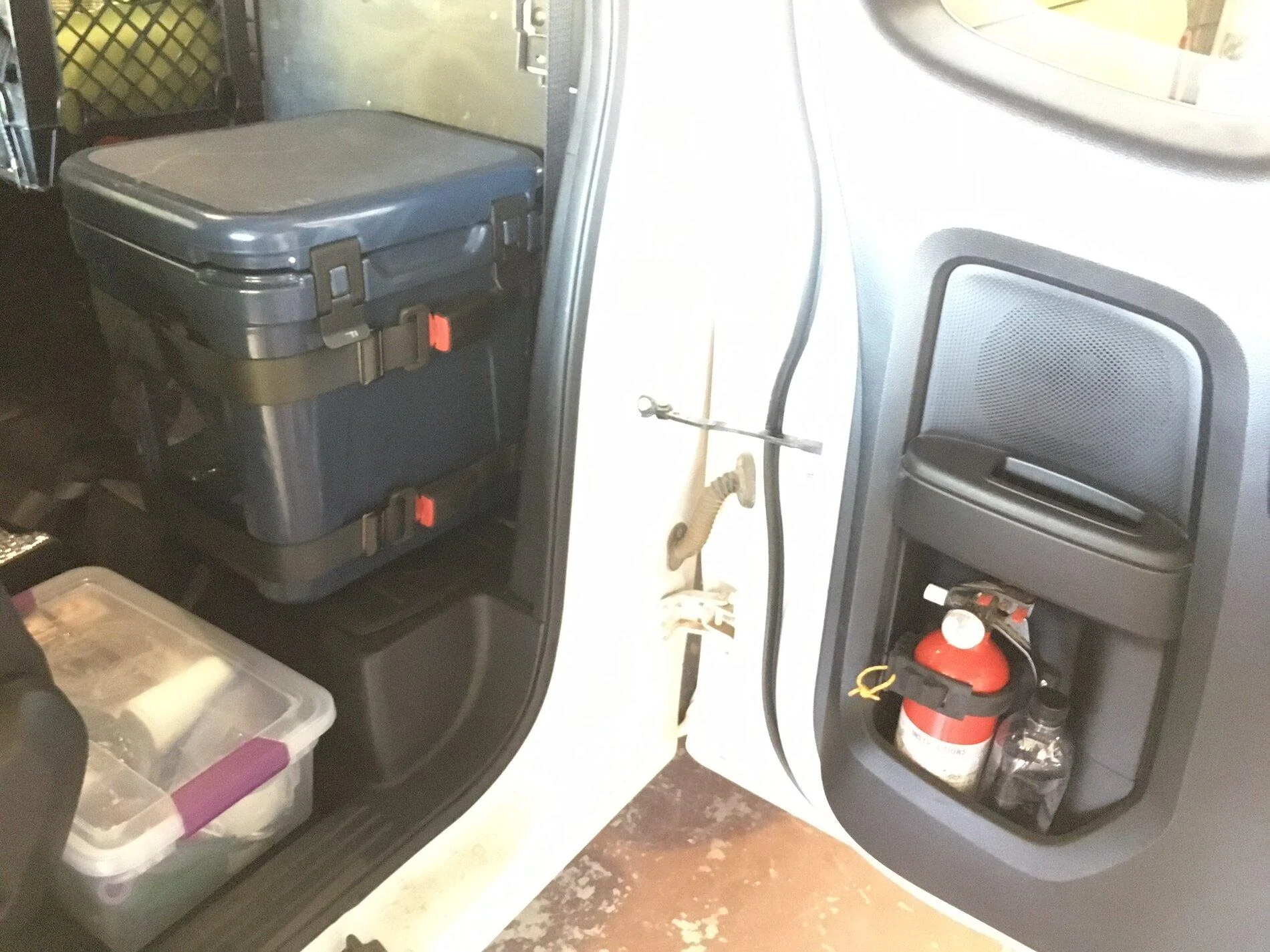

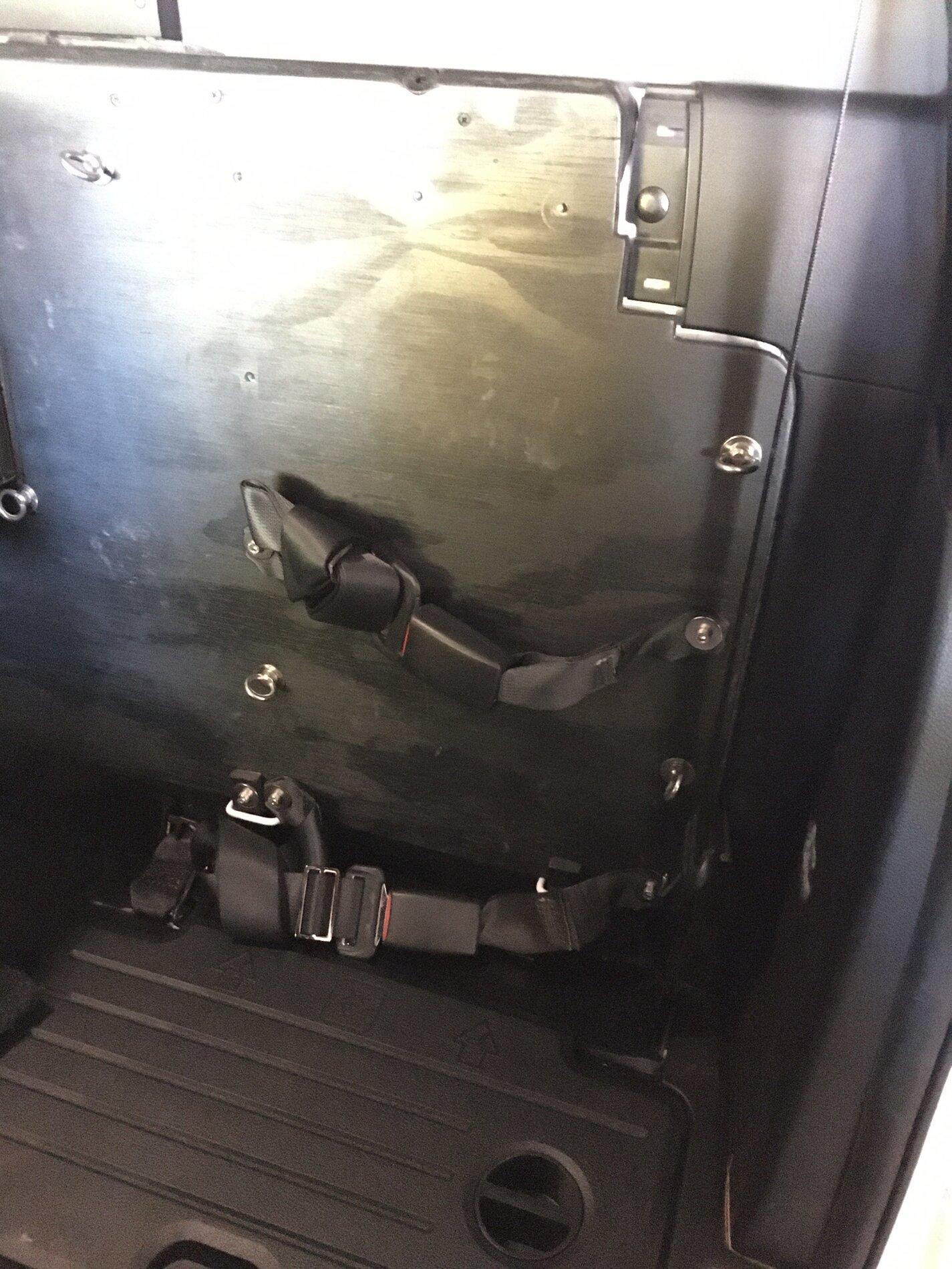

So currently, my rear cab has a designated slot for a Yeti cooler that has bolted/buckled attachments behind the driver seat. It can be opened and accessed without removing it from the cab. The middle is where my toolbox sits which also is secured to the rear wall. And the passenger side has three milk crates bolted to the rear wall. these act as clothing and gear storage, and a handful of small bungees hold things in and to them as needed.
passenger rear cab: tupperware storage in footwell, milk crates, and camp axe/shovel secured to milk crates. hooks on passenger headrest for baseball hats and headlamps.
driver rear cab: slot for toolbox, cooler. binocular case attached to driver headrest.
the milk crates are bolted with m6 bolts and washers to the grid of t-nuts on the rear wall and can be moved or removed if needed.
in the front door storage we have a water bottle each, and various stuff in use while traveling.

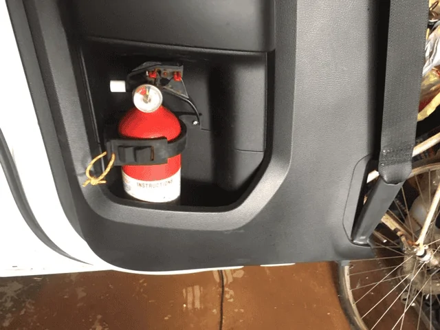

driver suicide door has a fire extinguisher (see here: https://www.ranger5g.com/forum/threads/fire-extinguisher-mounting.3666/post-188103).
passenger suicide door has bathroom stuff (portable bidet, TP, and the shovel is right there).

Securing those crates to the rear wall board is a great idea - and you got to use those tee nuts again !

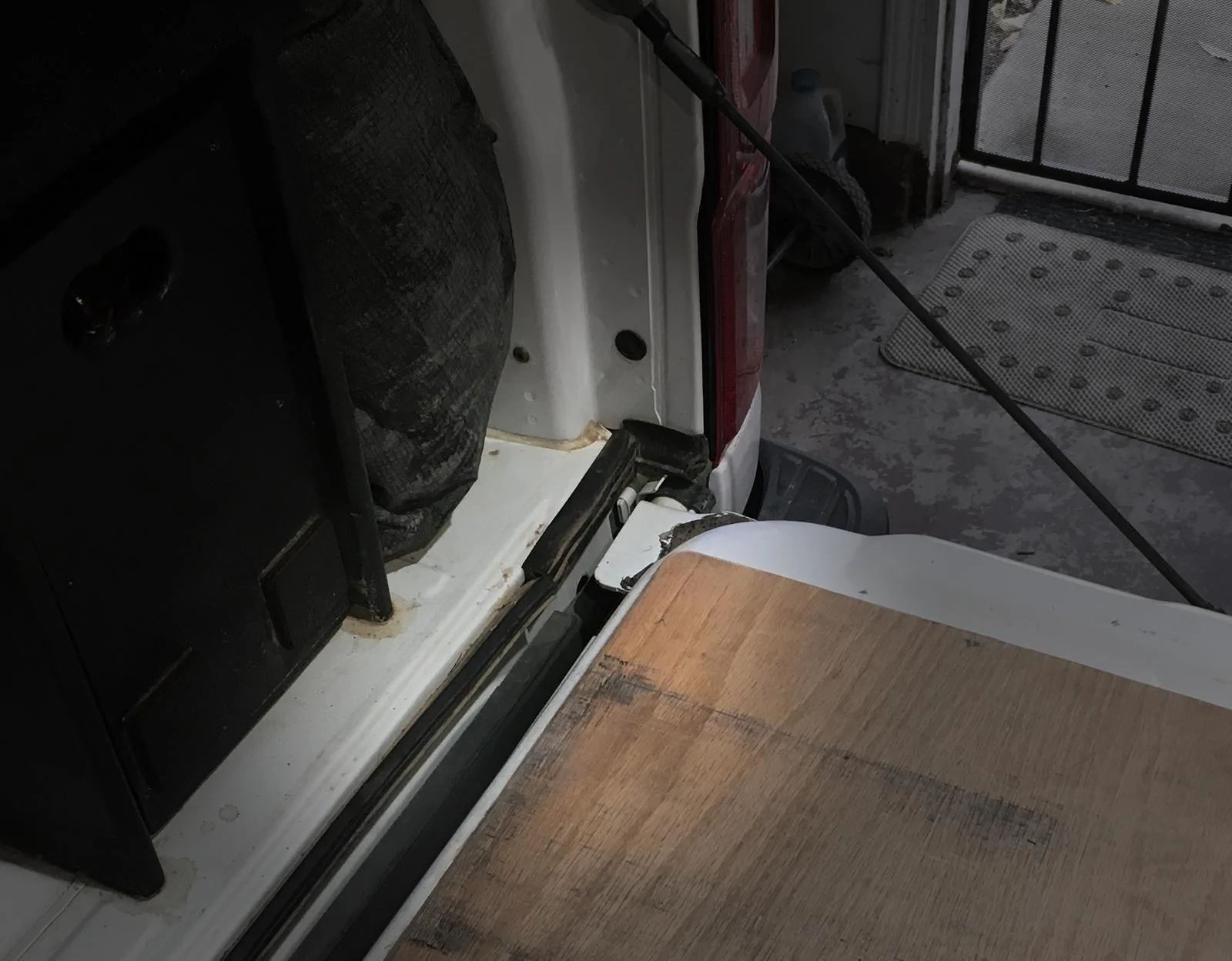

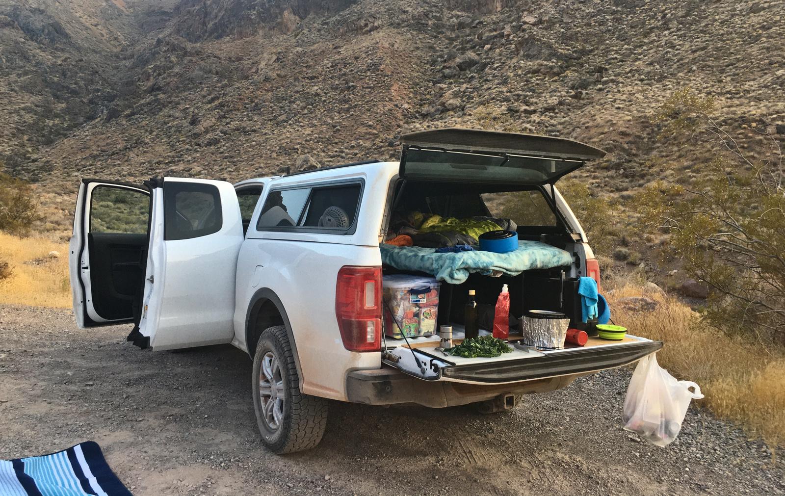

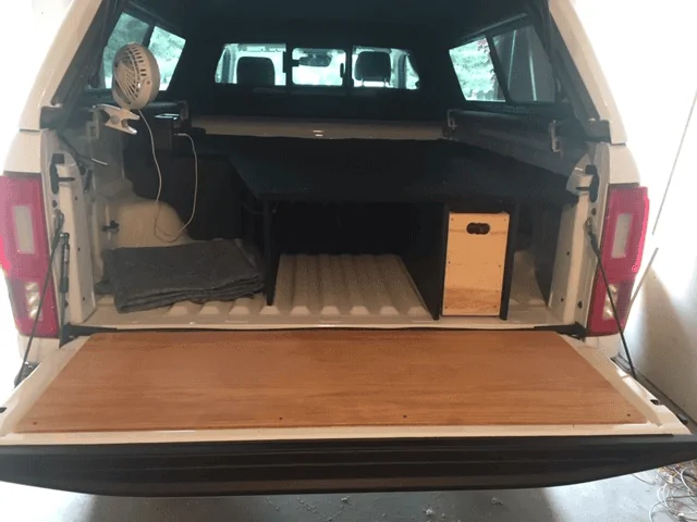

The Kitchen:

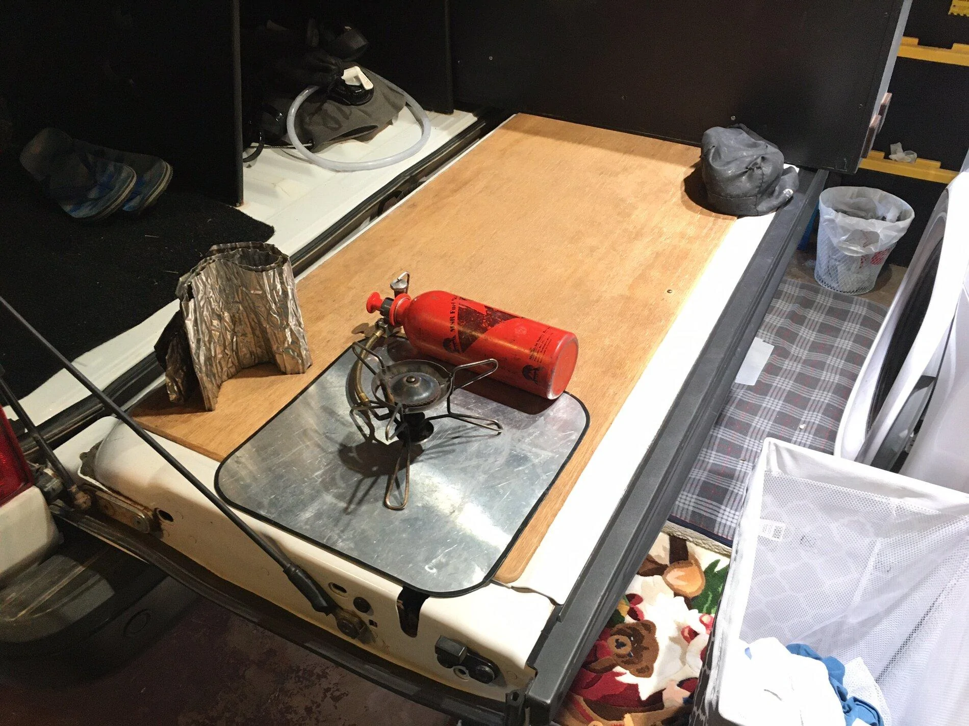

The kitchen is your basic setup, tossed in the back of a pickup.

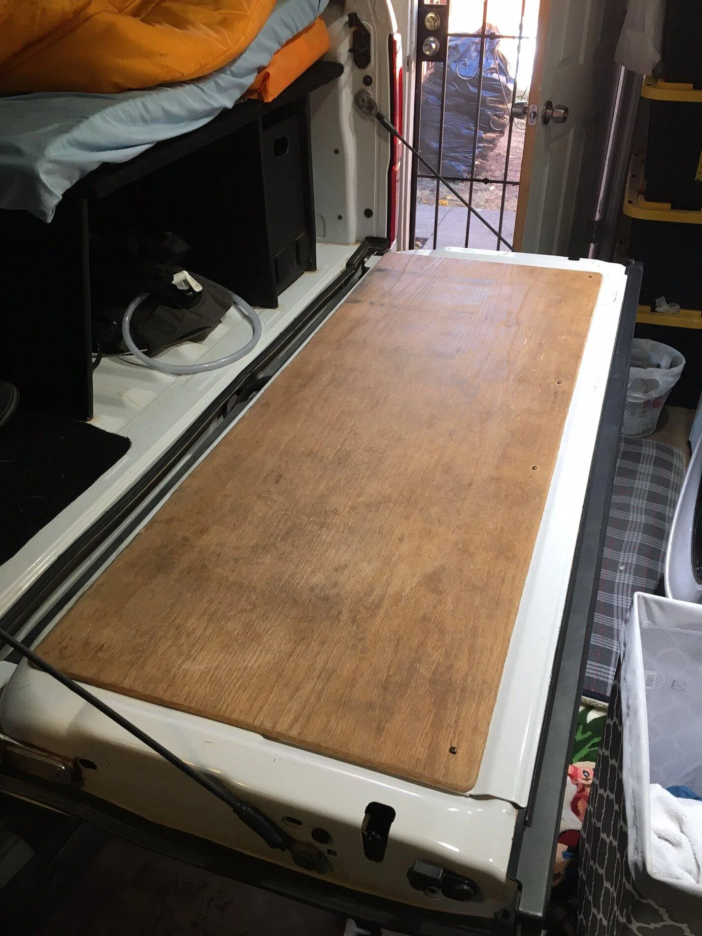

the single biggest immediate upgrade to the function of the ranger as a camping accessory for us was putting a sheet of wood on the tailgate. this was mentioned in this thread here:
https://www.ranger5g.com/forum/threads/installing-wood-pane-inside-tailgate-advice.8084/
basically, i cut a 1/4" oak veneer plywood to size, secured it at the top of the liftgate using the four factory sheet metal screws, and at the bottom of the liftgate with a bead of silicone. the sheet metal screws that come with the liftgate have a large flange and would stick out a lot and be pretty ugly, so i hunted through the stock of accent screws at Menards and found screws with a tarnished bronze look, countersunk heads, and- importantly matching threads. not every wood/sheet metal screw of the same size has a truly identical thread and given i am reusing holes in the liftgate with small screws in thin metal i felt it was important to match the thread pitch exactly and avoid stripping an already tenuous hold.
when i first was toying with this plan, other posters suggested replacing the OEM sheet metal screws with riv nuts. that would be a far more elegant/robust solution, but this ended up working well after months of abuse and i dont think i will need to replace this frequently enough to make riv nuts an attractive upgrade.
the plywood was dirt cheap, as a 2x4' piece is sufficient and most big hardware places sell that size piece for 8-10 dollars for craft projects. i cut it to size and routed the edges with a roundover bit to make it prettier, sanded it lightly, and sealed it with leftover deck sealer from the underside of the bed project. this has been great as it does not absorb rain, spills, or food, but preserves the basic wood look.
to match the factory screws to the new board, i backed the factory screws out a quarter inch, vigorously marked the heads with pencil, put the board in place and pushed hard so the pencil marked the back of the board. then drill and countersink the holes and replace.
there are no convenient factory holes near the bottom of the liftgate, so initially my plan had been to use double sided tape. the one i bought was too weak, and i wasnt sure how long this plywood would last so to avoid industrial adhesive marks on the tailgate i used a small bead of silicone under the board and this has worked well. when it comes time to replace the board it will be easy to peel the bead off the smooth paint of the tailgate.
after a lot of heavy use, including pulling the unlubricated, unrailed heavy drawer over this board, walking around on it, and generally abusing it its still looking pretty good with only a few small spots where the veneer has come up. however when it eventually dies i would like to replace it with a prettier wood, perhaps a 1/4" bamboo or a baltic birch with no thin vulnerable veneer. unfortunately those were not available from my local places when i was building.
this board is not for looks. its a major ergonomic upgrade. it provides a flat surface so that boxes slide over the tailgate, cups and bowls rest flat, it doesn't get hot in the sun when we sit on it, nor does it feel particularly cold in the winter.
alternatives would be to purchase a professionally made plastic tailgate cover, but the wood feels really nice underfoot and I suspect these dark plastic versions would be really hot in the sun, and the light ones would look messy. the wood grain hides the dirt and imperfections of wear and tear.

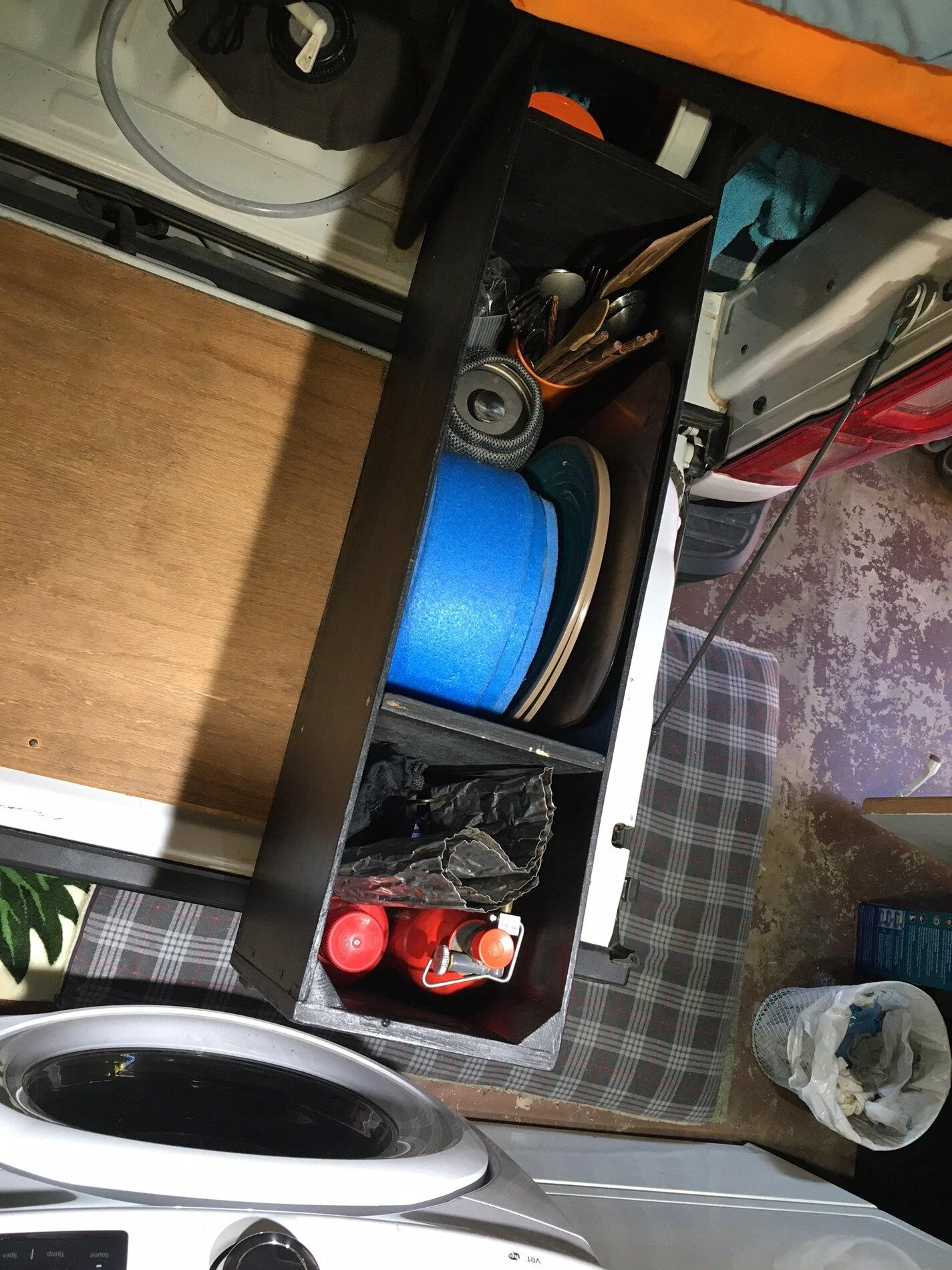

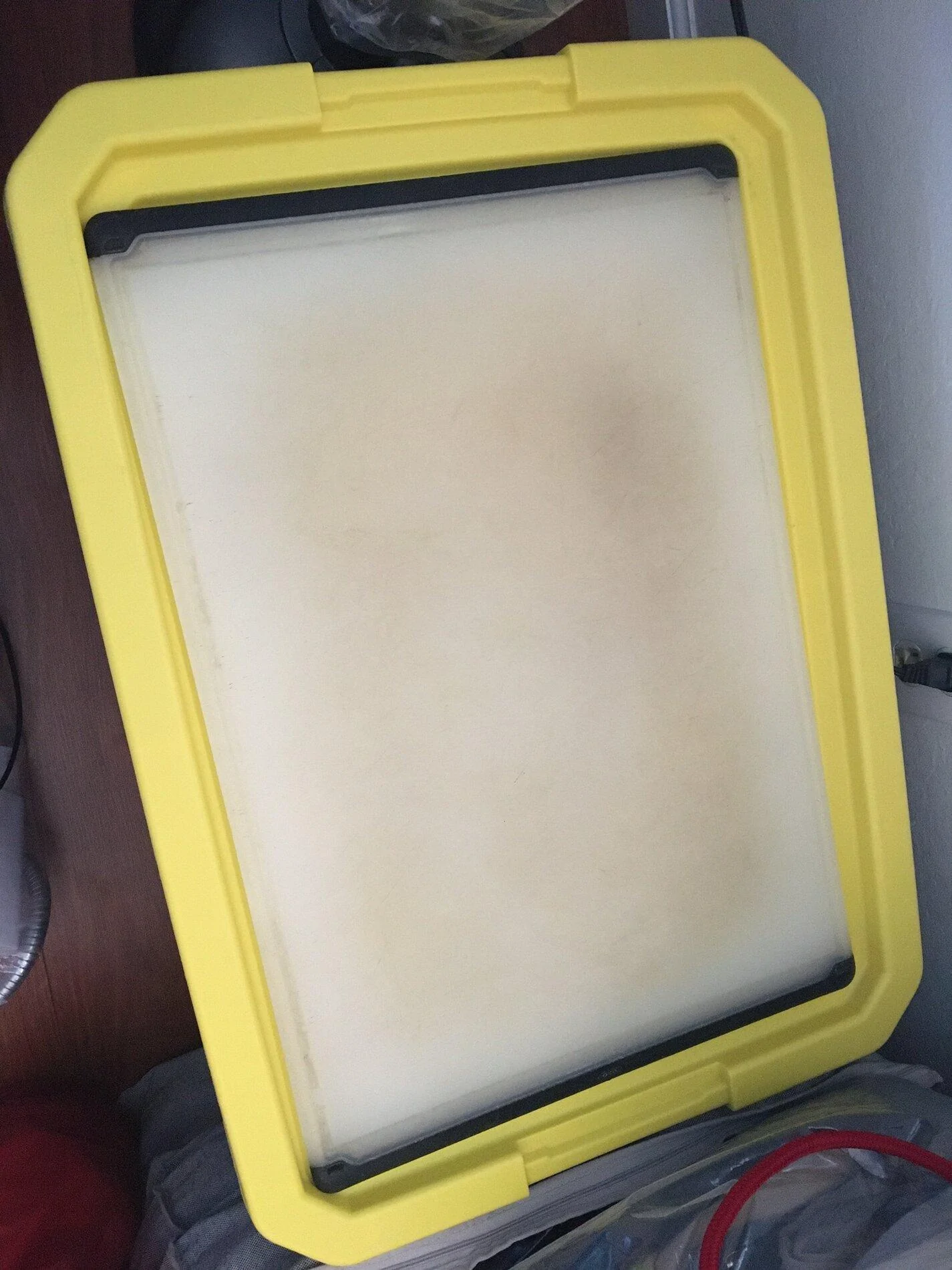

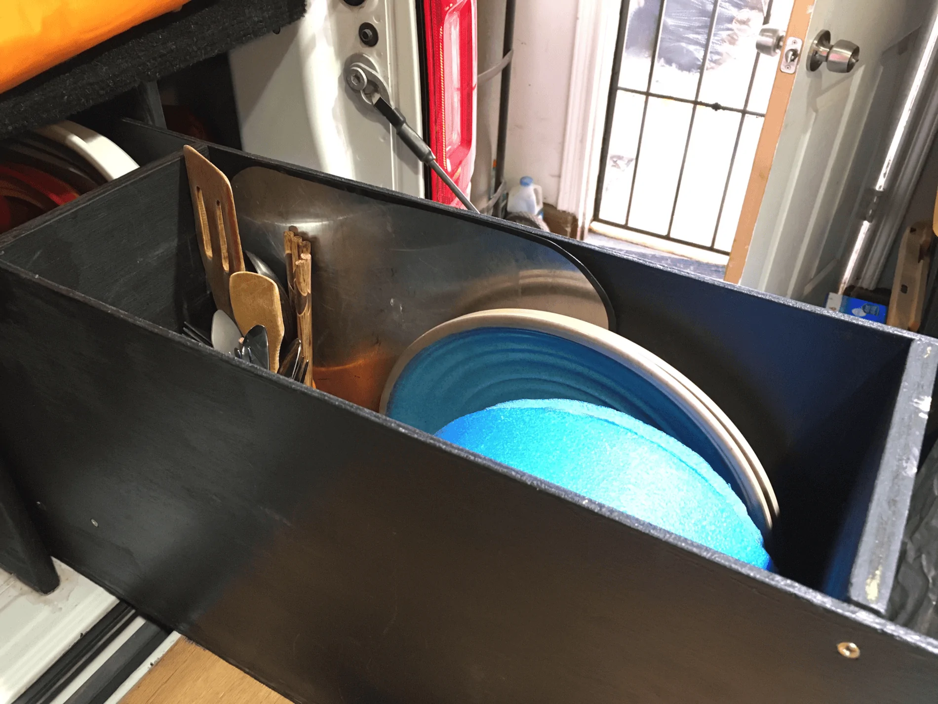

we keep a large cutting board, which insets into the top of the storage bins that go under the bed.
i keep a MSR whisperlite stove (burns white gas or gasoline) in the rearmost section of the pull out drawer, along with a spare bottle of white gas (burns without soot or gas smell), lighters, pot holders, wind shield, etc. the stove sits on a square of aluminum flashing which fits neatly into the slide out drawer without taking any space. It stops stray drops of white gas burning the tailgate wood. It does not get appreciably hot. Even running the stove for thirty minutes doesn’t get the wood hot and there are no char marks after months of use. We typically carry 44oz of fuel which lasts a couple weeks.
the next chamber has our pots (3), pot cozy, plates, bowls, french press, utensils, and two vacuum double wall cups.
the next chamber has silicone/plastic collapsing tubs and collanders (they accordion flat), dish soap, collapsing bowls and tupperware, silicone scrub brush, more cooking stuff.
the last chamber has tons of nonperishable food and spices. The stuff we rarely use. it can be accessed by pulling the drawer all the way out, which is a little tenuous when its heavy, or through the trapdoor in the bed which opens onto this area.
for water we carry a bunch of platypus brand collapsing containers which we use when hiking, for a total of around 8L. We also have the frozen water bottles in the cooler (or occasionally use the melted ice as well). then for primary storage we have two MSR dromedary 10L water bladders which are super robust. they sit in the primary storage chamber next to the food box. One has a shower attachment which we use as a tap for dish washing or dispensing water. If we wanted more water, we could fill up one of the big storage bins with more water bladders, or stash another 5g collapsible container in the bed cutout. in practice, if we need more than the 30+L we just stop taking camp showers for a little while.
For actual showering, we leave the (black colored) dromedary on the roof and it heats up with the sun, and shower with that. We have a small quick drying fabric mat we put down to keep the dirt off our feet while showering.
trash bags (we use the thin plastic ones that come with groceries) hang off the metal bracket/bumper at the side of the tailgate in a convenient position while the tailgate is down.
and the fridge:
is just a cooler. for ice we typically use frozen water bottles which we drink later, plus or minus ice. it keeps things cold for days in hot temps, or forever in cool temps, and keeps us in vegetables and perishables and cold drinks while on the trail and traveling.
the cooler is bolted to the cab rear wall with seatbelt and seatbelt buckles
the first iteration of the cooler attachment used a cam strap, but it was annoying to have to thread and attach it everytime. and bungees were also tricky. but i wanted a secure and robust attachment that would keep this in place in a rollover. so what is a common way to secure heavy things in place during a rollover, but is instantaneous to engage? seatbelts! these came from the local junkyard and are preadjusted to the cooler so it only takes 15 seconds to secure and release the cooler, which makes it easy to pop it out of the truck for use as our camp table (its the perfect height for our low camp chairs).
i decided against a real fridge becuase this was simpler and i just didnt think the fridge would be necessary. a real fridge would max out the powerbank we have, but that would be easily fixed by upgrading the solar. we currently only have 80W, but another 150-200 would fit easily on the topper, with a flexible panel which would more than power a fridge all day and remain below the level of the tracks, out of sight and with no wind profile..
one note on the cooler: one thing that does annoy us about this setup (using an in-cab cooler with ice as our fridge) is how much noise it makes when offroading. on the first day it doesnt matter much as everything is still frozen, but as the ice melts and you have an ice-food-water slushy mix in there starting on day two, when offroading it makes a lot of noise while slushing back and forth as we rock-crawl and muck around on off camber terrain. to fix this, you could probably drain the water, but we dont do this to preserve as much cooling potential as possible (and we can use the water if we want).
however with our setup, you can strap the cooler into the bed if you want. it straps reasonably nicely between the two OEM load attachment points in the bed cutout. for aggressive offroading, i would pad between the cooler and the bedwall (with a folded blanket or big jacket) so it isnt banging against the bedwall, and use some aggressive cam straps or bungees.
our cooler is the yeti roadie 24
https://www.yeti.com/en_US/hard-coolers/roadie-24-hard-cooler/YR24.html
we like this one because its big enough for our purposes, fits behind the drivers seat with lid opening out the suicide door (ie: easy access by opening suicide door, dont have to take cooler out of cab or fight the drivers seat to reach in), fits a bottle of wine upright (wife says thank you), and seems to do a decent job keeping things cool. there are non-yeti (ie, not ridiculously expensive) versions which i bet would also do fine. an advantage to the non-yeti versions is that many have a drain plug, which would make it easier to drain water. the yeti insulation material does not seem to be anything magic and i dont know why a walmart brand cooler wouldnt do a great functional job. honestly we chose the yeti because it had cleaner lines, was easier to clean, and the build quality was better, but with no fantasy that the cooler function would be any better.

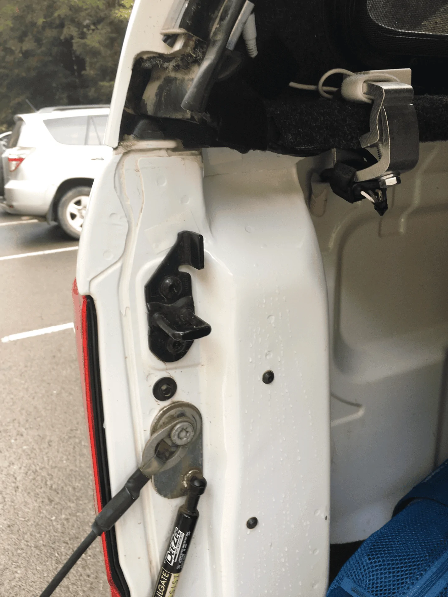

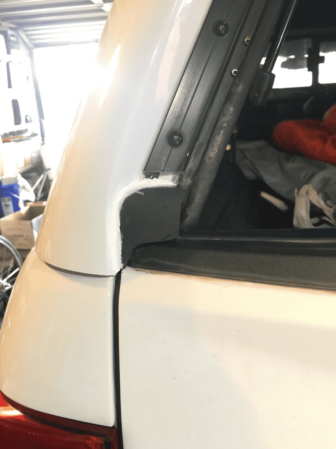

sealing the bed:

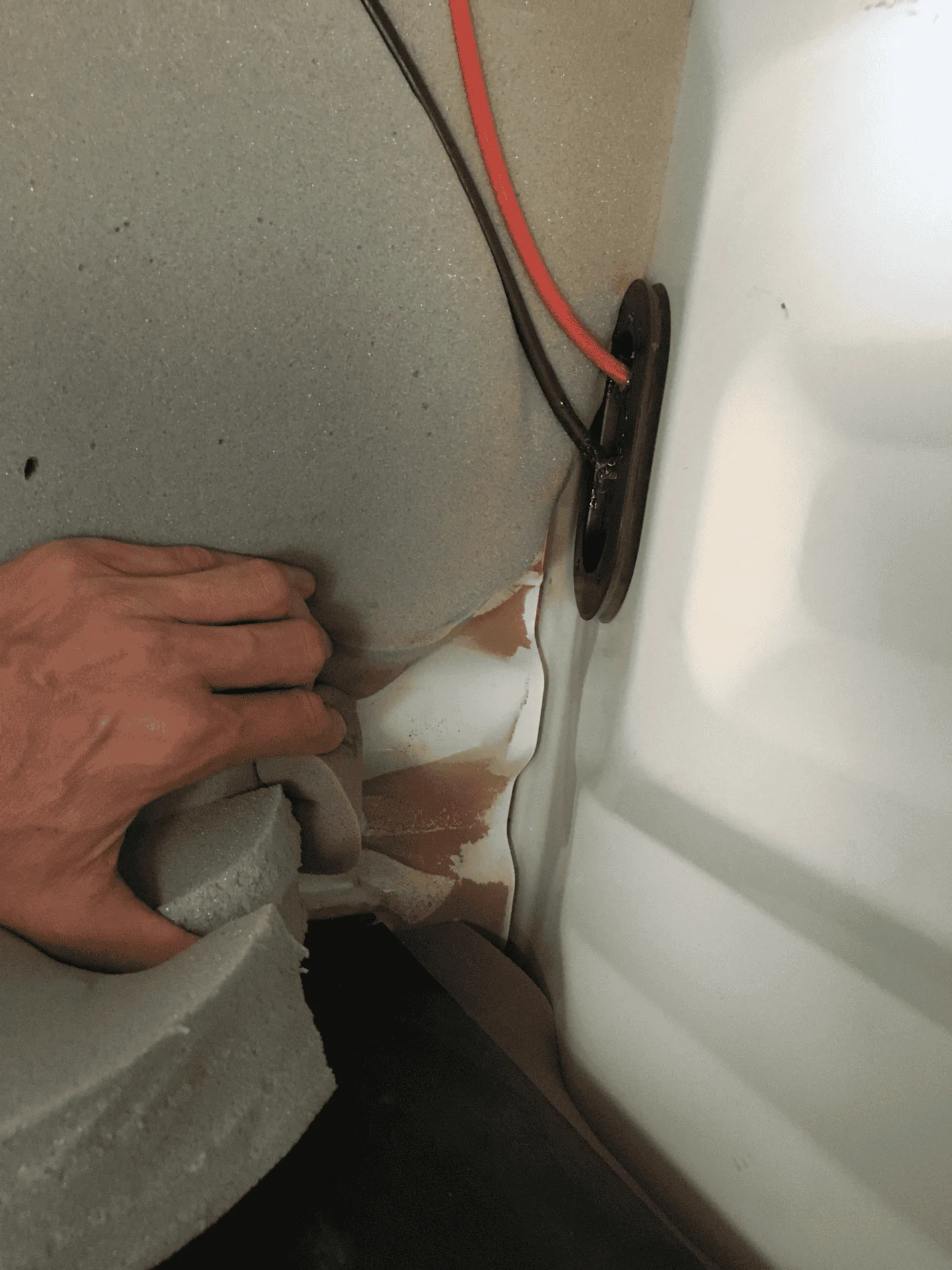

For folks that DO plan to live in the bed with a topper, or are considering it, i think it might be useful to review how I approached sealing the bed.
Preface: this is our first truck, and we previously were doing our adventuring out of a lightly converted minivan. We chose the ranger to get us outside because we no longer wanted to be limited by road quality (or lack of road at all, at times) and chose against an SUV because they were generally more expensive with lesser MPG for a similar offroad capability (4runner, etc) or werent big enough to live out of. We knew we would miss the single-room ergonomics of a van/SUV for overlanding. I sorely miss the ease of moving between the front seats and the living area in the minivan, especially when its raining, cold, etc. And the additional noise and storage space and rear visibility loss from two unwanted walls between the cab and bed is a bummer. These were small tradeoffs for the freedom to explore the expansive undeveloped roads with our house, but I have to admit I underestimated the difficulty of keeping the outside outside. Some folks have noted the ranger bed is especially hard to seal- it's my first so I can't compare. I also think our ARE topper is unnecessarily poorly engineered to make a seal, but that could be because we got a crappy build or an early model, or a model ill-suited to our purposes (see my topper thread here: https://www.ranger5g.com/forum/threads/my-new-are-topper-installed-today-is-this-right.7913/).
We live in the bed. Without a zipped RTT or a sealed space inside the OEM hermetically sealed compartment of a van/SUV, sealing every little crack makes a difference. Otherwise the road dust, puddle mud, rain, wind blown debris, and bugs and rodents will be in your personal space, your wife will (may?) be unhappy, and you will spend a lot of time brushing sand off your sheets before bedtime. And it is a pain in the butt to clean the inside of the bed after you build it out like this, so it's all about prevention..
First, before you even get the topper on, the bed itself has a lot of holes in it. This is never more apparent than in our un-bedlined truck. If you have a bedliner most of these will likely be sealed for you, but we do not, which was good in terms of building onto the truck and making it easy for our stuff to slide in and out of the storage chambers. Sealing the holes in our bed required a varied approach: there are various holes in the sheet metal, some empty bolt holes for aftermarket add-ons (bed extenders, etc) and empty load attachment points, and then there are awkward complex gaps at interfaces in the bed and around the tailgate. Closing the small sheet metal holes is an easy place to start. Initially, my plan was to find premade plugs that fit the various holes, and there are threads on that here (https://www.ranger5g.com/forum/thre...-for-these-holes-in-the-bed.8376/#post-155195, https://www.ranger5g.com/forum/threads/in-search-of-bed-box-plugs.7056/, https://www.ranger5g.com/forum/threads/bolt-holes-near-cab-in-cargo-area.8615/#post-156535). I started down that path, and did use a box of cheap assorted firewall plugs from amazon to plug half of them, but the oval holes, and some offsize holes meant there was going to be escalating orders and costs. I lost interest in this when I realized what a great job white electrical tape did- it holds up across the wide temperatures i travel in, matches our white paint making the holes basically invisible in the low light inside the bed, and i can cover any shape and size.
Basically all drilled/tapped holes I filled with the appropriate metric bolt, with grease on the threads to make it easier to remove in the future and hopefully cut down on some corrosion.

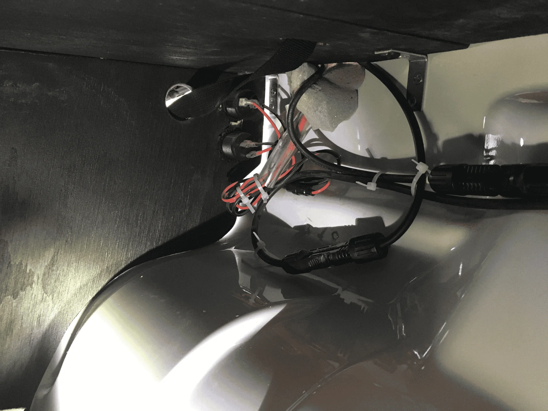

one problem hole was the large oval hole i had wires going into from under the bed (with the 12v wires from the battery). i didnt feel like buying new plugs from the dealer for this invisible spot (under the bed) just to cut holes in them, so i just left it empty. bad idea- dust billows up from the road into the bedwall and into this gap easily. now it is sealed nicely with a chunk of leftover memory foam from the mattress which forms around it and seals nicely, after a couple months of use.
a couple linear gaps in the rear top of the bed were covered with electrical tape, and then the large gaps- in the top four corners of the bed, and the tailgate itself at the corners at the bottom had large gaps that i filled in with 'great stuff' brand 'pond and stone' spray foam (perhaps more up to handling the elements, and has a black color which fits the general look of the truck better than the yellow color of typical spray foam. just a few squirts, only enough to seal the gap, and intentionally NOT enough to make a larger hidden spray foam collection in the bed wall that might be a future rodent abode. i used a knife to trim it back to a reasonable contour after it expanded.
Note that spray foam was also used for two large gaps in the bottom corners of the liftgate that could not be sealed with the rubber strips.
The liftgate was sealed with a kit. We bought this one from amazon: https://www.amazon.com/gp/product/B07YF5BL8M/ref=ppx_yo_dt_b_search_asin_title?ie=UTF8&psc=1
it is decent. i would mention that it took me far more than three suggested tries sticking and unstucking and sticking to get them aligned right, as the way the liftgate closes it is very difficult to get the sealing strip to be compressed, but not stick out and make the sealer strip squeeze out around the edges and look ugly. After many months, super hot temps, a ton of dust and offroading, they are still sticking in place and sealing well. The one thing I would say is that i was applying a little light tension to the strip while applying it to lay it down straight and over a month of hot weather after applying it it retracted a little. This has only mattered where there is an interrupted strip of sealer along the floor liftgate/bed interface, where there is a larger strip on the sides, then a long strip of medium strip in the middle. The retraction has left a 1/4" gap at each interface that i don't like looking at.
it does let a little dust in while offroading (most would consider this trivial, but my wife is very.. sensitive) and i could close it with a little silicone, but i am tempted to leave it as-is as it will let water that collect in the bed drain if we are unlucky enough to get into that situation.
The last spot are the gaps in the front of the bed along the floor. These are abotu 1/4" and too small for mice to get in. small bugs might, and we definitely get dust in there, but it is less dust in those gaps than the gaps around the liftgate for whatever reason. I could lay a bead of silicone down to seal these easily, but i liked the idea of having them open to allow drainage if the bed gets water in it. so i temporarily sealed these by laying a strip of memory foam about 2x2" (leftovers from the offcuts from our memory foam on the bed) across the front, and these stay in place with the storage bins and drawers pressing up against them. in months of use they have not moved. they keep 99.9% of the dust out, although admittedly i am not sure they would really let water drain out all that well.
this is the dust collected under the memory foam "seal" at the front floor, after a couple months of regular outside and dusty road use.
then comes the topper.
in preparing for the topper, i ran a thin bead of clear silicone around the entire edge of the bedrail, where the plastic bedrail meets the outside of the truck. this would probably attract dust and look ugly with the topper off, but the topper lip hides it.
then the topper goes on. as noted elsewhere and by every topper person we spoke to, the ranger is a difficult bed to put a cap on, because it isnt one flat bedrail, but has a dip in the front, and because of tolerance issues ARE (and perhaps other companies) dont make a tight fit, so there is weird large gap in the corners at the front, and you need topper sealing tape of varying heights to make it seal all the way around, and subsequently have gaps between the sealing tapes. the side rails have one layer of foam strip, and the front has about three, and it still doesnt conform, so eventually the guys who put the topper in just gooped a bunch of silicone on it to seal it. it works, but it means the topper is basically glued on in the two front corners and if we wanted to reposition the topper or put it on and off it would probably tear the sealing tape and make us start over sealing the front side of the topper every time. not satisfactory for people who put the topper on and off. a better solution might be some of the high-volume topper sealers available online, or putting a chunk of very soft foam in those corners and let the topper compress it. i bet some of the garage door sealer products i see in the big hardware stores would work, as they seem robust, compressible, and tall.
the liftgate on the topper has a good seal at the top and sides, and a nice overlap and gasket at the lower lip, but the bottom corners have a wide gap and a junky fit at least on our model. these let in quite a bit of dust, and rain when the angle or speed is right. for the first few months, we dealt with this by shoving a rag into each corner of the liftgate, sittting partly on top of the bedrail, and it keeps out 75% of the dust and gets soaked in the rain and we just dry it or wring it out. then I played around with the many bits of sealing foams tapes and whatnot that i had lying around and never made a satisfactory solution here. Especially as the topper on our truck doesn't fit exactly straight, but gets a better fit at a slight angle, so the two sides arent exactly symmetric. ultimately i made a decent seal with a piece of closed cell foam that was originally pipe insulation, and silicone glue.
but it isn't robust and looks a little goofy. after a few weeks of use one already ripped, and i would probably have to replace them a couple times a season to make this work. i would be eager for better ideas for this spot, perhaps revisiting the garage door and window sealing aisle at home depot is in order. decent photos of that interface and the gap can be found at the end of my ARE topper thread. https://www.ranger5g.com/forum/thre...nstalled-today-is-this-right.7913/post-157333
finally- sealing the cab. well, obviously its pretty good as-is, but then you start running wires and antennas into it and motivated critters can get in if they want to. Those issues are sussed out in other threads. thankfully the cab isnt a problem for us.
final result:
dust: barely any. after a long day banging around on dusty roads there is enough that it lays a fine coating on the foot of the bed and along the liftgate, but not enough that most people would be annoyed.
water: after a hard rain or driving on the highway in the rain it will let an Oz or two of water in along the tailgate/liftgate gaps (less when the homemade gap seals are working). this is controlled well with a rag, or a wipe after a drive. Not ideal though.
after a heavy rain and some driving you can see the water rolling down the bedwall after we open the tailgate. note this is before i put the little foam gap fillers in.
rodents: mice can get into the cab as-is. with the tailgate down mice and rats can get into the bed (they seem to make their way up the wheels to the underbed stuff to the liftgate /bed gap and in. since figuring this out, when we are in places that see camper traffic (and therefore the rats and mice have figured out where the good stuff is) we close the liftgate behind us at night and have never had a problem since.
