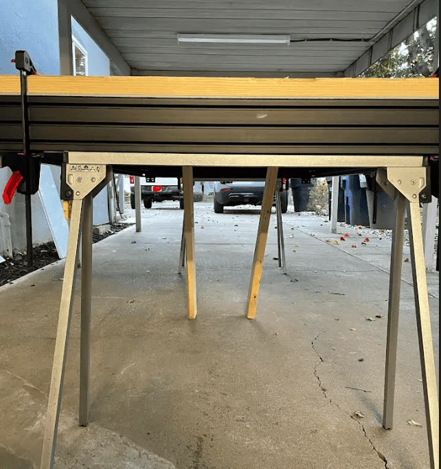

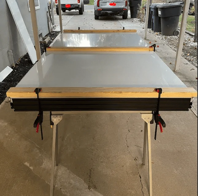

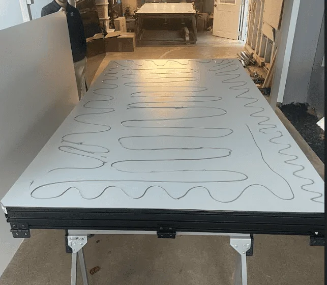

Got the floor panel glued/laminated together last night. Threw down about 2/3 a tube worth of liquid nail adhesive on the panel and clamped them together. Really straight forward.
Cure time is 24 hours so I will mark out and drill my mounting holes tonight. After that, I will be taking a break heading into the weekend to spend time with family for Thanksgiving. Hope everyone has a safe Thanksgiving!
Liquid nail on bottom sheet:
Clamped together with 2x4s across the top:
Added some center supports to keep pressure on the 2 sheets in the middle. Without these the center bows and the top 2x4 doesn't make good contact with the full span of the sheet in the center.

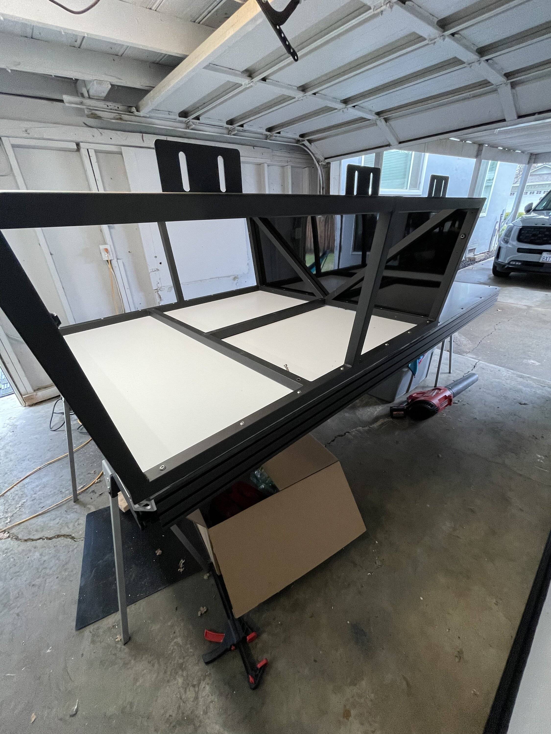

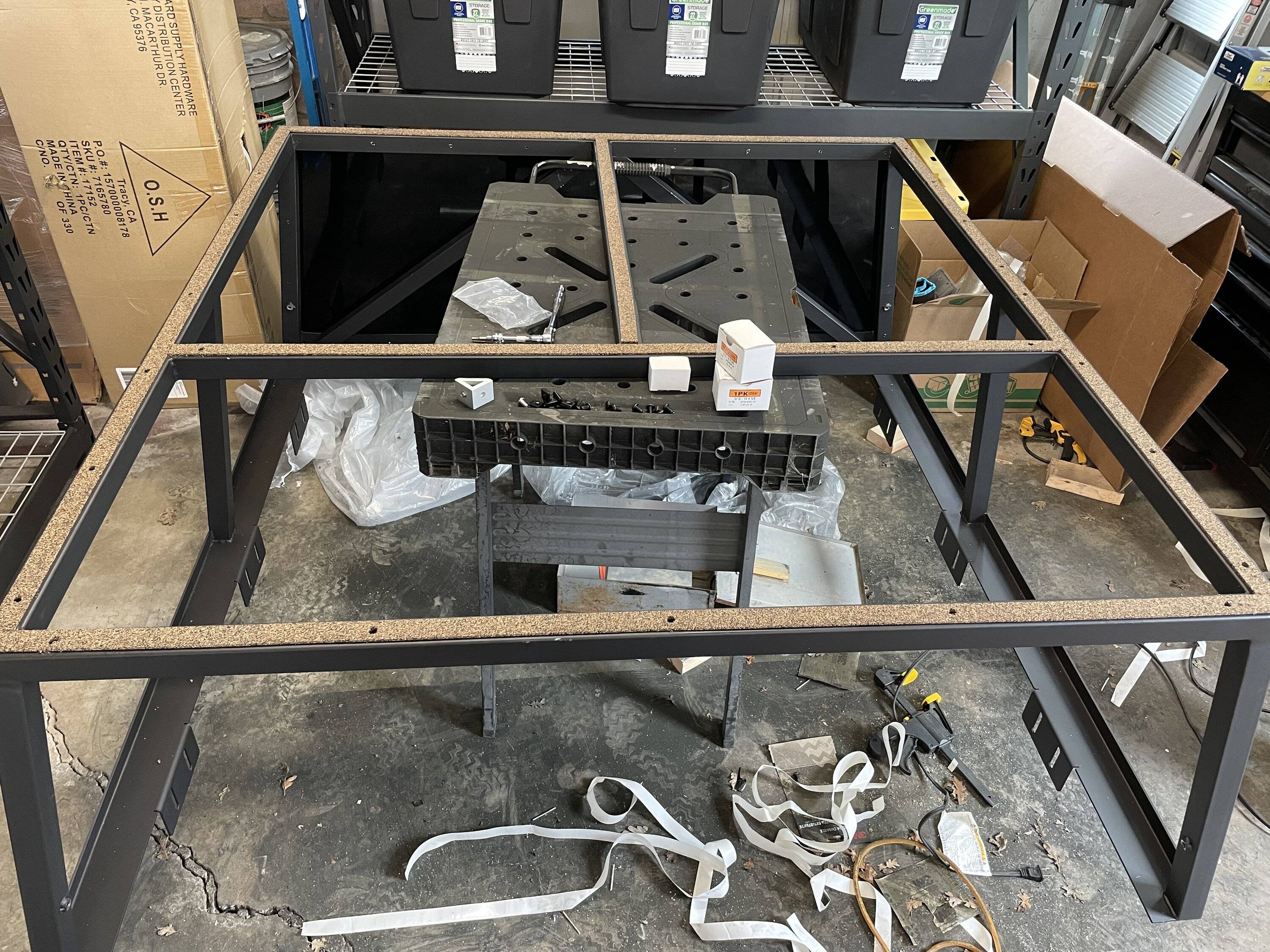

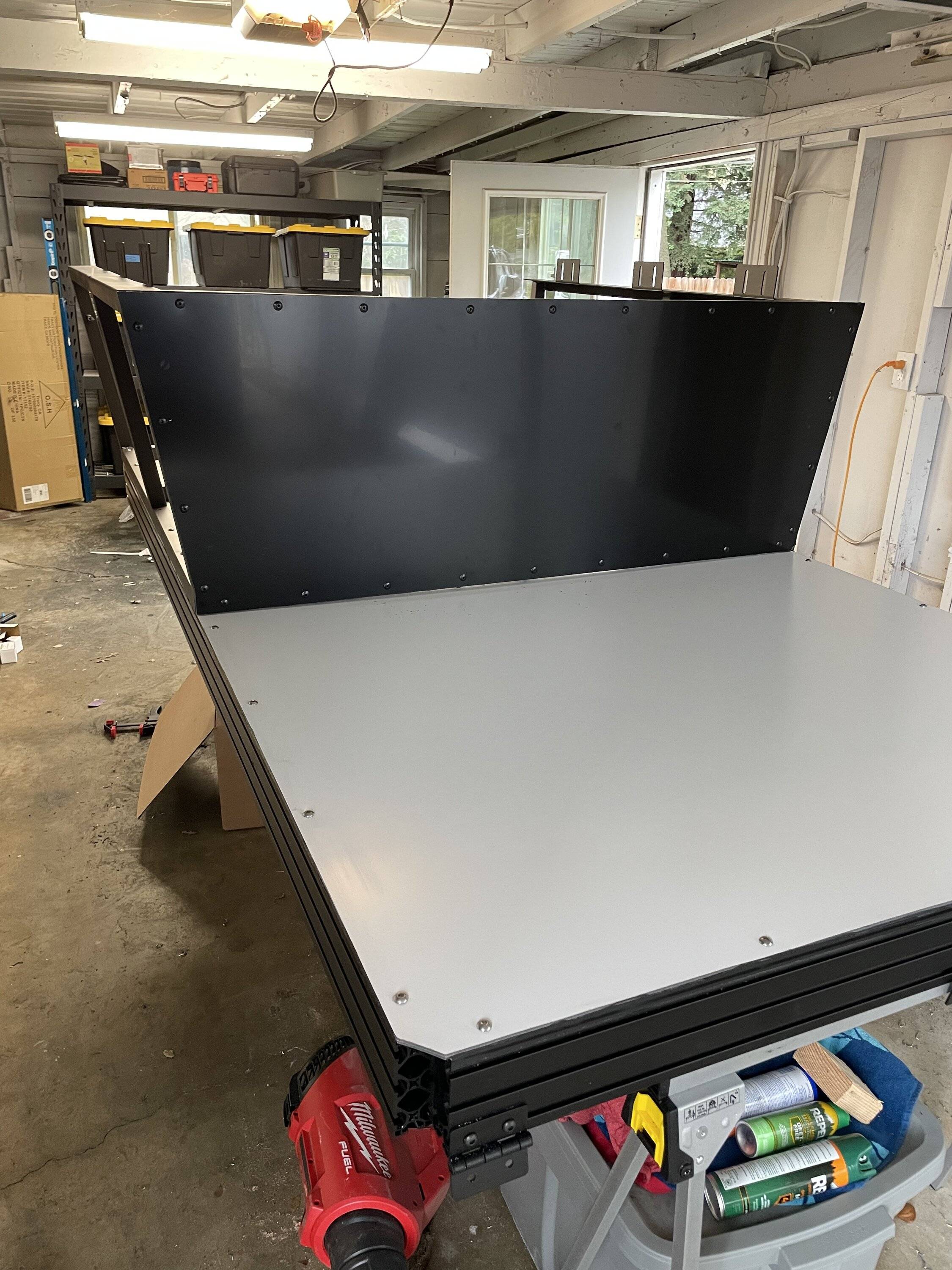

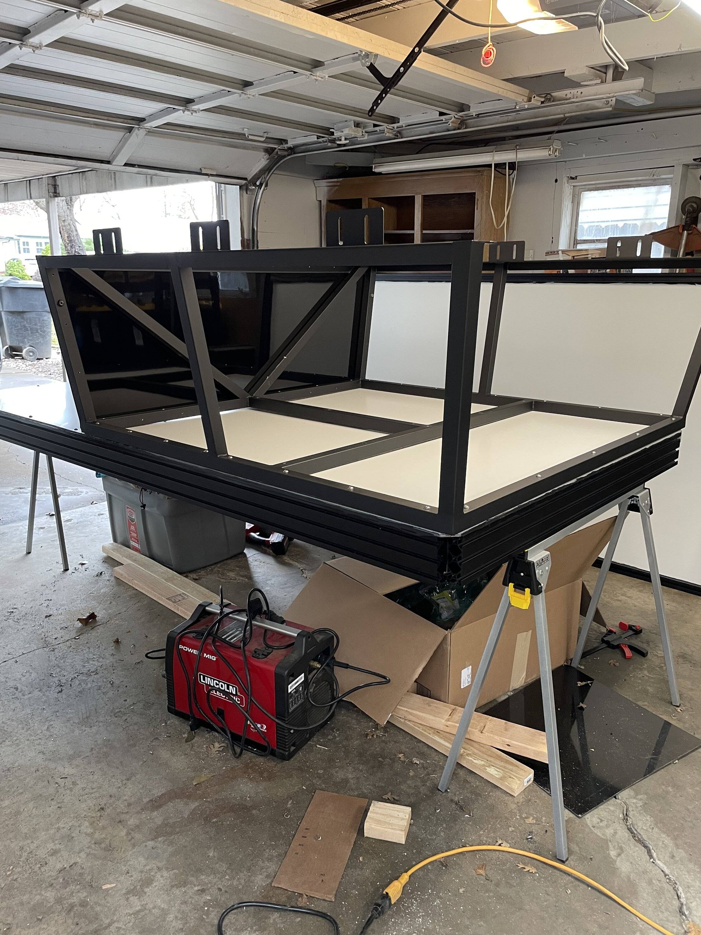

OK thread has been dead for a minute but I have been working on it when I have time. Made good progress on the frame, and it is finally all done and painted.
I was able to mount the front bulkhead panel last night as well! Riveted it on with black flush-mount rivets. I sandwiched some rubber/cork gasket between the panel and the frame. I will go around and seal the outside edges with polyurethane as well.
Now that the bulkhead panel is on, the next step is mounting the wedge to the frame. Hoping to do this in the next couple of days!

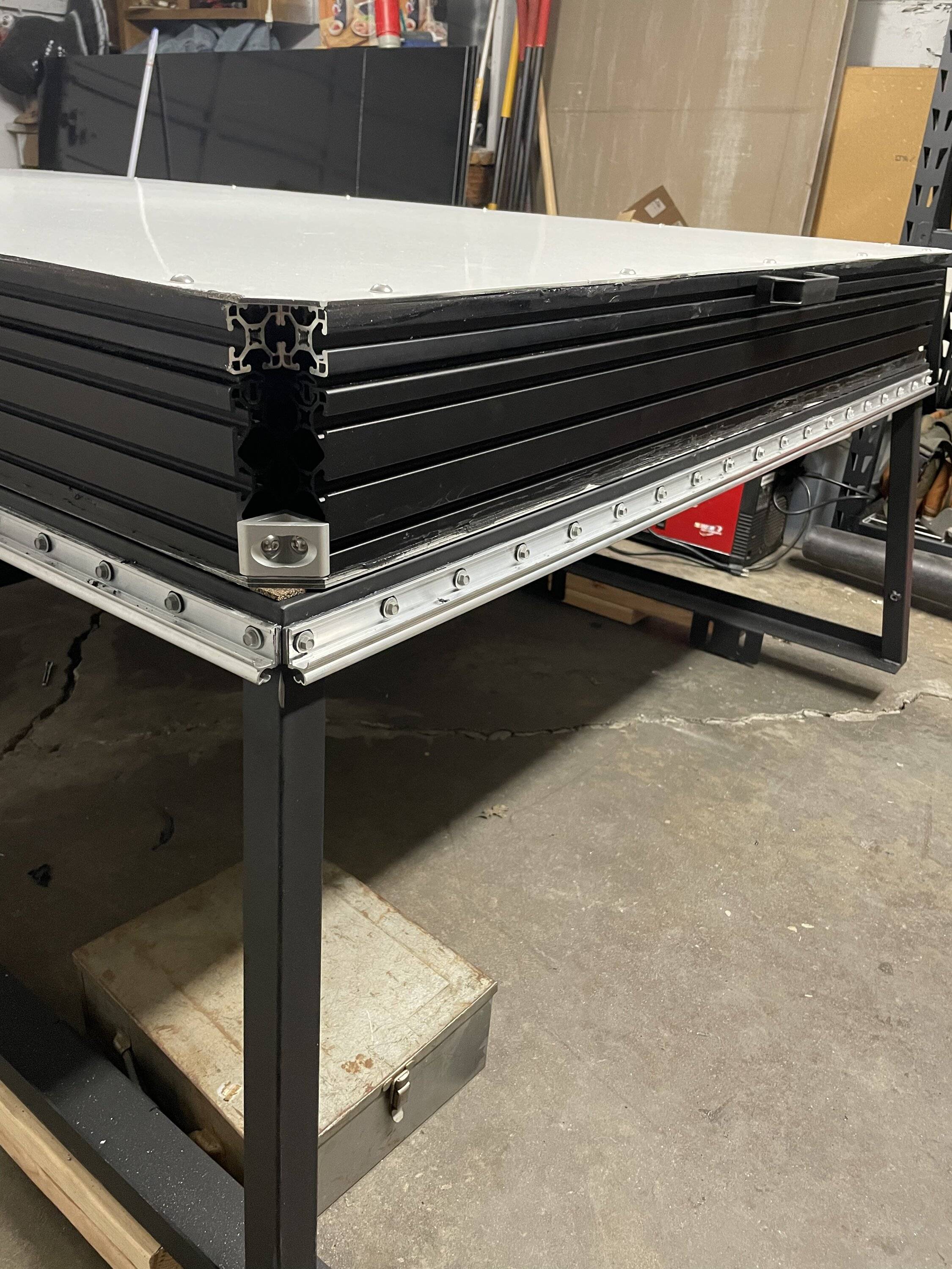

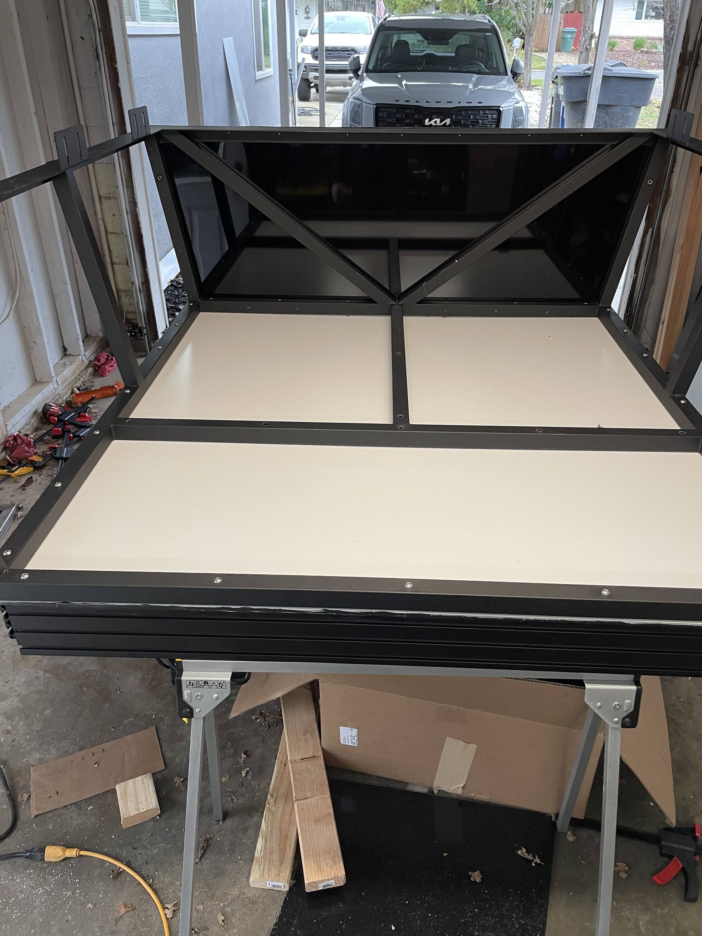

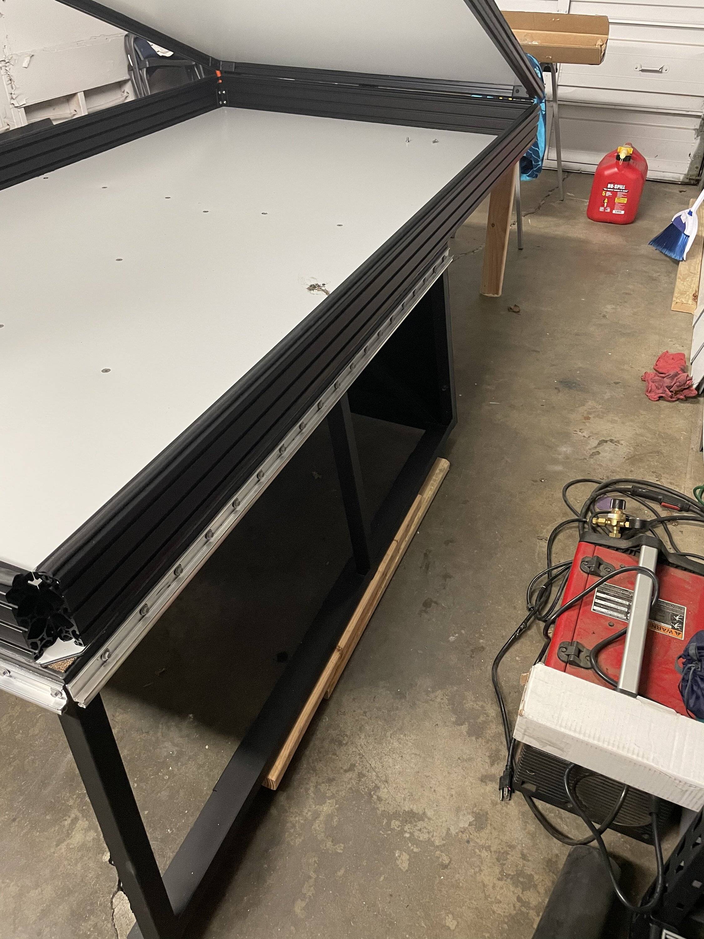

Got my space frame mounted to the wedge this week and sealed! I used a rubber/cork gasket in between the metal frame the max metal. I also ran beads of polyurethane sealant between the max metal and the extrusion to make sure it’s water tight. Bolts go through the frame and mate with t-slot nuts in the extrusion frame, effectively sandwiching everything together when it is torqued down. Once the urethane cures I will go back and touch up any open gaps.
I still have to add my support bolts in the center of the frame, hence the small gap in the center of the panel and frame as seen in some of the photos. I will countersink these bolts from the top side and use flat head bolts with a nylon lock nut on the bottom.

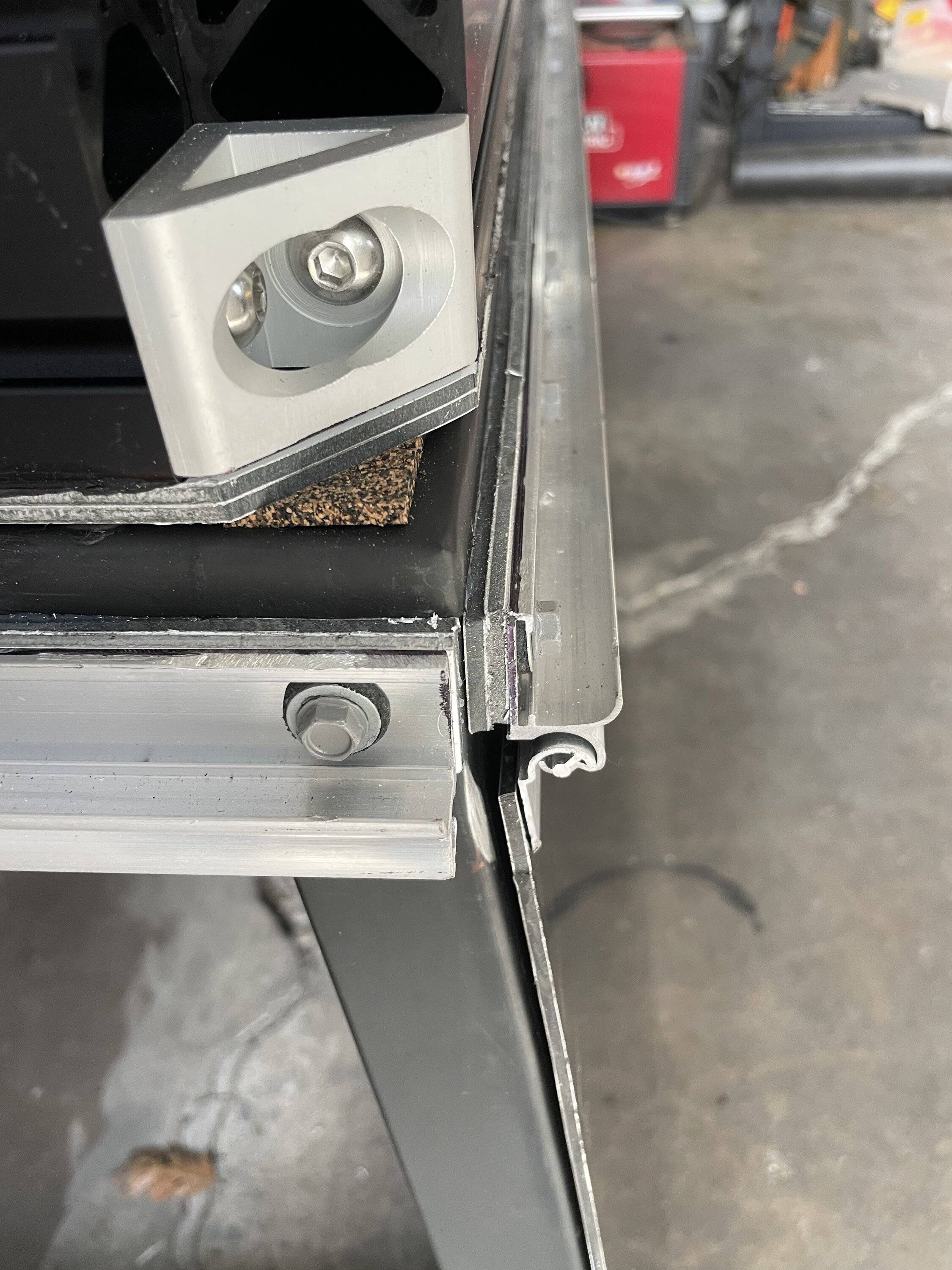

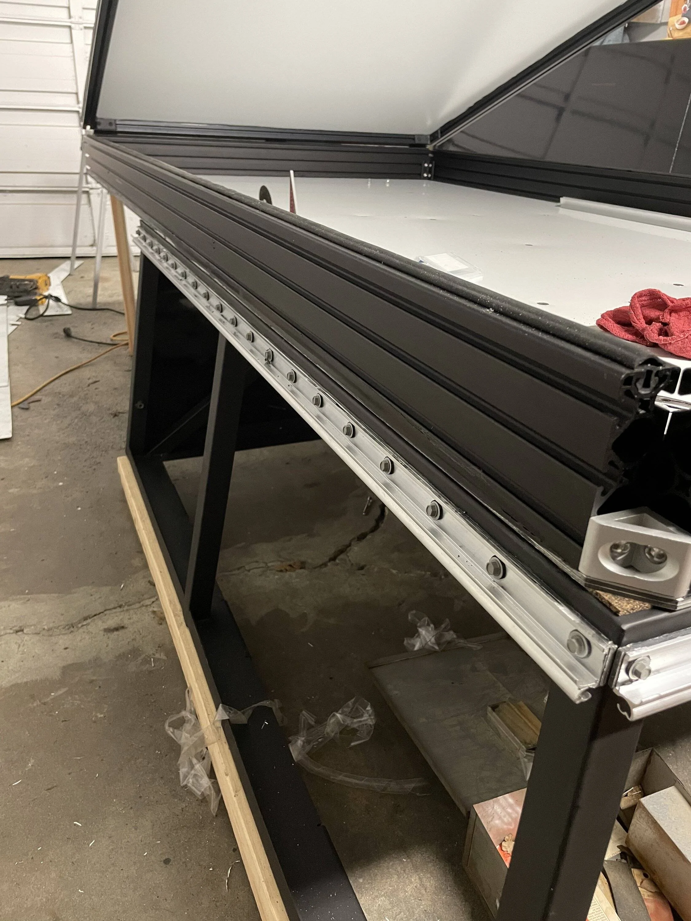

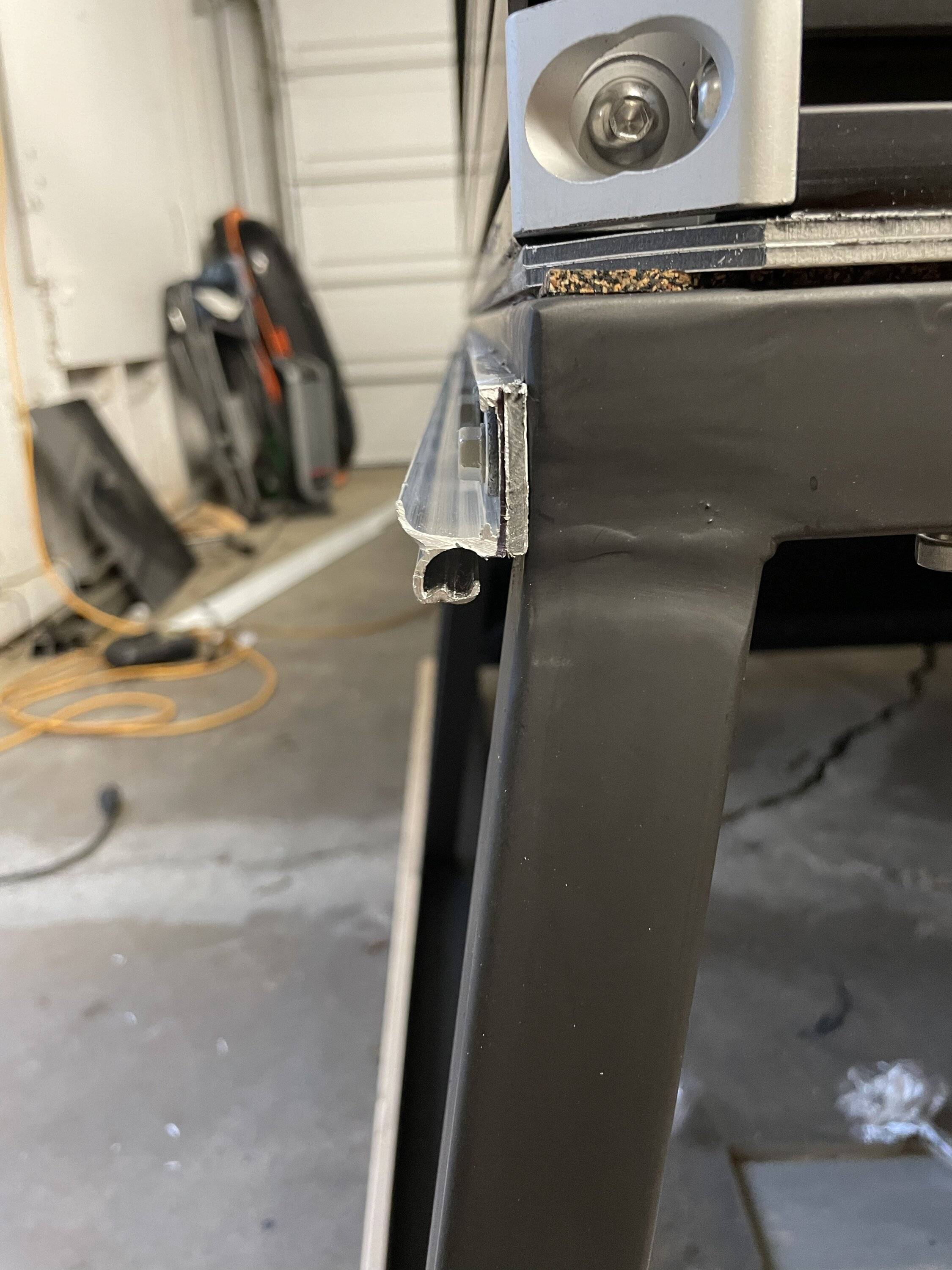

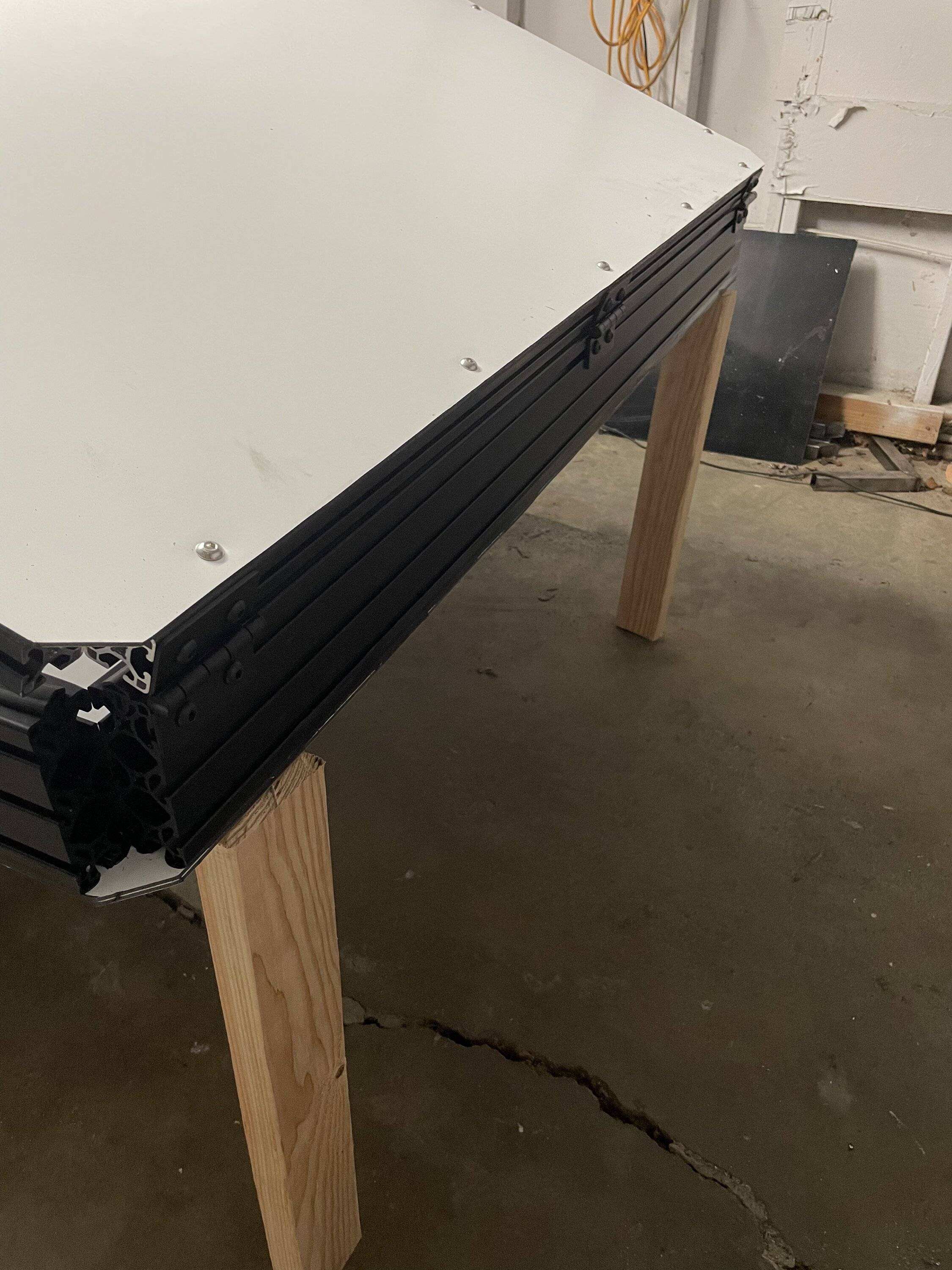

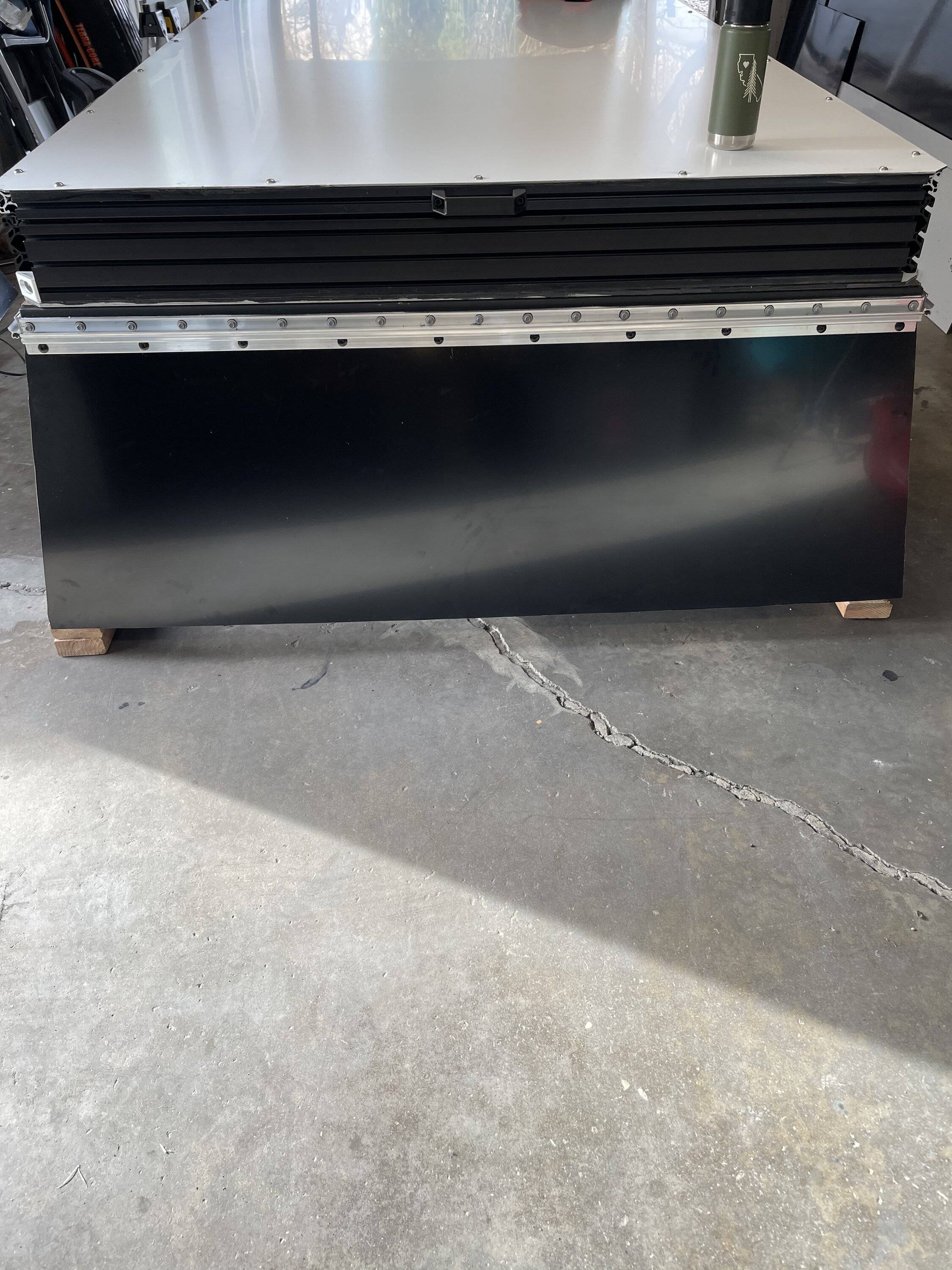

Put in some solid hours today working on the wedge camper. Got it flipped and added the countersunk support bolts in the center of the frame.
I also put the pop top on and attached the front hinges. After that, I added my thick channel gasket between the top and bottom of the wedge for when it’s closed. Lastly, attached my hurricane hinge for all of the doors! Lots of progress and she’s really coming together!
I chose to go with the hurricane hinge because it has a built-in gutter as seen below. It’s also a continuous hinge that nests inside itself making it extremely waterproof. This will help with water running down the inside of the panels during rain or when I wash the truck. I also added a strip of the panel material behind the hurricane hinge to fur it out slightly so the panel can rest properly against the gasket on the frame.

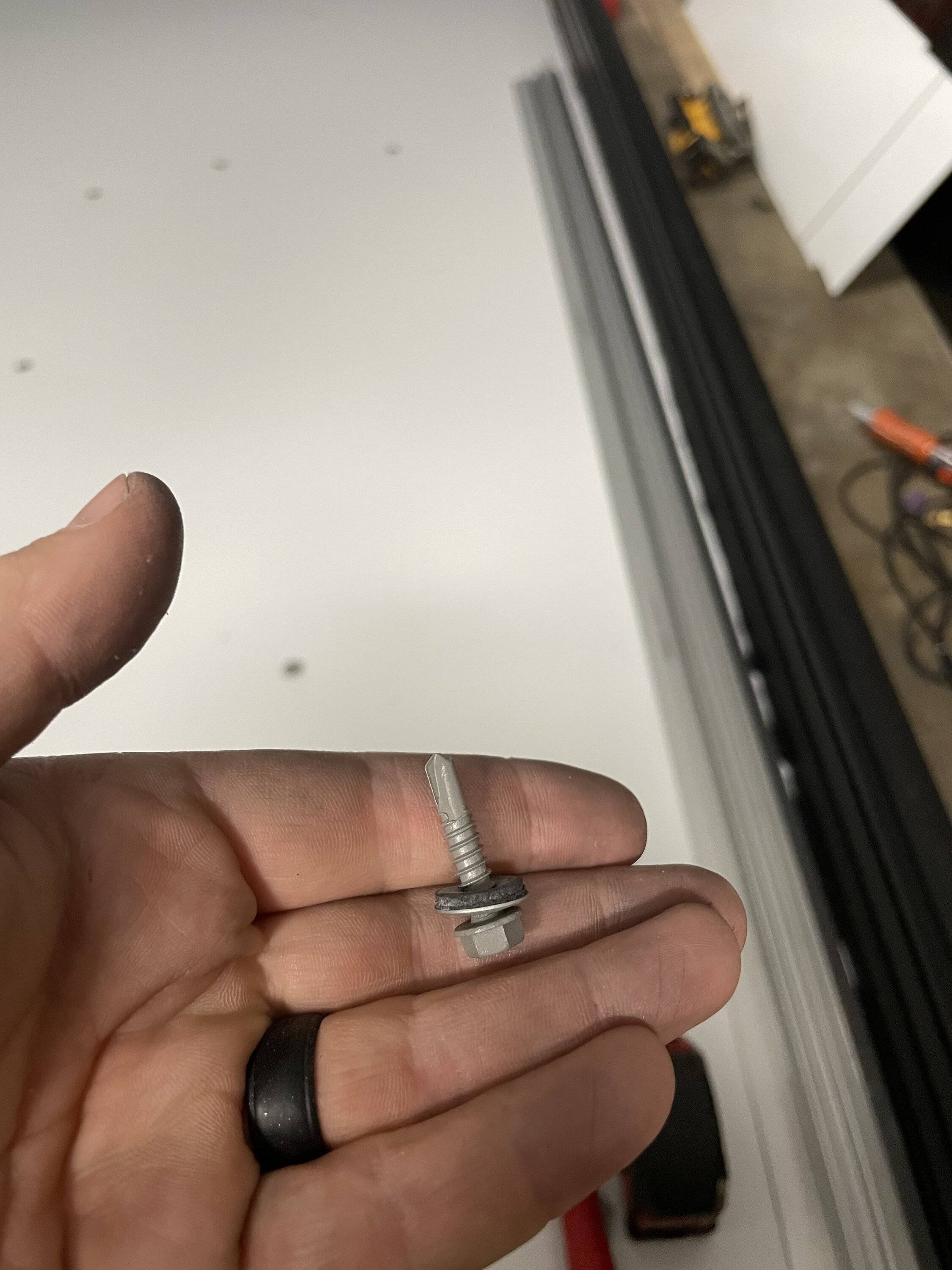

I attached the hurricane hinge with some self tappers that are used for sheet metal roofing. They have a built-in rubber gasket so they seal water tight when torqued down.

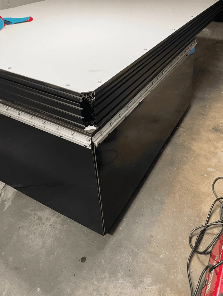

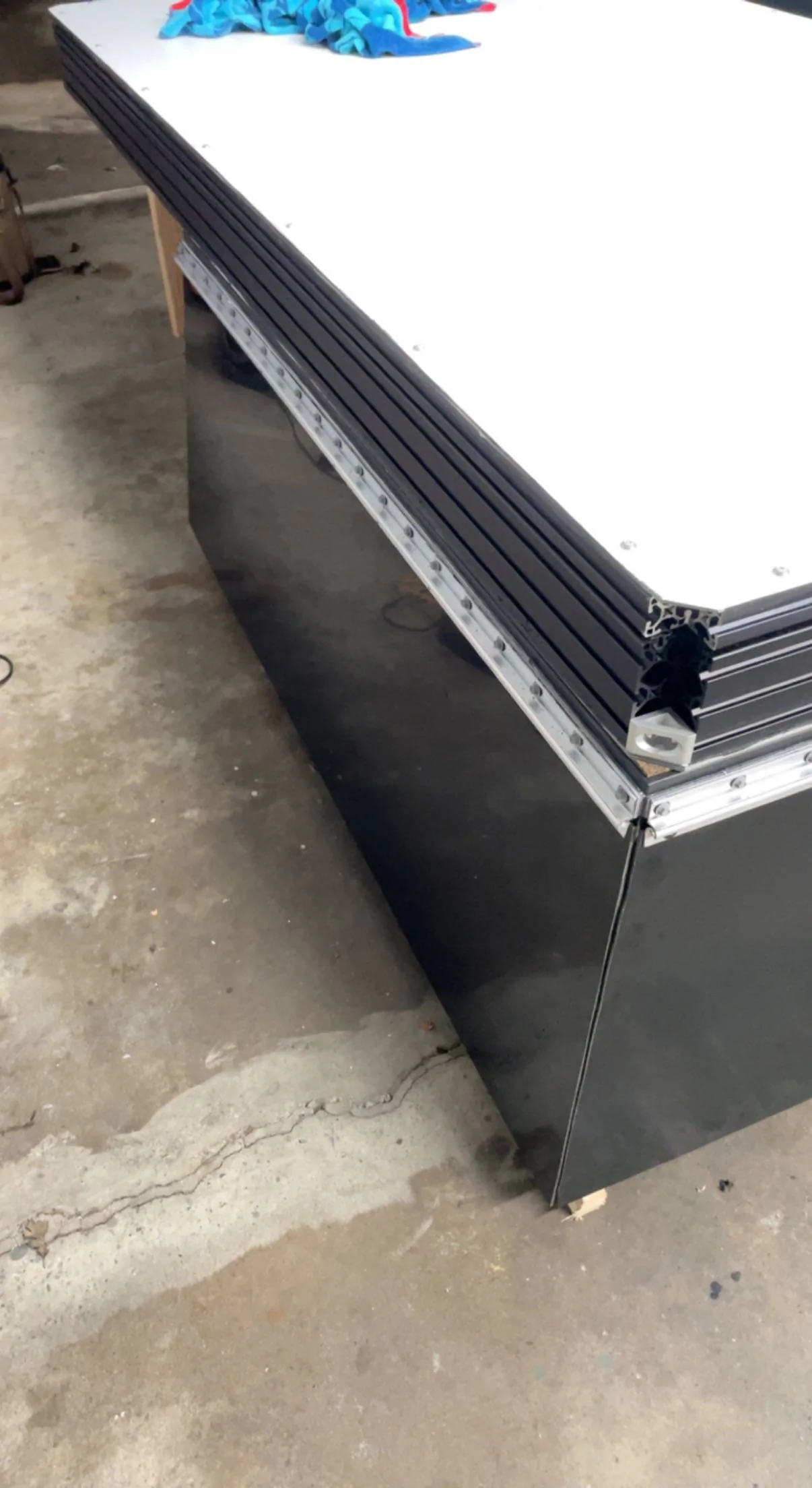

Well, made an error yesterday and forgot to factor in the thickness of my panel gasket when making my shims for the hurricane hinges. Because of this, my spacing was going to be off where the panel meets the frame and it was going to be an issue. I added a second shim the same thickness to all of my hinges this morning and it ended up being perfect. Had to do about 2 hours of rework, but I’m happy I caught it and it came apart and went back together smoothly. Pictured below is the hinge mounted with the double shim. You can also see the spacing between the panel and the frame. It should be perfect with the gasket.
I got my rear panel riveted to the hurricane hinge and trimmed to size. I found the easiest way to do this was rough cut an oversized rectangle and then first rivet the hinge to the panel. Since the hurricane hinge is two halves that slide into each other, one half stays mounted to the camper and the other can be removed. You’ll rivet the half that can be removed to your rough cut panel.
After that, I mated the two halves back together on the camper and traced the true size of the panel with sharpie. I then pulled it back off and cut the panel to size using my markings. I think it turned out really well! Also saved me the hassle of using measurements and straight edges etc.

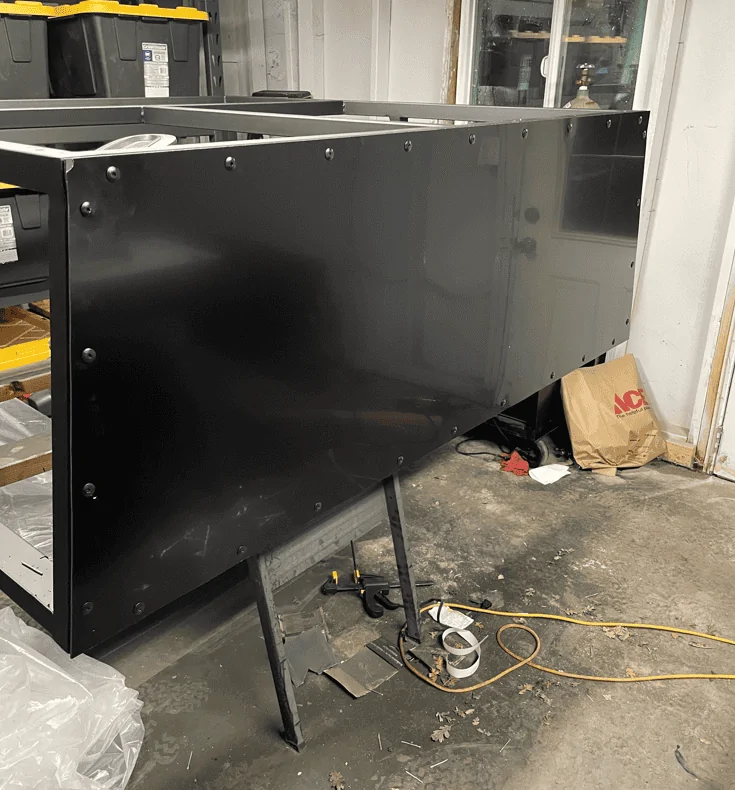

First side panel went on last night. I’ll do the other side tonight then all of my panels will be done!
I am a little concerned with how much the doors open since the rivet interferes with the hinge right about 90 degrees. I would have liked to get 100-110 degrees of opening but we will see how it looks mounted on the truck.
If it becomes a big issue, I may have to drill out my rivets and use a slim nut with a flathead on the backside to try and get another 10 degrees or so of opening angle.

I got my last door panel on last night. I drilled the rivet holes roughly 1/8" lower on the hinge this time and this allowed the door to open much more and not interfere with the top hinge. With this, I was able to achieve my 110 degrees of opening which was awesome.
I went back and ground/sanded down some of the other rivets where they interfere with the hinge to provide a bit of relief and this worked great for the other panels. I will fine tune this over the weekend when I mount my gas struts.
