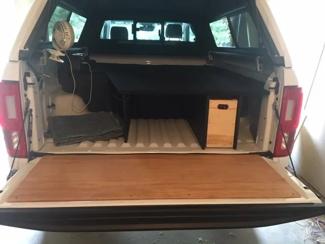

I would like to install a quarter inch sheet of plywood onto the tailgate to protect the paint and provide a flat working space while camping.
Does anybody have some tips?
I’m assuming I can take out the screws that hold down the upper inside panel of the tailgate and use longer versions to attach the top edge. (what is that panel anyways?)
then will probably need to drive some sheet metal screws to hold the lower edge.
Is there any critical wiring it would not tolerate running a few sheet metal screws blind into that lower portion?

and i wouldnt be so ghetto and use sheetmetal screws.
use rivnuts (threaded inserts). install them into the tailgate, they'll stay there and you can use countersunk screws with recessed washers for a flush fit. you can remove and replace them easily.
https://www.princessauto.com/en/det...VZPl2MzqArvxlSUfEmjZU846rpcU65qRoCwuYQAvD_BwE
youre right. rivnuts would be way nicer but i dont really have a final solution yet so i just used a sheet of 1/4" oak plywood and drilled it to the same pattern as the four top sheet metal screws, with a few dots of silicone at the lower panel to hold it in place.
not as sturdy, but works well for now with no modifications or additional tools.
the plywood is weak stuff and will probably be replaced every other season, but its nice and flat and comfy, even in full sun. bamboo is too expensive online, but if im driving through a place that sells it cheaper would probably upgrade in a heartbeat.
i took out the four sheet metal screws and replaced them with slightly longer same-thread bronzed countersunk screws and it looks and feels nice enough for now.
the edges are routed with a 1/4" roundover bit to make it pretty and take off the edges.
tip for folks thinking about a similar project: to get the screw pilot holes lined up perfectly: back out the stock screws you are going to usen so they sit above the level, mark up the screw heads with a pencil, then lay the wood or board down on top of them and push down. this will mark the underside of the board and you know exactly where to drill matched holes.
