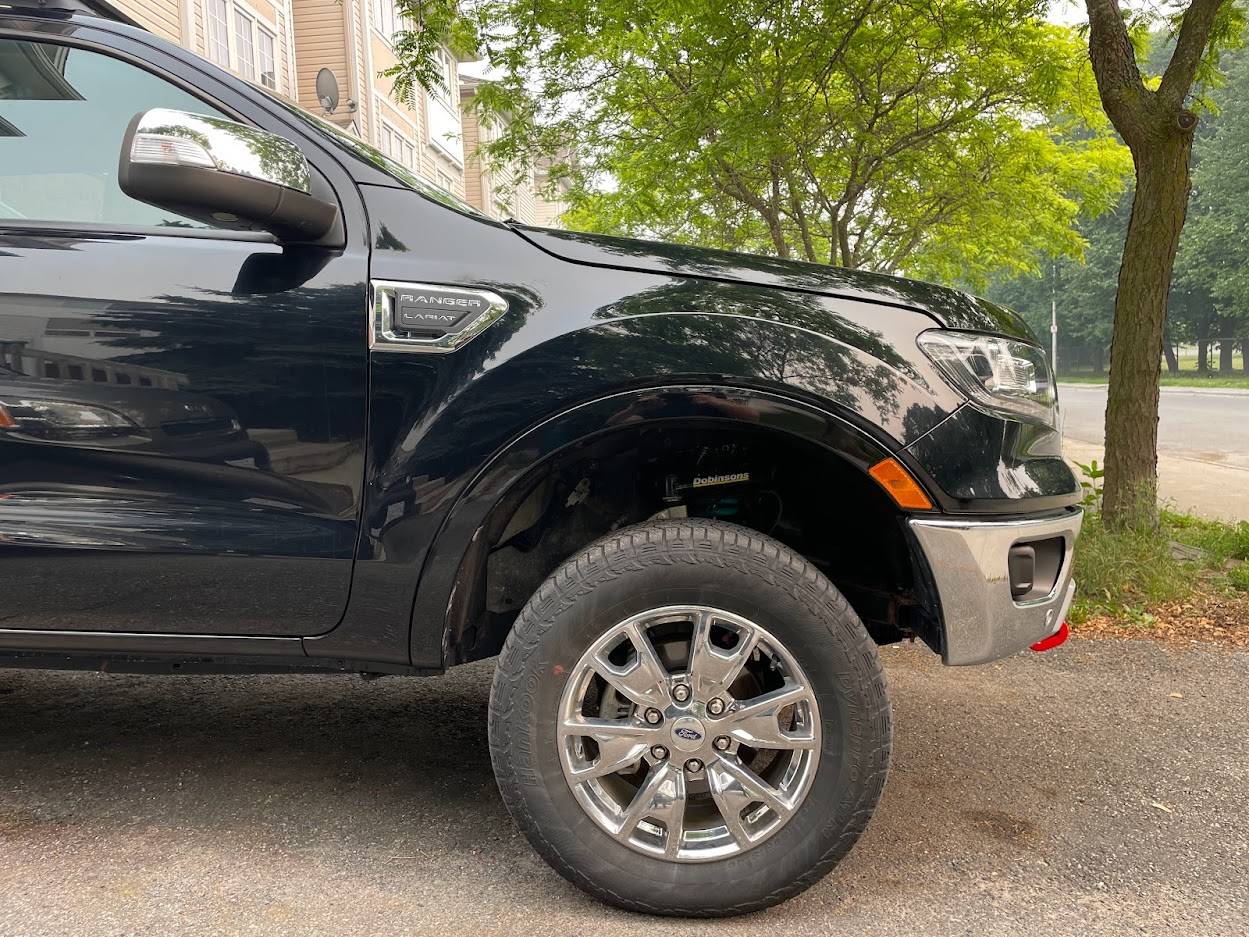

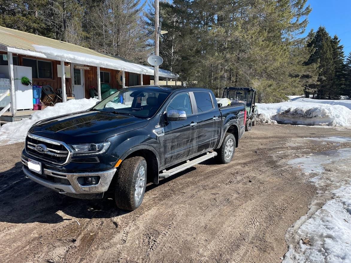

Added a pic of it when picked up in December. Expecting to do most mods by spring. It's still full winter where I am and driveway work is a pain.
I'll keep updating as it progress. Here are some pics of the truck being replaced, the Ranger when I got it and the Ranger this past winter.

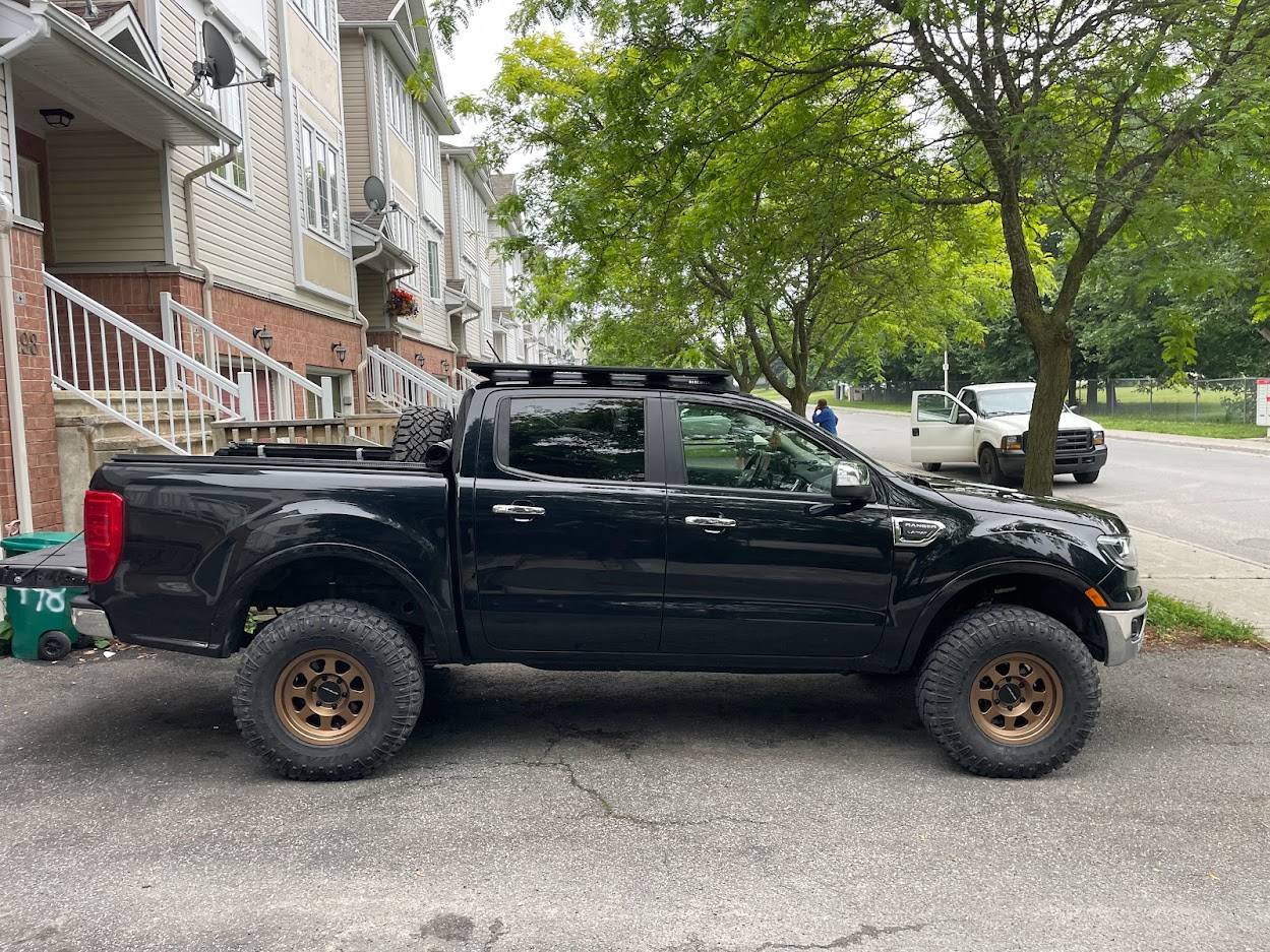

Just a quick update. I'll post pics when I get a chance to grab some clear ones.

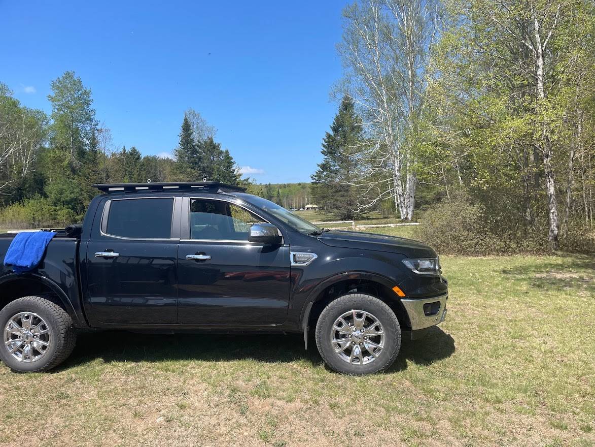

1. ARB Base rack
- Installation went fairly well, short of chewing through the cheaper step bits from amazon. There were 4 holes that needed expanding and another 8 that were new.
- The rack came mostly assembled and all that was needed was getting the backbone on then bolting on the fully welded platform.
- I also had the 2 side bars that I put one, but quickly removed as I usually side load the rack and they looked a little like ears when the rack was bare.
- I purchased the BASE255 49 IN (L) x 51 IN (W) model with side rails for my Dual Cab SuperCrew. I recommend just getting the BASE251 and save a few bucks without the side rails.
- I grabbed a few eyebolts and some tbar adapter to mount some Maxtrax recovery boards
Link: https://arbusa.com/roof-racks/arb-base-rack/

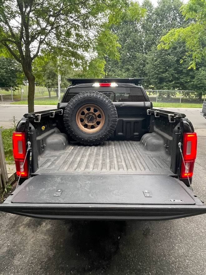

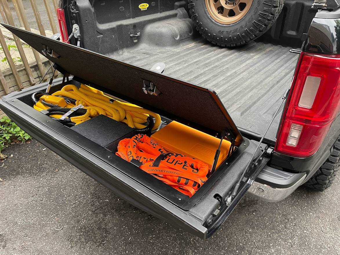

2. Huracan Fabrication Tailgate Storage
- Another straight forward installation. Mostly just a lot of cutting.
- I chose this since the box/tub is smaller than my previous truck and the lack of underseat storage. This gives a good size sealed and lockable storage in the tailgate.
- I opted for the polycarbonate top sheet as well since it will also act as a main camping surface.
- I added a bead of sikoflex around the edge just to help with some sealing since I will be running the truck without tonneau or cap. They seem to now have a custom strip for this very reason.
- I also added the legendary tailgate dampener to help with the added weight and improve my HP and full mileage.
Link: https://hfabusa.com/collections/ford/products/ford-ranger-tailgate-storage

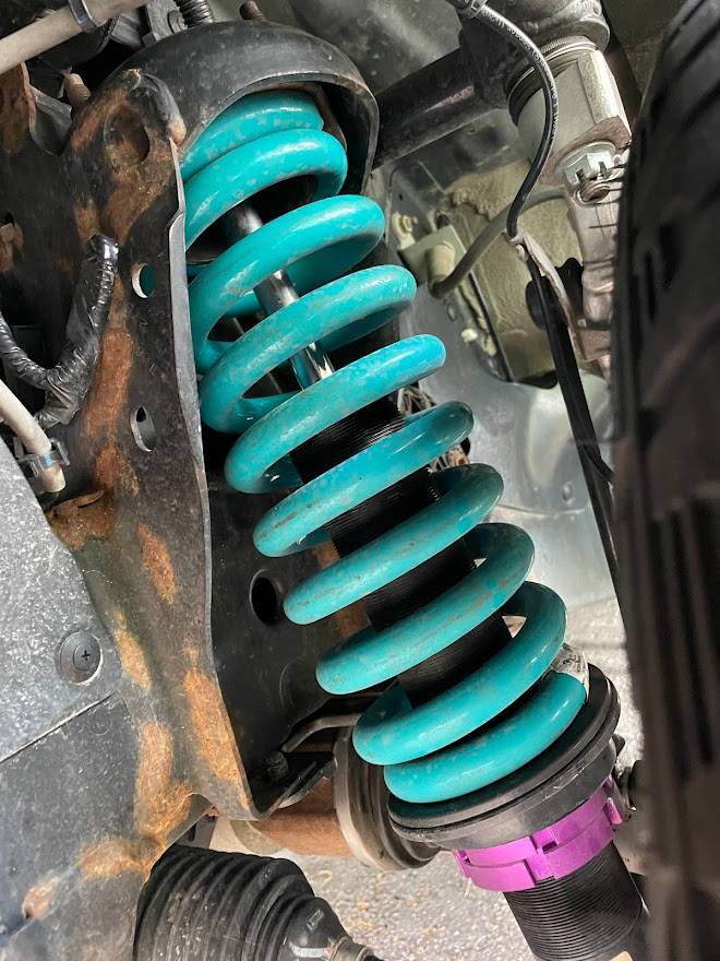

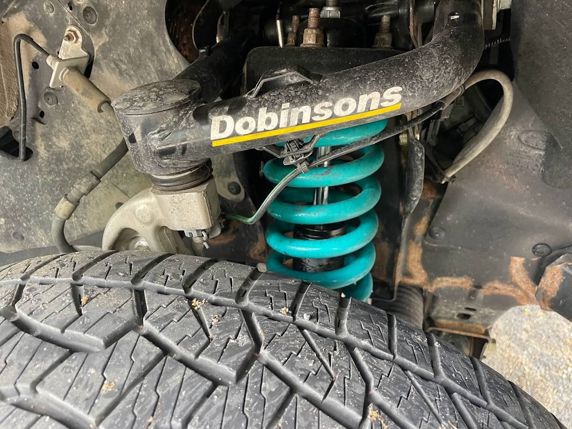

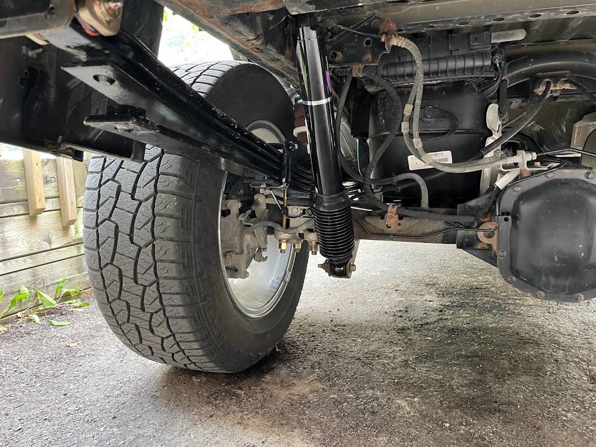

3. Dobinsons 3" IMS front coilover suspension
- I have completed the full front end suspension upgrade.
- This includes new front and rear intrusion bars from BDS. I removed the front bumper and removed the front bars. For the rears, I chopped them in half to remove and the new ones were both easy slide in and bolt.
Link: https://bds-suspension.com/instructions/123614.pdf
- I opted for new Dobinsons front Upper control arms (UCA19-009K). These were simple bolt off - bolt-on. One note, I did have to grind open the knuckle end opening slightly to fit the ball joint in. The taper was slightly off, maybe 1/8th off.
- The same bolt on simplicity was seen when changing out the new (SE19-570) Front Sway Bar links (Shortened to prevent bottoming out with the control arm).
- Setting the height on the (IMS19-50096) Front IMS Struts was easy, they came with the required adjustment tools. I also purchased a set of the purple rings that are standard for the Australian Rangers. (NA get black rings).
- The hardest part was compressing the new 75mm front coil springs (C19-536) these are good for a 0-110lbs load. The compression tools I had could not get these compressed enough to assemble. I ended up getting a shop to assemble the coilover and then bolted them on in the driveway.
Link: https://www.dobinsonsdirect.com/pages/product-result?rq=mk_ford~md_ranger-usa~yr_2019-2022

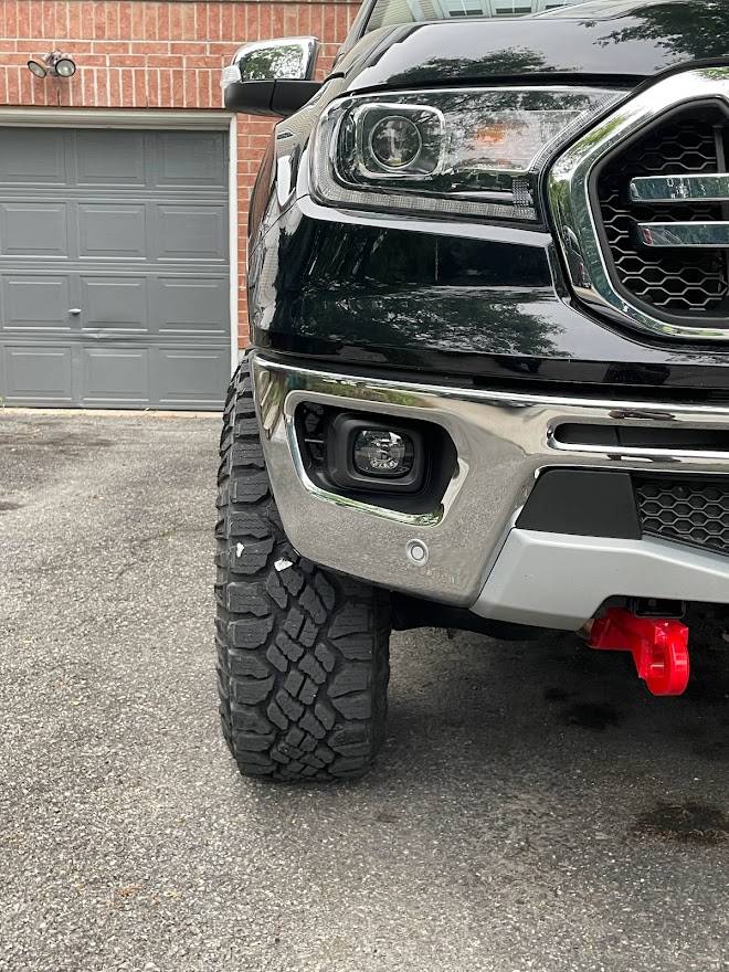

- ARB Recovery points were installed, pretty straight forward. Just bolt on
I’m going to suggest avoiding this one. I have it and while the idea is awesome, the benefits don’t out weigh the drawbacks for the cost.
First is the cost, for under a 100 bucks you’ll get the same storage if not more out of a nice Milwaukee portable tool box. Plus you can use it as a step to get into your bed.
Second is the weight, god damn it’s heavy empty let alone with recovery gear in it.
Don’t expect a tailgate damper to help here. If this was made out of carbon fiber than I could potentially see the value.
Third is the latch rods are just a bitch to get lined up correctly.
Did I mention it’s stupid heavy.
Side note, if you have a silver ranger and want this product I’ll gladly swap you tailgates and 400 bucks on your side.

Naaa I’d give them a solid 3/5 stars purely on a good idea and great build quality. A slight redesign could solve the latch mechanism and switching to a lighter material would be a game changer.
Honestly if you don’t mind the weight it’s a solid buy as long as the cost doesn’t matter to you.

The main reason I wanted it was the fact that I am running open tub/box with the truck. It gives me quick sealed storage. Also, no racks or canopies, and upgraded leafs, so the payload can take the extra weight.

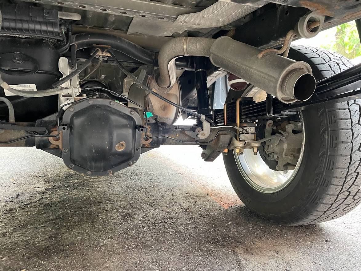

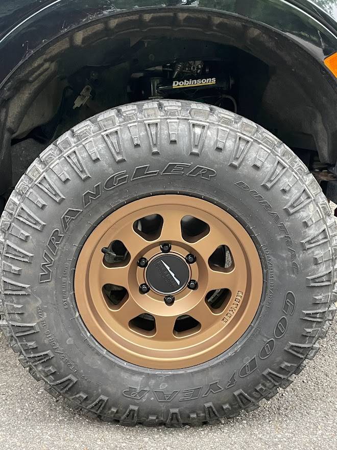

Suspension Done
- Dobinsons 3" IMS full kit with parabolic leafs. - Fronts are done, leafs, bushings and shackles installed.
- BDS intrusion bars front and rear. OEM bars chopped and removed, BDS bars installed
Notes:
1. I needed to widen the opening on the knuckles where the UCA ball joint connects. Maybe just 1/8th with a small dremel.
2. The zerks on the the greasable shackles were 90 degree fittings and my grease gun wouldn't connect right. I replaced them with some straight fittings.
3. I needed to chop the side exit exhaust tail pipe to clear the extended parabolics.

I am anxious to hear what you think if the Dobinson's. They've been on my radar for awhile, but I haven't seen anyone actually run them.
7,142
24,334

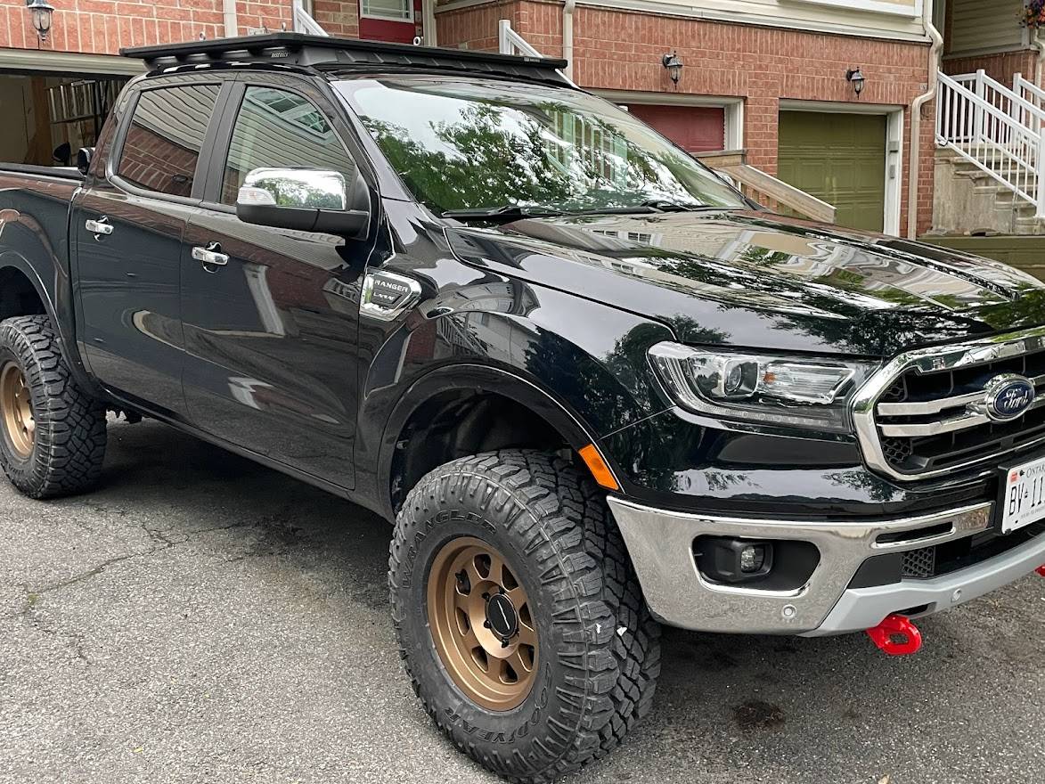

sharp wheels! its nice to see something other than black on a wheel.

Very solid! What tow hooks are those?
