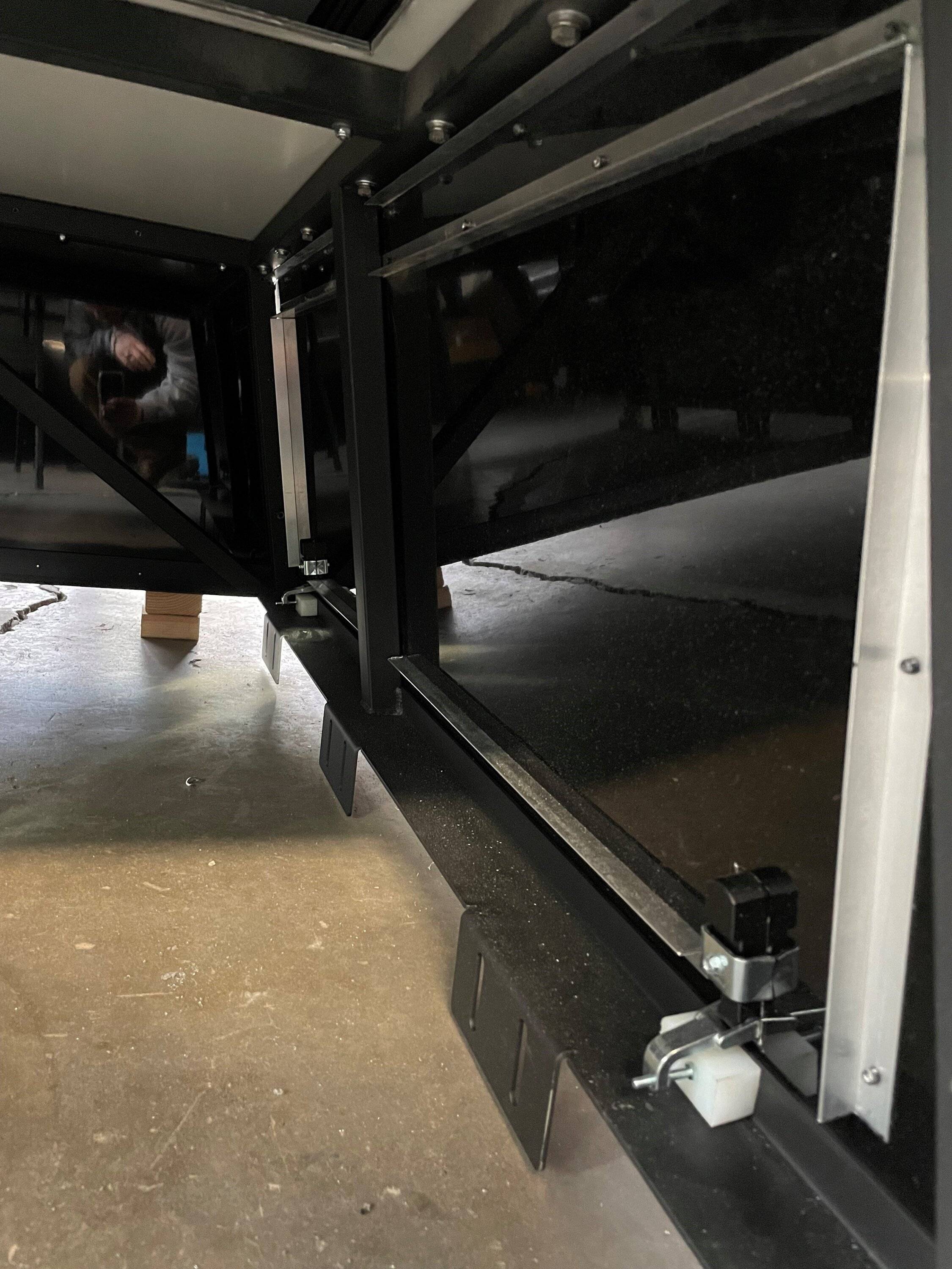

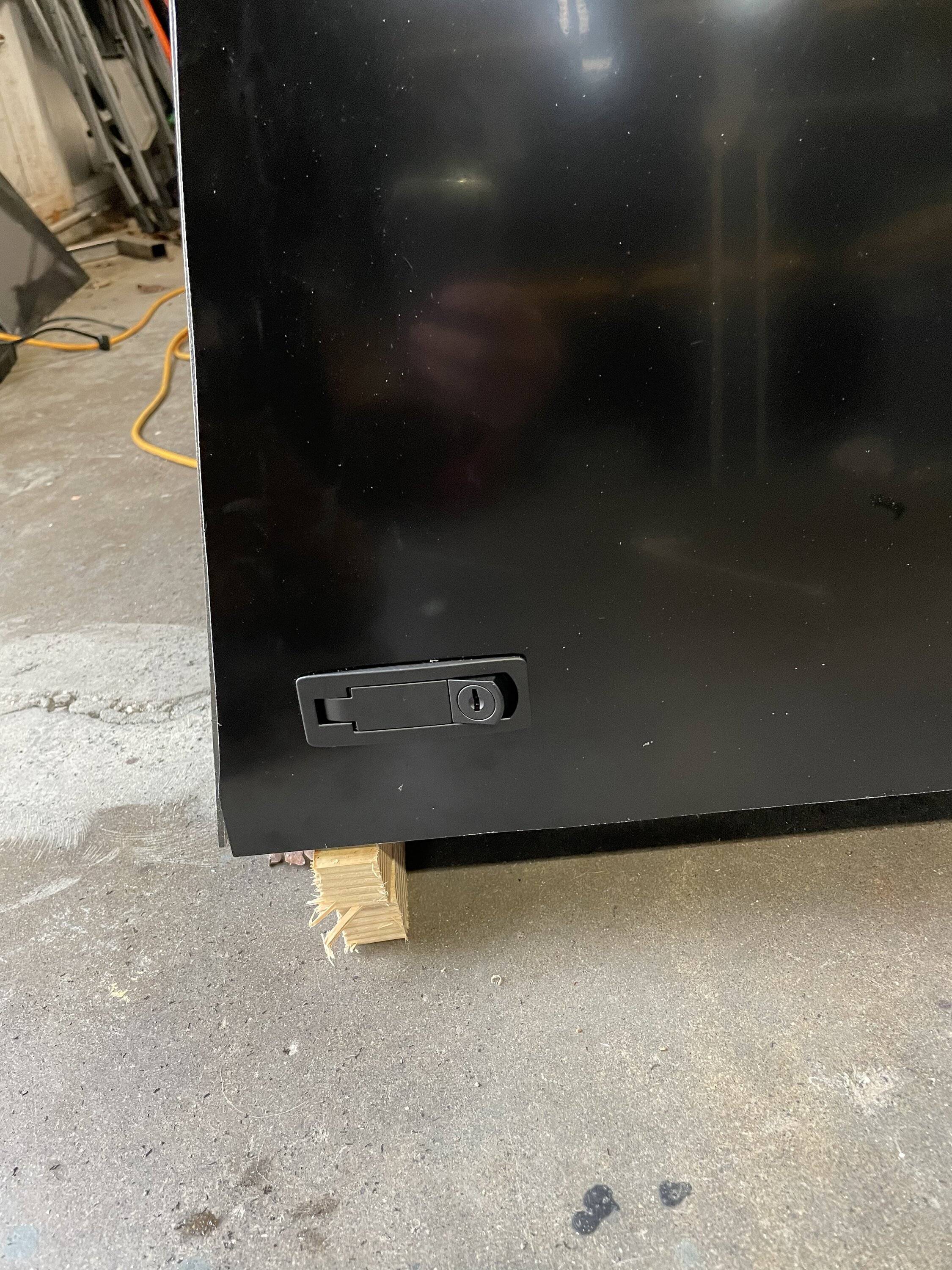

Southco locks/latches are on. This was a little tedious but went quick after I did the first two. Loving how they turned out!
This week I’m going to put on all my panel stiffeners and gas struts for the doors. I need to also put on my bulkhead gasket.
After that, I just have little things left like the 3rd brake light, cutting my opening on my floor into the wedge/sleeping platform, and touching up sealant etc.
Fabric is scheduled to be sewn mid Feb.

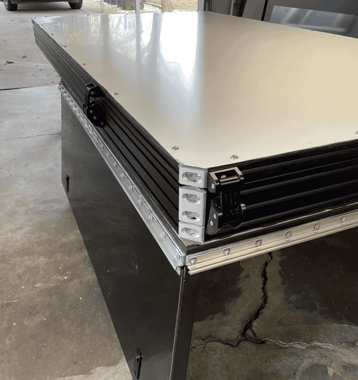

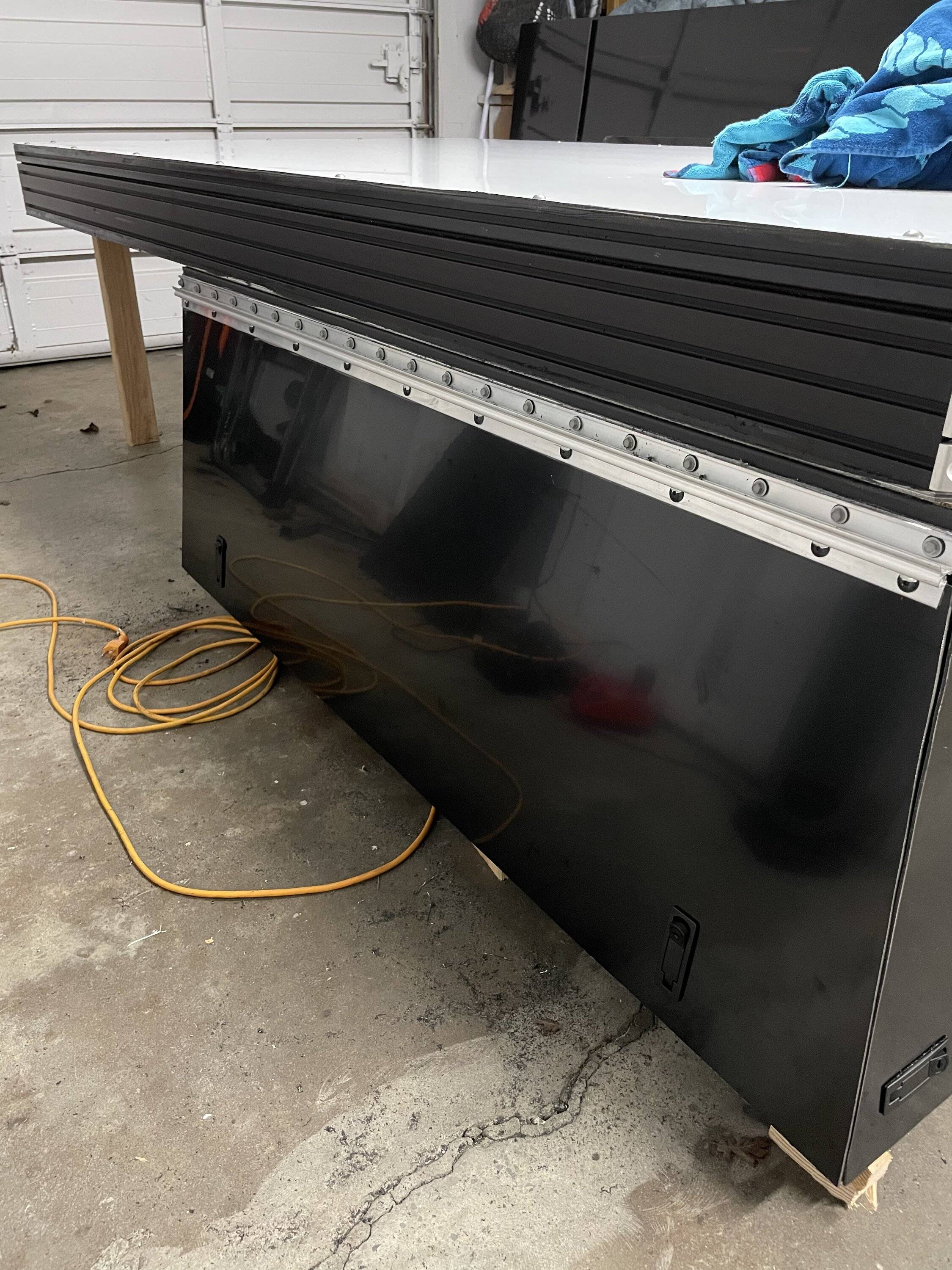

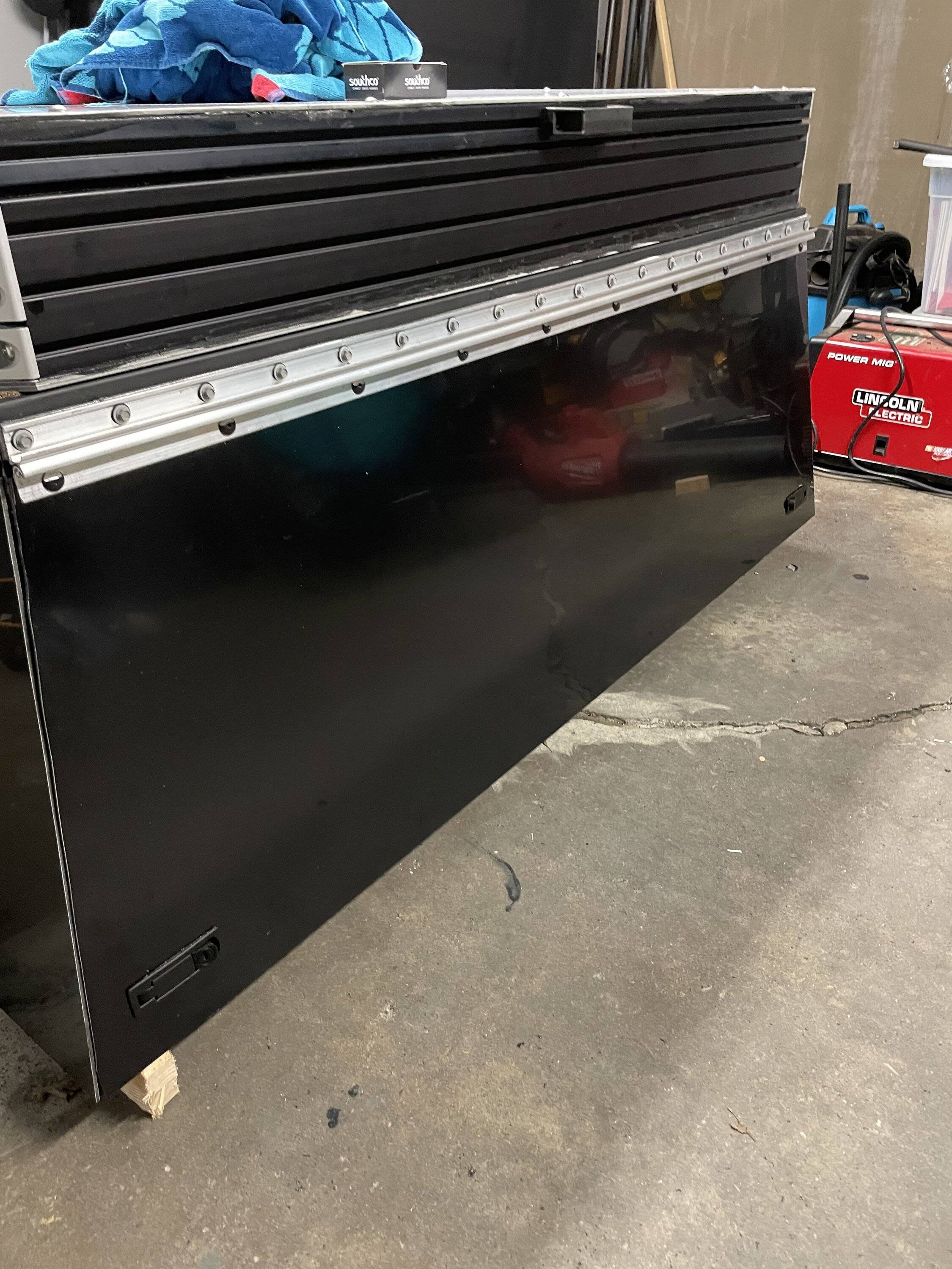

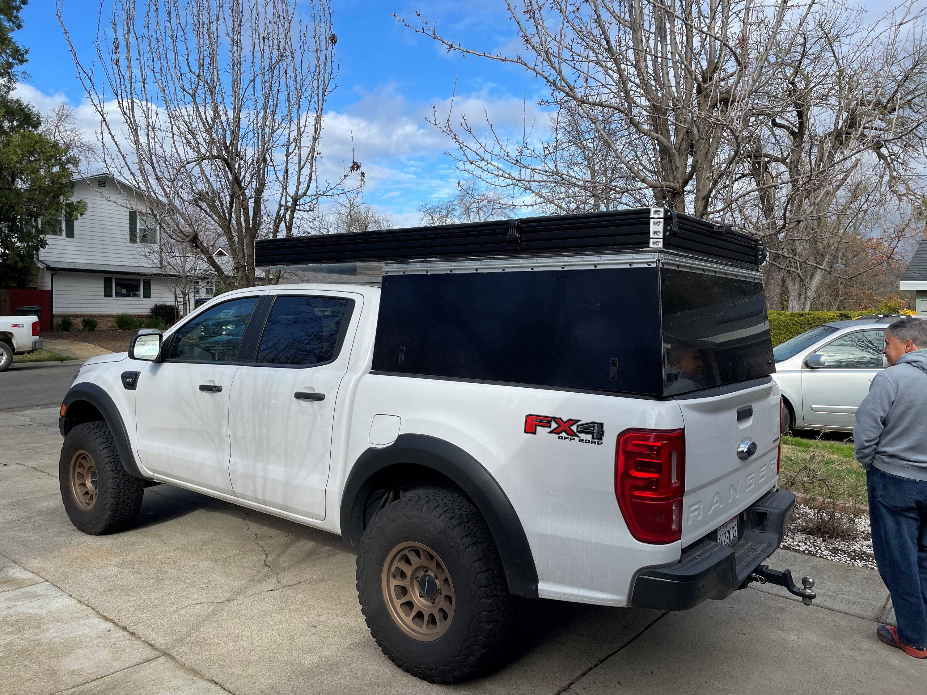

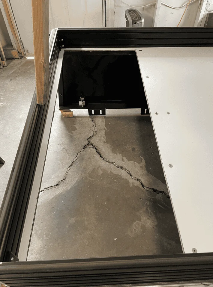

This past weekend I accomplished a lot on the wedge camper build!

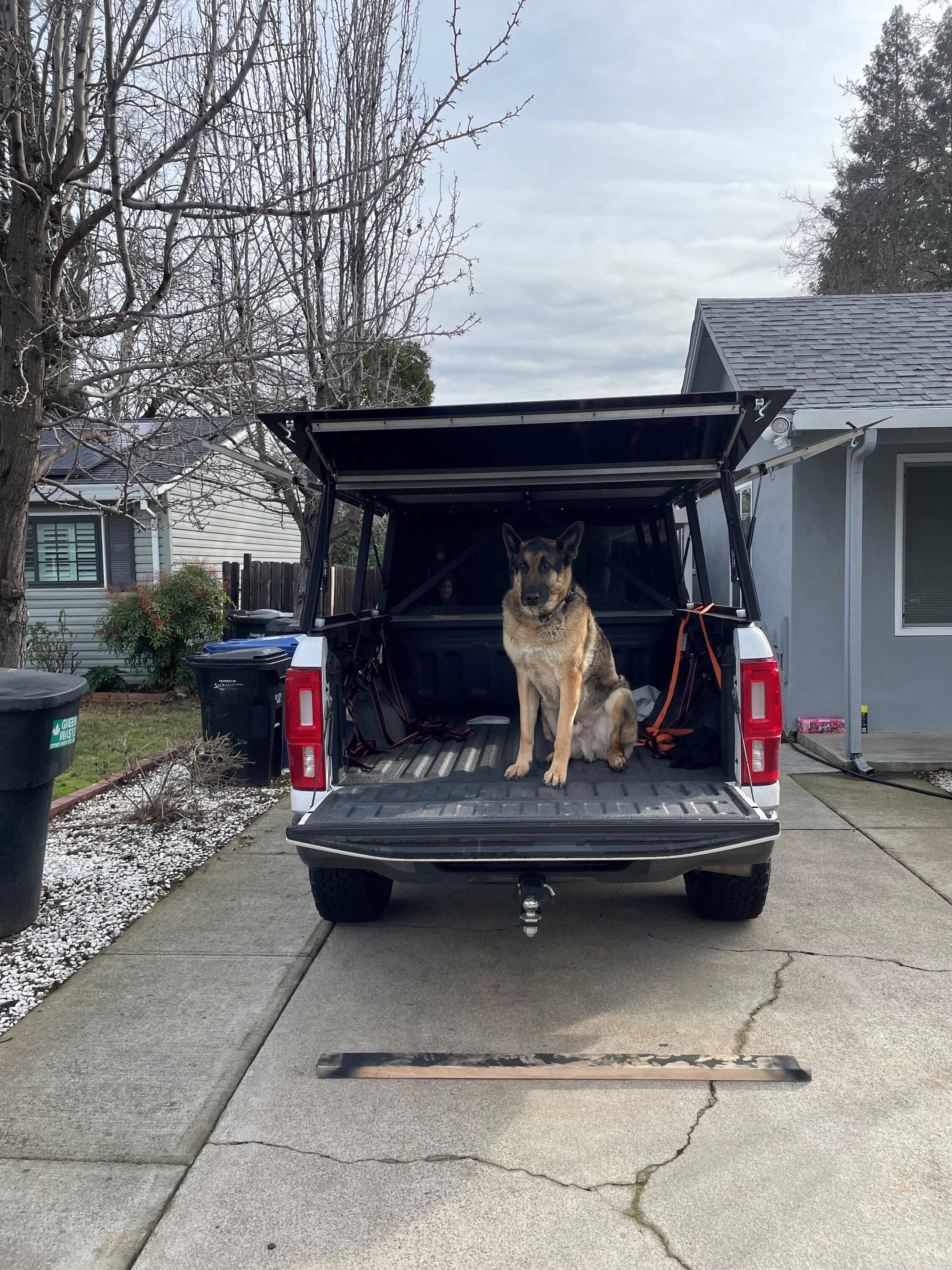

I got the floor cutout done for access to the sleeping area:
I got my latches on for the wedge:

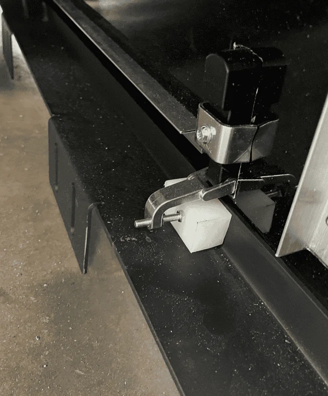

I added spacers to my southco latches so they could properly clamp onto my spaceframe for my side panels:

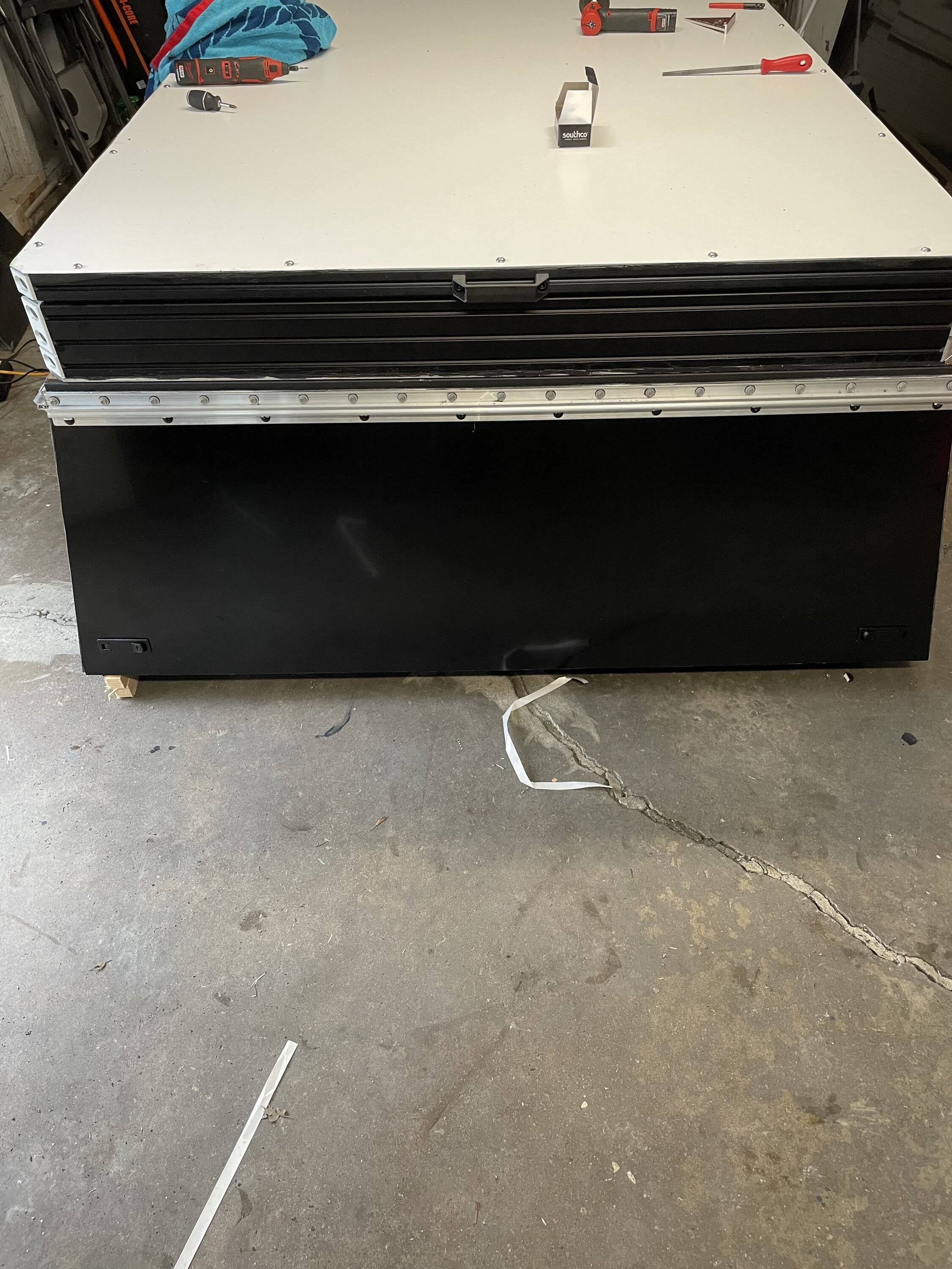

I got my panel stiffeners riveted on:
And lastly, I got a full test fit!!!
This week I am going to work on installing all of my gas struts and panel gaskets. I will also touch up as much cosmetic stuff as I can.
Next week I will take a trip to Hot Metal Fab in Loomis, CA for some permanent mounting bracket solutions. After that, I should hopefully have my canvas finished and get that all attached.

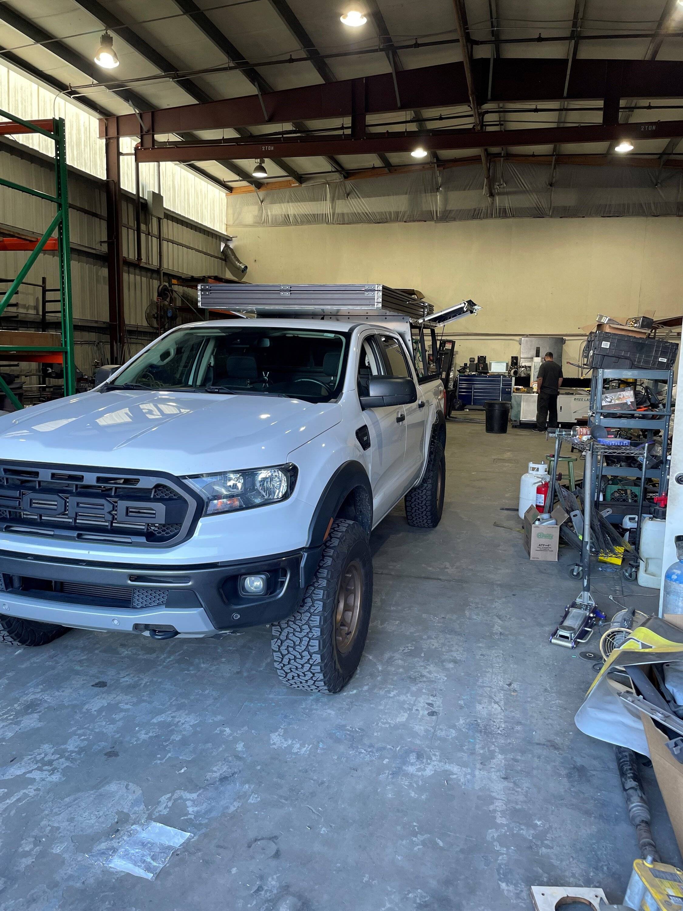

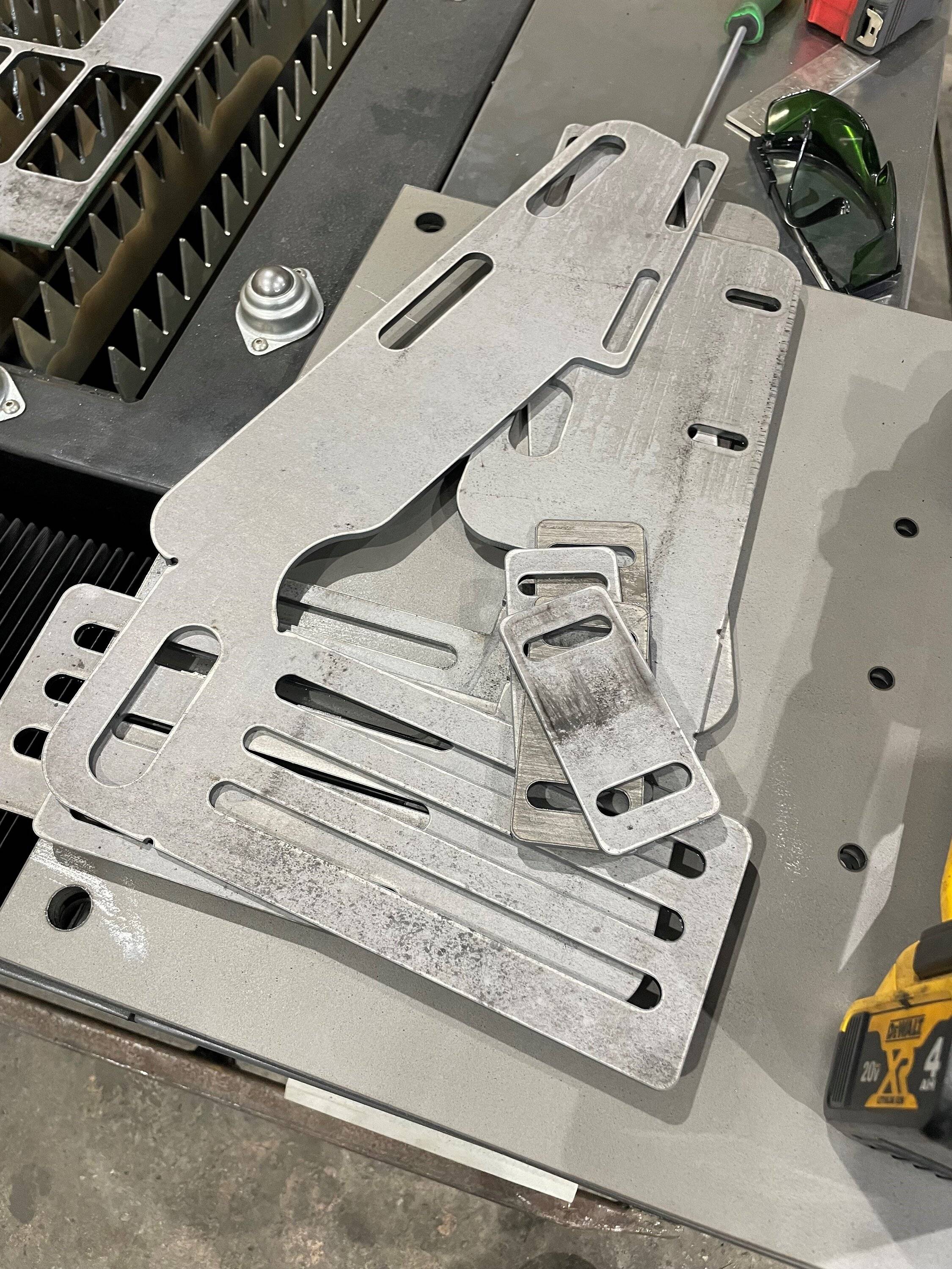

All my gas struts are on! Also visited some friends at Hot Metal Fab in Sac for some goodies off of their brand new laser. These will be the permanent brackets that will hold my camper down. The mounting points are the existing tie down locations on the bed. Once the brackets are bent, they will have new integrated tie down locations so I will not lose that functionality.
Lastly, my canvas guy bailed on me. He is not comfortable sewing my tent portion of this project so he turned it down. This is unfortunate as I was about a week out from having him start, but I appreciate the honesty from him and his commitment to only deliver excellent product. He recommended a second company to me located out of Grass Valley, CA. Upon speaking with them, they are actually contracted to sew the canvas for an actual wedge camper company. They were incredibly familiar with what I am trying to do and suggested they build mine in April 2023 when they do their next run of tents for this other company.
I have a trip to Yosemite planned to see firefall at the end of the month. I am going to use the camper, so I will temporarily cut a tarp to size and duct-tape it to the inside of my wedge extrusion. Should do the trick and let me proof out my measurements/blueprints!

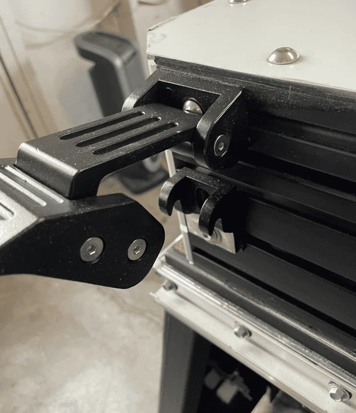

Where did you purchase the hurricane hinge ? I am still trying to decide on what hinge to use on my build. I might chest cheap out and use piano hinge.
Hey Justin! I purchased my hinge from Overland Trailer, here is a link to their store:
https://overlandtrailer.com/product/hurricane-hatch-hinge/
I was about to do the exact same thing, and then my best friend who has been helping me with this project said "How much is the hurricane hinge? How much is the piano hinge? You're really going to skimp $150 on your $4,000 build?" Lol. It cost me $318 and some change to get all of my hinge shipped to my door. (3) 60" pieces was plenty.
Also, lot's of people battle leaking with wedge campers in general, and I wanted to make sure I had zero water intrusion on the top side of my panels since all of my water will be sheeting off the top or the tent when it is open, directing all the water to the top edge of the panels. I think the piano hinge could work well so long as you seal it properly, but may not be 100% water tight. Also, the built in rain gutter on the hurricane hinge is awesome.
