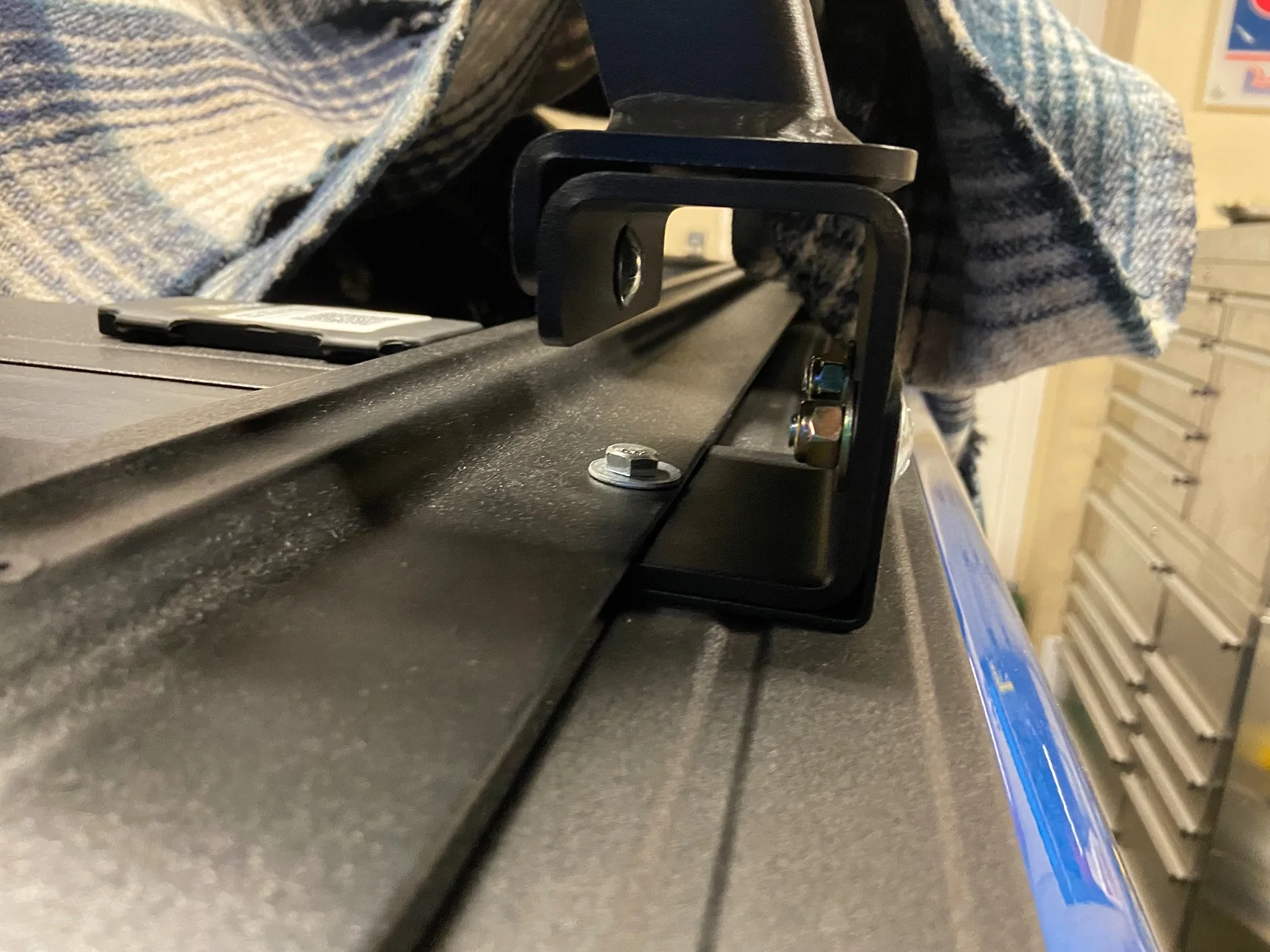

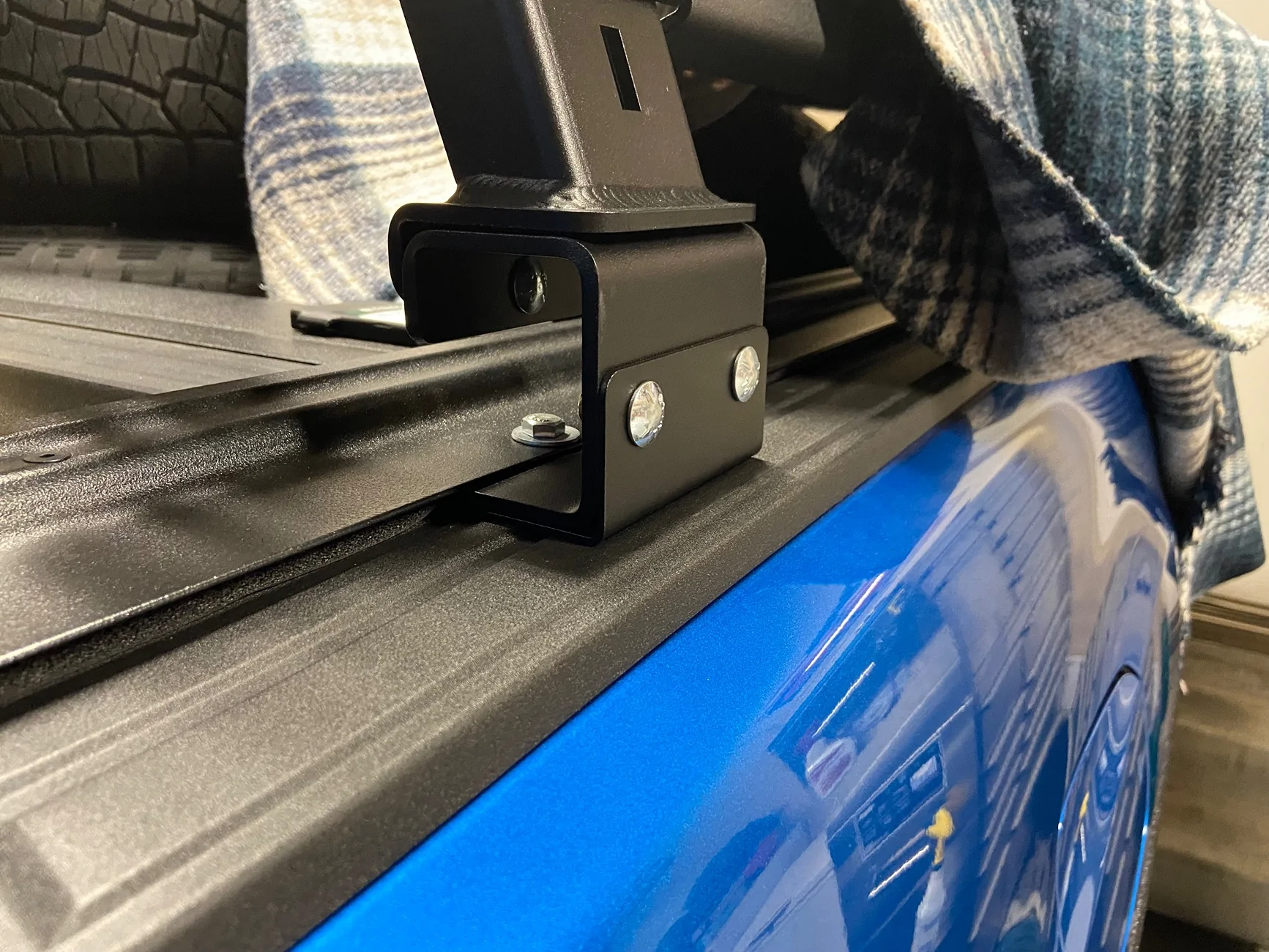

On the above mentioned trip I found that the topper had slid forward and touched my cab. No damage but I wanted to make sure this could never happen again.
I bought some 1-1/2" aluminum angle from Home Depot and drilled some mounting holes and used some t-nuts I had leftover from a Xtrusion Overland project and I was able to bolt in a "stop" to prevent it from sliding forward past new bracket.

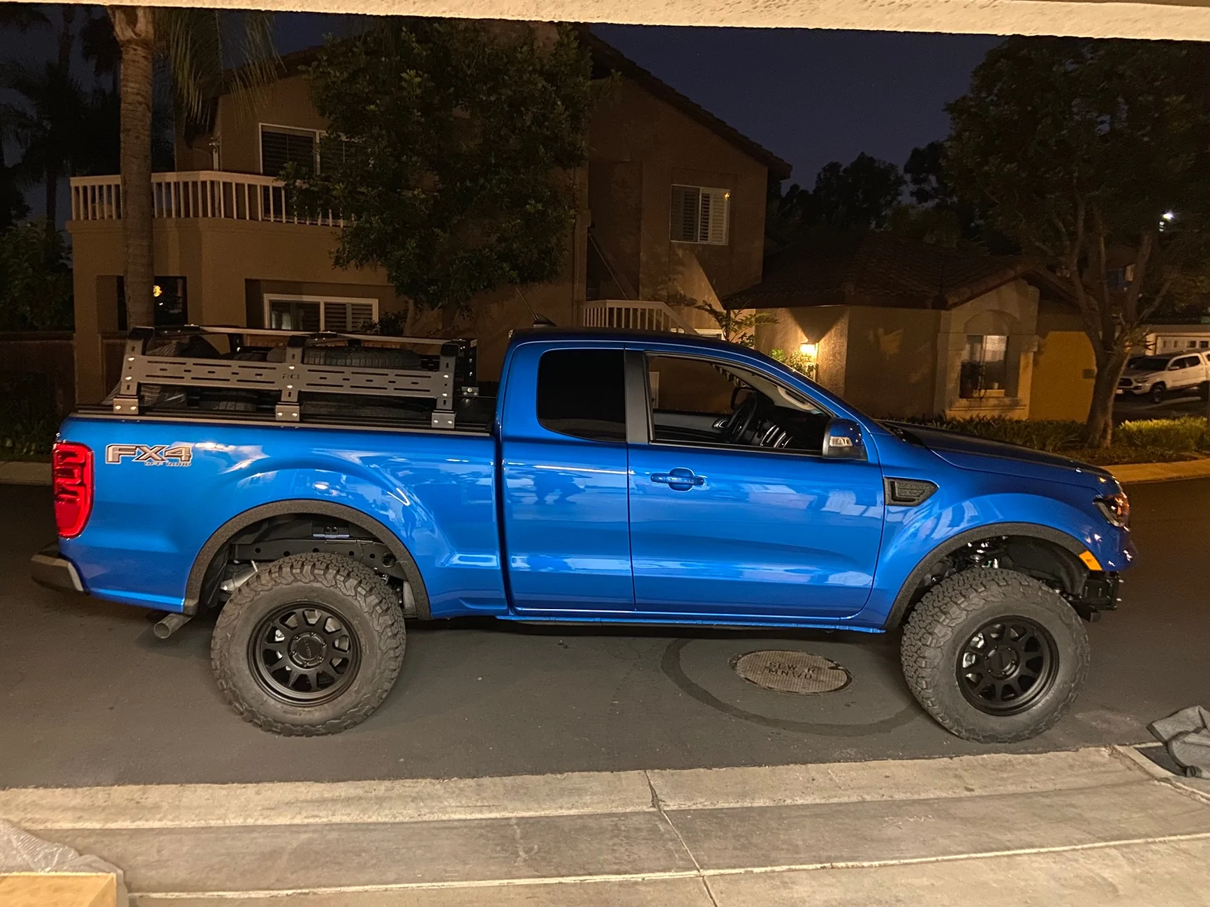

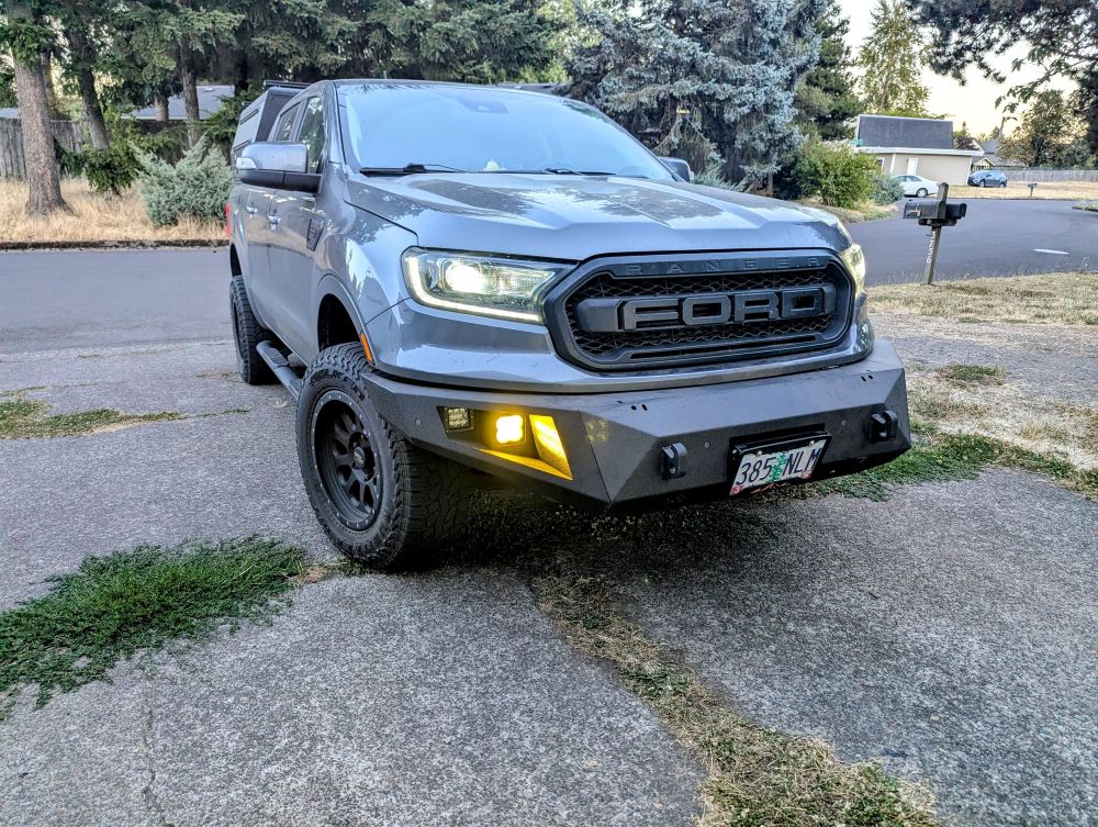

I installed a new bumper that allowed for better lighting and the winch cable easier to get to. While I had it apart I did remove my front crash bars which eliminated my minor rubbing in reverse at full lock.
That thing looks massive! Deer wouldn't stand a chance.

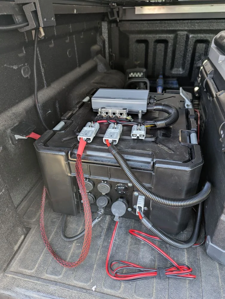

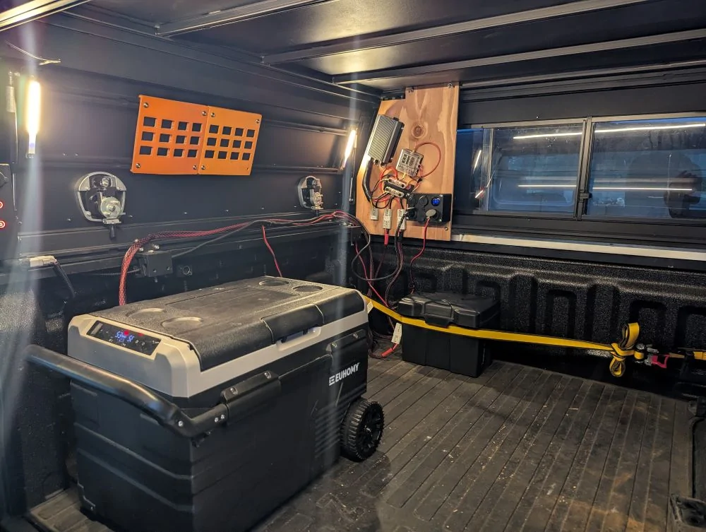

I’m using the echo flow generators also, have you considered their alternator charger? That thing is great. It’ll fully charge both of mine from empty to 100% in 1:15.
I am actually migrating to a custom made 12v aux battery. I am using a Renogy 50 amp dual battery and solar charger.
