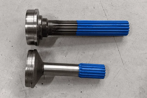

IIRC, ~68" Flange to Flange. This is ballpark. Measure!
Here the difference in spline between Ford Stock and TW Driveshaft slip joint.
Top is TW
Bottom Ford
