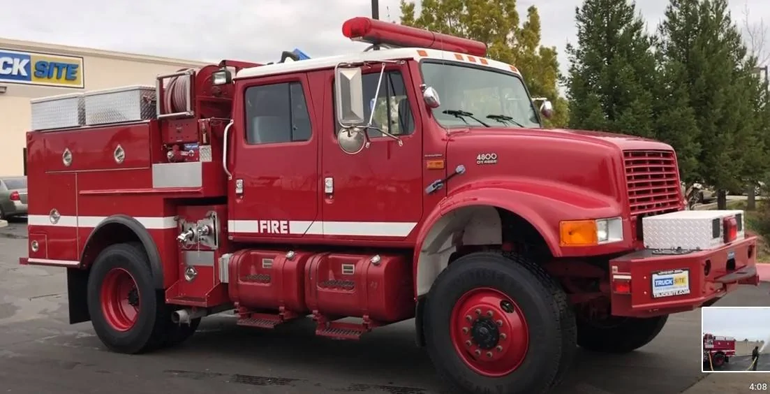

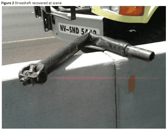

That driveshaft looks to be from a commercial truck. The u-joints are massive.
UPDATE:
The driveshaft was from a commercial vehicle, a 2002 International 4800 4X4 firetruck similar to this. It was the 2 u-joint cardan joint equipped driveshaft that failed due to cardan joint failure.... from lack of grease - the part was not field serviceable. The issue was a known problem on this truck.
"The McCandless International Truck service manager and his lead technician stated that the centering ball and seat assembly had failed due to lack of grease.
They stated that the multiple cardan joint design on this style of drive shaft will allow for service of the u-joints but not the
centering ball and seat assembly in between the u-joints."
The story can be found here
Broken drive shaft on wildland engine scatters parts, damages four nearby vehicles
The official BLM accident report PDF is attached. It has some pretty interesting pictures.
Edited for clarity.
