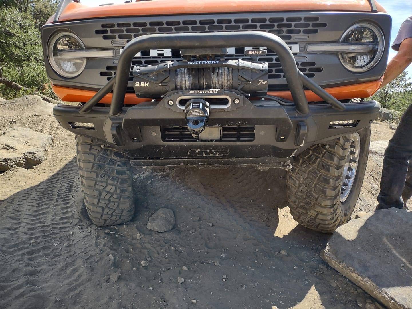

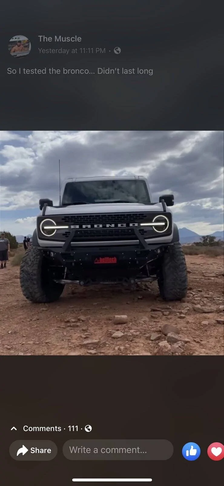

My 2 cents... the board is being a bit harsh on Phil. He is an engineer. He was with Ford. We all live in an extremely litigious society. Like it or not it is a fact. As such Phil has zero choice but to keep his mouth shut when someone is asking such technical questions on this forum. If he'd have answered with his engineer speak, you can bet your ass that he would have been subpoenaed for any lawsuit which possibly arises from the installation of an aftermarket one piece drive shaft.
No flames needed. I see both sides. But I also see Phil getting beat up, I believe, unfairly.
This would've been a great discussion between two engineers. There's obviously a problem for some and Shawn has fixed that problem and even reached out to Phil asking for his opinion. Instead he (Phil) chose not to discuss this which I don't understand why because between the two of them it would've added A LOT to this thread. I'm not trying to knock on anyone here but this should've been discussed openly here so anyone with this issue an uneven Shawn could've got another prospective.
The main purpose of this forum is to find and get answers to peoples problems and I think Shawn has done a great job at doing this. If Phil thinks this is a waste of money and those buying them are fools I feel he should elaborate more and they both can discuss this rational. I get it that Phil was an engineer for Ford and maybe doesn't like someone saying there's an issue with a Ford product but let's be real here. NO manufacturer is perfect and Ford sure does have their fare share of problems with all their vehicles. You don't have to look to far towards the Bronco which has had it share of problems especially with a proven motor like the 2.7 and lets not even get into all the broken tie rods.

Not really broken , they simply came untied ... they came untied...
How does that knot go?
The rabbit comes out of the hole, around the tree, and back down the hole.
Fair enough.
