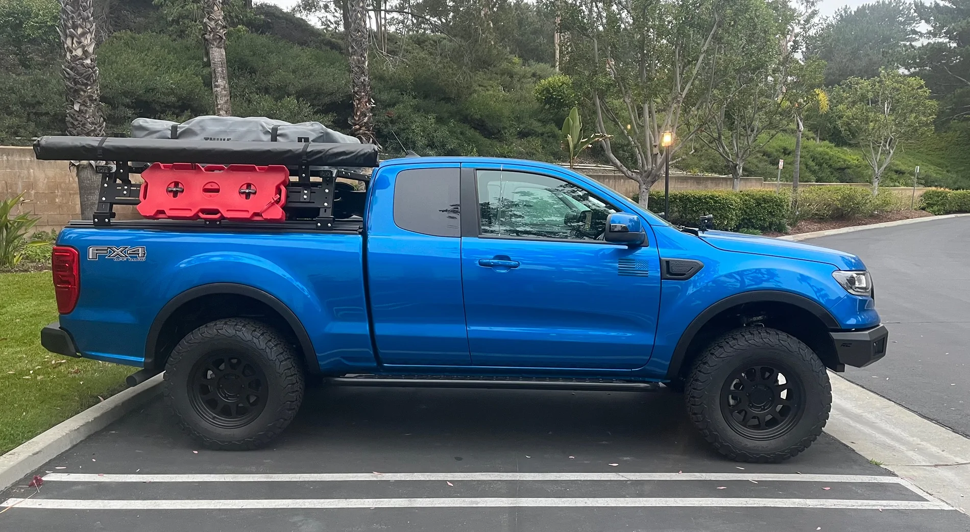

I have ICON set at option 2. Which levels the truck having Fox 2.5 front and rear with fronts set at about 2 inches. Carry about 600 pounds or so with gear and accessories mounted on vehicle. Running 32.5 KO2 tires no issues. Option 3 was too high back was up a couple of inches. Some complain about the springs being noisy I have no such problem and very happy with ride quality. I dee they are listed on Stage 3 for two prices around $350 and also $700? I paid $700 almost 5 years ago.
That’s a clean set up! Difference in driving from road to off-road?

Not a daily driver only use for camping and off road trips. Handling is great for both. No rock crawling, but some pretty rough trails and very happy with both on and off road handling. Do not get the softness issue maybe the Fox account for that they are adjustable and are set towards the firmer end.
