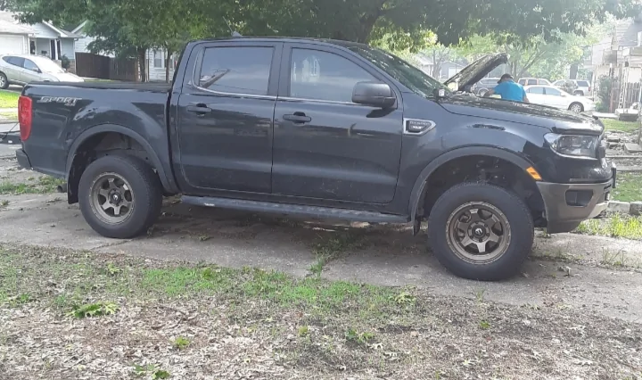

I have the Bilstein 5100s on my truck with the fronts set at 1.8. They have a firm ride to, which I like, it reminds of the way that my Grandpas old F150 farm truck rode. Here is a side view of my truck.

I have the Bilstein 5100s on my truck with the fronts set at 1.8. They have a firm ride to which I like, it reminds of the way that my Grandpas old F150 farm truck rode. Here is a side view of my truck.
I don't want to firm the ride more than the FX4 with going off road in the mountains. I had my Super Duty for that! 😂
I hear you Mel. Considering that my truck had the ride quality of a marshmallow before I had the 5100s installed, I will take the firm ride over the other, any day of the week, month or year lol.😆😁
