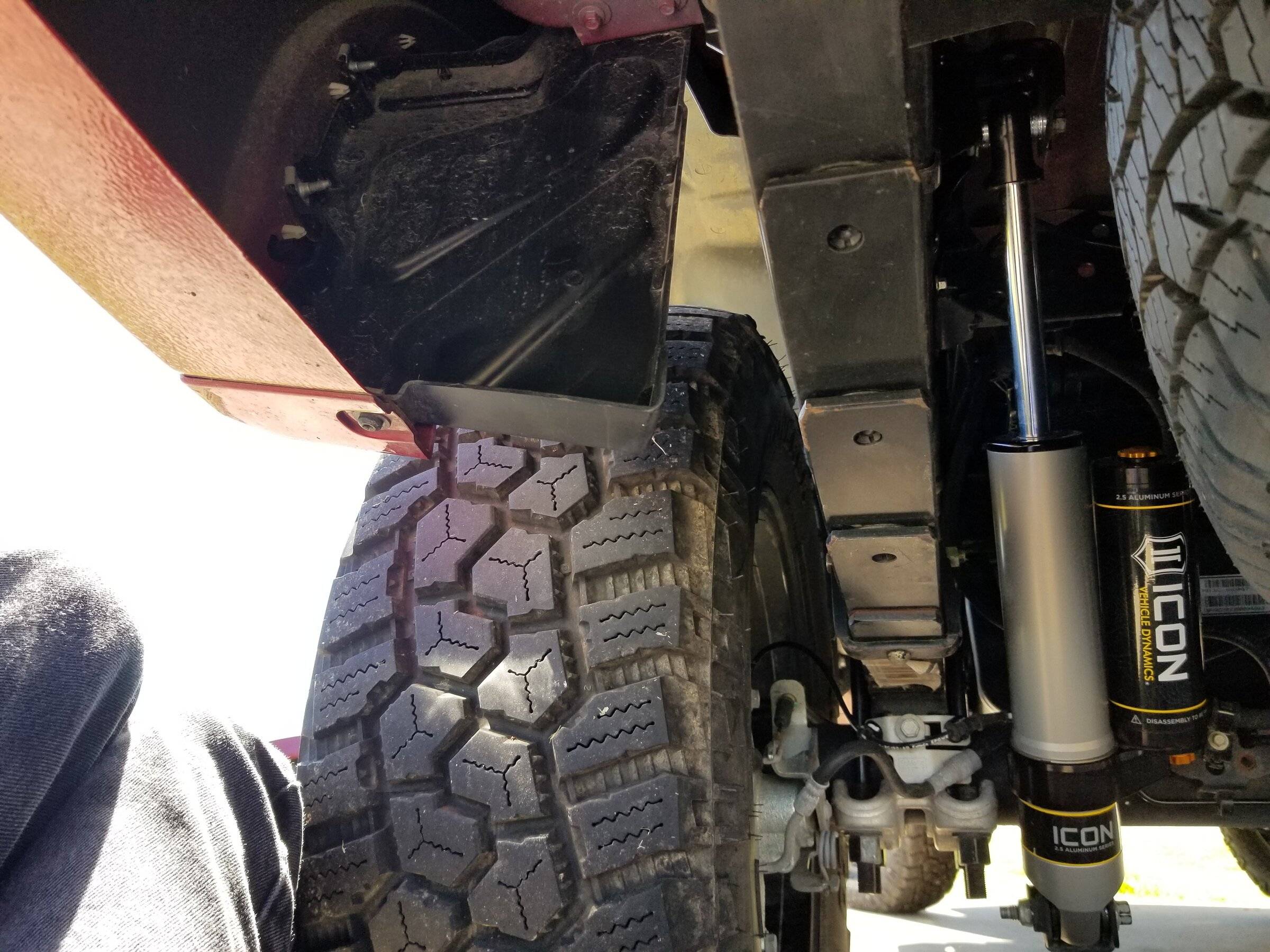

The end with the bushing already in it goes towards the front of the truck... you will need to re-use the bushing from your factory spring in the rear... torque top/front to 119 ft lbs , rear to 89 ft lbs. U-boats to 98 ft lbs.. I gave the bushings a squirt of WD Dry lube before installing, and have not had any squeaks...they are not designated for passenger or driver side installation, but prior to installing I did place them upside down, side by side to see if there was more arc in one compared to the other...the difference between the two was only a 1/16th of an inch ....I used the taller / more arched pack on the driver side....Ranger lean reasons....?...One more picture after I up graded my shocks to the ICON 2.5 adjustable valve Piggybacks....
