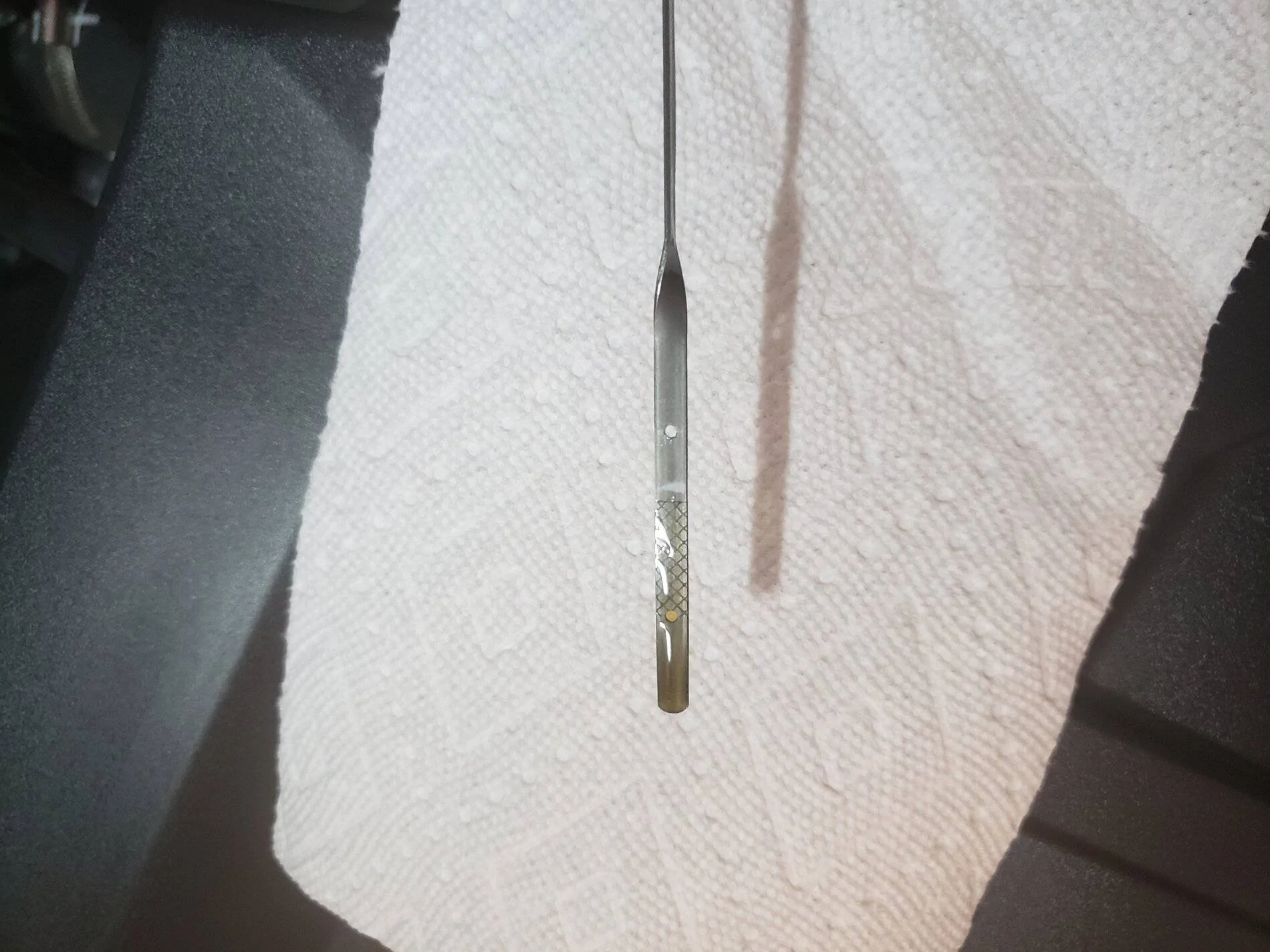

Just an update. Drove it 500 miles since my oil change. Mostly over the recent holiday weekend. Alot of highway and alot of hilly driving. Checked the level in garage about 30 minutes after shutting it off. It's now half way between the top of hash and the top dot. Remember, after I changed it, it was below the top hash after 15 minutes. I will check in morning after it sits all night to see where it is. I have an appt Wednesday for the vibe and the thunk at stops. I will bring this up just so it's on the record. Got 25.8mpg over 160 miles on way back. All highway and all atspeed limits from 55-65.

Fyi, I used math not the onboard for my mpgs. 168 miles using 6.5 gallons.

this is after 586 miles on oil. in the right light you can see that it now is about the same distance above the top of hash as it was below the top of the has 586 miles ago. Checked at the same time in morning, same garage and same orientation- pulled in versus backed in.

put a match to it yet?
i think you're over worrying this at the moment.
maybe go at least a 1000 miles between checks.
give your brain a rest.

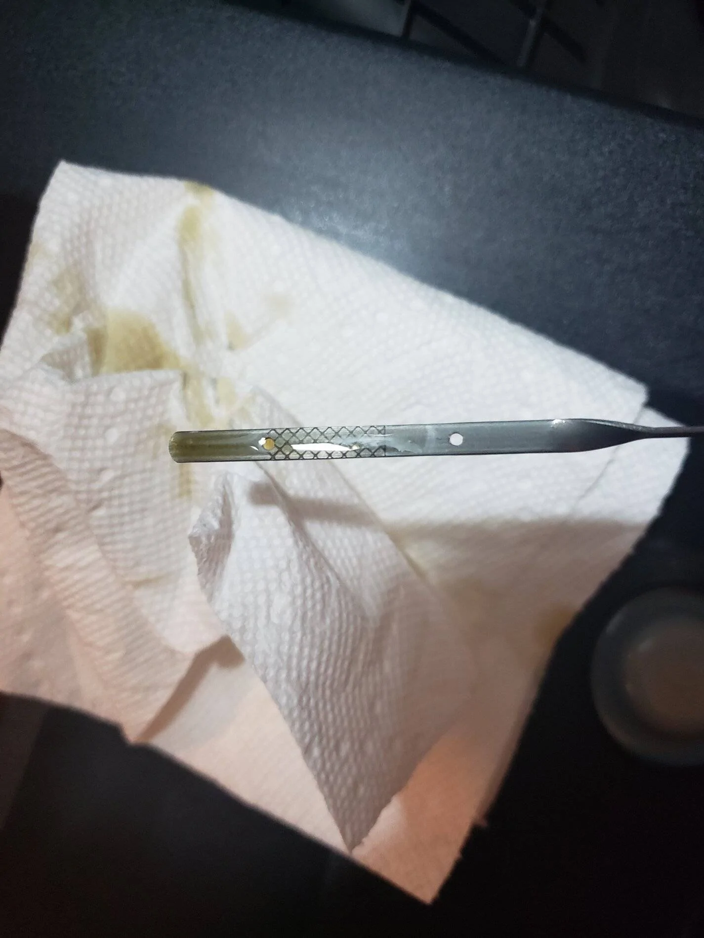

Then why does it keep on rising? Here is a picture from this afternoon after driving it and letting it sit 15.

Its now halfway between high hash and the top dot. When I changed it last week it was under the high part of the hash.

you could have a fuel/oil problem
you could be having issues getting a proper reading
you could be seeing atmospheric and temperature variances.
you could have OCD
bottom line, get your oil tested if you're overly concerned or let it go longer and don't nitpick the little changes. its like the wives who weight themselves after every meal, it just doesn't help.
you just changed your oil, your good for 10000. checking it after every trip is just going to drive you nuts.
give it a good chunk of miles over a vast amount of different driving scenarios. i'd say another 500 minimum, preferably a 1000. you're under warranty, go the full 10000 and be brave. if the engine grenades itself, you'll get another.
I hear you but in the back of my mind is ford telling me its overfilled and not honoring warranty. With that said, it's not overfill now though its getting there, and I have an app tomorrow and will bring this up so its on record. Its creating up on its own.

you are literally going to drive your self insane over this!!
