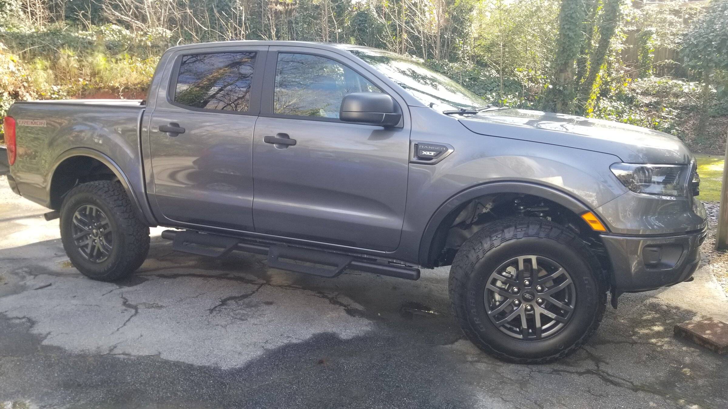

I appreciate it. I hope they can get it going soon. I feel like my truck purchase was just a dream, LOL. Glad I took a pic f it the one day it was in my driveway!
Beautiful Truck!
