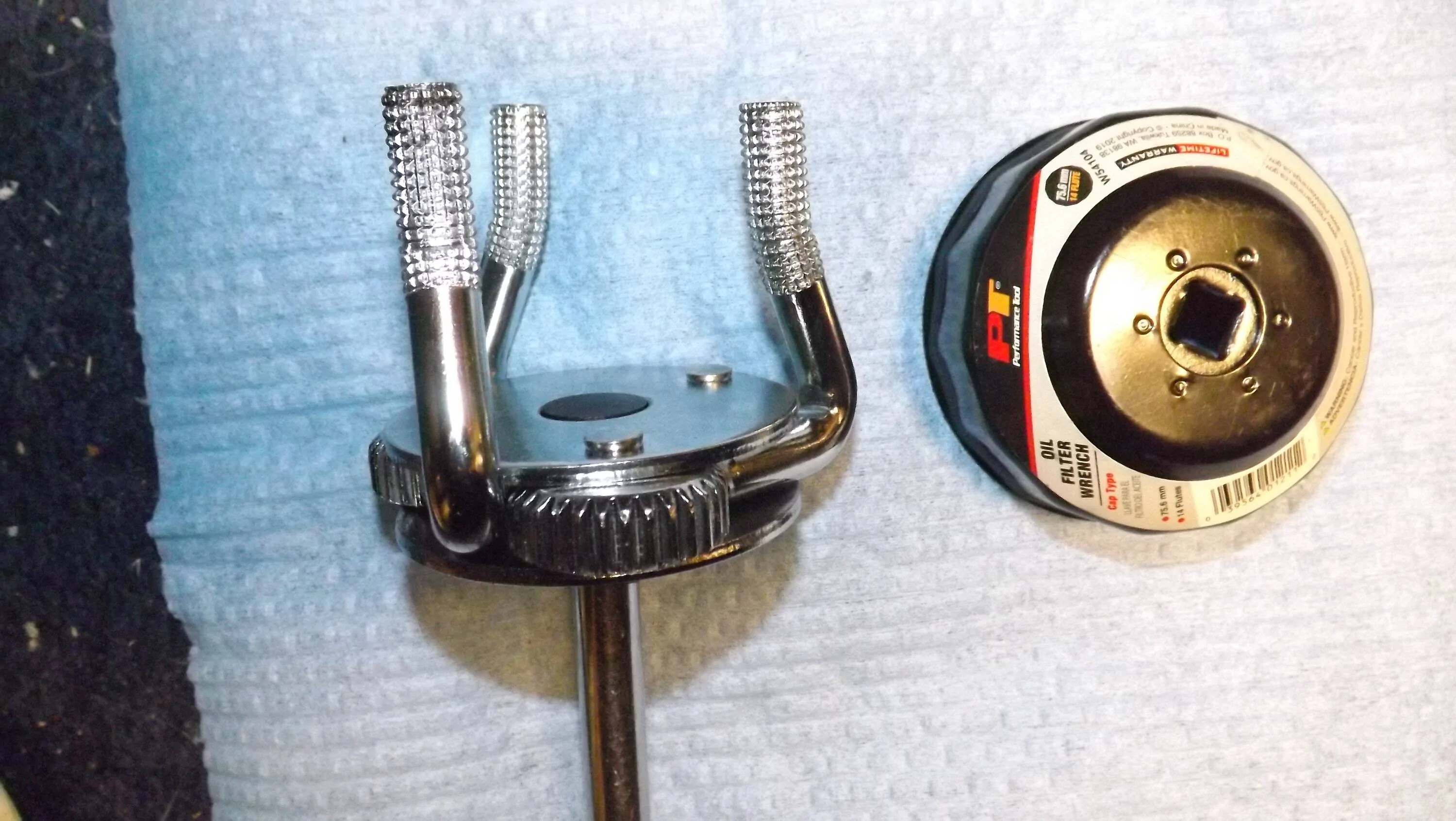

Decided not to give the dealer another shot at my Ranger. Cleaned up the skid plate, drained the oil blend. Finally, was able to get the filter off using some extra persuasion.
Standard wrench on right would not do the job. Had to resort to the one on the left with grousers. Filter was clearly put on too tight. Filled it with 6 quarts and 6 ounces of full synthetic. Installed proper Motorcraft filter.
Now I can leave on our planned 4000 mile camping trip out to the NW knowing I've done the best I could do to get ready.
Guess, I will just do all my own changes from here on out. Easy hours work. About 1/3 the money too.
This was only my 2nd oil change on the Ranger and I did something better this time. I had an old piece of a shop vac extension, a tapered plastic tube, laying around. It fit snug over the filter drain and let the oil from that run down further back where it was easy to catch in a shallow pan. I also let the filter drain out into that drain for several minutes before I completely removed it. Much less mess that way.
