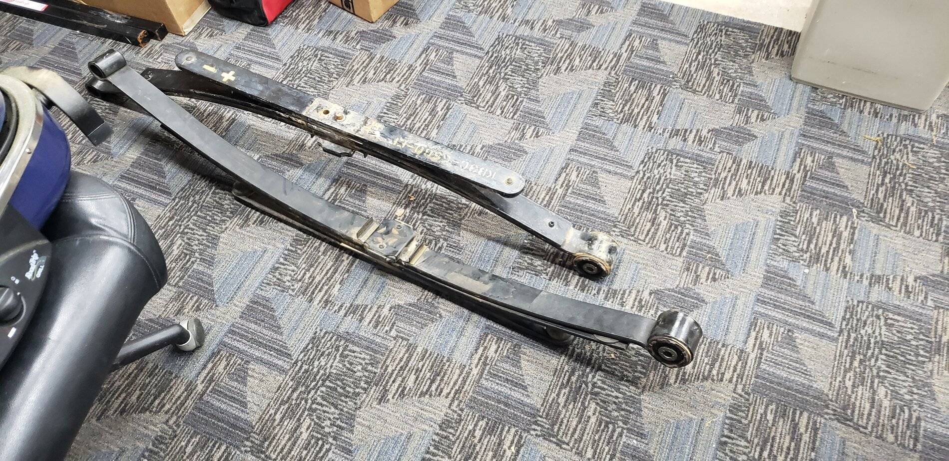

I've seen this happen before on springs that haven't been re-arched. I'm not too awfully thrilled with these springs, and ended up with an add-a-leaf kit on mine that will hopefully help. I've seen reports of this happening to other trucks and hope it doesn't happen to mine!

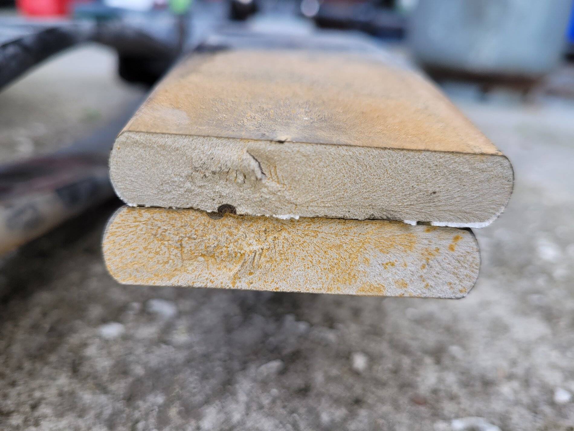

And now I'm 2 for 2. Other re-arched spring failed today.
Again, clearly visible mfg flaw was the initial point of failure.
About 1" closer to the spring arch In a location where very little work would have been done during the re-arch.
Still, I don't think there's any doubt the re-arching is likely a key player in the failures as the overload leafs don't take weight as quickly.
I'd left the overloads as is, just flipped them so their original reverse arch would better follow the arch. Had hoped to ease the harshness of the ride.

The circled area is almost certainly the point of failure and caused by a stress crack. This could be from heat treatment to tempering. See it happen from time to time in high carbon hardened steel.
