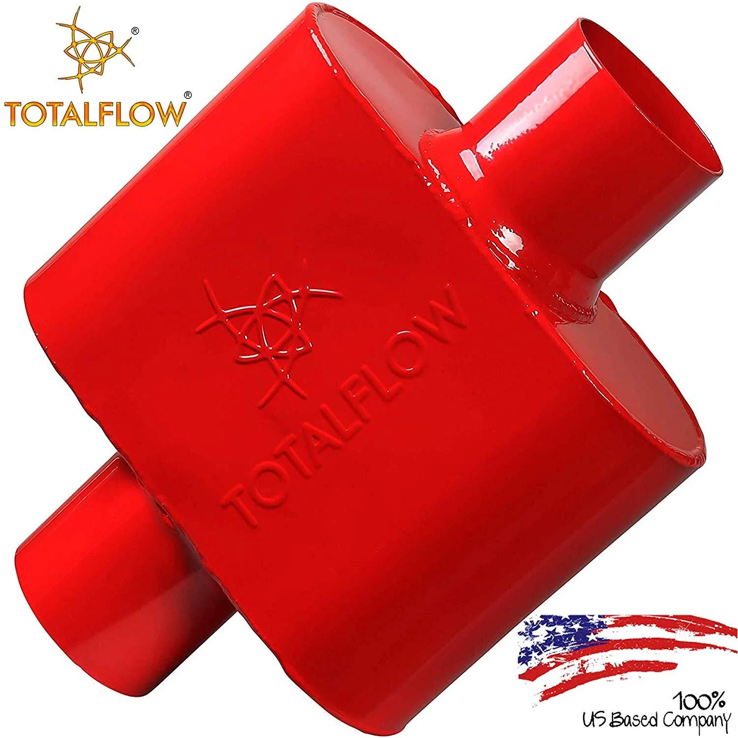

I finally got my exhaust sounding the way I wanted it today.
I recently did the muffler delete, but on my truck it sounded like Auto Stop Start.
My wife hated it, I grew to hate it, and was about to buy the Magnaflow to put in place of the 3" pipe that I had welded in.
Then I happened across this guy...
Like a mini Flowmaster and only around $22.
I got one with a damaged box off Amazon for under $20.
Inlet and outlet are 3" ID so I cut out a section and it slipped right over the ends of the pipe I had installed.
Installed it today with clamps and......
Dare I say it? It sounds GOOD!
I'm hoping it will only improve as it breaks in but right now I am extremely happy with it.
Deeper tone, zero drone, and I swear the truck seems peppier but that may be because the exhaust doesn't sound like a riced out Accord any more.
If I'm still this happy with it in 2 weeks I'll go by and have it welded in.

The biggest sound difference is inside the cab.
Much more pleasant now.

Nope, I got the aluminized.
I wanted to go on the cheap to try it out since I was basically planning to have to remove this and put in a Magnaflow.
If I knew then what I know now, I would've spent the extra $10 for the stainless version.
I wonder how bad that's going to smoke and smell when all that paint get's up to temp.....??
Based on the reviews, the paint will be gone after a couple hours runtime and then you're left with the aluminized steel.
As I mentioned to Phil, if I knew then what I know now I would've gotten the stainless version.
