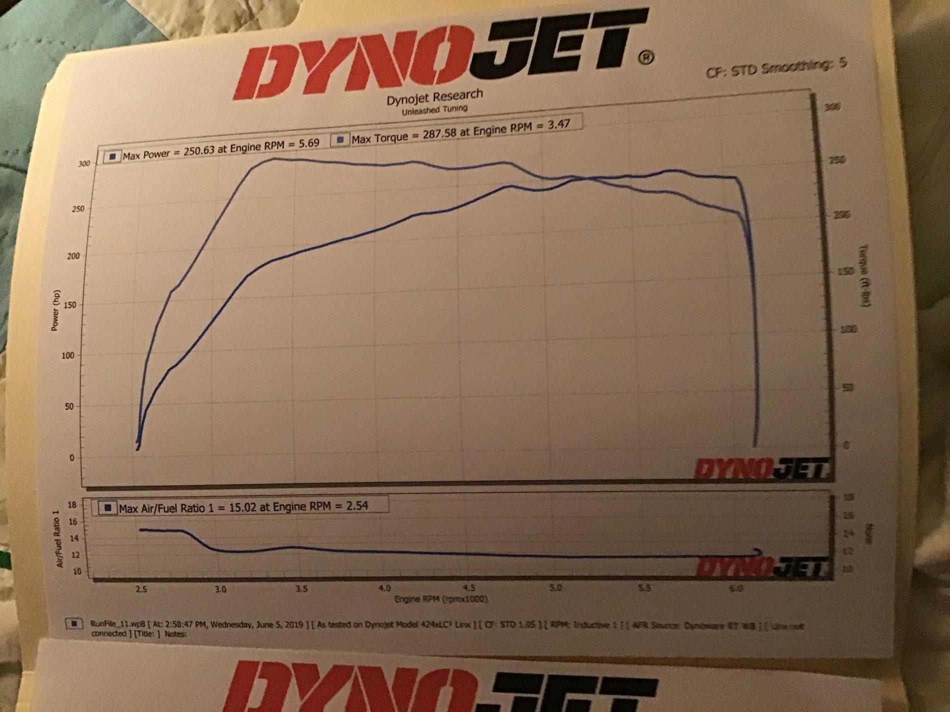

Since you're not going to be drag racing your Ranger I would go with just a tune. I think you will get more bang for your buck with it as it's customizable to your needs. You can always get different tunes too like @Doc has on his Ranger with the main tune on the S position and the D position was just cleaned up a bit for daily driving. It's $400 including the BDX tuner and 2 custom tunes from Unleashed Tuning.
https://www.unleashedtuning.com/bdx-unleashed-rev-x-custom-tuner/

Having experience with Ford 4 cylinder Ecoboost engines, an exhaust system will add some HP and some beautiful music to enjoy! The sound alone is worth it to me! That being said, an exhaust will most likely yield 8-12 HP depending on what system you choose. The real benefits of a nice tuned cat-back system are found if and when you add other components. I am running a Borla exhaust system on my new Ranger and love it! This was the first mod I made to the truck and the first thing I do for Ecoboost engines. I will eventually add a modest level tune, ram air and a larger intercooler. A quality exhaust is a good building block to start with.
Here are a couple of examples of how easy it is to increase the performance of an Ecoboost engine.
My 2017 Titanium Escape has a modified Borla system that I was running on another vehicle. I am also running a one off intake system as well based on the Focus ST system I built.These modifications alone increased the MPG by 2 plus miles per gallon and a noticeable increase in performance. That's all this one will receive.
On my Focus ST, I am currently running a Mountune 93 octane tune built around Magnaflow exhaust. Mountune intake, intercooler and crossover tube. Unique fabricated ram air system and a few other custom items. I kept the boost updates at a safe reliable level so I can enjoy my car for a long period of time. The whole package produces approximately 330 HP and 415 area lbs of torque. It's loads of fun, but very reliable. Gas mileage did drop a little over one mile per gallon after these changes, but that's a negligible difference to me.
I hope this information will answer your questions about exhaust. It all depends on what you want and what you value

The most significant change you will find with upgraded exhaust is that by removing exhaust restrictions on a turbocharged engine like the 2.3 ecoboost you will see an increase in spool speed for the turbo (spins up faster). This wont make a huge change in peak horsepower without a tune but should cause an increase in power at lower RPM's.
As far as I know the 10spd auto is a reasonably normal automatic transmission with a torque converter. Producing slightly more power at lower RPM's will change the shift points in the transmission and increase throttle responsiveness.
In a prior life I drove an imported RHD JDM Subaru STI with an automatic transmission(only offered in Japan). The factory tune of JDM Subaru's was so aggressive that improving turbo spooling by removing intake and exhaust restrictions basically put that car into full beastmode.
I feel like the Ranger is a couple of minor modifications away from a notable change in driving experience.

That’s why I did a muffler delete...

Tuned muffler delete only..
