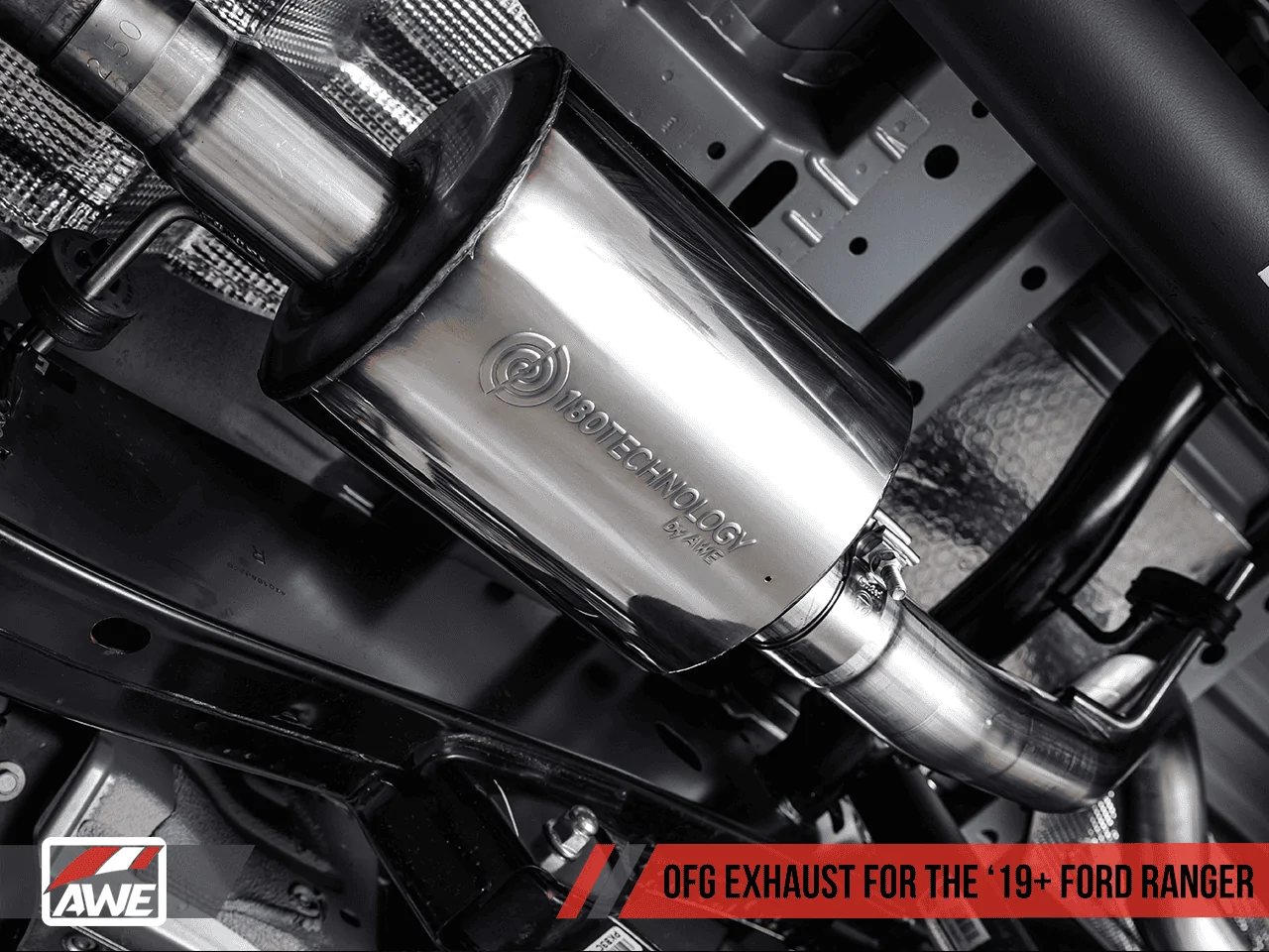

Here is a picture of the factory to AWE connection for reference. Let me know if I can help in any way. Here is a link to the product page.
Thanks for the reply. The factory mid pipe should be ok to use. I’m assuming it’s just a straight through pipe. So it would be new down pipe, factory mid pipe AWE exhaust. That’s the plan

Curious as to why you didn’t do a full cat-back?
The front pipe is a just a straight through pipe and doesn't cause any restrictions so we opted to connect after that point to keep cost down and satisfy 99% of the market. If you are looking to go big power and have a DP, you could certainly replace that front pipe with a larger diameter and mod our mid-pipe to make it all work. Should be relatively easy!
