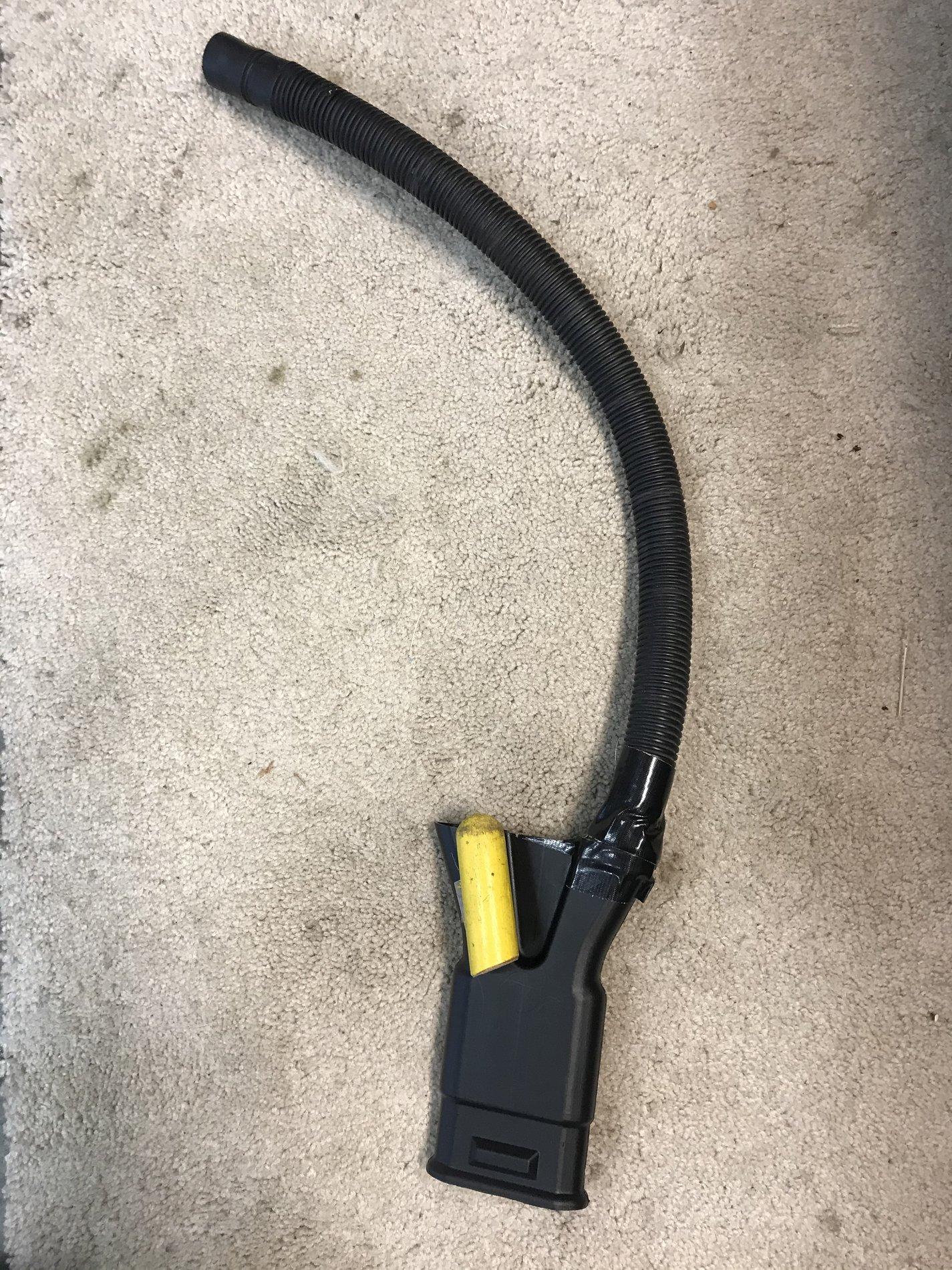

I just blocked off the passenger side underseat vent.
I also found a small vacuum hose that fit just right and plugged one side of the drivers side vent with a piece of broom stick.
Routed the hose fwd and wire tied it to the left side of seat.
We’ll see how this works.
