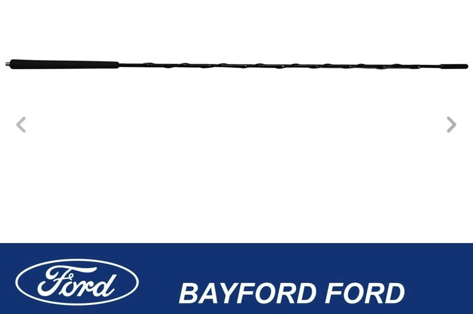

Drip rails were a NVH nightmare for wind whistle.... Glad they are gone.... Drip Rails and right front fender Antennas...wind whistle generators... Ever wonder why the Ranger Antenna of the past had a course stainless steel wrap?... Yep....to break up the standing wave created by the fender mounted antenna.....

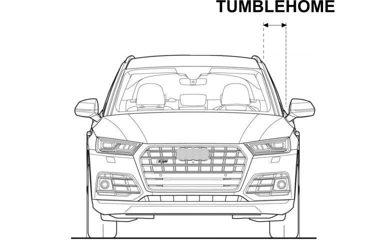

Complicating things is the tumblehome on modern vehicles. The more slab sided the less chance of drippage on the seats... Tumblehome is not a common term but here is a graphic of what it is...

Nope...real word...Nautical term adapted to automobiles.... When I first heard the term many years ago as a Nubie at Ford, I also thought it was a prank..
