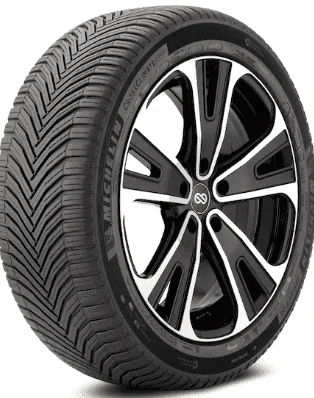

I went with Michelin's CrossClimate2. Love them! I can cross a river and not hydroplane lol.
Visually the tread is hard on the eyes- like a zebra striped dress or am I the oddball outcast here:crazy:

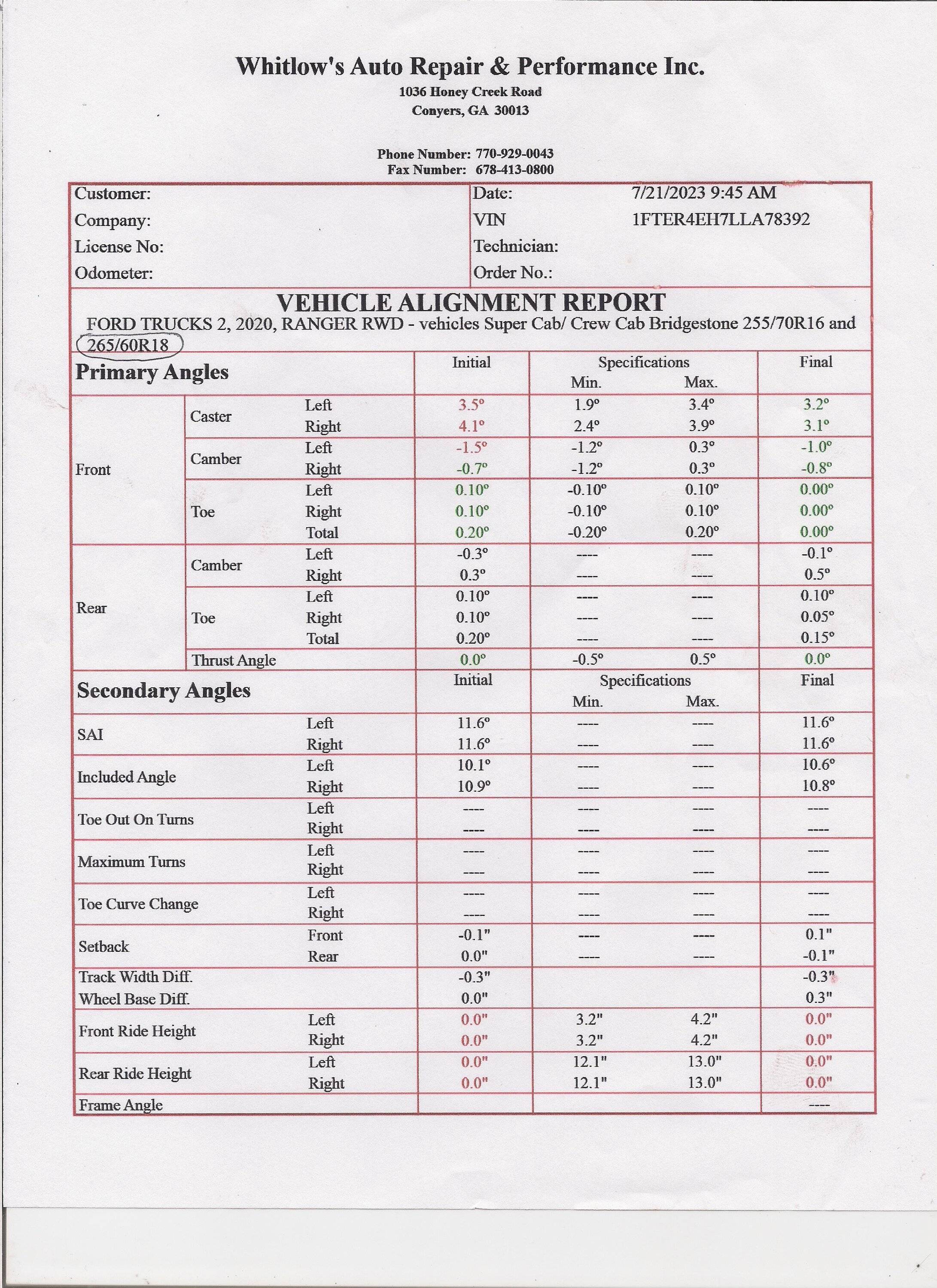

I noticed vibration at 80 MPH, okay at lower speed, I kept forgetting about it.
Then one day possibly an oil change I noticed the left front tire had excessive wear on the right side. About 37k miles. The shop I went to did not expect it needed alignment.
It needed the alignment.
Take it back. You want some Toe-IN on there. If at 0 it will go into a Negative Toe-OUT and cause vibration

Got the alignment done. The tech called me and said "Your alignment wasn't that bad actually, how long had it been since you last rotated your tires?" :LOL:
What's the deal with the ride height spec? And why is it 0 before and after when the spec is way into the positive?
