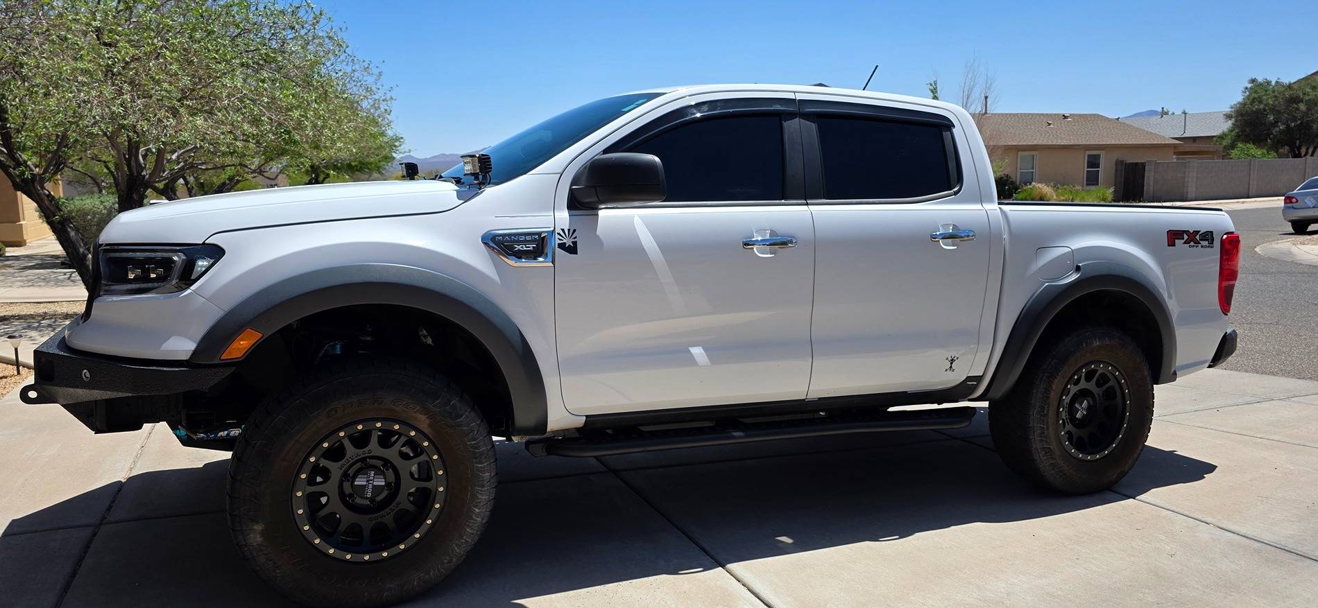

I'm currently looking more at 275/70/R17 (10mm wider than stock making the tire 32.1") stock 265/70/R17 (31.6") just doesn't fit the profile of the truck and wheel well in my opinion.
I'm still exploring if possibly a 285/70/R17 would work without wheel spacers but I'm still doing the research for it. I'm removing the crash bars and replacing them with Ready Lifts low profile crash bars (I value the safety and reason they're there and don't want to just chop them off without having some sort of protection with expecting a new born soon). I'll also be installing a 2" lift from FordRangerLifts.com, they've got really good build quality and the instructions that come with it are well documented and easy to follow along with.
All-in-all, if you're going aggressive, you'll need to do more aggressive work to allow for adequate spacing between rubber and truck like @RangerPNW advised. @Canadian Ranger does bring up a great point though, if you're going for high speed articulation of the suspension system, stock is the best way to go, if you're doing more slow speed and less full articulation you should be good going 10mm bigger.
No need to mess with the crash bars like such if you are running the Factory wheels and no spacers. I know because I had 285/70-17 Firestone Destination XT's on my 2019 with the Factory wheels along with the Old Man EMU Nitrocharger Sport Suspension Lift. This also included me removing the plastic cover from the front crash bars and slightly moving them away from the tires. The only rubbing I had was at the chassis on full lock.

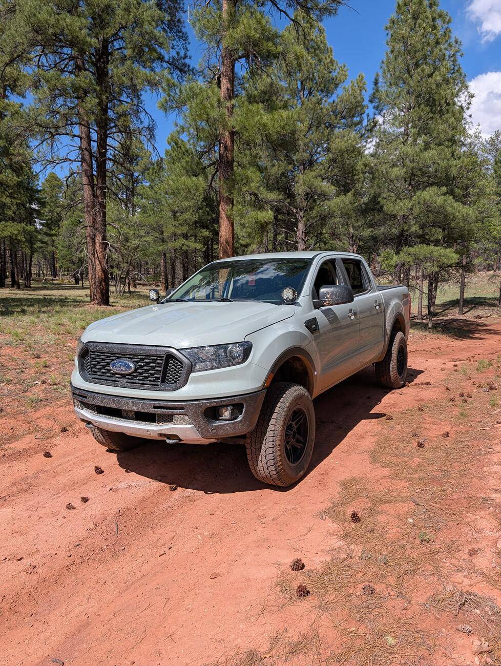

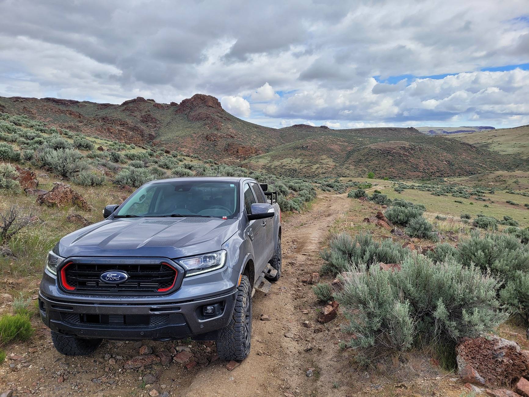

Depends on where you are. Seeing that picture and assuming most of the trails are just like that, then I would agree that the stock size is just fine. If you were on trails that required just a little bit more clearance, then going to a 33 would be a good idea. It just depends on the trails.

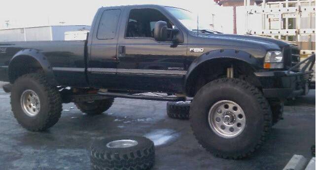

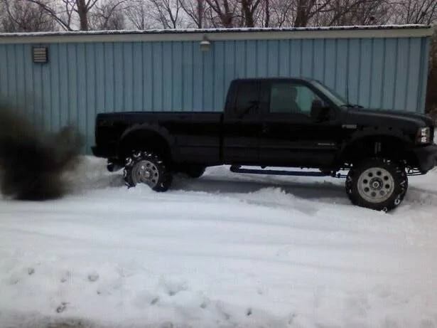

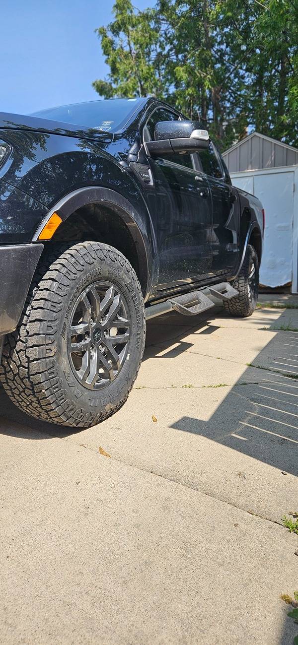

Same wheels in both photos. Clearly look the same. I didn’t put 46s on because they looked badass. I clearly needed another foot of ground clearance…. Big tires on a daily driver are typically for looks. 32 to a 33 is so minor on the trail it’s laughable. Extra width is more important.
