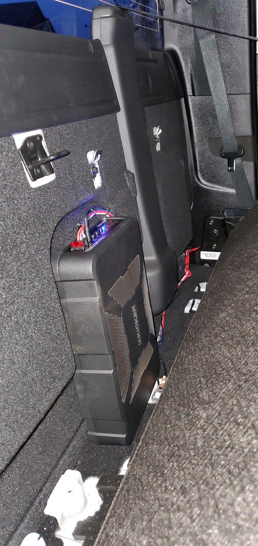

Ideally I would like to put it behind the rear seat but if I have to I will put it under the passenger seat. Will def post photos!
Got the extended cab so if I can't stuff it under the seat maybe just resting on the back floorboard might have to do.

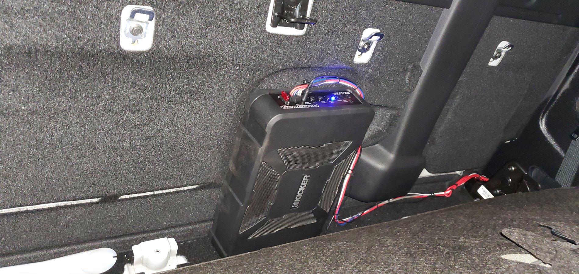

Just got the Kicker Hideaway installed behind the back seat, fit perfect and I like the sound alot. I will def be switching out the stock door speakers sooner than later though. Not a huge priority, but I know replacing those will improve the sound even more.

I just swapped out the factory speakers in my XLT and added amps and a sub (kept the factory head unit), on a relatively modest budget, and it made a huge difference. I didn't want or need window shaking bass or tons of power, and this setup really added some oomph, provided really clear sound, and built up the low end. $600 all in, including installation.
Here's what I added:
1. Infinity Basslink SM compact amplifier and 8" subwoofer. Tucked under the passenger seat:
https://www.crutchfield.com/S-mYejTePyWKZ/p_108BASSLSM/Infinity-BassLink-SM.html
2. Infinity 4 channel amp (6004A). This fit behind the head unit in the dash.
https://www.crutchfield.com/p_108P6004AM/Infinity-Primus-6004a.html?skipvs=T
3. Infinity Reference 6 1/2" - rear doors
https://www.crutchfield.com/p_108R6532EM/Infinity-Reference-REF-6532ex.html?skipvs=T
4. JBL 601CF - front doors
https://www.crutchfield.com/p_109CT601C/JBL-Concert-Series-601CF.html
Pretty happy with the result, and I've had to turn down the bass level on the sub - it really cranks.

It will fit behind the rear seat in the resess to the right and above the jack. You can also leave the jack in place. I had BB install mine and they did a great job.

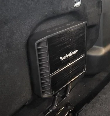

I'm not the OP, but here is the link to my own write up.
https://www.ranger5g.com/forum/thre...cker-hideaway-speaker.6776/page-2#post-144286
First, I did not pay any extra customs charges for the Aussie under seat box I bought off ebay.
The Kicker Key 180.4 has been replaced with a new designation the Kicker Key 200.4

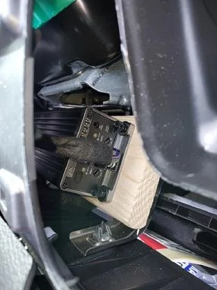

It fits nicely above the glove box, tucked away inside the dash. There is a steel bar, with holes that match up perfect for mounting the small amp with the help of a small peice of wood.
The door speakers and tweeters, I replaced with PowerBass OE65C-FD components for the front doors, and the PowerBass OE652-FD 2-way for the rear doors. They are direct factory replacements, though I did have to add cutomized (cut to fit) Stinger Roadkill RKFR6 FAST Rings to fill some space between the rear door panels and the speakers. I also had to use a step bit to drill 2 holes for the rear door speaker wires to pass through. A little touch up paint, and a couple rubber grommets and it looks like it came that way from the factory.
The sub amp is a Rockford Fosgate Punch P300X1 300w single channel aplifier. For mounting the amp, I pulled back the carpet and gorilla glued a peice of 3/8 plywood to the rear cab. Once that dried, I put the carpet back in place and used some short stainless screws to mount the amp.

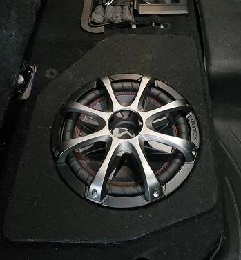

For the sub, I ended up going with a Kicker CompVR 43CVR102, the rubber bezle around the magnet had to be removed in order to fit inside the sub box. I did also line the inside of the sub usning spray glue with 2 layers of Poly Fil Extra Loft Quilt Batting.

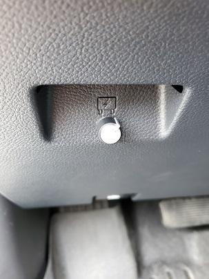

The bass knob fits nicely in the fuse panel, where it does not get in the way at all.
